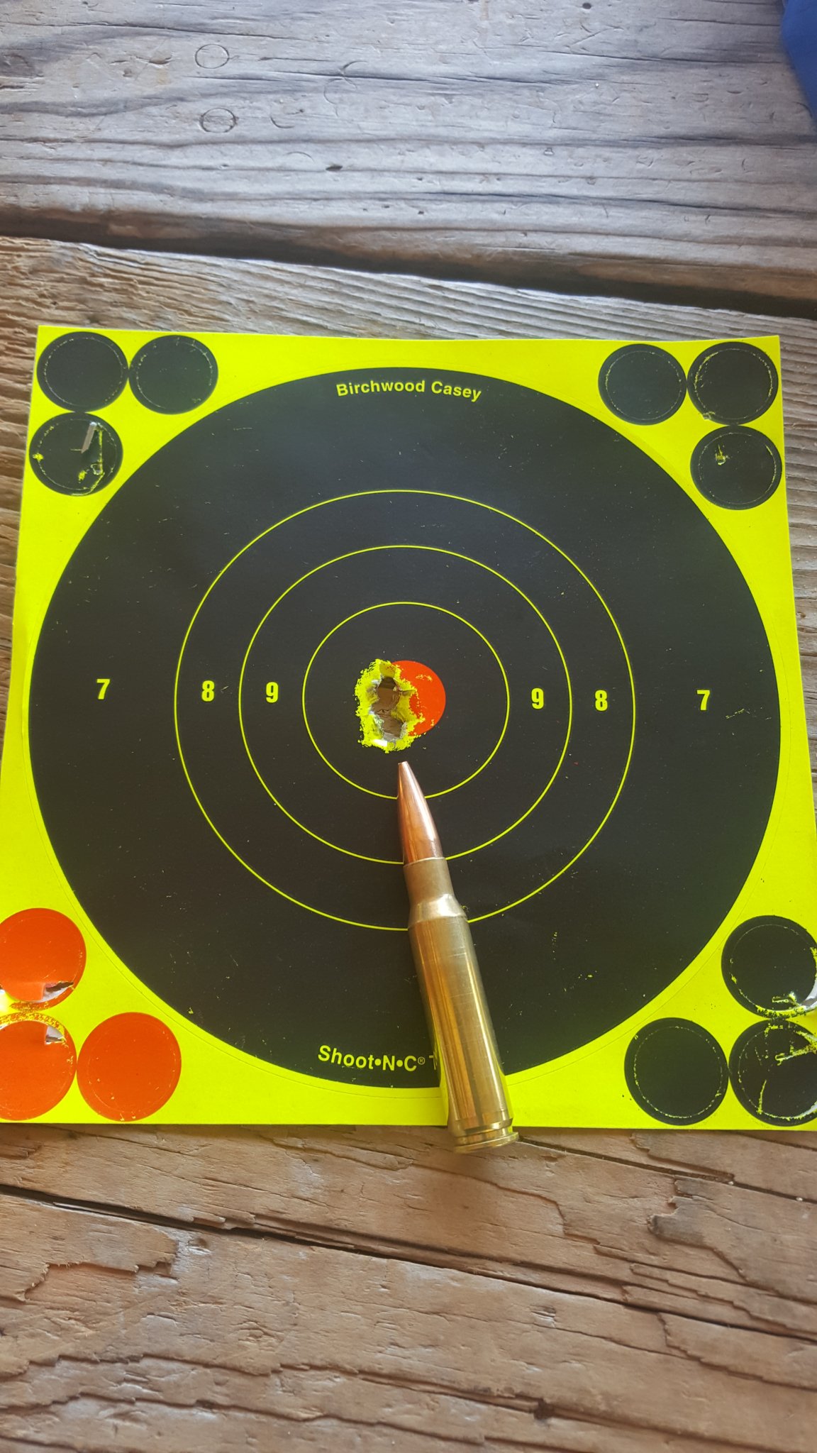

I like 155 scenars for what you are doing. I don't push them very hard but the same load shoots great in all my 308 barrels. Anywhere from 2650 to 2750 depending on barrel length.
Another vote for Scenar 155s or Berger Hybrid target 155s. They’re the most accurate bullet I’ve shot out of a .308. I like the Bergers better, but the Scenars have been cheaper. I haven’t needed to re-zero when switching. I use Varget behind those pills.
The magic speed for me has been 2850
I've debated on speeding it up because it's the book minimum, I had issues with Winchester primers that flattened out the later pinholed. Originally thought I had pressure signs because of those primers. I switched primers and lost almost 50 fps but they shoot so damn good that I don't want to mess with it. That's a 5 shot group in one rifle but the other barrels shoot as good with the same way.
Reactions: jLorenzo
