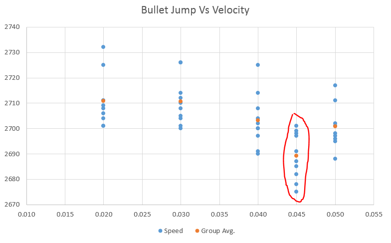

In case anyone wants data (sort of) on this. I've pulled bullets and reloaded the brass without re-sizing and they showed about a 10-15fpf lower velocity. I threw the loads into a bullet jump test I was doing just to see what they'd do. Everything else was the same. I seated the bullets with jumps between two of the other groups just to keep them separated. Needless to say, I ignored the data (this was for a Ruger Precision Rifle and 30 thousandths seemed to work best with just about every bullet I tried). And no, I'm not very proud of the velocity spread I had going here...
The necks on the pulled brass just won't have the same tension anymore when you go to re-seat bullets unless you resize them first.
