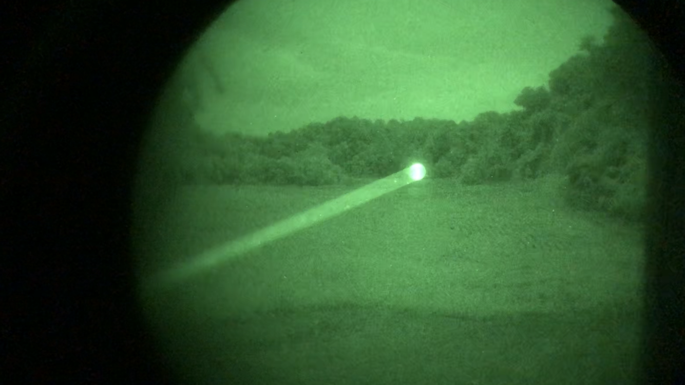

@Brown2008 below is an pic of what Downtown was describing as a powerful IR Illuminator.
That beam is at a known distance of 1,000 yards. 90mW of Laser Based Diode at 810 nm frying up some tree limbs. :LOL: It will even stroke on out much further than that. That beam will punch straight threw pretty much any night time "Photonic Barrier" a person would encounter out at night which "Photonic Barriers" would mainly be encountered in a City-Urban type environment.
"Google up "Photonic barrier" for some excellent information on why a powerful IR illuminator can be absolutely necessary in some environments. "
Reactions: westcoasteast

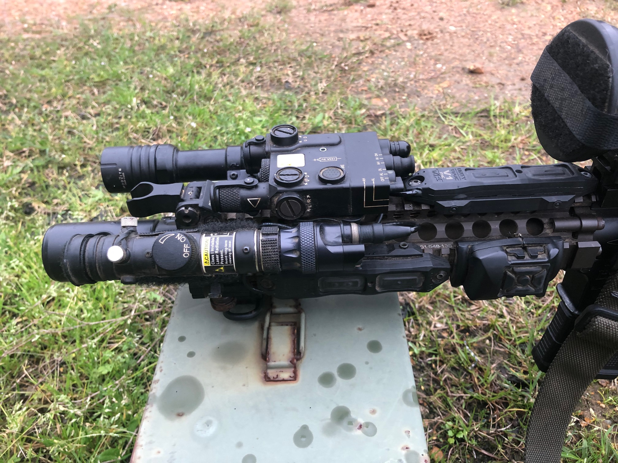

Be advised everytime you post something here it inevitably costs you money?For example a few weeks ago I had no idea a Steiner Dbal D2 existed, much less I needed one and it was the missing link to my shooting bliss......a few threads and a couple posts and $1200+ later.....well all I can say is mounting a laser and putting the beam on something and shooting it is fun, and aiming with an IR laser at something while wearing a PVS14 is just awesome. And being able to make the IR illuminator on the Dbal tight focused or broad is neat for someone like me who is new to all this stuff. Unfortunately I have not yet been able to field test mine to give a report on real world functionality for me. Other than the sheer fun of shooting with the laser at the range I bought it to go on my 5.56 for clearing the hogs in our traps at night with the PVS14 as trying to aim behind a NV red dot or a thermal at close range is a PIA when they are running around the pen, but thus far they are not showing up or we have done too good a job trapping on the couple farms they are set upon. I do run one of the little Surefire V1 Vampire lights on my helmet for navigating across the fields and in the woods and the IR works real well for that. Drive with IR cube lights on the buggy.

If you have a civi Dbal A3 you are 2/3 the way to Nirvana. Slap a Luna ELIR-3 beside it and slave it to the Luna. When/If you get a PVS 27 or 30, the Luna ELIR-3 would arguably be the best laser based Illuminator to pair with it. So you killing 2 birds with one stone so to speak.

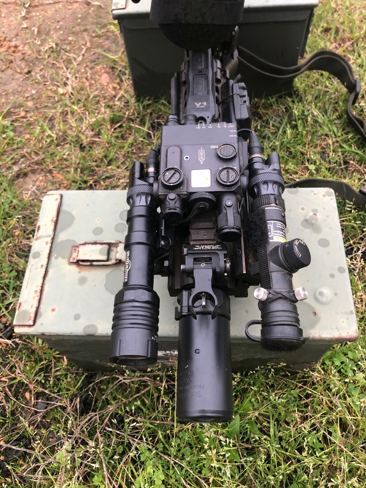

Solaris SRX IR Laser Illuminator with variable switch.
Currently is my go to Illuminator and I've owned most of them (except the MAWL). Warning it is not eye safe!
I run it on 20-30% for my D-790 and 10-20% for pvs24LR
Beam is wide enough to fill the scope and maintain its strength on the lower settings.
Cleaner light than luna's and most led's.
Battery life is 4-28 hours.
Mount it in a Burrius Signature ring and you can adjust/center it with the reticle. 1" 0r 30mm will both work on different locations.
Down side is it is heavy at 16 oz. and not eye safe. Street price about $200.

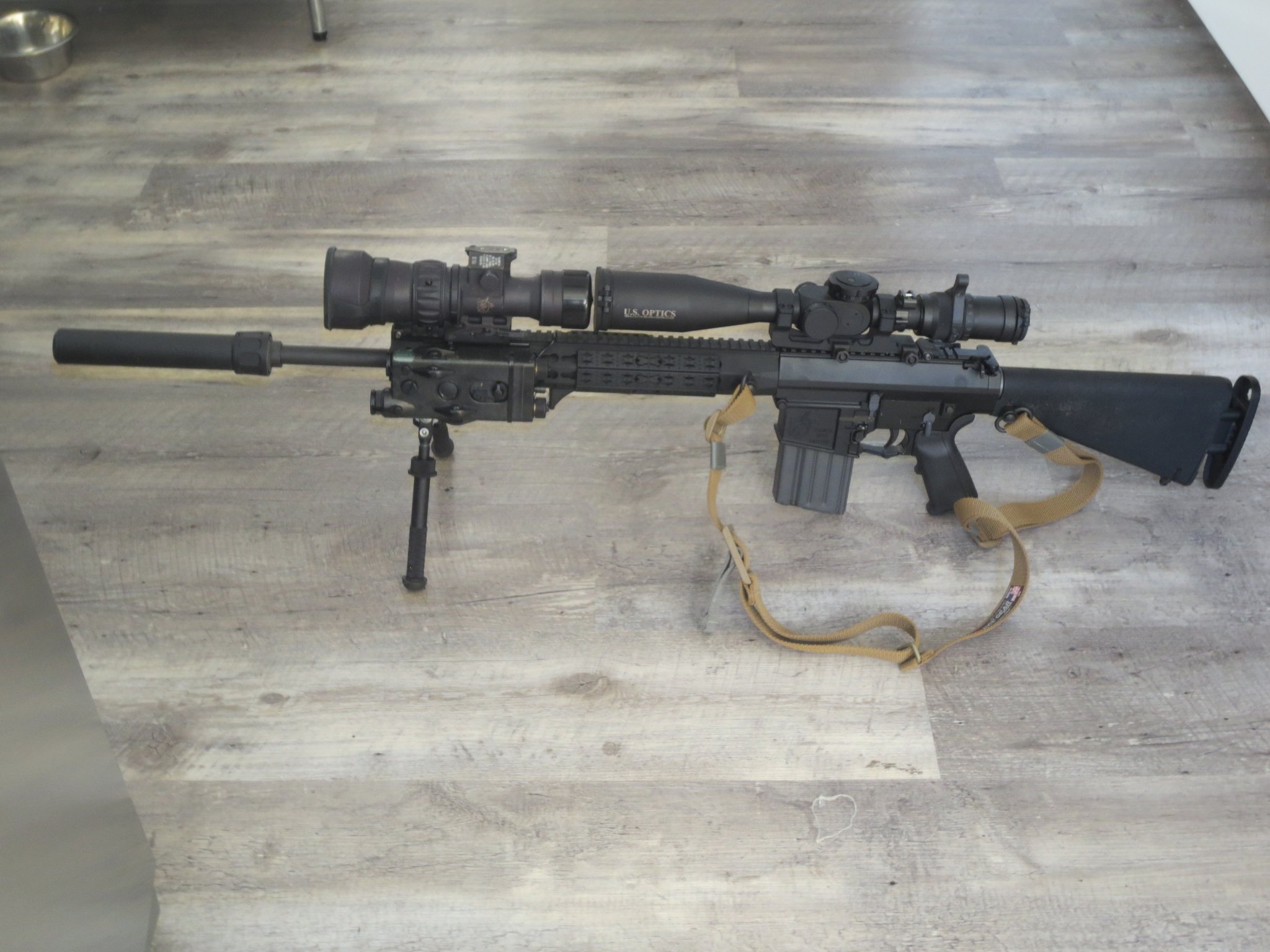

For most aiming use the .7mW will work (but IMO that needs to be stepped up to 5mW to be more effective). Anyway, it works to 300m, seen it plenty of times. The illuminator is different. I guess guys are having luck with Luna or whatever, but I'm sure that thing has got to put out a big red glare, I could be wrong. I use an old PEQ2 and it gets the job done quite well. And the illuminator on high works great for the PVS30.
As far as mounting it so you can use it with a sight, I'd shy from that were I you. You CAN do it, they make mounts that allow you to put it behind an EoTech or Aimpoint or whatever on an M4 (there are recoil limitations depending on the 14 you have) and while it works, it limits you to only being able to look behind the sight. Hence the laser and head mounted option. It's the only situation where you'll find seasoned shooters tell you it's okay to use a laser on your rifle.
Hard to tell you what to do. PEQ2 has done me fine but finding a legitimate one requires some know how and persistence. Calling in the SN to CID, NCIS, FBI, local sherrif and police, the mfg., etc. If none of them are looking for it, then it's one of the gray area items. While it ain't stolen, it's been written off (they don't do this anymore but used to) and you can legally own it, you still can't send it back for repair. However, good ones in like new condition usually don't have any problems. Same with PEQ 15's. If they can't give you a SN, don't bother.
Works fine illuminating targets out past 1000m for this PVS30 and there's no way that thing would work that far without it. Being a PEQ2 it's considered big and bulky but as you can see it doesn't take up that much room.
