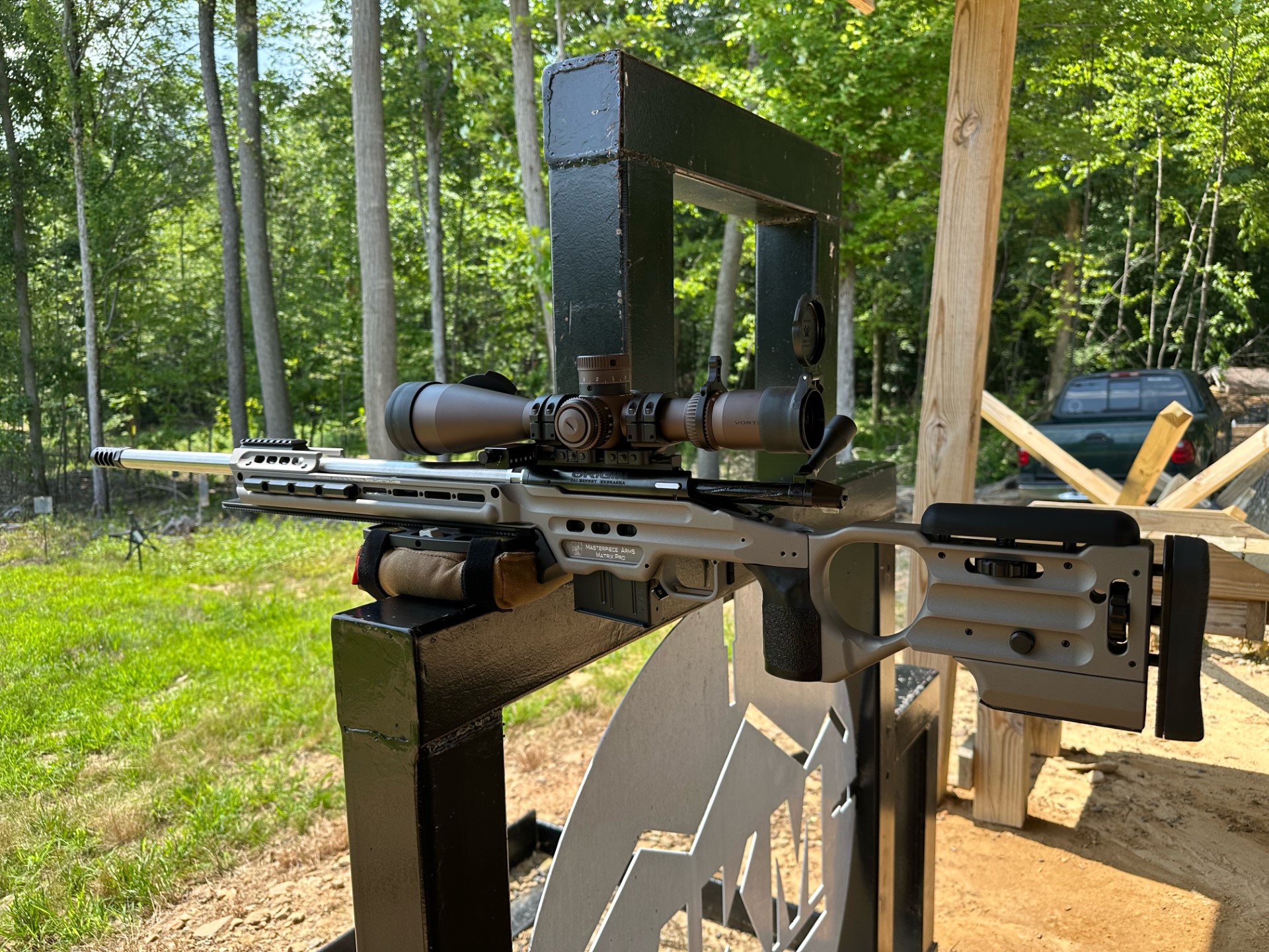

Here is a pic of one of my PRS rifles with a barrel nut and 1.25 Heavy Palma Bartlein profile barrels.
looks Like I wrong with the BugNut. He will be able to run up to a 1.20 breech for the Remington threads according to SPR.
