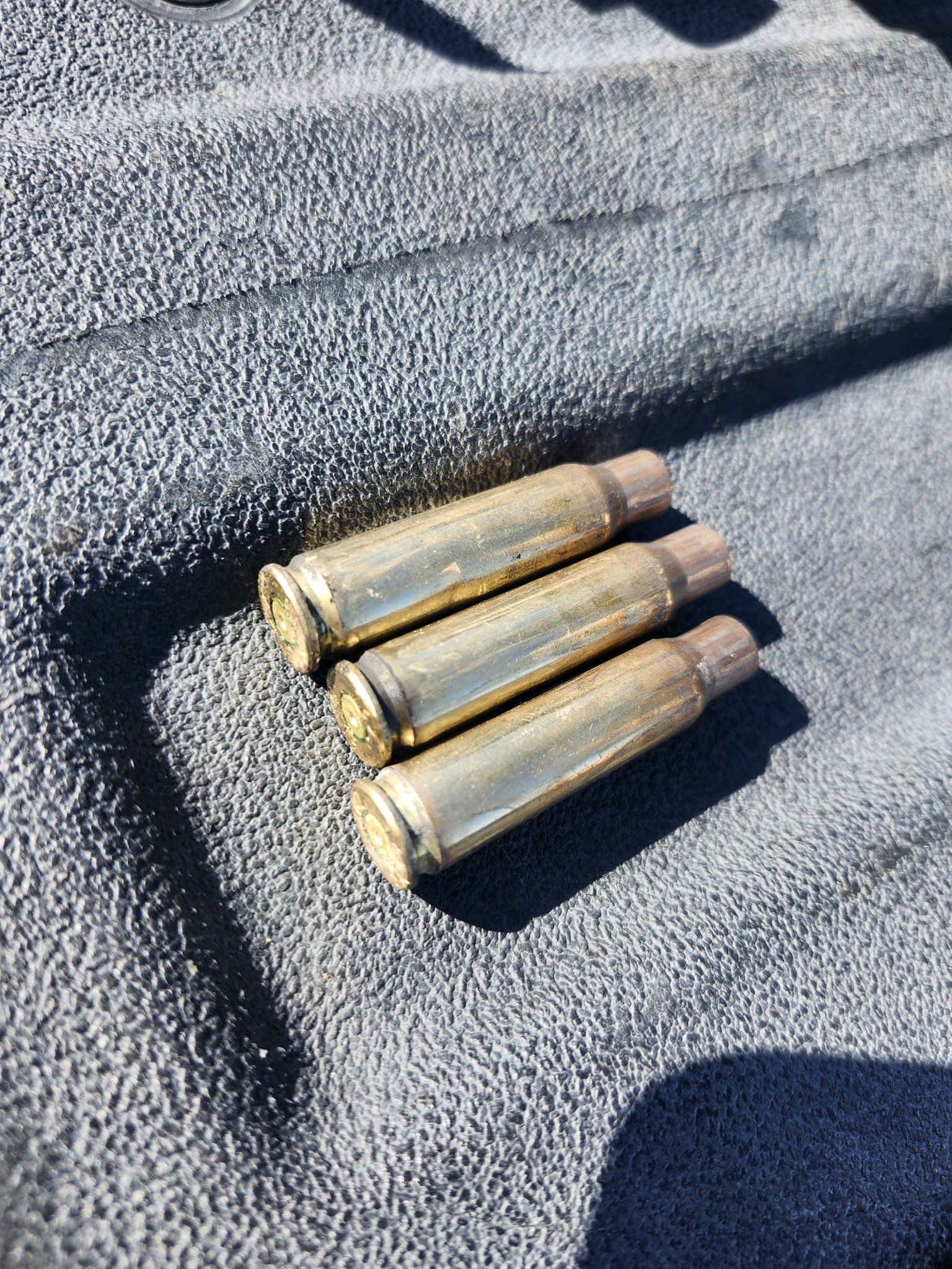

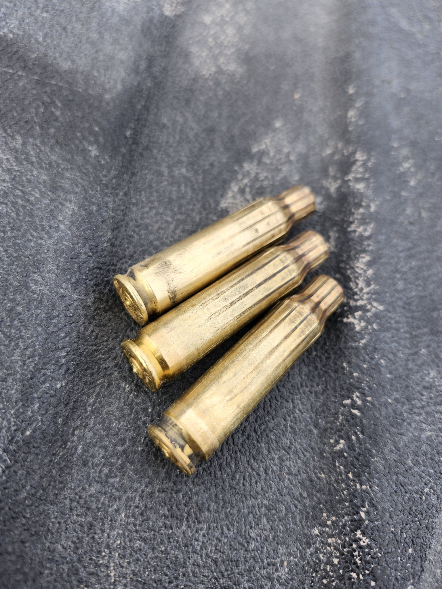

Im guessing this is over gassed?

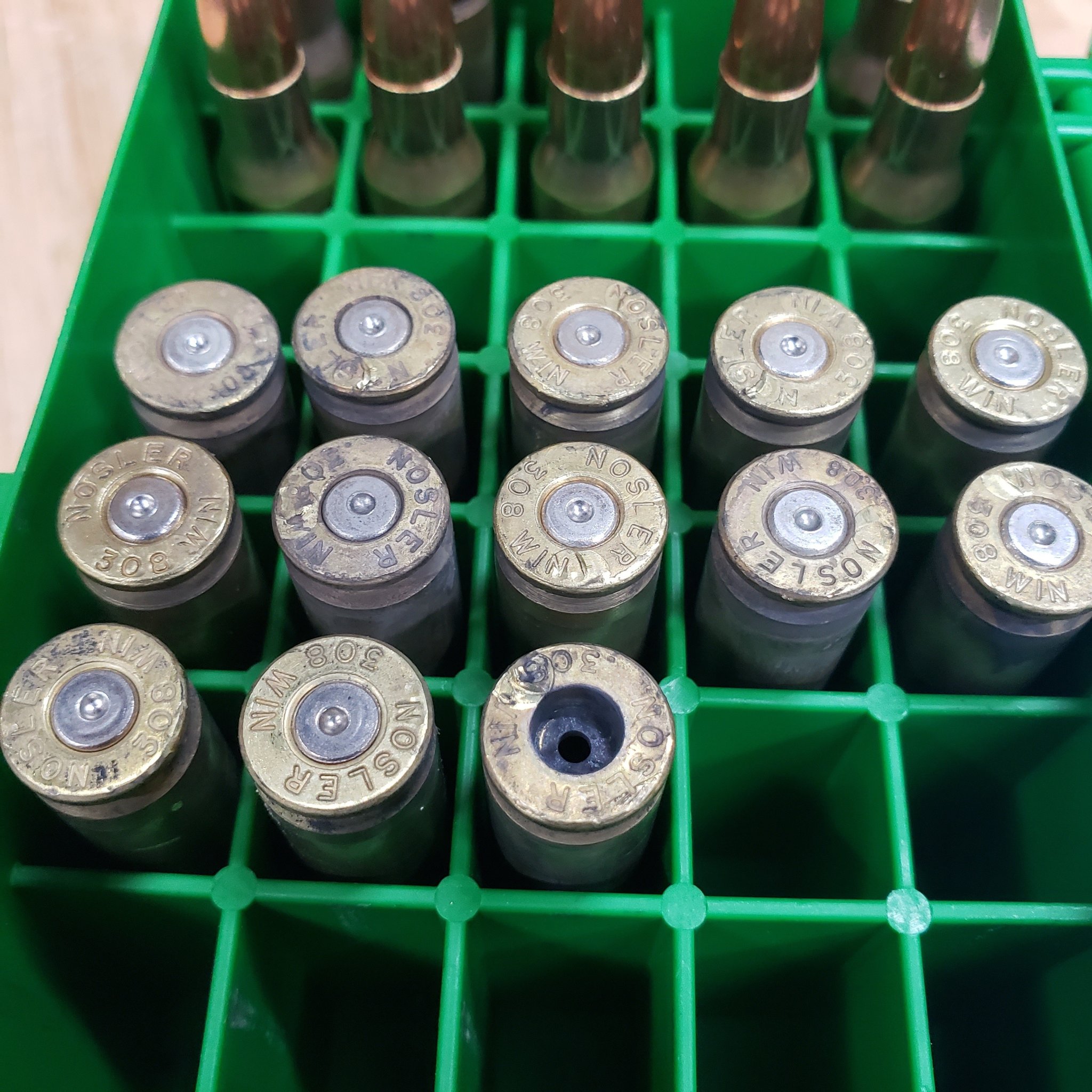

    Im at 42.9 of varget (1.1gr below book max) on a suppressed PSA rifle length, rifle buffered LR308 firing hornady 178s. Its destroying the rims. Lantac enhanced bcg and superlative arms block opened all the way. I even threw in another tungsten weight in the buffer for a total of 6.4oz. Rough chamber maybe? I scoped it once and don't remember seeing anything out of the ordinary.

    I used to run 44gr of Varget in an 18" bolt gun with 175SMKs. So this seems to be in the range, but brass can have can have wildly different internal volumes.
    How many rounds through the barrel? Have you bore scoped to see if there is a carbon ring? They can cause massive pressure swings.
    A couple of those rounds have very clear pressure signs with the brass marked up and primers flattening.
    I do sometimes run 8208 loads in a 5.56 hot enough to flatten primers but there is a lot less powder in those charges than a large frame AR. I would be backing those down at least a grain.
    So sort story, over gassed but also over pressure.

    You are over max in my reloading manual, which states 42.4 gr.
    Drop the charge to 40.5 gr and try...your problems should disappear, make sure your not jamming bullets into the rifling.
    Appears 41.3 would be a good max for your rifle...and this brass.
    Some lots if Nosler brass are soft in the case head, some old lots only lasted one firing in a bolt gun.
    So try another brand of brass, Lapua is expensive but I use it in auto loaders, ...sometimes, as it has harder cases heads.
    is that primer blown out of the case or just deprimed? That would be way over pressure.

    Like the gents above suggested, I believe you are simply over pressured for that particular barrel/chamber.
    Nothing in your pictures or description would make me think this is over gassing your system.
    You mentioned that the rims are getting destroyed. Technically, your rims look fine. I don't see anything similar to rims that were torn off by the extractor, which would point to over-gassing and the bolt trying to extract before the chamber pressure drops.
    You are destroying primer pockets and getting brass extruded into the ejector hole which is destroying the case head. To me that is pure pressure indicators.
    No need to measure your gas port. That will not fix your problem.
    No need to jack around with your GB adjustments or buffer. Neither of those are your problem.
    Get a safe and well behaved load THEN tweak your gas system if needed, which will likely be fine as is.
    It doesn't much matter in the least what the reloading manuals say or what other peeps .308s can handle. Your rifle think's that load is too hot.
    Do something with your ammo to get your chamber pressure down and the gas system will respond accordingly.
    I see. So it's just too much powder then eh? What confuses me, is how the base of the cases are damaged. I don't see any of the ejectors tearing the rims, but rather displacement of the brass on the face of the base; if you were to rub your finger over the head stamps, there are super sharp burrs torn out of the face. How does this happen?

    Ok, did an experiment because I wasn't satisfied that running too much powder was the entire cause of the back of the case head getting all tore up. The ejector and extractor in my opinion after screwing with it, were both too tough. Pulled the ejector, clipped a coil, cleaned and oiled it, and now it's smoother and not sprung as hard; didn't see the necessity of throwing cases into another dimension. Pulled the ejector and seen it had not only a high spring rate spring in there, but the top hat AND TWO donuts on the thing. Why? Was this a mistake? The thing was sprung WAYYY too hard. Threw a light polish on the claw, ditched both donuts, and now it feels pretty normal to me. I then went to the superlative arms gas block and turned it almost all the way off, to I think just 6 clicks open, in the restrictive mode. I then ran a 10mm bronze brush in a drill through the chamber and it came out clean as a whistle. Super smooth now.
    Now, I went back to that same brass, cleaned up the faces of the bases with a little light sanding, and reloaded another entire ladder starting with just below the load that began to cause the brass damage; 43.4 grains of Varget. Loaded 43 to 43.8 in two tenths grain increments and the damage to the case face is minimal to non existent. Very pleased to see this. They also didn't get as carboned up either. They still got dirty but not like before. Going to try this one more time, (should have thought of this while I was at the range) but will shoot this load with the gas block totally closed off, to eliminate any possible violence from the bolt ripping the case out of the chamber possibly too fast or too hard. We'll see what if any damage is done to the brass then. Love these experiments.
