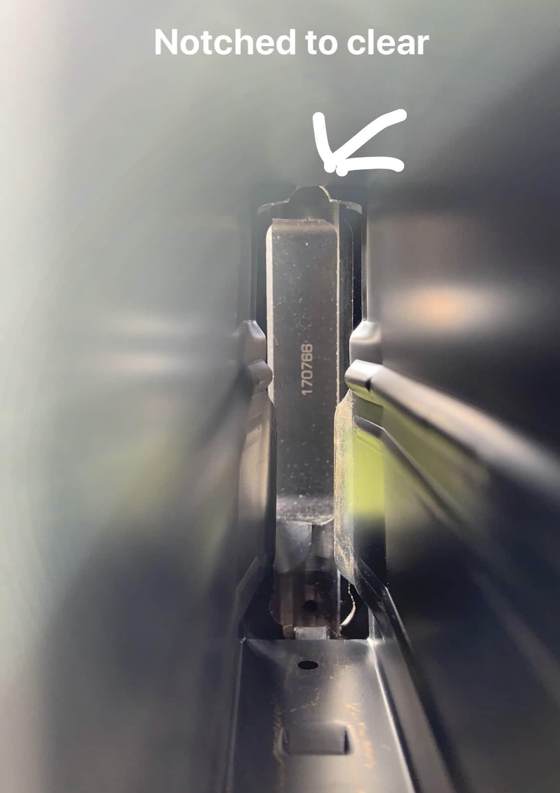

Unfortunately I have to use the binder plate style. I only have one of the metal mags. It measuses at 2.890"
Seriously though, if it is indeed that much jump, dont sweat it. Most bullets go in and out of accuracy as you move farther out. The locations seem to vary. Do Mark Gordons length test in lengths that fit in your mag, and you will find something.
Reactions: louu
Get the dremel out and make space to clear without a binder plate. Or jump em a mile and hope it works better. But I’d test and see what’s best shooting then work to accommodate that rather than handicapping myself right away.
