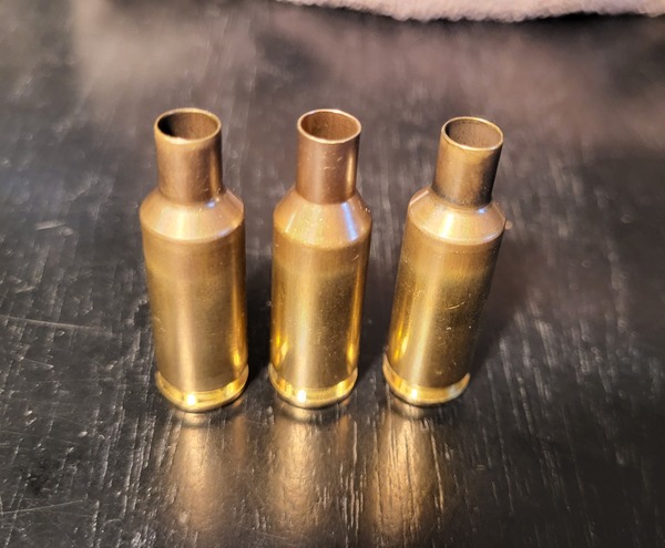

Two pieces I fired today, along with a new piece
Sort of hard to get a good comparison on the shoulder from that angle, but it looks like they’re coming out just fine. If they come out like that with a lower charge and less extraction issues “you’re Gucci fam”
As an aside, 2.25 is about 150k shorter than I ever loaded any BRA (with 140fb). So unless you had a zero freebore varmint reamer, you can probably move that out. If you are touching at 2.25 or so, I’d hesitate to go straight to the benchrest guys loads in the 29-31 range. They’re loading jammed(or close to, generally), but with 200k more powder room.
