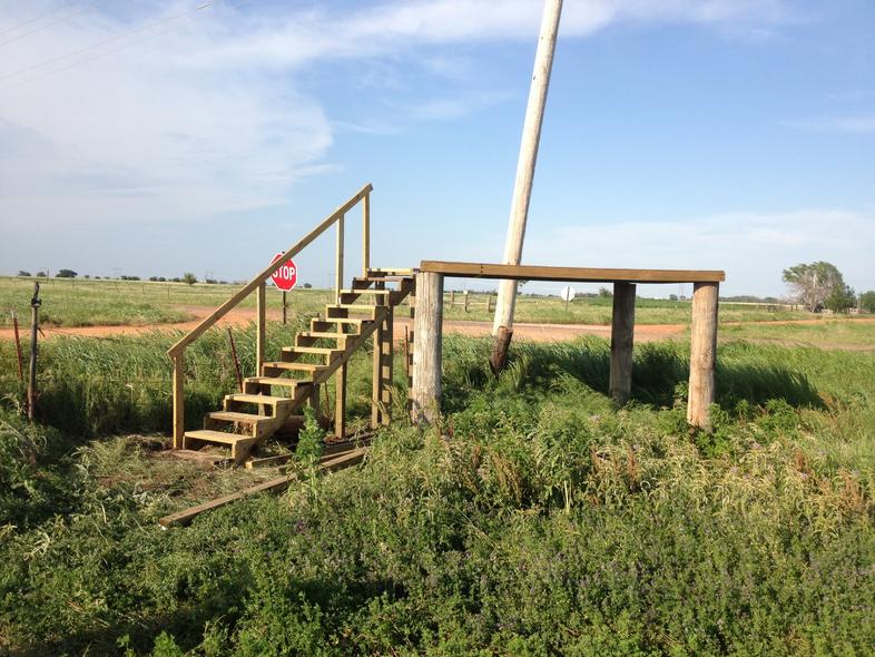

I'm making my own range, yesterday I made a nice (I think) raised 8x8 shooting platform.

A business partner of my father is graciously giving me command of a pretty large CRP field to make my own range to create videos on. Yesterday a few buddies and I made this platform. It's steady, level, and just under six feet high. Should help get out of the mirage somewhat. As soon as I get some targets it's time to brush hog and make some berms, then get to shooting!
All the supplies loaded into the truck:
Creating the frame:
Legs are all braced with plenty of support from the outside as well:
Frame up and in the bases that we leveled out
Joists and joist hangers in place:
Laying down the top boards:
Needs another board...they weren't as thick as advertised :(
98% done, just a few more screws and boards next time we come out!
Pretty nice view from up top:
Hope you guys like it! Hopefully will have everything else set up in a few weeks.
Looks nice, I'm jealous! A couple of pointers though. First all dimensional lumber is sized by the rough-cut dimensions. For example a 2x4 will measure 1-1/2 x 3-1/2 inches. It appears you used 5/4x6 deck boards which should measure 1"x5-1/2"
Now on to the screws, for best strength you should stagger the screws/nails, meaning don't put 2 in the same grain line (where you screwed the 2x bands to the posts, just stagger them a bit).
I look forward to some pics of the berms!
those blocks are called deck blocks (at Lowes at least, last time I bought some), available at lowes, hd, etc. 2x lumber can stand on edge in them or 4x4s can stand upright, genius idea
I second the motion for a roof!
my only suggestion is to take off the 2 cross braces and put them on an angle from the bottom of the 4x4 to the center of the 2x6 then the same on the other side. what you have will probably work but if by chance it does fall, it could be dangerous with a loaded weapon. other than that I cant wait to see to the finished range
Needs more barricade.
Be ready to reinforce the concrete blocks in the bottom after a few rainstorms. They are going to sink a bit and can cause all sorts of support issues when they do.

If you wouldn't mind...how about posting a material list? I'd like to have something like this on the ready. ;)
4 concrete blocks 4 4 x 4 posts, 7 or 8 joist boards ( he had something huge like 2 x 10, you only need 2 x 6) a bunch of 2x4 or 2x6 floor boards and then his little braces that don't brace properly ( no offense to you tyler)

Looks like the consensus is I need some diagonal bracing, it seemed really solid to me but I'd prefer it last.
I could provide some targets for a day in exchange for some trigger time...........just say when ;) Columbia, correct? I think I may have some spare lumber for the cross bracing/ thingy/ whatever!
Its to late now, but if I were to have built that platform I would have gotten really long 6x6 instead of 4x4 and continued them all the way up and just build a roof off of them. I would have gotten like 12' long ones or maybe even 16'.
At this stage I would just buy an easy up, they are about 8x8 and rig it up there when you are there shooting and then take it home with you. Most of the legs have holes in them for stakes you could get some fasteners(not sure what they are called) that screw into the wood and then have threads on the top. Its similar to all thread, but the bottom portion is designed for biting into wood and it has a small section in the middle to put a wrench on it to turn. Then just grab some nuts to fasten your easy up to the "bolts" in the wood.
Oh and I just saw that you are in Missouri.... Where abouts? I am in St. Louis, but dont mind driving a bit for some long range shooting. Im always good for buying steaks and cigars.
Suggestions…
diagonal bracing! otherwise it could rack and fall down.
… WILL FALL down, over and or get racked, losey-goosey). Run a diagonal from "top" of each post to somewhere slightly below the middle of the next corner post. Repeat three more times.
Deck screws will not stay tight for long, gonna need pairs of 3/8" (1/2") bolts/nuts/flatwashers to connect rim joists to each post.
Suggesting a diagonal 2X6 UNDER the floor joists to prevent racking the deck.

Do add diagonal braces for structural rigidity. You may want to consider anchoring the corners with those screw-in anchor rods used for deer blinds and temporary antenna towers. A brisk surface wind may cause you some grief.
Cover/Sunshade: Unless you want something permanent, consider using electrical conduit for supports. It's relatively light weight for the diameter/section, and coated to prevent rust. If you want, add pulleys and a halyard to easily raise the cover. You might consider greenhouse sunshade for a cover. It is not waterproof and allows air flow, but will keep the sun off the deck. Don't forget side curtains when the sun is not directly overhead.

For me, it's a cross between the 'easy-up' shade tent thing, or the 'longer 6x6's and a permanent roof. Only thing I'm gonna do (when I build a tower of my own one day) is put an oversize roof on it, similar to a Control Tower. Simple because, unless it is 12 o'clock noon, all that "shade" you're creating is only shading the grass on the ground below you.
How much off-hand let alone 'bench' shooting are you going to be doing from that platform? Do you need an 8' ceiling?
Yeah, "choker" bracing.
A single diagonal under the joists and an opposing one at the base should be plenty.
As for shade, 2x4's longer on the vertical in the direction of fire, shorter behind, and a 12'x12' tarp, some eye hooks and bungees
