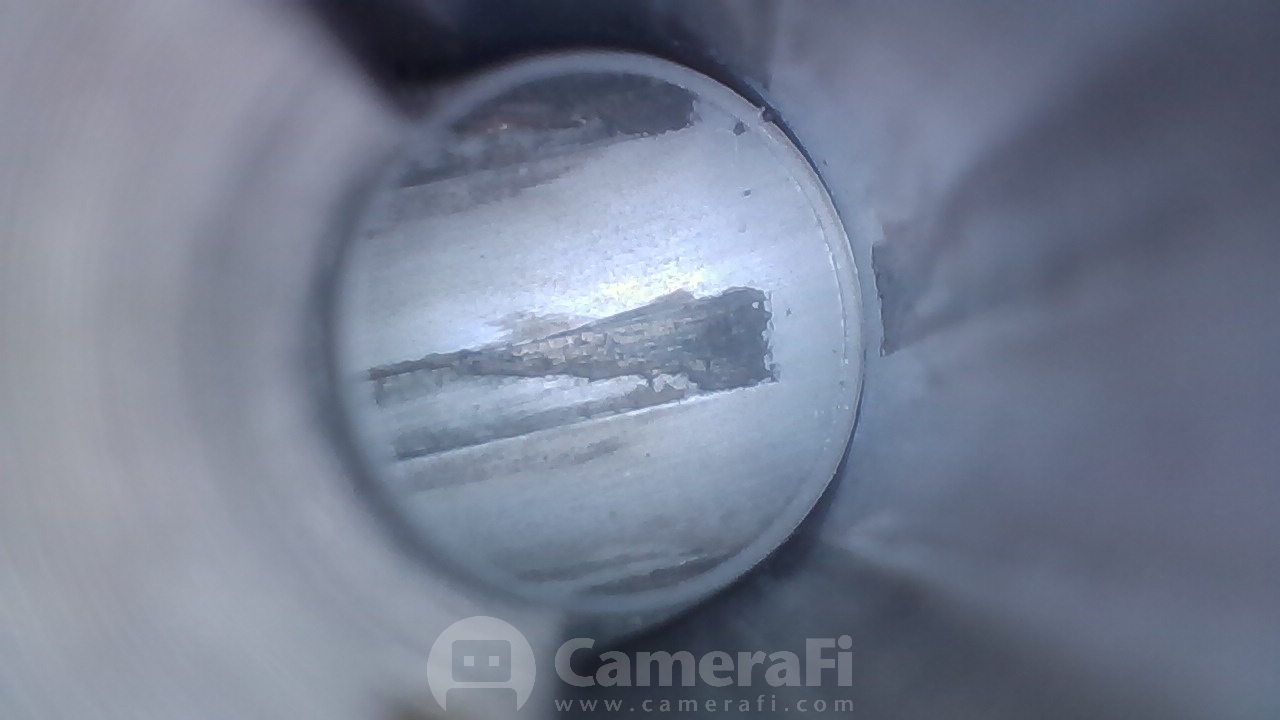

I can feel the cringe the title illicited, but it's also true. The beauty is, that I know I am ignorant, I know I do not know what I am looking at, and I'm curious and willing to learn. This is the first barrel I've borescoped, and am curious how it looks to someone who would know. My perception of what I'm seeing is captured in said video, right or wrong.
I'm happy to be educated.
Offset in what way? It is a 5.56 chamber.
look at where the lands start
Maybe it’s the way you move the camera but some appear longer than others.
that means the reamer was not perfectly square and/or concentric to the bore.
It’s not rare on cheaper barrels and factory barrels.
If your spending $700-800 on a barrel from a highly skilled and detail oriented smith then I’d be kinda miffed about it.
It’s definitely not a guarantee the barrel will not shoot well.
It takes time and expense to fixture up a barrel to less than a tenth of of the width of a human hair.
Time=$$$$$$
Shoot it.
That’s the real gauge of a barrel.
The other thing you'll see in hammer and button barrels is the lines the run perpendicular to the bore axis. On a cut (or buttoned for that matter) barrel that has been lapped, you'll just see smooth lap marks that run in the same axis of the bore.
Unless there's a giant goof in the rifling somewhere, I mostly don't even worry about the length of the barrel. Most of what I'm looking at is from the neck forward about 6-8" to monitor fire cracking, throat wear, etc...
On a new barrel, the same probably applies, look for jagged/uneven machining in the throat, rings in the chamber, and in the case of AR's, gas port location (looking for burs mostly).
Looks like a good factory AR-15 barrel.
ETA: I'll echo Steel Head insomuch as I wouldn't get caught up with anything you see unless the barrel doesn't shoot (or it's just outright fugly). Proof is in the pudding. I've scoped a factory rifle that had shallow rifling running all the way back to the neck on one side of the free bore and it still (somehow) hammered.
Reactions: Steel head
I see it now. Does this mean the chamber is not concentric, or will this affect barrel life or bullet stability through a suppressor? The barrel is hammer forged, cut chamber.
Will not affect barrel life, stability, nor exit through a suppressor. Only has the potential to degrade accuracy. It's not the worst thing I've ever seen. 100% would test fire it first because it might not matter at all.

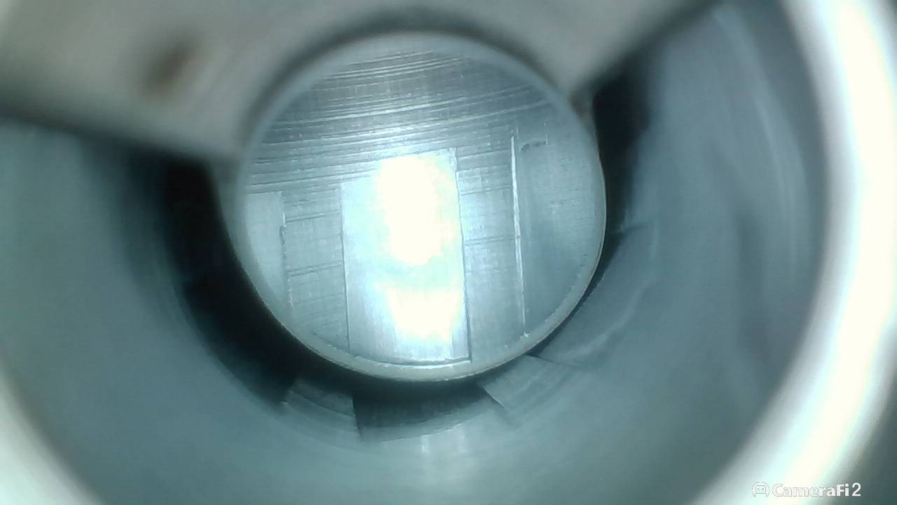

Question...how "clean" should one expect the leade to be? Is this looking good, or rough?

be more fun to repeat that video after you fire a few thousand rounds a before and after type of deal .

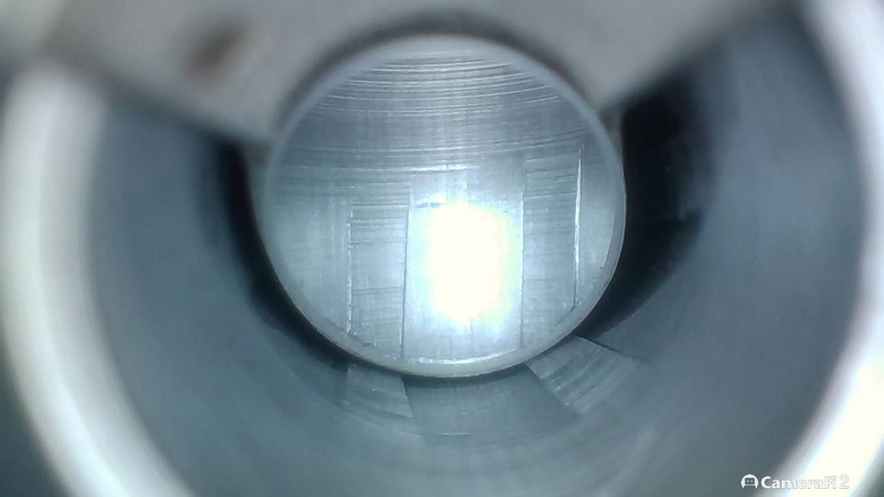

This is a similar barrel, except 14.5 middy, after about 1K rounds.
looks pretty nice.
Chamber appears to be slightly offset from the bore but my first Shilen was like that and it was an amazing barrel.
What did you see that made you think the chamber was offset? Looked pretty normal to me, but I'm an idiot, so there's that.
What an I looking for?
OP the barrel looks great, very smooth and well finished from what I can see
