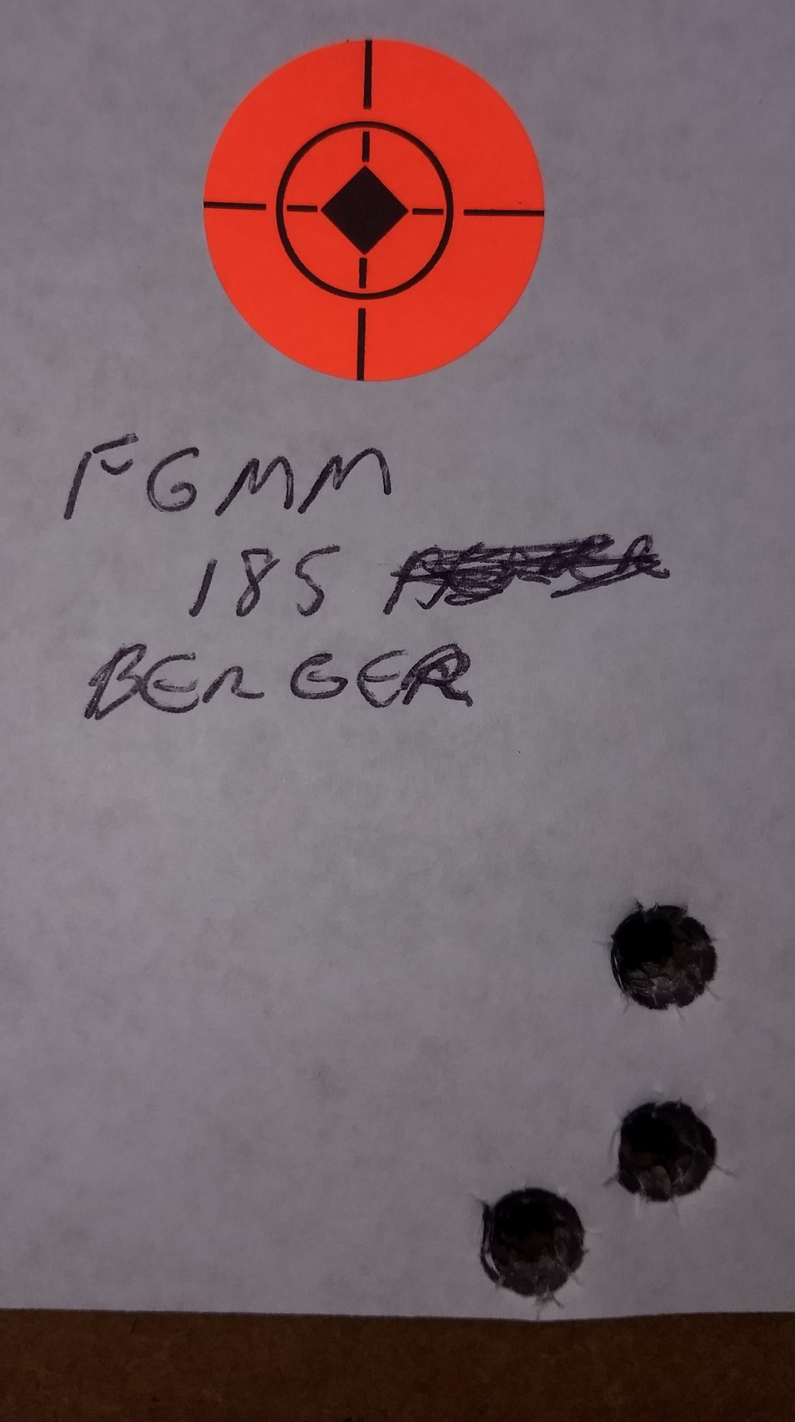

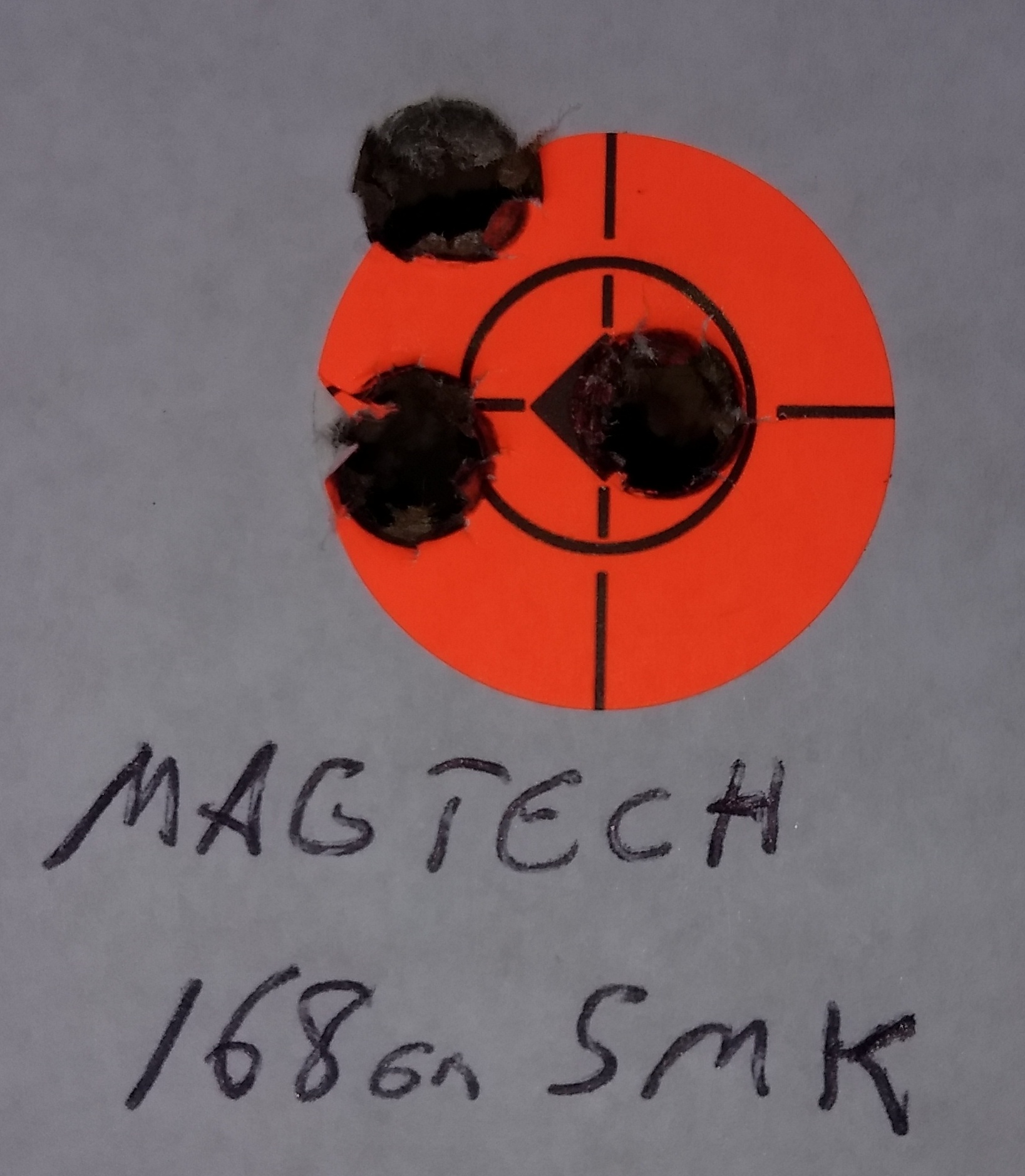

I've been shooting for decades, and I'm lucky enough to live where I can shoot out to 700 yds or so on my own place. Most of my shooting is done without much prep, and usually over the hood or bed of a truck at coyotes, hogs, or other game. Whenever I get a new gun, I usually sight it in at 100 yds with the round I think I'm going to be shooting with it at all times. Today, I thought I would seriously compare three different rounds since I was looking to go up in the bullet weight. The gun is a Savage 110 Tactical, 24" barrel, 1-10" twist, 308 WIN. The rounds were:
(1) Federal GMM, 175gr SMK
(2) Federal GMM, 185gr Berger
(3) Magtech 168gr SMK (The gun was originally sighted in with these, and the round I usually shoot)
The conditions were a slight intermittent breeze, 73 degrees, 90% humidity. I don't have a bench rest vise, so I was shooting over bags using a very solid wood bench that I built. I let the barrel cool between each group of three. In order, I fired the Federal 175s, Federal 185s, and Magtech 168s. As I stated earlier, I usually shoot the Magtechs, and have shot them at targets out to 700yds with no issues. The target is a one inch orange sticky at 100 yds. I was surprised at the results. Any thoughts?
7066290
7066291
7066292
I’m not 100% sure what your question is. It is not at all unusual for different bullets to have different points of impact. In the case of the 185 Berger Juggernauts, they are 18gr heavier, and not nearly as fast. If you could ever call the .308 “fast”. ? Point being, different brands, different weights, different POI.
Nothing I see looks strange at all.
Also of note is that shooting 1 group of 3 shots is statistically nothing. Not enough rounds to even register a blip. You would ideally need to shoot 5-6 groups of AT LEAST 5 shots each to start to get a feel for the gun and ammo’s abilities. Many folks will say 10 shot groups. My opinion on those is that it gets difficult for many shooters to maintain everything perfect for 10 shots in a row, so human fatigue becomes a factor more than just the gun/ammo. Shoot a 5X5 with each type of ammo you’re considering. Then you’ll start to see trends and patterns that give you enough info to start making decisions.

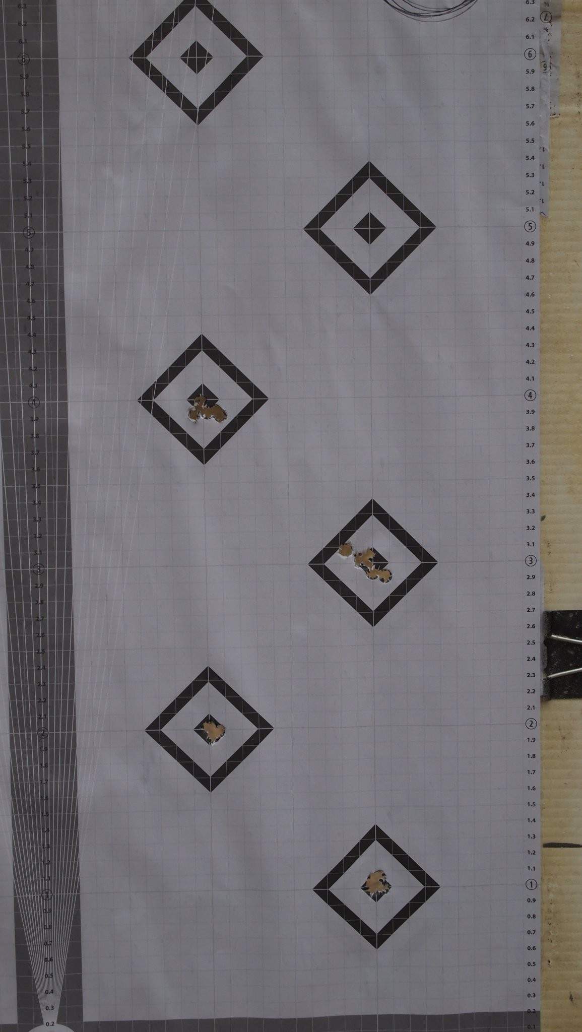

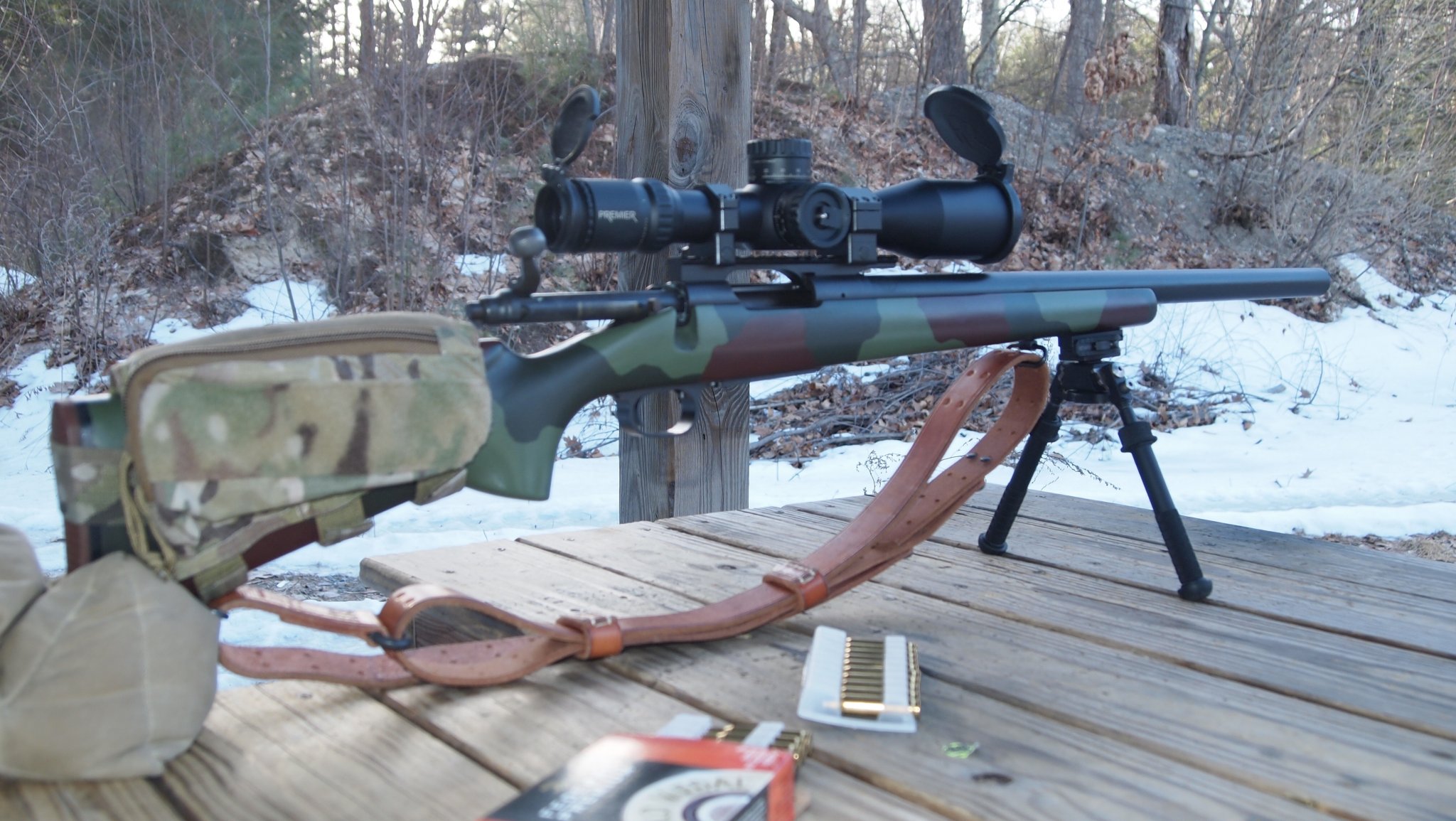

This is my last shooting outing with my "Billy Baroo" M40A1ish using 175 FGMM .308 at 100 yards. The inner circle is 1 inch, 5 round groups.....
If I should jump to conclusions your Fed ammo is fine and something is wrong with your rifle based on my results.
168s often show better short range accuracy for me......but over distance I take the advantage a heavier bullet provides and suffer that small loss of accuracy at 100.
I have found the exact same thing. Usually 175-185’s give up some to the 168’s. However, the 168’s tend to go sub-sonic between 800-900 yds. Not only that, but 168’s do not handle the transition well at all. They tend to get very erratic at 1000yds. Like hit a foot left, correct that, and hit a foot right.
I’ll give up the .2-.3 moa accuracy at 100 yds to be able to shoot to 1000.
And, that was my intention of trying out the heavier bullets. I wanted more stability at the greater ranges. After measuring, the FGMM 175s grouped at 1-3/8", the FGMM with 185 Bergers grouped at 7/8", and the Magtech 168s grouped at 9/16".
I guess I shouldn't complain. I shot close to 1/2 MOA over bags with ammo that cost 62 cents a round. That almost makes it not worth reloading (almost.) I was expecting the FGMMs to perform better than the cheapo Magtechs. I was also going under the assumption that the larger the group at 100 yds, the more of a "miss" at long ranges. Of course, I was aware of the lack of performance of the 168s at extreme ranges. That's why I was looking at the heavier bullets.
