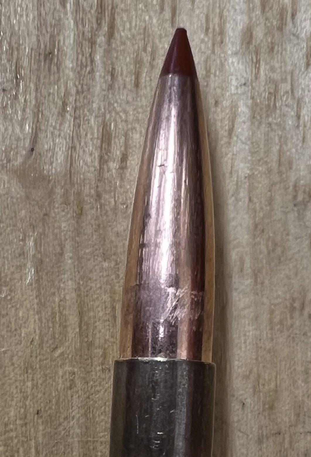

Defiance action with Bartlein barrel. 175-ish rounds on it. I bought it used (safe queen bought 10 years ago from customer maker and hardly used) and I have only put 15 rounds on it. Original buyer had 160 rounds on it.
All of a sudden the bolt won't close on factory 140 ELD-M ammo. If I really force it, it will barely go, but it takes an insane amount of force. When I extract the round, there are marks all over the bullet (see pic at end).
My handloads are all 140-ELD-M. I made one just for grins with the same results. It will chamber and extract new or fired brass no issue, so the binding is definitely at the bullet. Remainder of the action is smooth. It runs fine with nothing in it obviously, and it ran factory ammo last week no issue. But this week not so much. Can't see anything obvious with the bore camera.
This is a new box of ammo...maybe these bullets are slightly larger? It will cycle factory federal 6.5CM ammo and leave only a light mark...
Is the solution to have a gunsmith just run the reamer in on a clean-up pass?

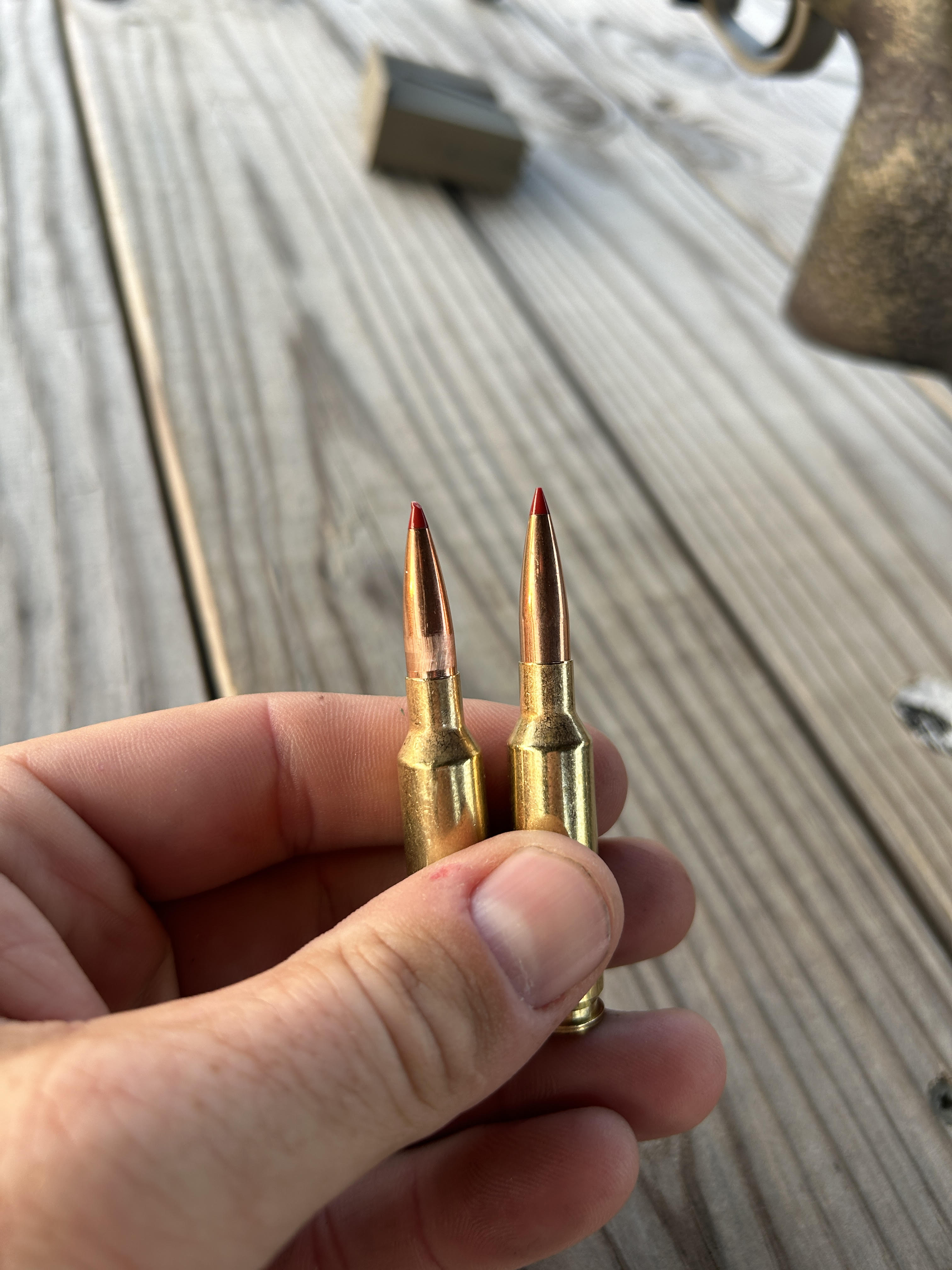

Pic of new bullet (right) and chambered/extracted bullet (left).
Have you measured the new round vs the extracted round? That is some serious engraving on the extracted round.
Reactions: Taylorbok
Carbon generally doesnt do that to copper. If it was a carbon ring I would expect some black particles to break off with that ammount of force.

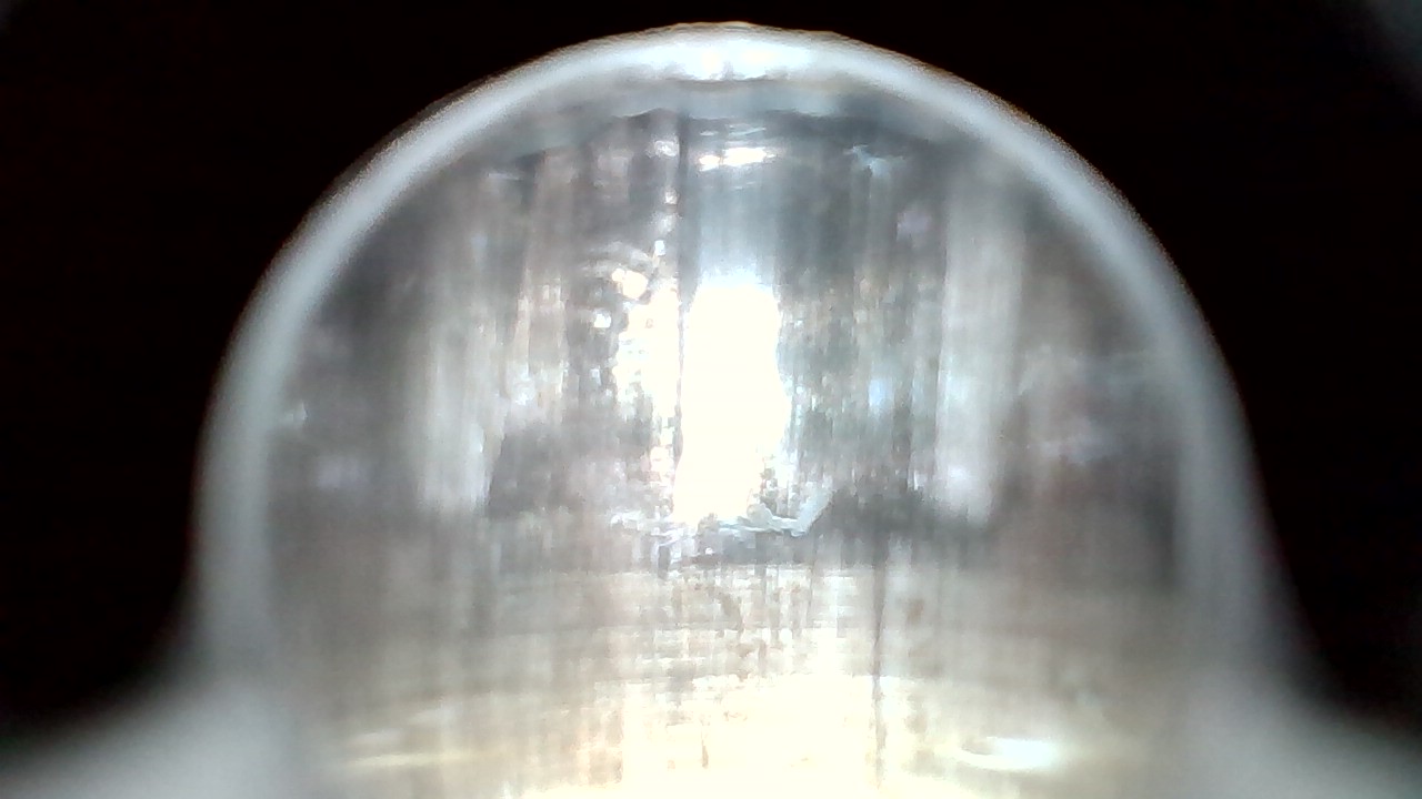

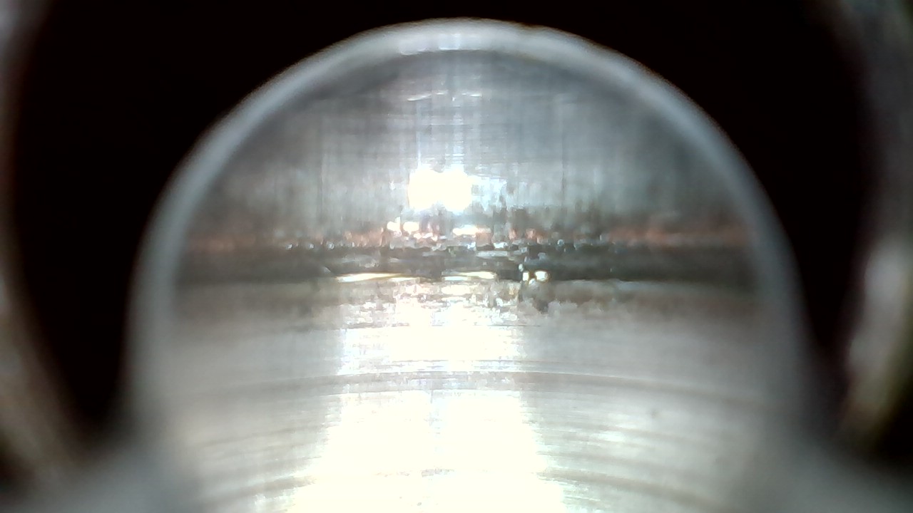

Can you place some fotos taken with the borescope showing the neck-to-freebore transition and the lead?

Pull the bullet on a known "hard to close round" and try to chamber that empty case w/o a bullet. That would isolate the possibility of over size cases, which are not uncommon.
You could have more than one thing going on.....
Usually, jamming a bullet into a tight leader or throat that hard would result in a bullet staying stuck in the bore and powder all in the action when extracting the case. Rub marks on the bullet may only be a secondary issue. Maybe, maybe not...

Looking at the end of case picture, that seems like where the copper is catching. You can see flakes of it on that edge.

Is the profile the same on the two bullets, or is there more taper on the one that chambers easily without the engraving marks? Perhaps it's an optical illusion in the photo, but the bullets look slightly different. to my old eyes. What is the diameter of the bullet just ahead of the case mouths on each bullet in the photo where the problem is occurring?

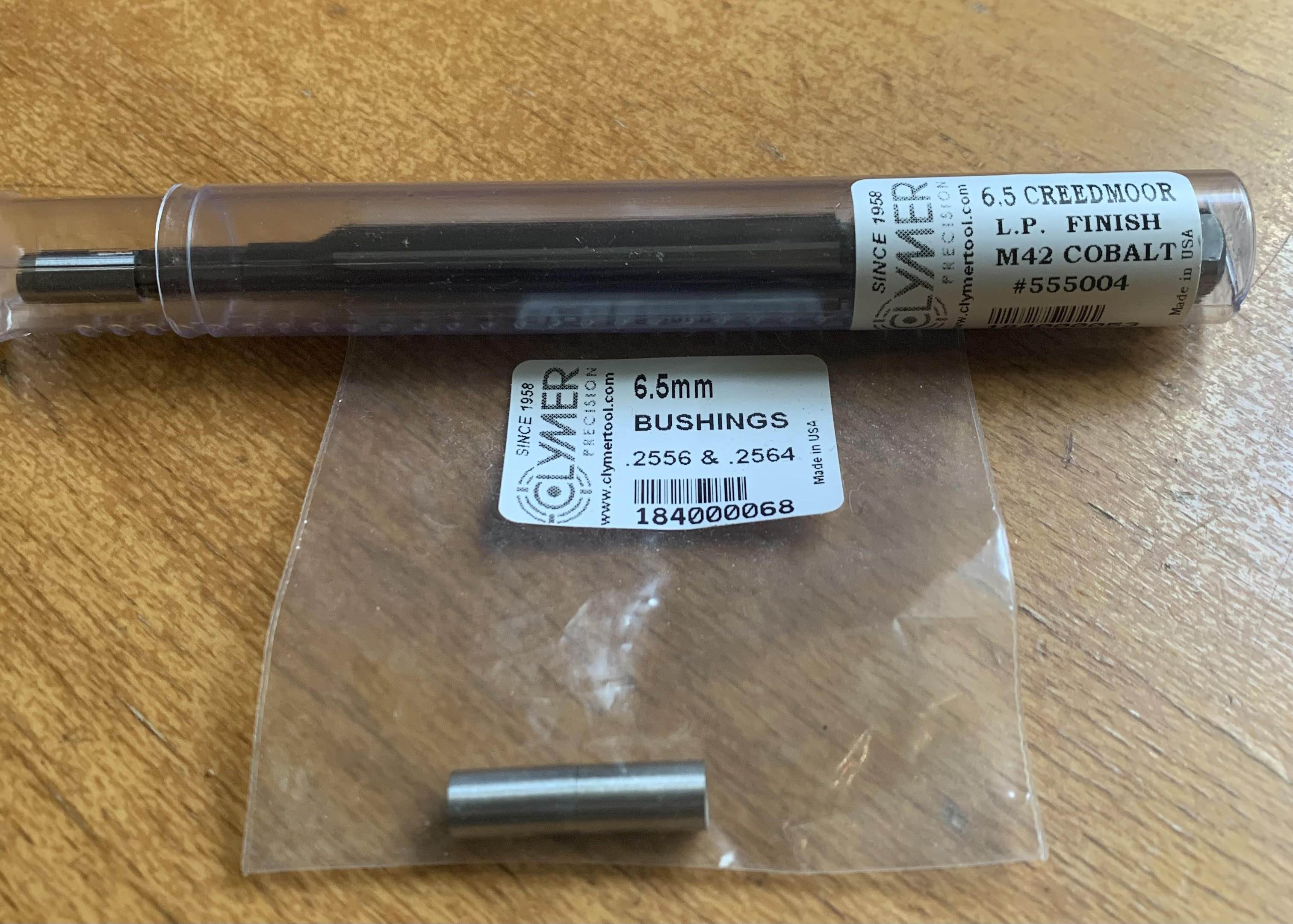

Clymer finish reamer off the shelf at Brownells with a few bushings cost about $200. I just turned by hand with a tap wrench & some tap magic cutting oil. Worked like a champ, gun hammers.
Just stop when you hit the shoulder and should be good to go.

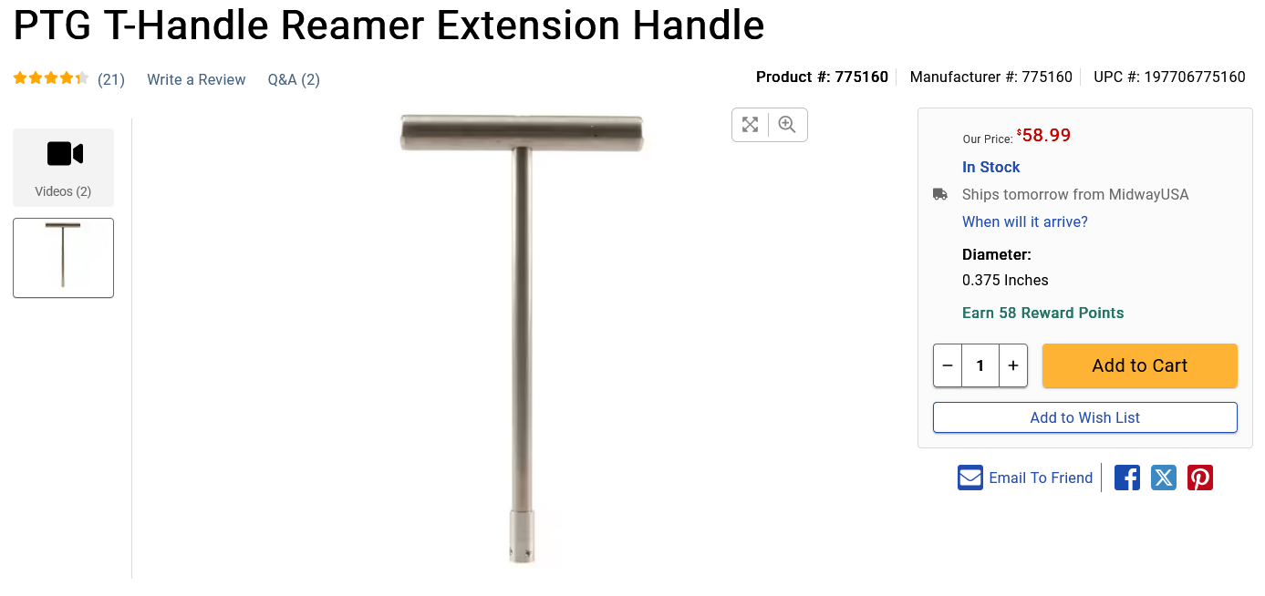

If you don't have a barrel vise then pick up one of the PTG extensions from Midway & you wouldn't even need to remove the barrel.
I have a barrel vise but no action wrench for the Defiant and I have no idea how much it was tightened and would rather not mar up the gun-kote finish. Do you have any interest renting out the tools?
Same profile
The new bullets are just slightly larger Im guessing. The reamer was probably tight in the throat to start with. I have sent back a few reamers with undersized throats. A good smith can tell you the actual diameter for free and fix it for pretty cheap. Guage pin on a magnet works, I use an aluminum rod with bore and set screw to hold pins to check that.

I had exactly the same marks on a new 6mm barrel - 6mm GT. Turns out the barrel was reamed not with a SAMMI 6GT spec reamer but more like an older .243 reamer. My guess is that they didn't have the newer SAMMI reamer for the 6 GT. Get a new reamer (SAMMI spec) and have it redone on the same barrel. Make sure your gunsmith is aware of the issue.
Image below:
Reactions: patriot07
Image below:

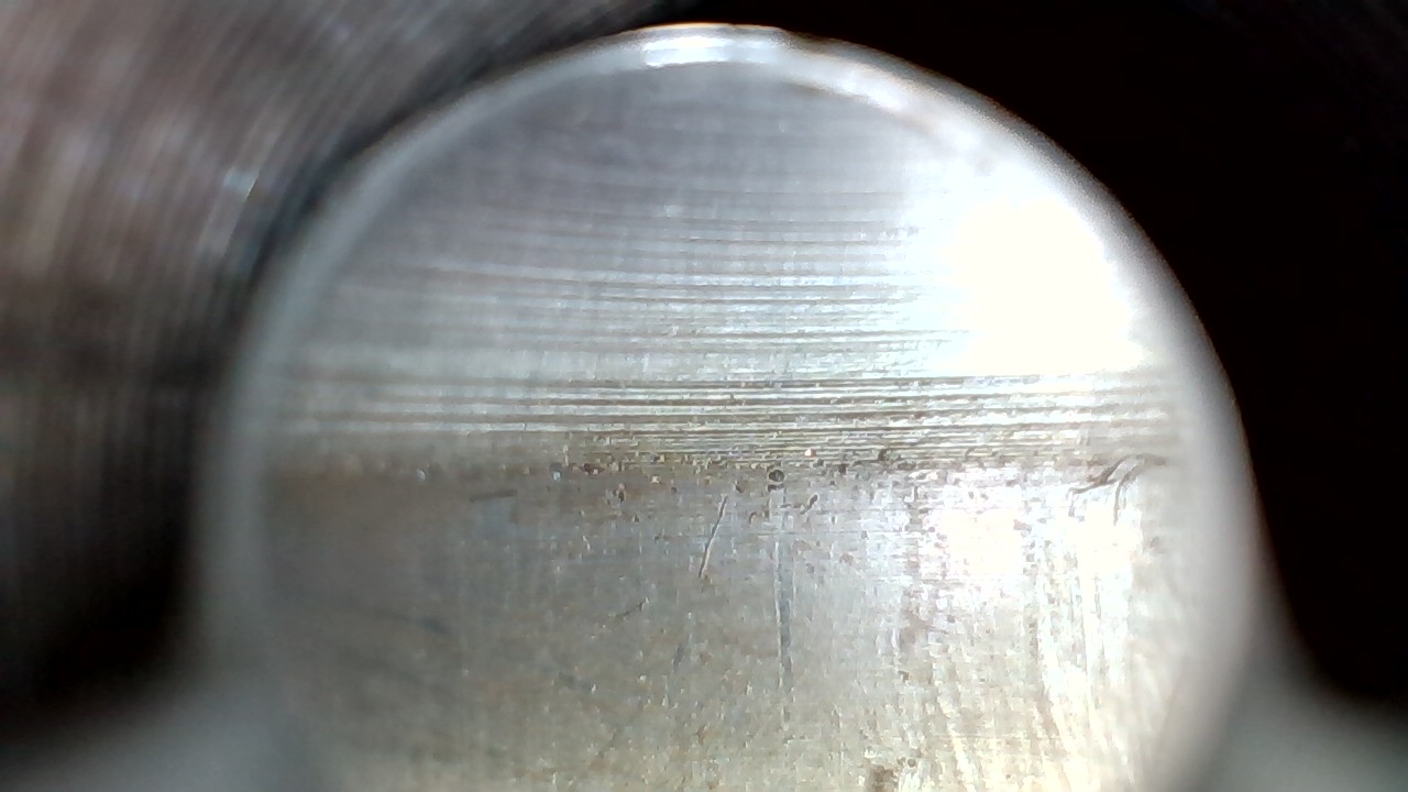

I don't know if you have a bronze brush. If you do, see if you can brush out the transition (end of case area). If not, you are going to need a lot of Boretech Cu2+ applications to remove that ammount of copper.
Doesn’t look like much of a carbon ring, if any, but you can see a lot of copper at the edge that will just get worse the more you try to chamber a cartridge.

When I saw that my thought was the copper from the bullet jacket is getting scraped off by the carbon.

That's pretty much what's going on. I think I need to just run a reamer in there to open it up to saami spec, and I think the issue will go away.

Tough call! The more you magnify you see stuff that might not be an issue.
The other hard part about looking at your pic's is.... "what did it look like before the gun had any rounds fired thru it?"

A friend has a semi-custom reamer that has been getting passed around a lot. The same gunsmith is doing the chambers but several barrels have been cut and I doubt anyone knows how many it has done. I haven't heard of any issues with it but it seems like it might be time to order my own reamer.
If you for see yourself putting multiple barrels on your gun / or guns and for the cost of say $250 for a reamer and add gauges in there as well... it's not that expensive in the long run. Also when it's time to get resharpened it's about half the cost to resharpen it. If I recall correctly we are getting two resharps on a tool.
So even if you are only getting say 10 barrels out of a tool it works out to say $25 a barrel. That being said... for the amount of barrels we get out of a tool... let's say 40...that works out to a cost per barrel of only $6 or so.
Then you have your own tool and know what's being done with it etc...
JGS Precision Tools or Manson is who we use. Get a reamer with interchangeable pilots. For example if it's a 308win. reamer and your using our barrels. I'd get a .2996" pilot bushing put on it.
If your going to use it in other brands of barrels you have to watch the bore size. If the bore is tighter or looser then just order a couple of extra bushings for it.
Just to chime in, this barrel WAS NOT chambered by Bartlein. This was done by a gunsmith nearly a decade ago.
I think the real culprit was a carbon ring and a tight chamber. I cleaned the carbon out again just for good measure and did some load development this morning. Looks like a Bartlein doing Bartlein things...thanks @Frank Green for your excellent work
Image below:
Please name the shop that cut a 6GT with a .243 reamer. Please!
Reactions: wind gypsy
Image below:
This was probably about the time the 6GT got SAAMI approval. I heard there were some discrepancies between the SAAMI approved GT and the original .120 FB GT drawings and the two didn't necessarily play nice for everyone.
