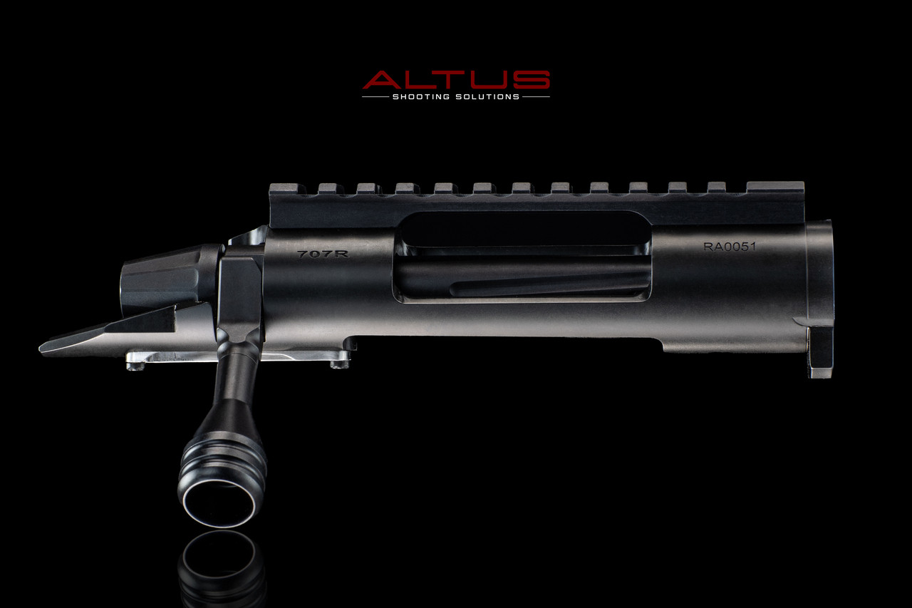

Impact 707R
Not an integral lug, no pic rail, but light weight and cheaper. Be a great hunting action.
It is an integral lug, just no integral pic rail. At that price comes with hawkins hybrid rings and the new 75 degree impact bolt. Can take any bolt from a 737r per altus. I think it’s actually a decent deal. I ordered one
Ahh, looking at it there was a line all round the receiver at the lug so I assumed it was not integral. I do trust Tate to put out a spectacular product.
Awesome. I’ll likely be in for one of those. Gonna start with the Hawkins on it but, want to try the area 419 rings as well.
Pretty excited to get one in my hands. I should have it before the weekend

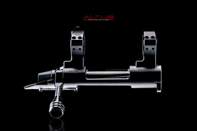

34oz for a "lightweight" action and rings?
That a misprint?
Don’t think so. I didn’t buy it for the weight alone. It’s (707r with rings) lighter than a 737 action alone😂 (3oz)

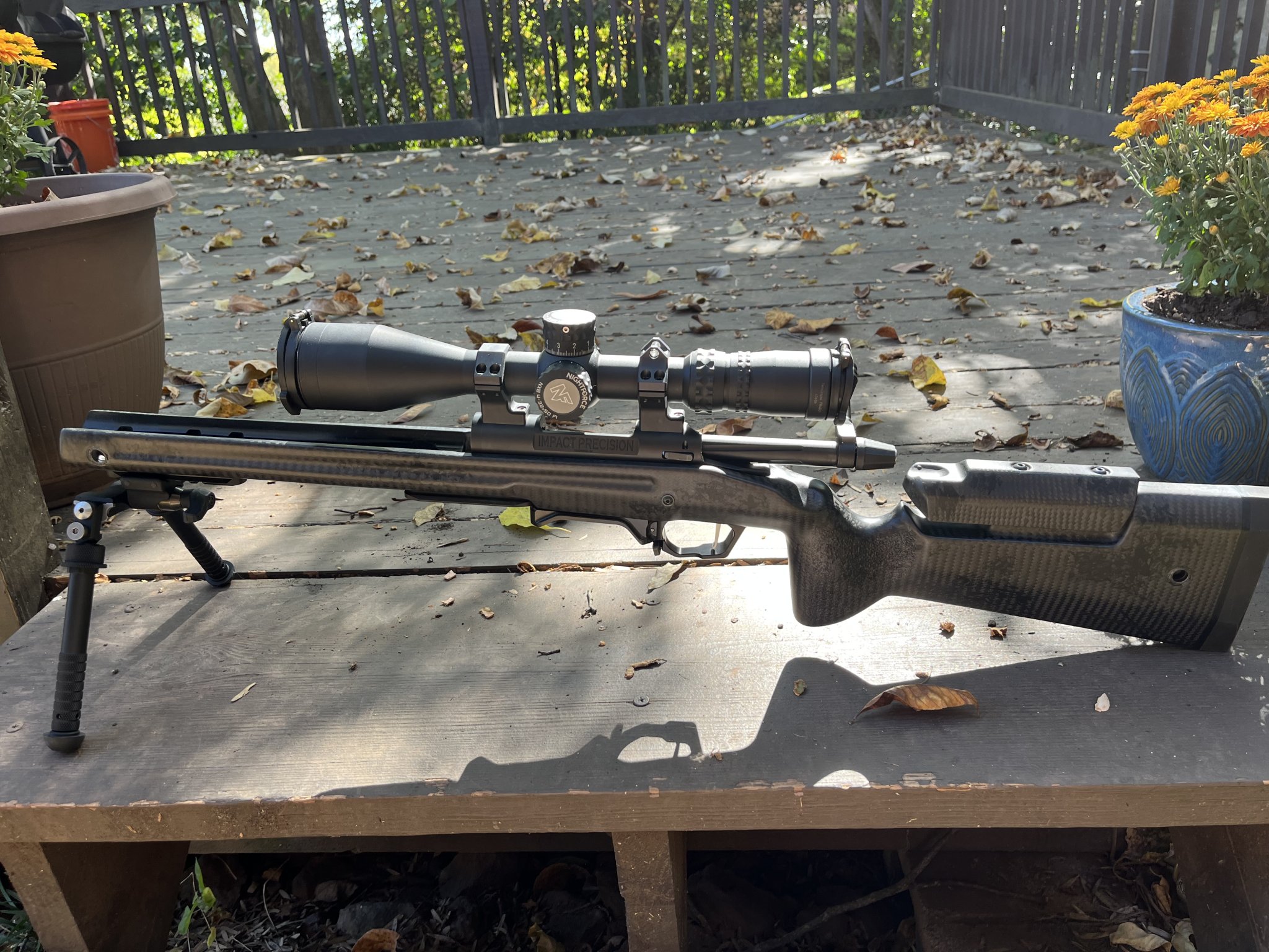

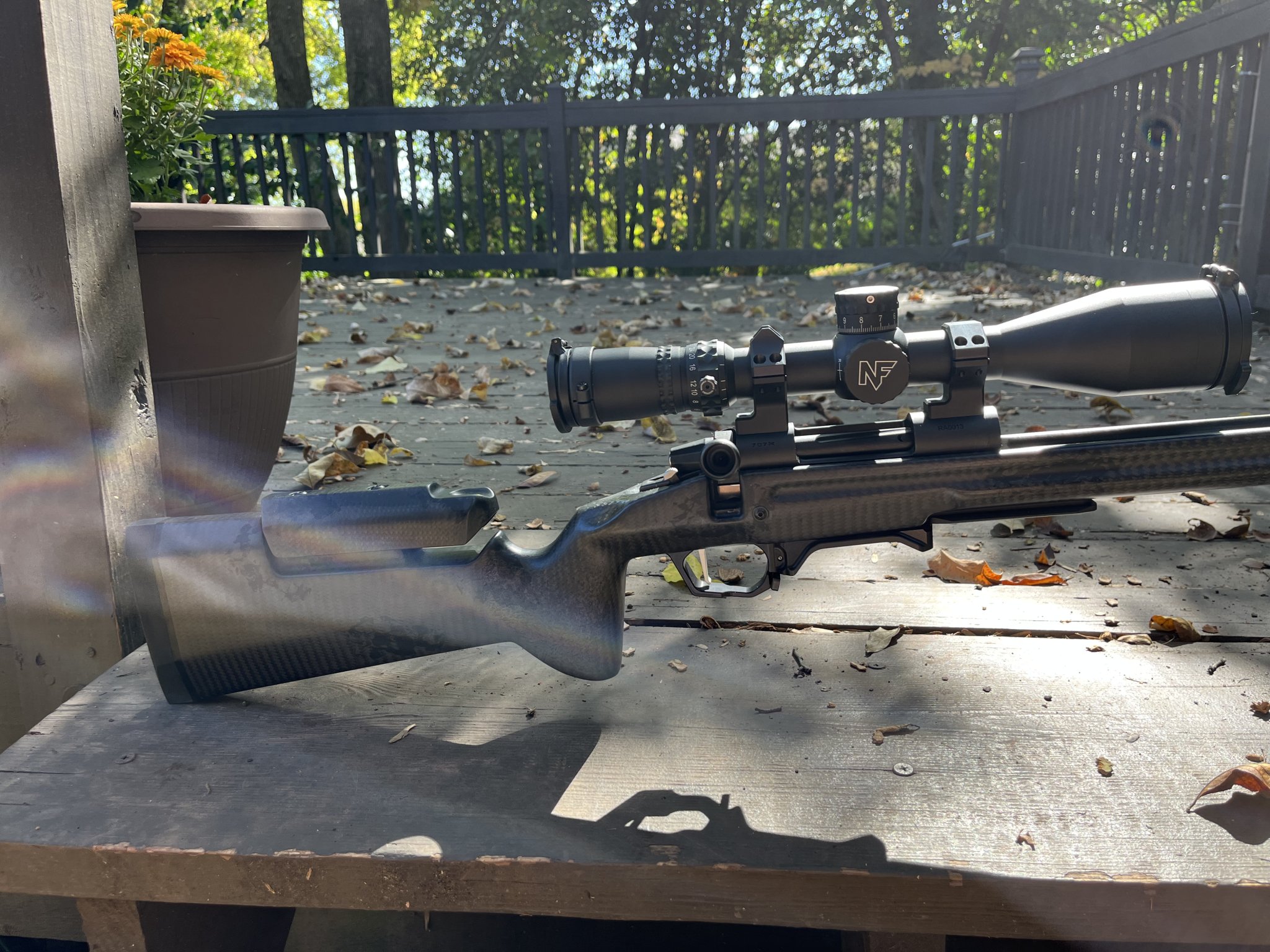

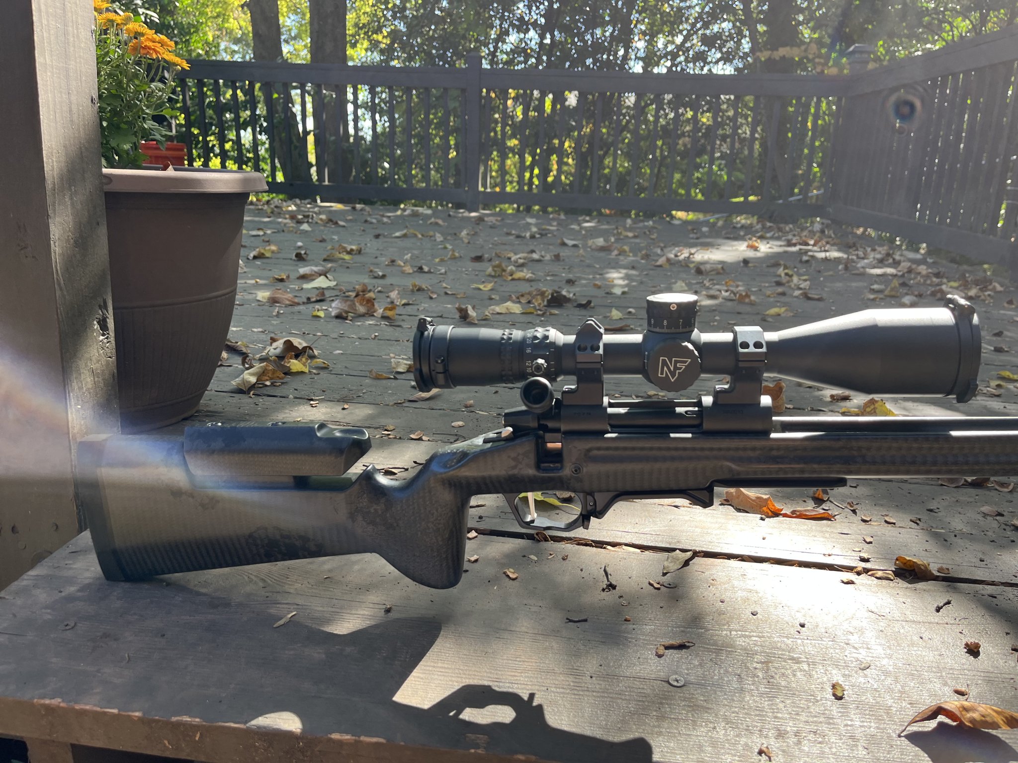

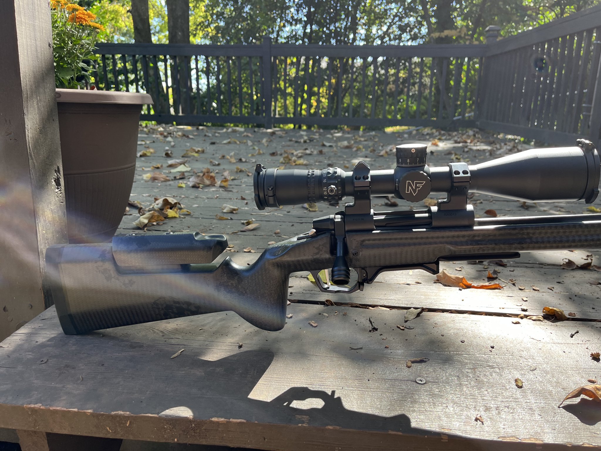

Schedules finally aligned and I was able to pick up my 707r. Same great feel, fit, and finish of a 737 but on a diet. Really awesome package and I will be getting more. My 22 creed 20” bartlein carbon barrel arrives on Monday so I will update with more pics then.
I’ve always been a zermatt/origin fanboy because of the pricing and bang for the buck. I think this may be my new number one. Once I get some rounds through it that will confirm. Action runs as smooth as my 737s, and maintains almost all the great features. I did throw one of my other barrels on and it headspace’s and timed near perfectly. Not saying they always will, but in my one of one it looked like it was cut for the action

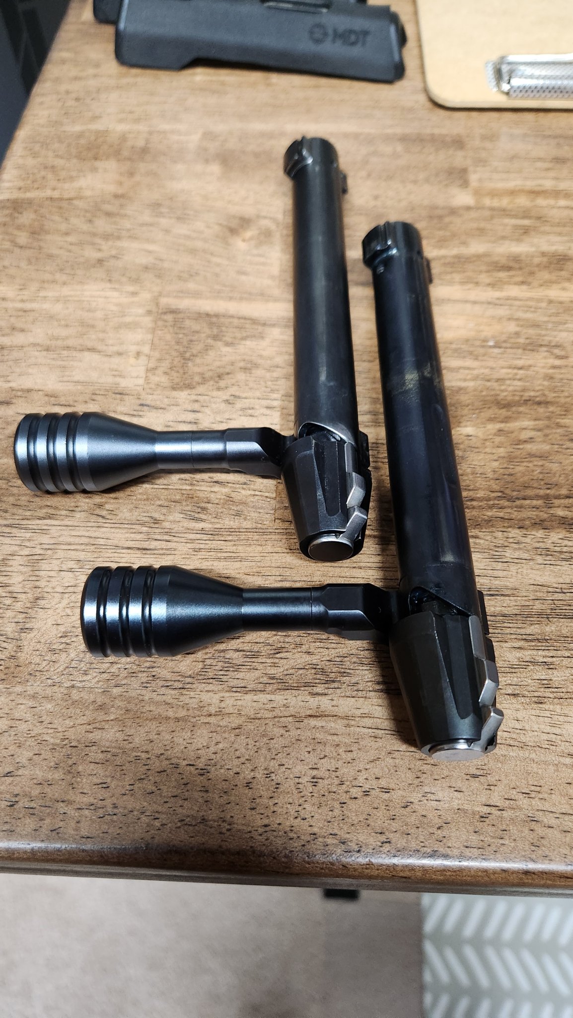

If you're comparing a new 90 and a new 75, for all intents and purposes they feel identical in my opinion. The 90 feels ever so slightly lighter but not by much. Both new 90's and 75's are heavier than old 90's.

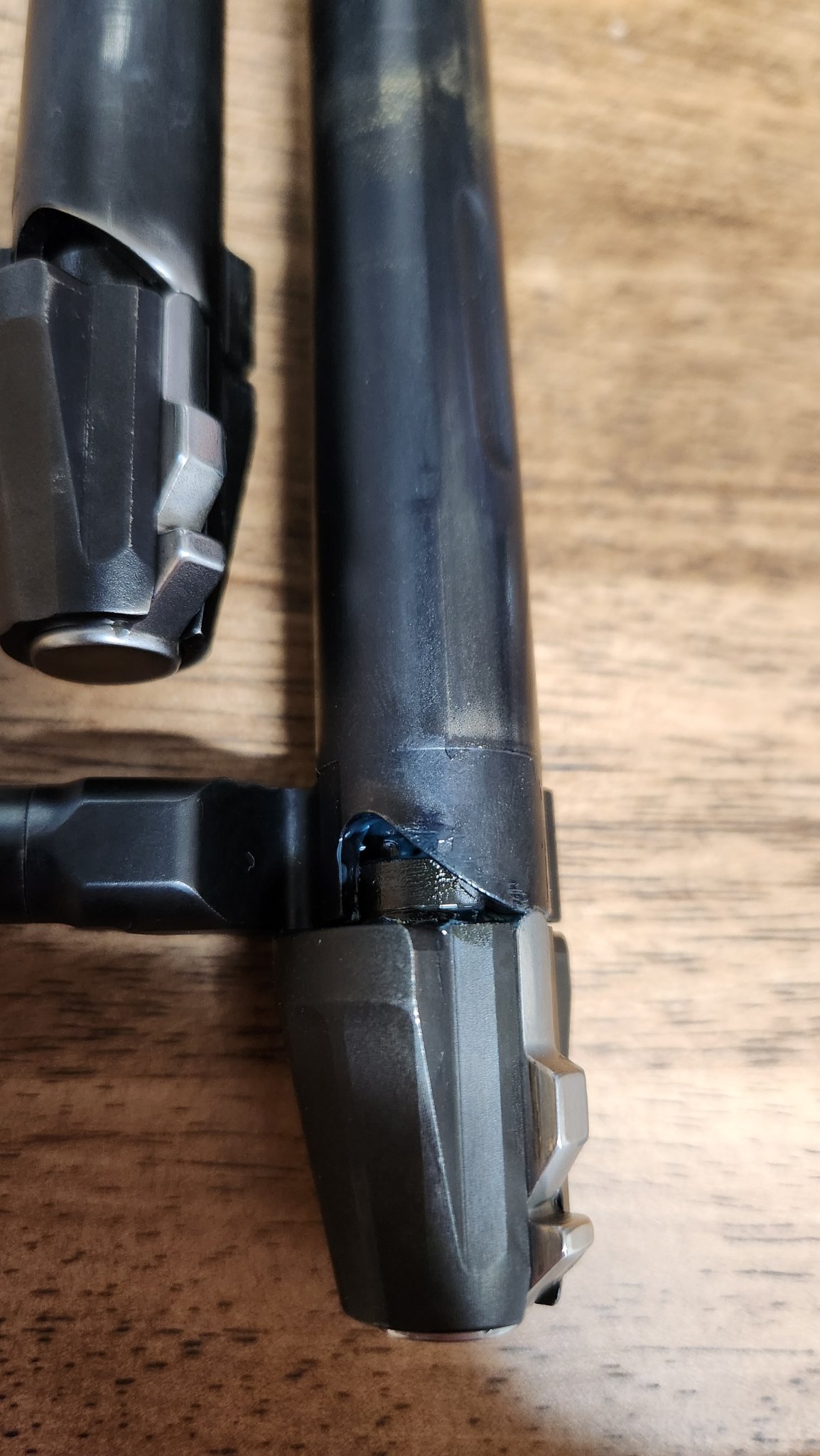

There seems to be a revision to all impact bolts around the time the 75's went into production. The bolt knobs on the new ones are longer and the cocking ramp is different. New 75's seem to have a steeper straight ramp like you'd expect, meaning a heavier lift. New 90's have a curved ramp. They start with the same ramp angle as the 75's, then taper off about 75% of the way through to extend the lift. I also noticed the timing feels a little different. Seems like there's less cock on close with the same trigger.
Looks like they redesigned all bolts to feel pretty close to the same, but they'll all be heavier than the older bolts.
(Old bolt on the left, new bolt on the right, both 90 throw)
Reactions: saum14 and Mattv931
I have two newer Impacts in both flavors. When working the bolt at a slow pace, the 75’s lift is noticeably heavier. You can feel the difference in weight. When working the bolt like a cool guy in social media videos, the heavier lift is less noticeable but there is still a difference. It’s not disruptive or anything. I’ve had people work both bolts and all say the same. Unless you’re smashing your hand I’d go 90 all day having both.

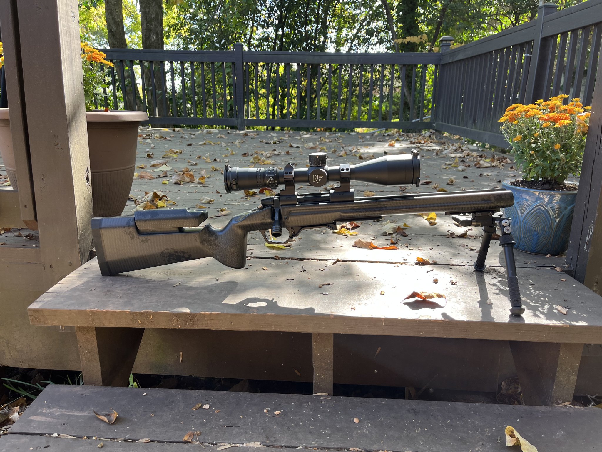

Just picked up my 707r today. It’s a tad bit heavier than my 737-90 but it’s on a hunting rifle so it will be just fine. The pic rail is stuck on tight with those pins. If you’re on the fence about it because of that reason I don’t think it will be an issue at all.
