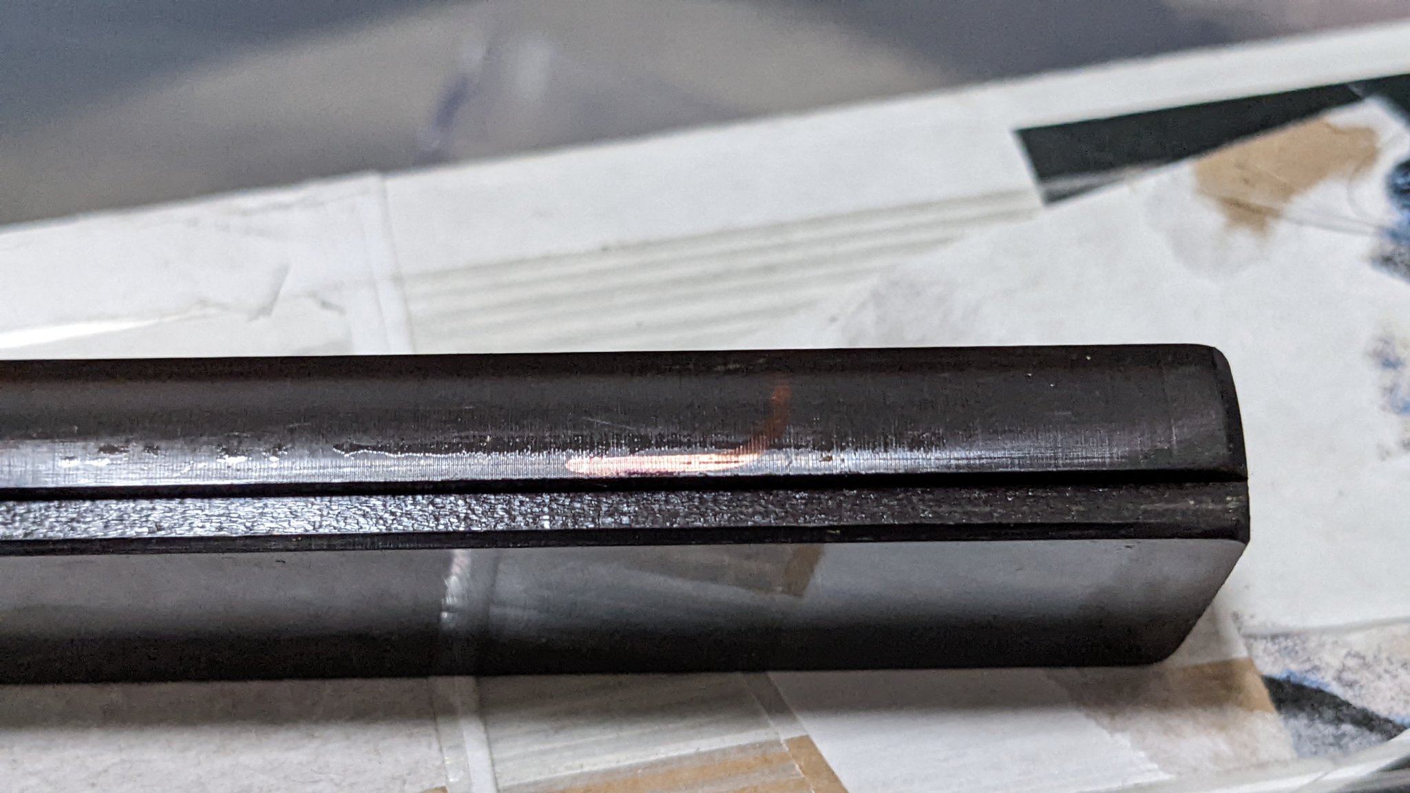

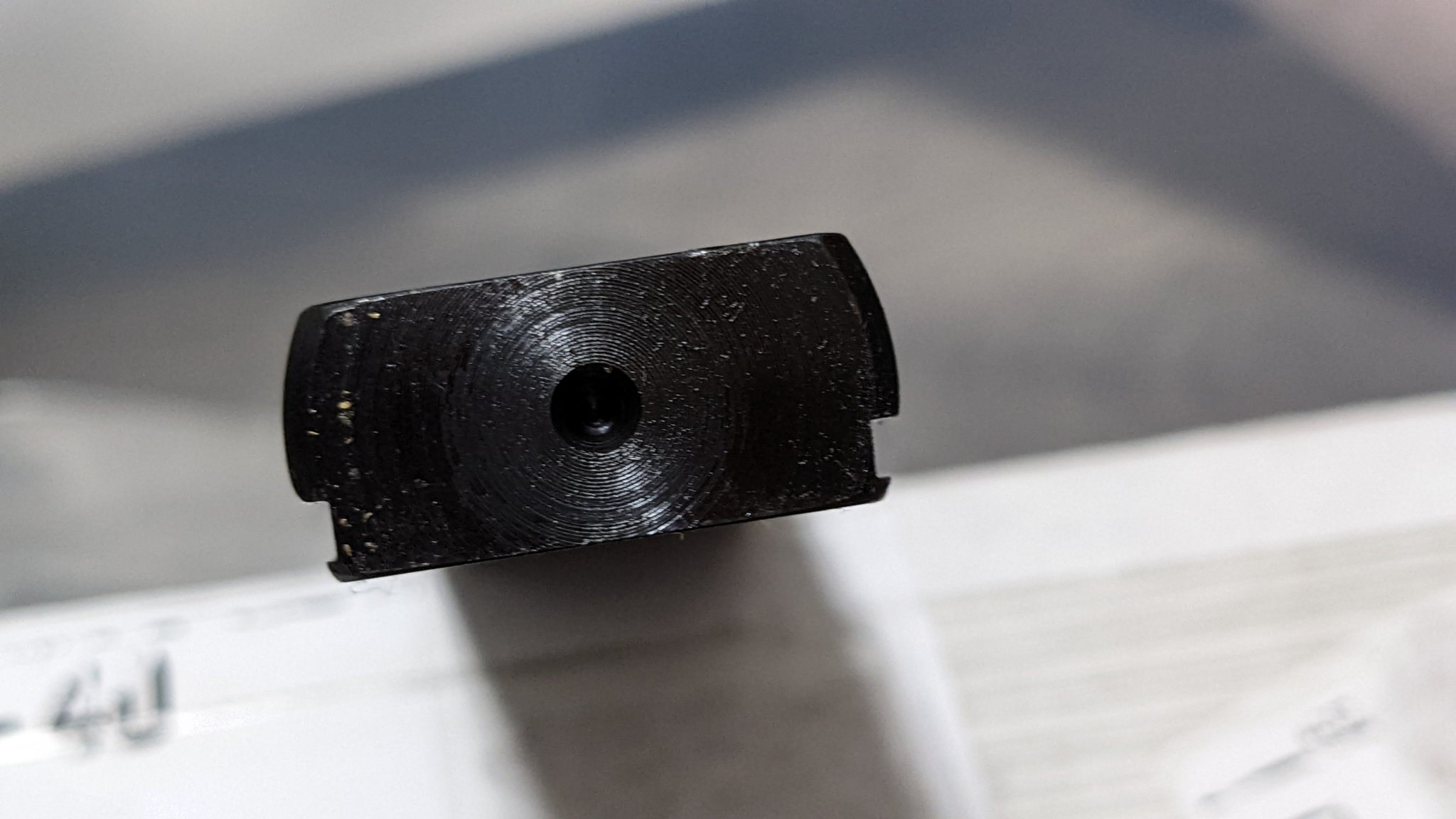

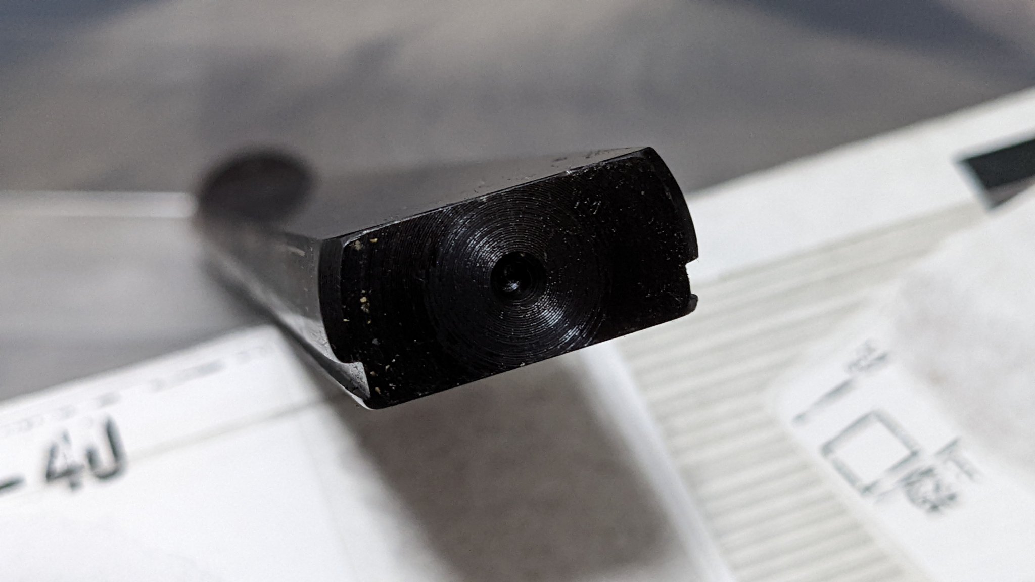

PTG Remington 700 action wrench seems to work. I've only insert the wrench, have not torqued it yet.
Has both non-binding rails.
