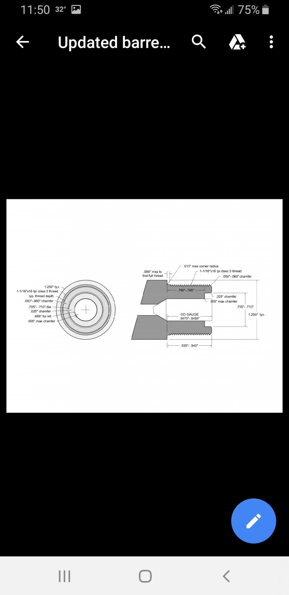

super_poot buddysarmory.com Full Member Minuteman Commercial Supporter Mar 3, 2013 1,001 211 Cheyenne WY Mar 4, 2020 #1 Mar 4, 2020 #1 Does anyone have a print for an impact 737R handy? Don't have an action on hand to measure it yet.
cwinner Private Full Member Minuteman Apr 20, 2009 204 162 NM Mar 4, 2020 #2 Mar 4, 2020 #2 1.0625x16TPI...... all the ones I've done I shoot for 0.940" tenon length and 0.950" headspace. Reactions: super_poot
B Banango Sergeant of the Hide Full Member Minuteman Aug 9, 2018 402 113 Pensacola fl Mar 20, 2020 #3 Mar 20, 2020 #3 Here you go. Got this from tate streater. Attachments Screenshot_20191024-115045_Drive.jpg 93.8 KB · Views: 2,186 Reactions: Ksracer and super_poot
