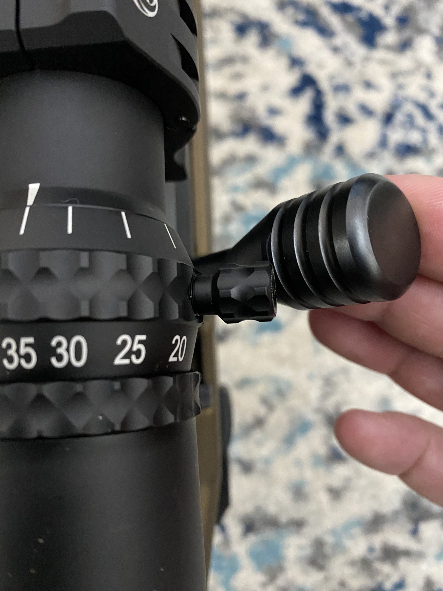

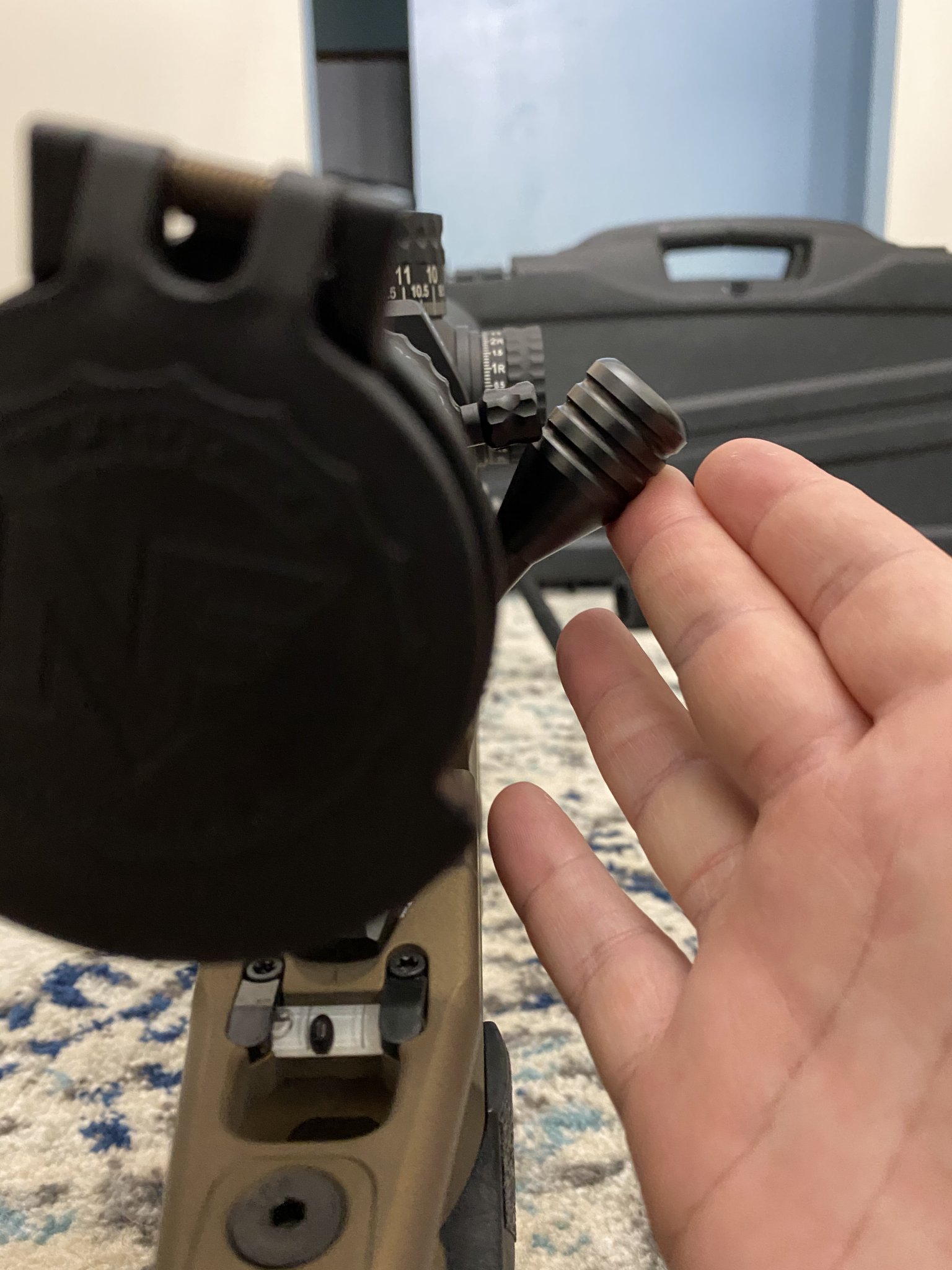

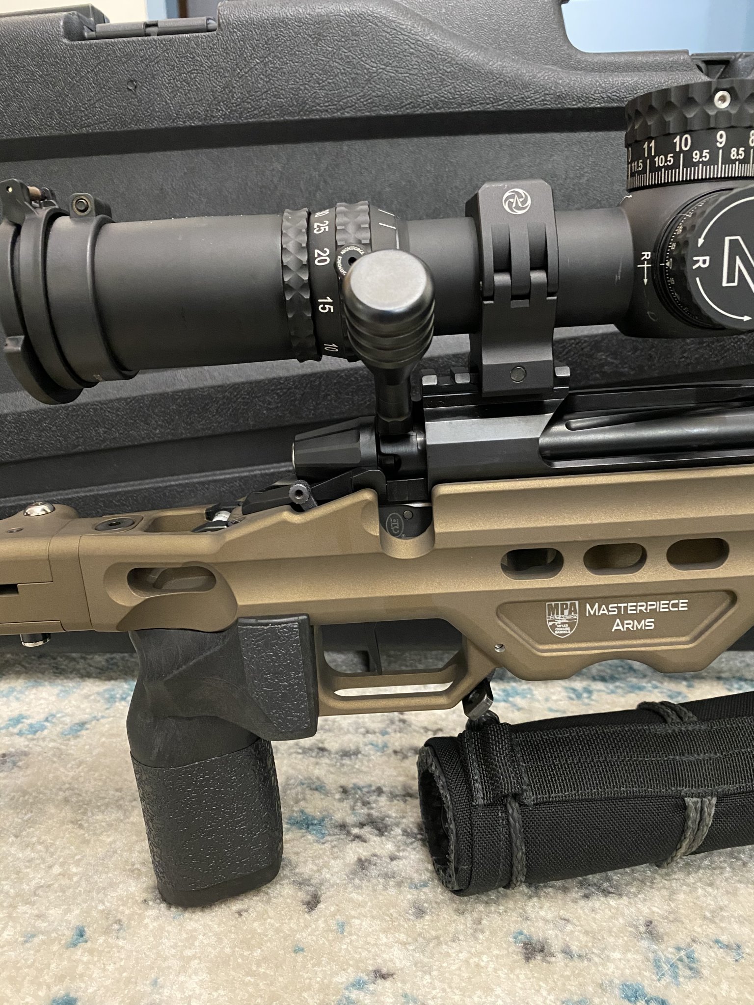

I’m assuming I’m not the first person to have this issue. The factory bolt knob on my Impact 737 LA is hitting the throw lever on my NF ATACR 7-35 when I have it turned to about 33-35x. I have medium height ARC rings.
What are my options to fix this? Is there a way to change the bolt lift angle? Is there an aftermarket bolt knob/adapter that would change the angle of the knob? I really don’t want to change my scope height if I don’t have to.

Try a different knob depending on where it contacts.
The Impact knob is nice though, being heavy steel, it contributes to the smooth bolt cycle.
They made smaller, spherical knobs in steel too, but maybe a tapered will work?

MPA Comp ESR. It hits in just normal running of the bolt. I tried to get a picture of the line it is making on the bolt itself, didn’t come out very good though.
Want to make clear that it doesn’t STOP the bolt, but it usually pushes the throw lever up a little unless I slowly pull the bolt back. Then it comes to a stop.

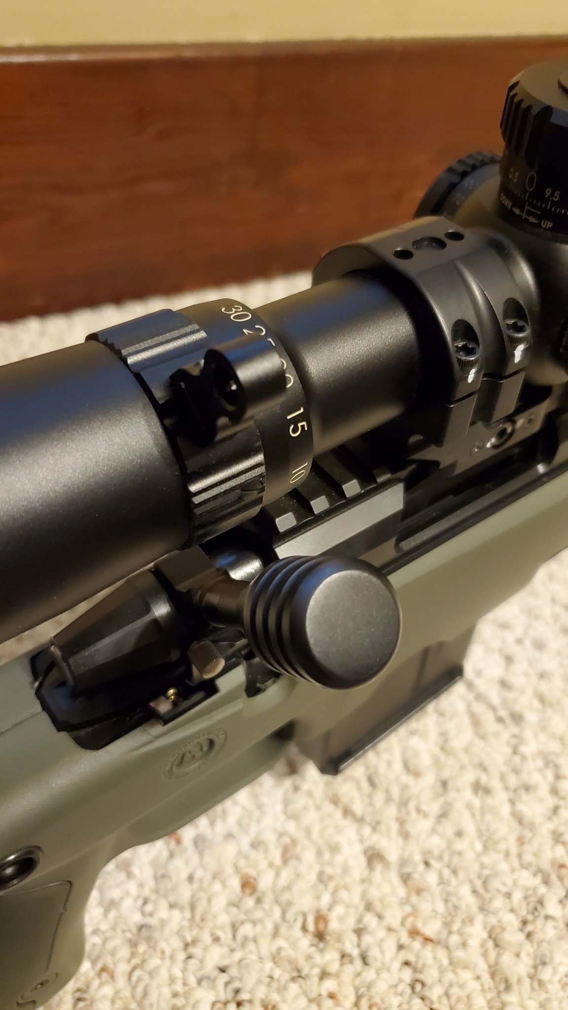

If you want to keep the lever you have on your optic, the easiest fix is taller rings. The only issue I see with that, is taking a divot out of your thumb if you get in a hurry with the bolt. I'd suggest trying it w/o the lever to see how stiff the mag ring is.
Op, as mentioned, you're limited to a few fixes. Some ypu don't want to do, but unfortunately you are gonna have to bite the bullet or live with this interference. Taller rings and move scope slightly forward, lose the nf cattail, or switch actions. If you added a bent down bolt handle, you would likely run into stock clearance issues. I like a scope as low as possible, but I also have 60°actions. A low scope helps mitigate slight cant issues, albeit slightly. Personally, id lose the factory nf cat tail and look into the one that was posted or see if mk machine makes one. Where nf placed that cat tail was dumb. I prefer for cat tail to be at 12 o'clock on max power, if i need to dial down, it will end up at 7-9oclock.
Yeah, when I first noticed the issue I thought maybe I would be lucky and they would have put multiple attach points which would be awesome. I will check mk machine.
The ring is fairly stiff. That is why I really want to kee the lever.

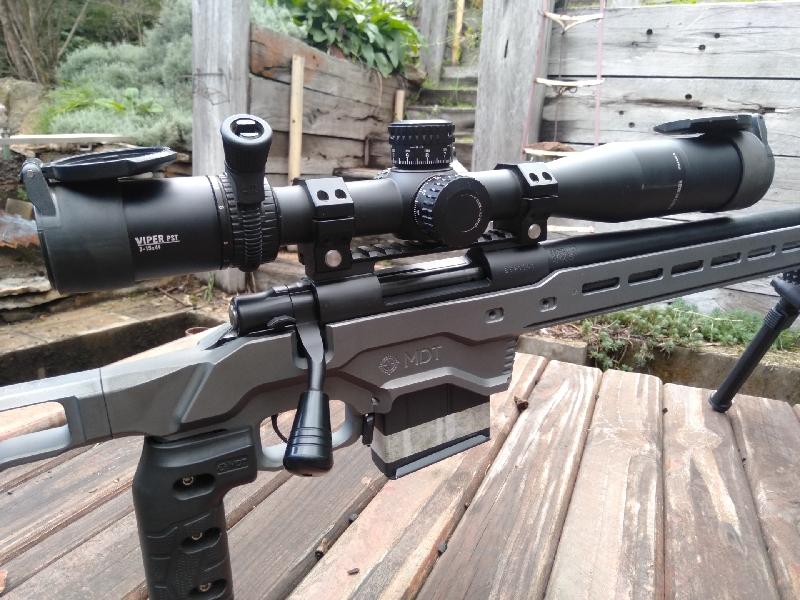

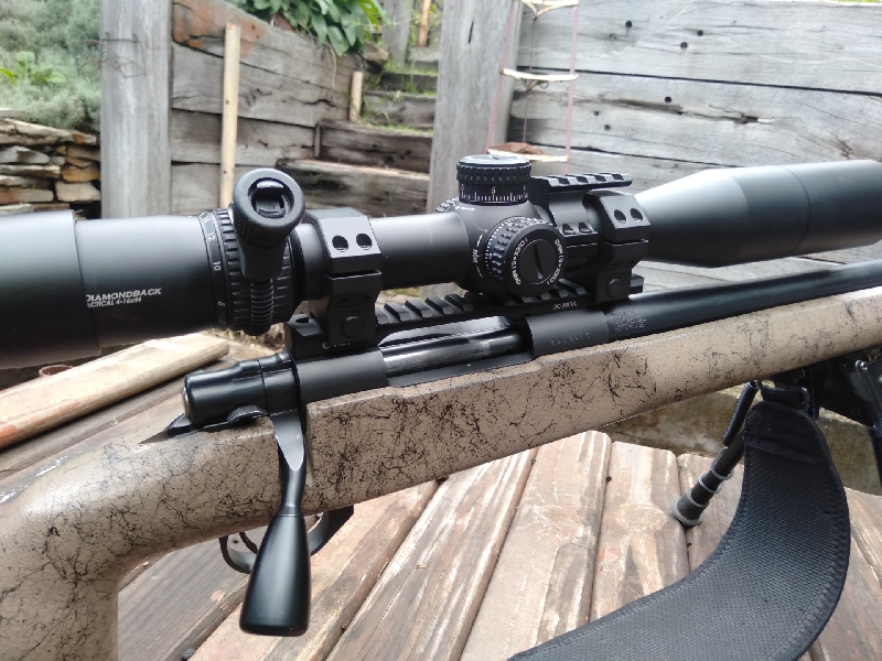

Your scope is mounted about an inch too far rearward. As a very "general " rule of thumb, I like the back of the eyepiece to be over the center of the grip. You could likely avoid that narrow conflict by moving the scope forward. But it looks like even then you're going to be rubbing knuckles on the ocular housing. This is another reason why I like to use higher rings. I think people trying to get the scope as low as possible gets out of hand a little. View attachment 7389865

So I took a "break from work" and shortened the lop as far as it will go (side note I am 5'6 with slightly long for my height arms) and it is still a touch too long, but after moving my scope to account for the lop change my issue has been fixed...by a decent margin, lol. Also excited to "have a reason" that I must go back to the range soon to sight in the rifle again.
