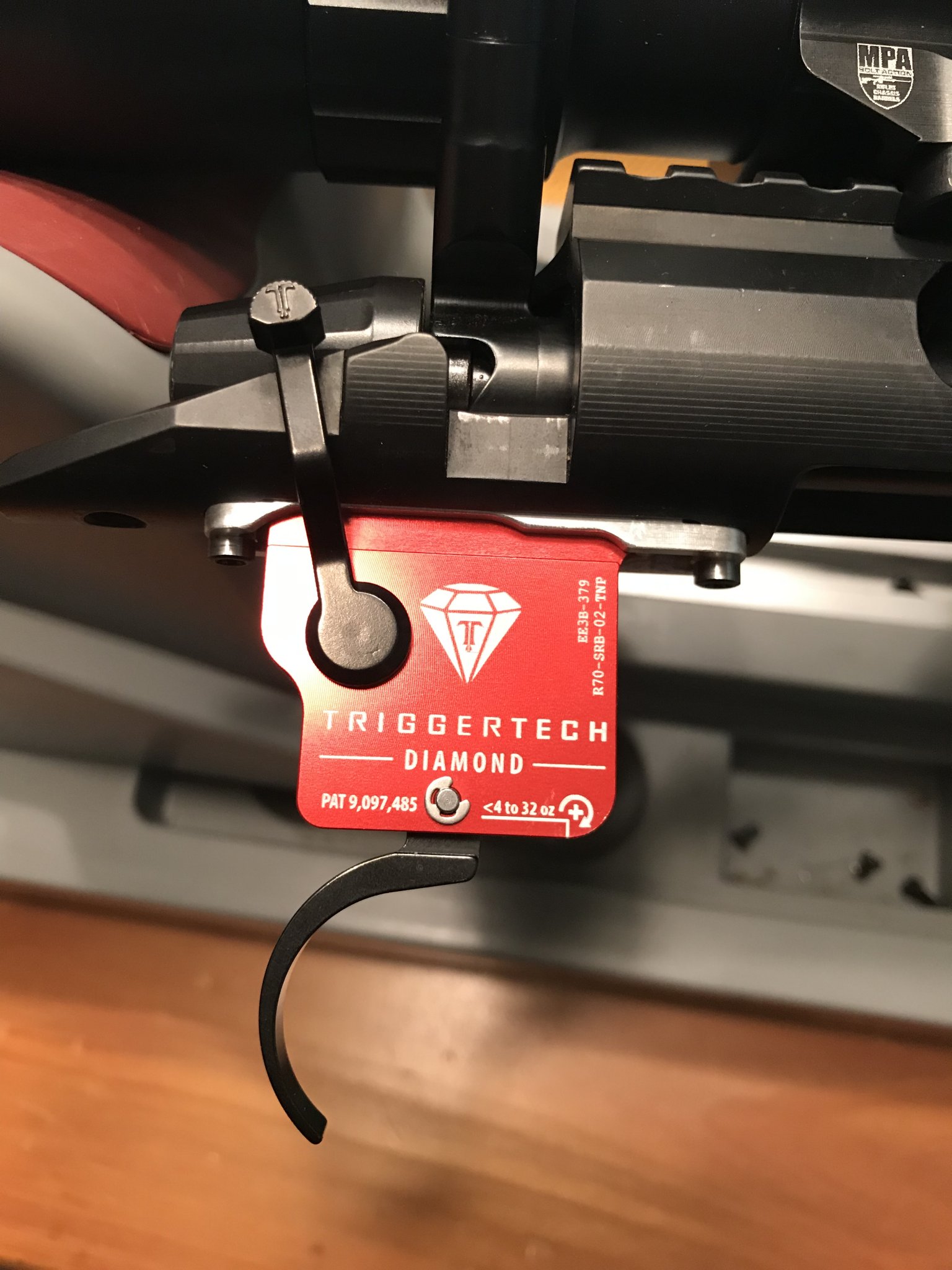

This is how mine is installed. I do get a bit of “drag” on the last bit of bolt cycle when feeding a round.
Poor engineering design if it can be installed the wrong way.
It can be installed the wrong way, kind of, but you can tell it's wrong. It doesn't sit in as nice and flush inside the milled out pocket in the action like it does when you have it the right way around. I just got mixed up when I removed the hangar from the action and installed the trigger.
My tip, since I don't have my rifle apart to double check it, is to try putting the trigger hangar in both ways. You'll feel that one way fits better than the other way, it's definitely noticeable. The part where I got messed up was in making sure that I installed the trigger facing the correct direction inside the hangar. I removed the hangar from the action and got it all turned around before I installed my trigger, so just pay attention to which direction makes the hangar fit nicely and which makes it fit terribly.
