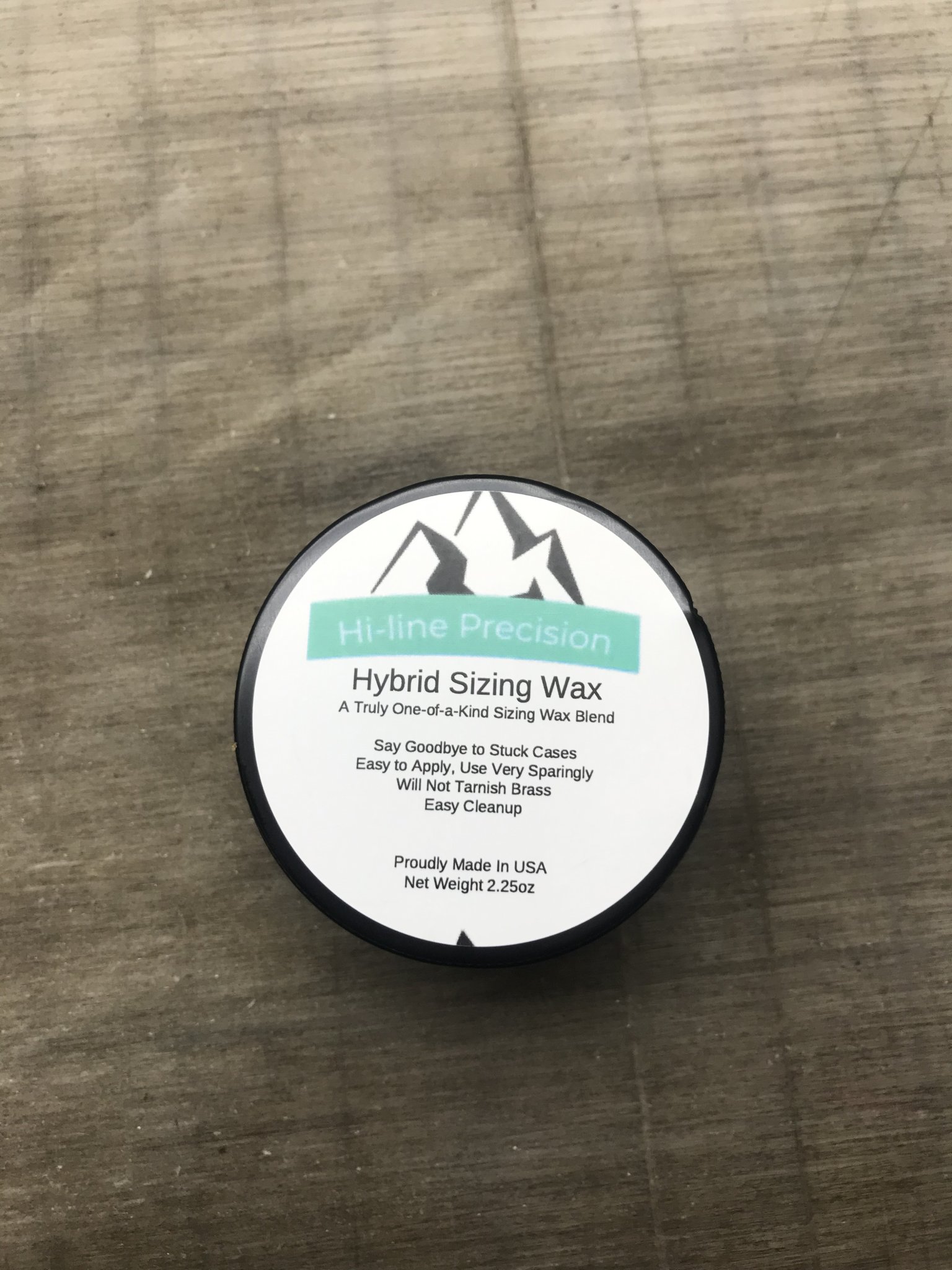

I just got some and had a chance to resize some .223 this afternoon, and I have to say that I'm impressed. WAY better than Hornady One Shot spray, which is the only other product I've used since I started loading a few years ago.
Just don't over do it - It only takes a thin film to FL a case. I tend to lube one case and then lube the next 2-3 with the residual lube on my fingers.
Same here. I start by getting a light coat on my fingers and then rotate the case in my fingers before inserting in the press. Re-coat the fingers about every 5 cases. Great stuff!
I've had stuck cases with One Shot, and the cases always seemed to have quite a bit of drag when resizing, even when it seems like I used a heavier coating. With the wax the cases resize much smoother and with a lot less effort pulling the handle.
It is definitely a slower process, but I don't mind that.
