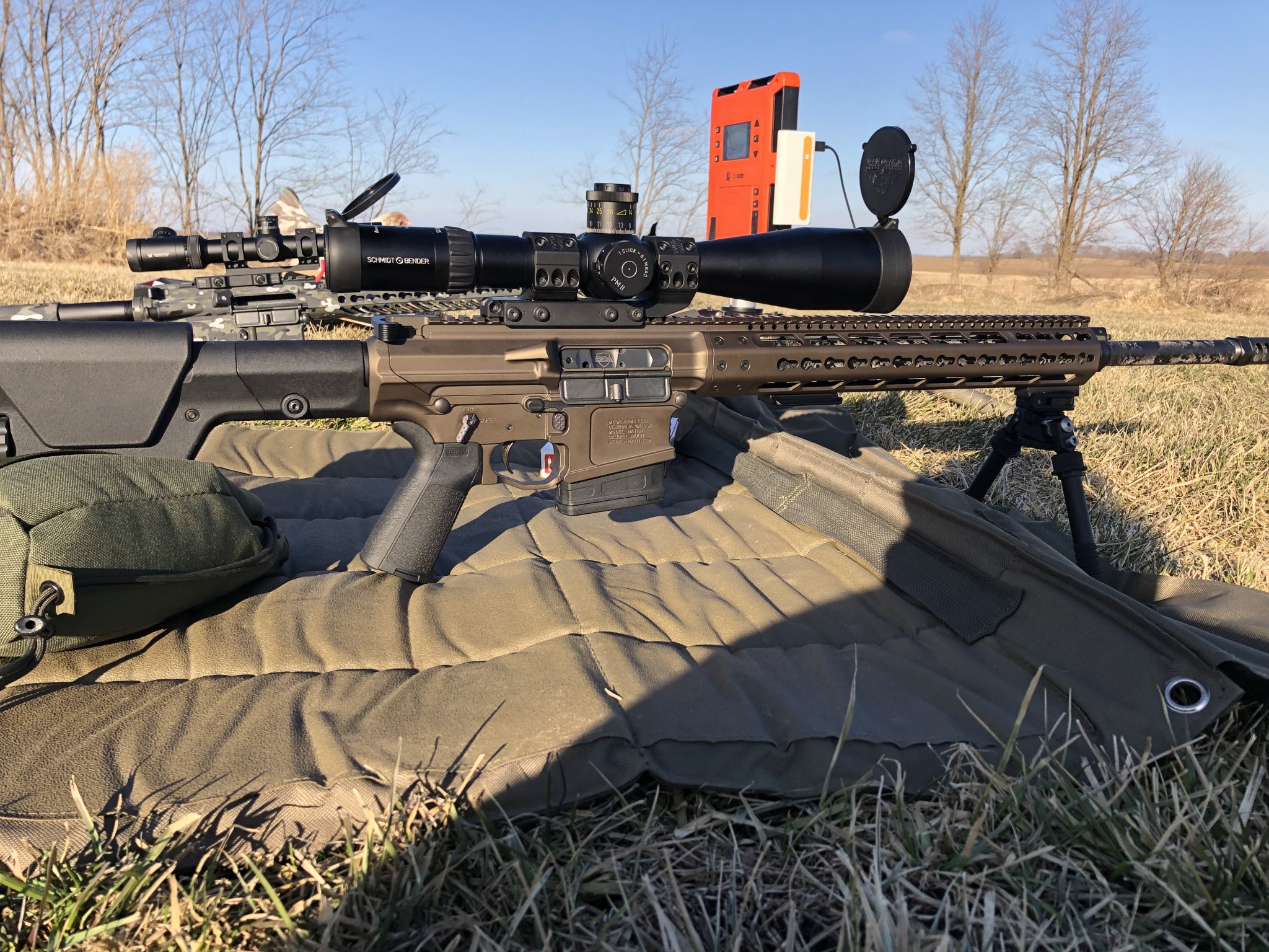

    Finally got to sight in my new 6.5 Creedmoor build and wanted to say that Proof makes a legit barrel. This is my first large frame AR build and first foray into the Creedmoor.
    Build specs: Mega MKM receiver set, Proof 22” CAMGAS 6.5 barrel, Magpul furniture, APA brake, SLR gas block, SSA-E trigger, JP SCS, and Rubber City titanium BCG with HP bolt.

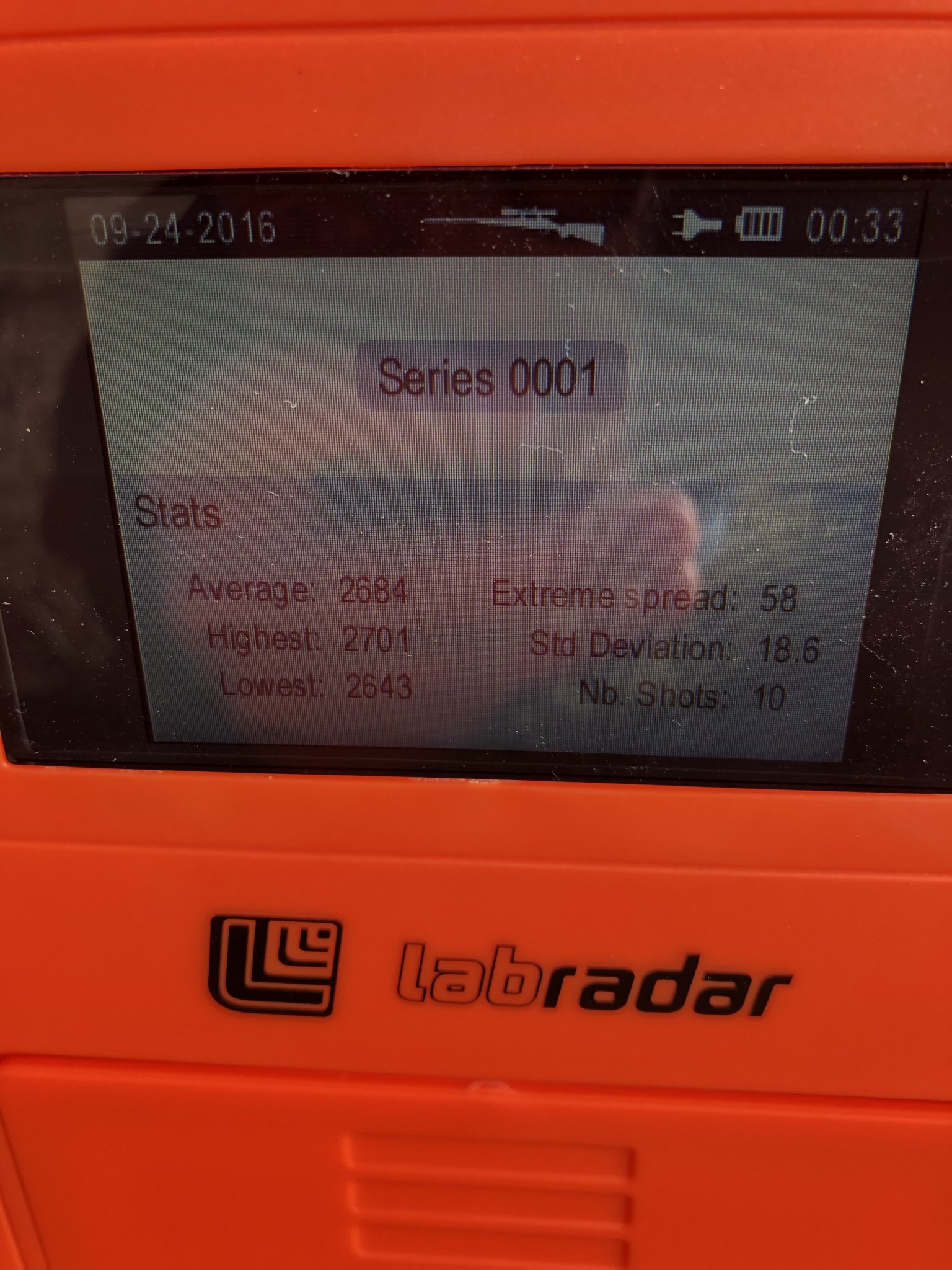

    First 10 rounds were Hornady 120gr Match factory ammo. Averaged 2,830fps. The last 10 rounds were Hornady 140gr Match ammo averaging 2684fps.
    I only put 20 rounds through it so far. 10 rounds to fine tune the gas block and get it sighted in. Last 10 rounds were these groups.
    A little proof that SD doesn’t mean a whole lot at 100 yards

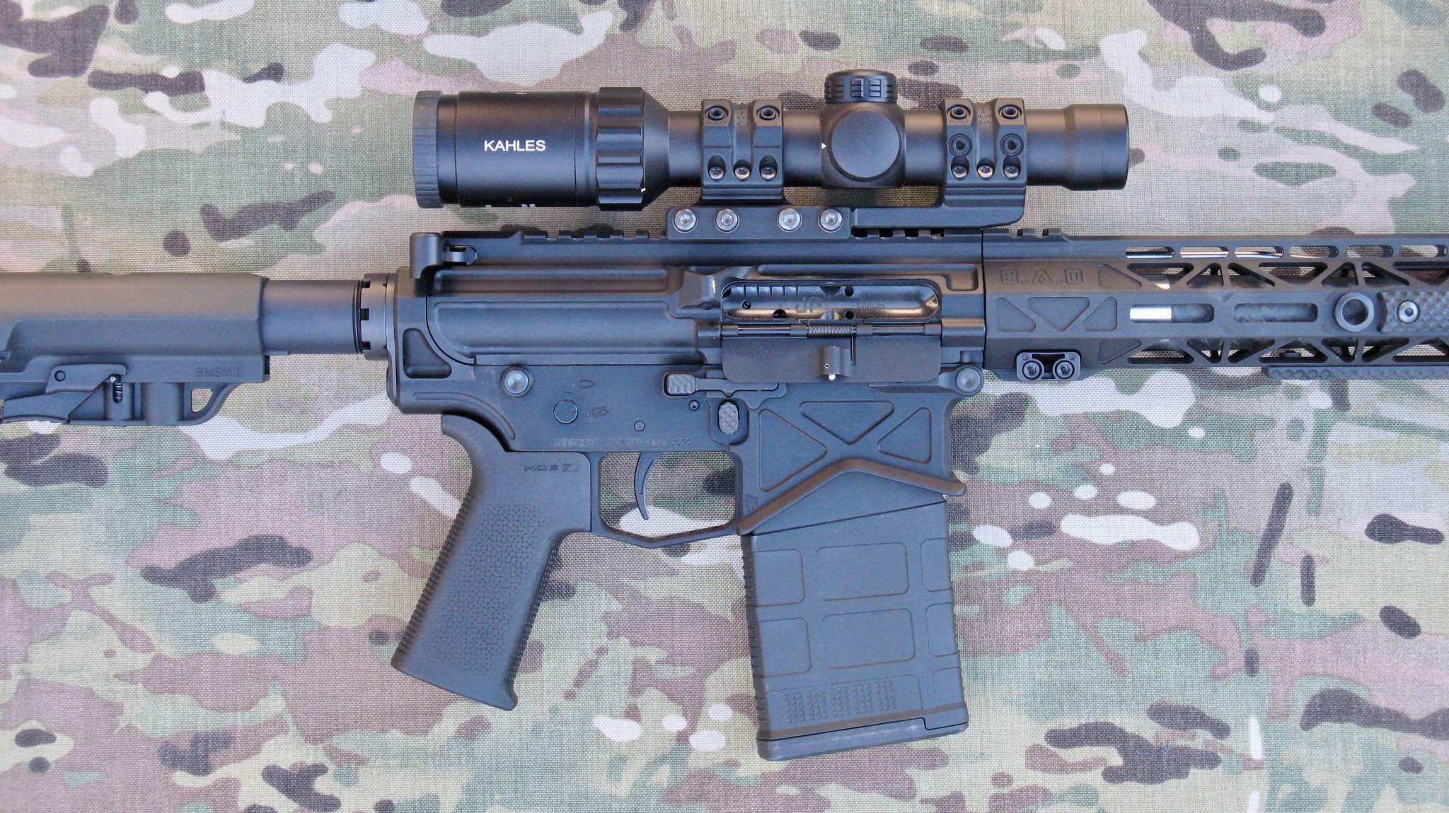

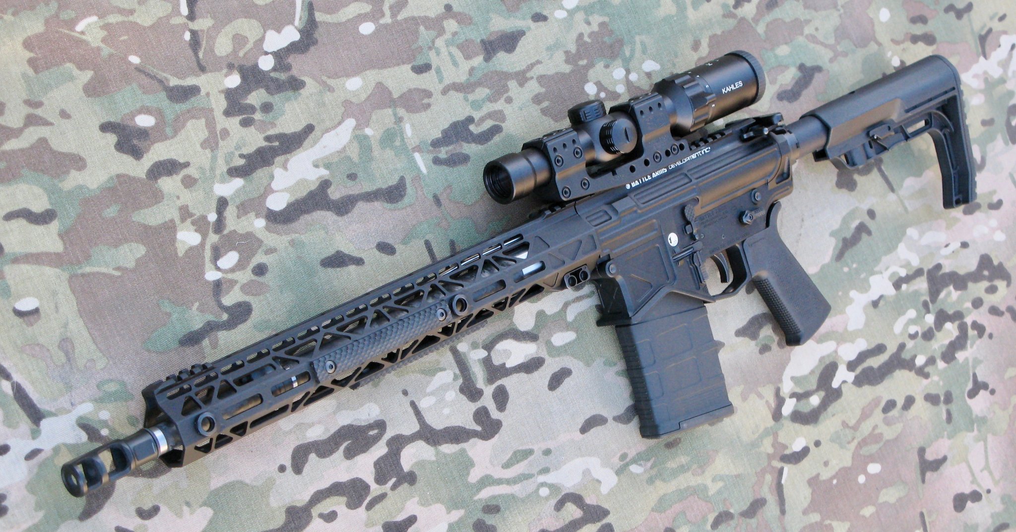

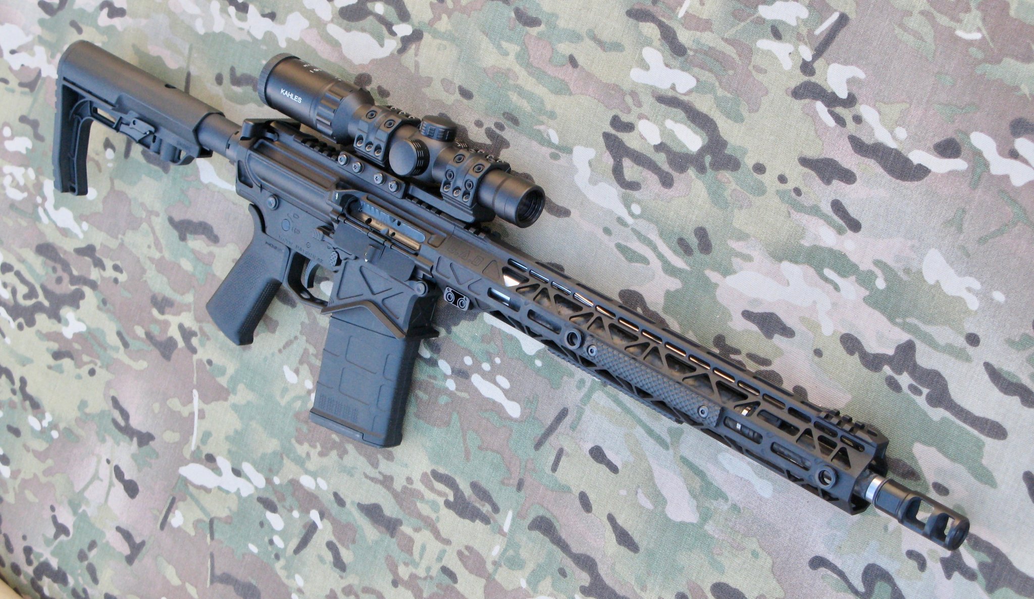

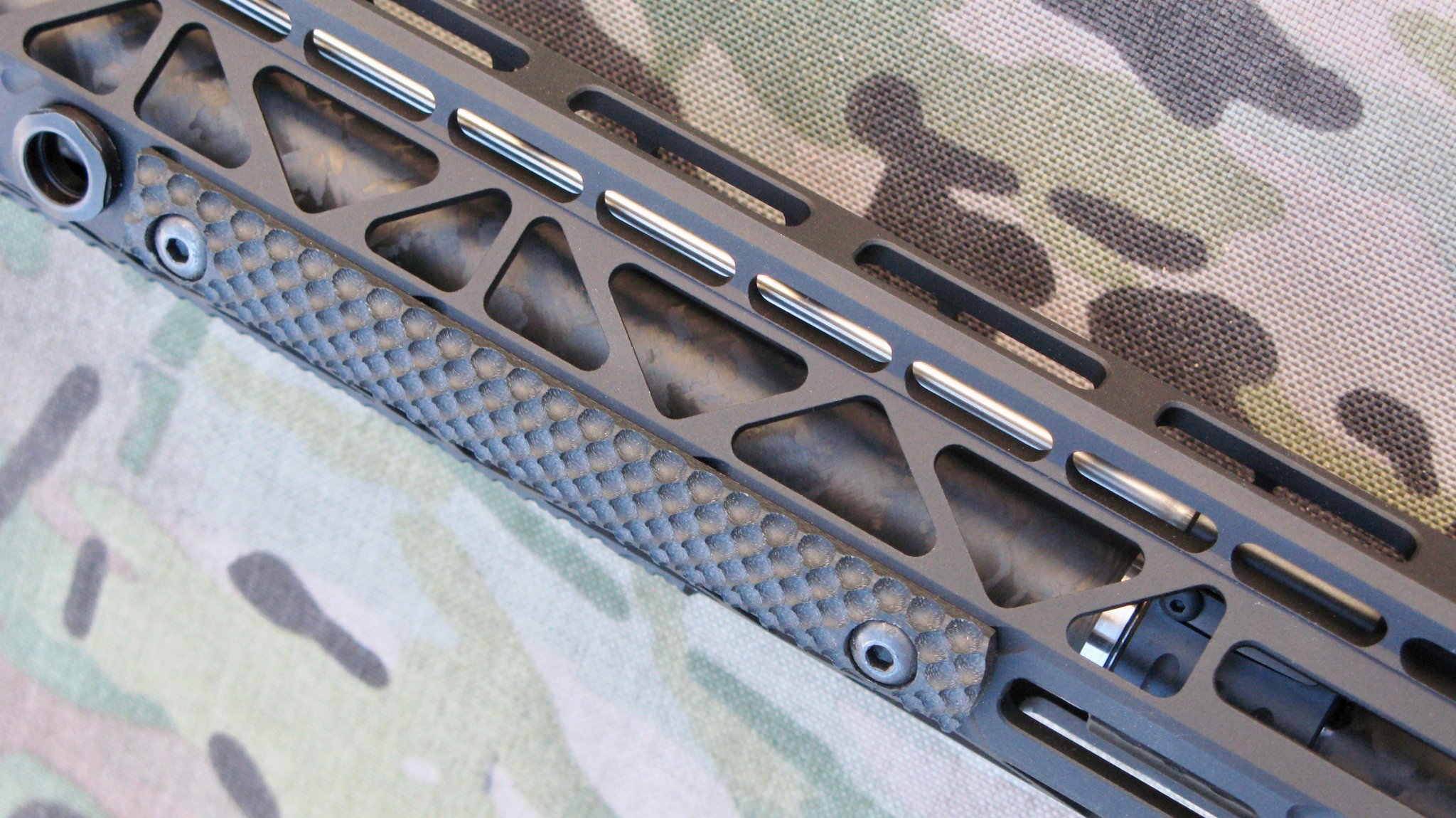

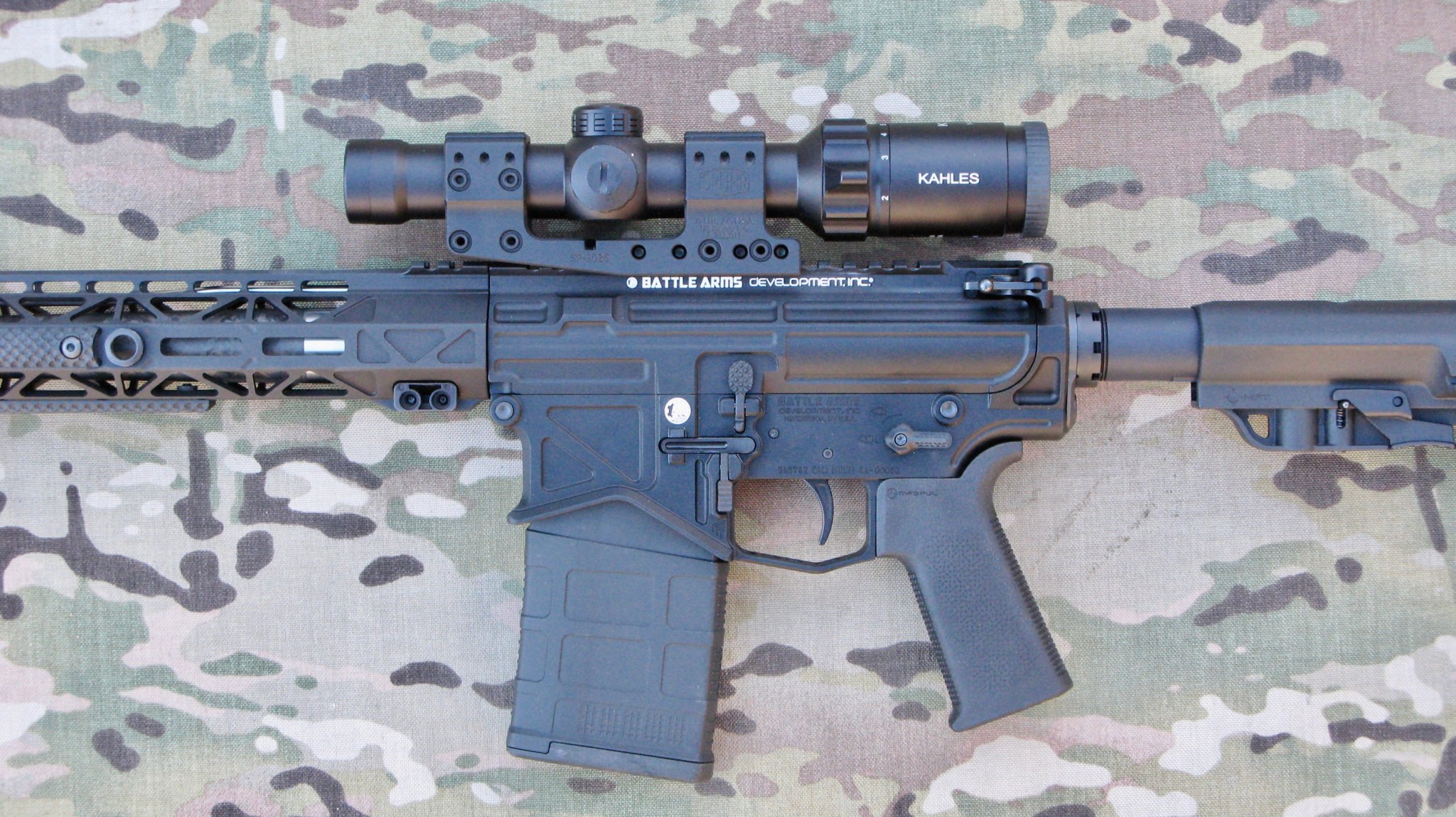

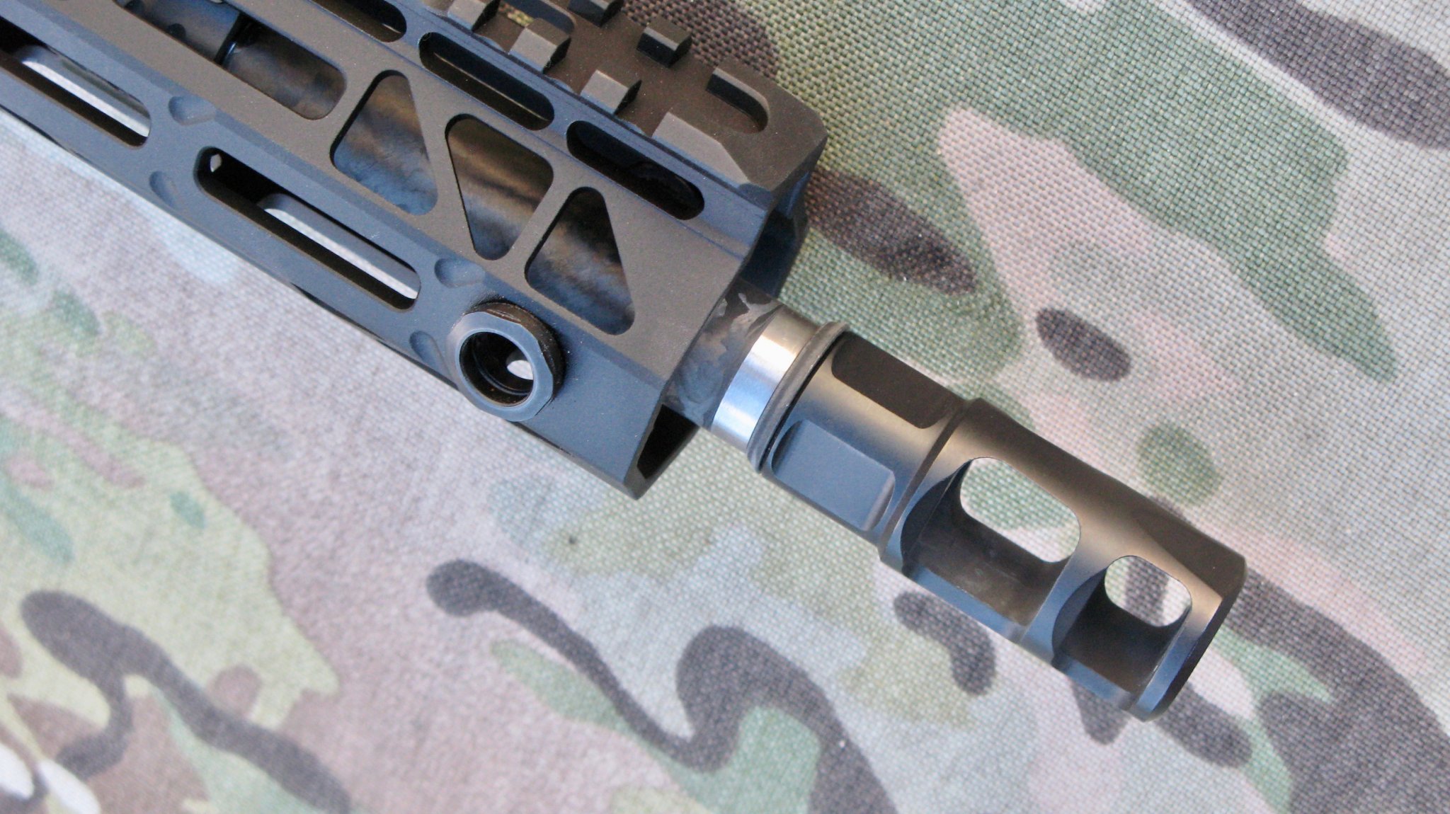

    Here's my newest, super lightweight, big block blaster!!! A 7 pound even dry weight .308 built around a Proof Research 16" CFW barrel with intermediate length gas system, JP LMOS bolt carrier with high pressure bolt, SLR adjustable gas block, and V Seven titanium Fusion brake. All housed inside the new Battle Arms Development billet 7.62 receiver set with matching 15" forend. LaRue MBT trigger, Vltor lower receiver extension, Heavy Buffers recoil spring, and normal H2 buffer round out the innards. All small parts in titanium from V Seven. MFT stock works amazingly well and weighs next to nothing. Great glass in the form of the Kahles K16i, riding in the bulletproof Spuhr SP-3026 mount. Recoil is amazingly light, plus accuracy is quite acceptable, especially considering the rifle's 7 pound weight. Reliability so far 100%.
