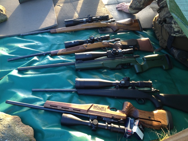

Rifles:
1 pc SAKO 30.06
2 pc SAKO TRG 22 cal 308win
1 pc Browning A-Bolt 6.5x55
1 pc TIKKA T3 Sporter cal 308win
1 pc Custom m96 cal 6.5x55
1 pc TIKKA 596 cal 6.5x55
1 pc Remington cal 30.06
1 pc Ruger Hawkeye Tactical cal 308win
1 pc SAKO quad Range 22LR (just for fun)
Scope mounts:
SPUHR ISMS (fantastic stuff)
Ruger scope rings
Ior scope rings

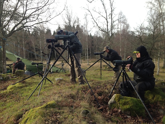

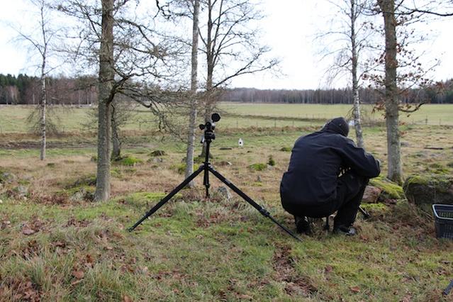

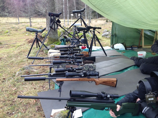

Shooters:
7 Military or ex-military sharpshooters or snipers with hunting background, age 23-45 years.
We had the opportunity to test a significant number of riflescopes and spotting scopes from AstroSweden. George from Astrosweden is a very nice guy who was present during the weekend and provided us with info about the optics and collected feedback from us during the entire weekend. He also served as an excellent spotter and proved quite proficient with the 22LR ;-)
The range is an open field with a max range of 1000 meters in the southeast of Sweden
The steel targets were set up from 300m out to 950 m.
Observation ”targets” were placed from 300m out to 500m. They consisted of ”bad guys” faces in natural size or close to. And some eye examination charts, same as used by opcticians.
Condition was quite windy during saturday and the shooting became challenging… Light was good for testing optic though :). We used the evening for shooting lowlight at intermediate distance 300-400 m. During the night to sunday we had a full moon, perfect for spending time in consistent darkness, comparing optic light transmission, illuminated reticles and ease of handling. Sunday morning gave us direct sunlight which was perfect to look for light effects in the scopes and reticles. Very interesting…
We had two guys (George included) who did most of the spotting since they had less experience with long Range shooting. The other six guys (me included) did most of the shooting. We spent close to 1400 rounds and about 15 hours per person behinds an ocular lens. I list this just to point out that the weekend was intense, lots of impressions and of course lots of discussions.
This can therefore hardly pass as a regular test with points and protocols, winners and losers. There was simply too little time and too much optic to go through. We recognize our shortcomings as optical experts, we are shooters who have spent time looking through glass while hunting, observing and shooting in the military and as civilians.
On behalf of our little shooting club and its participants we humbly accept that this is merely our opinions gathered in a short period of time with notebooks, rifles and optics passed around, tried and discussed between shooting sessions - which by itself was quite intense.

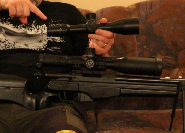

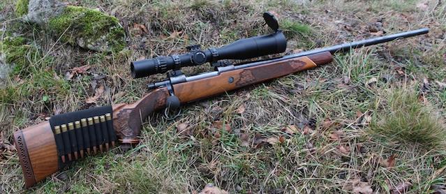

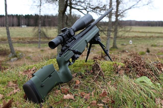

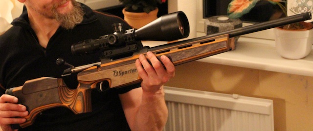

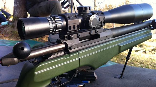

Hensoldt ZF 6-24x72 IR MIL DOT IR
Well, to start off with this scope is really not fair to the others. In all regards this scope is somewhat in a different league of optics. It is huge! The bell is indeed large and places the ocular lens high.
Turrets are excellent in their shape and distinct clicks. The turrets gave a positive click response and were easy to use also with gloves. Markings were easy to see and .1 clicks gave us an easy time to quickly obtain a grip on counting clicks on the different targets.
Reticle is placed in SFP and are of see-through design, it allows light to pass through as much as possible. The SFP threw us off one or two times, but that was just us being hasty and confused with changing scopes.
The reticle was perfectly adjusted on 10 and 20 power and there was no diviation between reticle and the turret adjustment that we could notice. The reticle illumination is for the whole reticle, and I´m personally not a fan of this, but none of us reacted to it as a negative. It is easy to adjust and can be turned down really low to accommodate everyones taste. No bleeding could be seen by any of us at max power. During daylight/ high noon it is not quite bright enough to use practically, but we did not feel this was negative, just notable.
Optical performance was stellar, really really very good! During daytime we all experienced a very wide field of view and also depth of view. A three dimension feeling that is hard to describe. Also the image seems to float in front of the ocular lens. You hardly saw the circle at all. It was really easy to see the difference in target distance out on the range. Clarity and resolution was excellent.
The eye box is very generous and forgiving. You acquire your target very fast even when shouldering a rifle not fitted to you, with little or no scope shadow whatsoever. Parallax adjustment worked fine and were more to make sure we didn't have the reticle dancing around on the target since we, most of the time used borrowed rifles. Sharpness and clarity appeared in great depth on the range even on the higher magnification (over 20 power) It of course decreased, but in the group it stood out, along with the other three Hensoldt scope close behind or just as good.
If anything clouded the heavens of this magnificent scope it was backlight… We did not use sunshade to challenge the scope, and the backlight was as bad as you can get in the field. Bright, low and a little morning mist. Tricky for any scope! But here we saw light effects such as ghost rings and light reflecting and some complete bright out. Not all of us saw this effect, so it worked fine in back light except for when it got in its weak spots. As far as we could determine it has to do with the exceptionally large objective.
Now, when the daylight went… Oh Boy…! This scope is in it´s element. That objective lens is not for appearance!!! I have never ever looked through glass like this. Especially in moonlight during the night this scope was the reference, we used a hunting tower in the woodlines at 1000m as a reference point. When looking through the Hensoldt all the details came into focus without straining your eyes. It was just there, not bright as day but very clearly visible. And I could not see it at all even with a good dark accommodation (more than 30 minuets of light discipline) Simply outstanding! No scope came really close to this performance, and this is in a good line of competition. Also shooting 25x25 cm steel plates at 400 m during nightfall. The guy shooting with this scope just continued when the others just had to stop. Not fair at all…After 30 minutes of only him shooting we stopped the session, but I think he could have continued if it wasn't for the mist.
To sum up the impressions on the Hensoldt ZF 6-24x72 IR MIL DOT IR I can say that several of us started with the mindset that it is simply too big for practical use, interesting, but impractical. After the weekend a few of us discussed what rifle to fit it with and that it´s not really that big. If you consider weight and objective diameter it is actually compact and short for what it brings to the table.
My interpretation of our behavior is that the scope is so damn good that a person will go through a lot to get that optical performance! Including changing rifle, negotiation with wife/girlfriend, selling the dog and even accepting a SFP… Need I say more? It delivered.
All in all a wonderful riflescope. The issues we had was down to three things:
*Size and weight - You gotta have the rifle and mount for that big guy!
*Back light - Well, sunshade would fix it and none of us noted this as a deal breaker.
*SFP - Although the reticle is well thought out with the cut through design and the readings on the powering is easy to use for milling. It is still a SFP and when pressure is put on your shot, hunting or military, you are more likely to make a mistake. It´s just one more thing to keep track of. If anything this would make me hesitate a little…
Let me know if you like the format or if I´m writing stuff too long and tedious. There is plenty of scopes left to translate from Swedish and I don´t want to bore you... I´ll try to accommodate you.

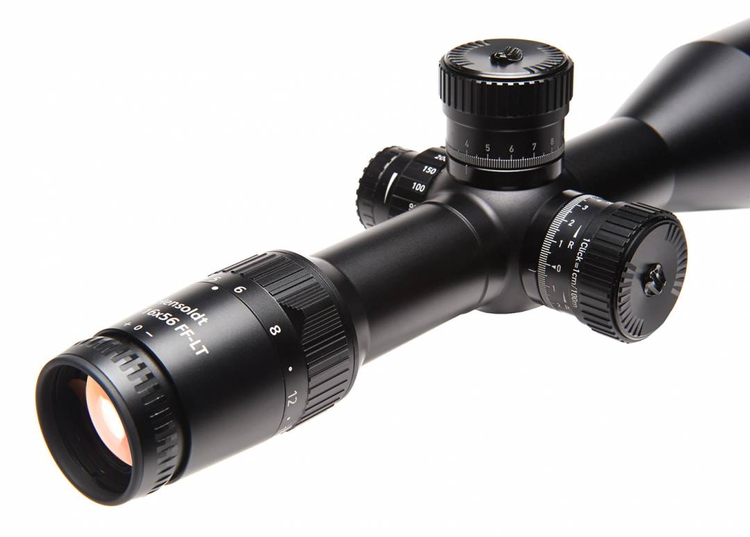

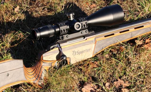

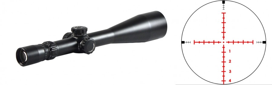

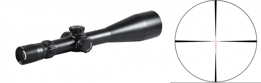

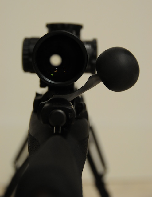

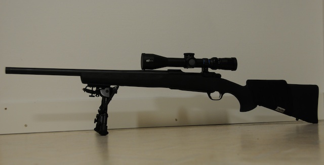

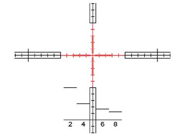

Hensoldt ZF 4-16x56 FFP LT IR
Ok, another Hensoldt… But with FFP, Zero stop and locking turrets! Yey!!
The turrets are fairly large without protrusions sticking out. Rather a fine grit that provides a good grip without catching gear or vegetation. You pull the turret up and rotate, when you let go it locks. Simple and easy.
The turret covers the entire construction so water will not ”get caught” (hope you know what I mean). Clicks were distinct and quite close in between, sound and feel put a smile to your face , and there was no problem to adjust in darkness with gloves on.
Zero Stop was also a positive added feature on this model. Sorry to say, but we did not use it in the field during this weekend. George showed us how it worked and it seemed intuitive to us.
Increments .1 mil felt just right and was again easy to count and adjust for second shot after spotter adjustment was given. I should mention that it was easy to lie prone and adjust this turret. None of us experienced that we had to break our position to adjust, just move the head a little and you are fine. This also had to do with the Spuhr ISMS mount that was used, thank you Håkan, well done!… ;-)
Parallax adjustment worked very well, and felt by most to be correctly calibrated to distance marked on the turret.
The reticle (see thumbnail) is a cut through design and FFP fine line. We tried different magnification settings to see if it got difficult to use… -No it didn’t… :-D
Just as easy to use on low power as it was on full power. I should point out that FFP is the norm in our group for our own optics, and we are therefore used to it. On the Hensoldt the design stood out as an overall very good design, and a favorite for most of us. Especially on high power were it was a tad bit thinner than the standard mil dot Hensoldt.
The Illumination was again a joy to use, no bleeding on highest power and as low as you´d like in pitch black darkness. Easy to turn off by pushing in the turret.
This scope share optical quality with its bigger brother 6-24x72. It did not have quite the field of view as ”Hubble”, we could hardly tell them apart in daylight. There was no tube vision at all, and it had the same ”floating optical” feeling. Again the depth of view and 3D feeling combined with a generous eye box made it very pleasant to use for long periods of time. We had to remind ourselves to adjust the parallax at times, because the target appeared sharp even with 400 m difference! -Very easy to get a grip of the range and finding targets fast.
As the daylight decreased, the scope stepped up. When other scopes started to become difficult to shoot with, the Hensoldt just kept going in the darkness… 3D field view - still there, resolution - oh yes. We did try it in the moonlight looking at the woodlines, and the hunting tower was no problem to see along with a detailed field of view even at max power (x16), but it was beaten by 6-24x72 compared side by side for some time. By a very small margin…
Another plus for this particular Hensoldt model was back light performance. 7 of us did not experience any of the negative effects seen on Hensoldt 6-24x72. It was not the absolute best in the back light performance category, but very close. One of the shooters had a different opinion regarding backlight performance, he thought it sensitive to backlight but better than the 6-24x72.
To sum up this scope is easy, get one, it has it all: compact, locking turrets, zero stop, great turrets and illumination, smooth and precise parallax adjustment.
It did not have the highest magnification of all scopes, but it was just right… and you could comfortably lie ”glassing” the range for hours without eye fatigue.
If there was one wish that we had it was to get a decent flip up lock like the Tenebraex included.
OK, next up is the March 5-40x56...

When you are looking at a scope with a magnification from 5-40 in FFP, one of the first things that come to mind is the reticle. Because there is no way it can be ideal for both x5 and x40… or can it?
The March 5-40x56 had the FML-1 reticle (see thumbnail) and it is a neat solution. We liked it from x5 all the way out to x40. For me personally it was a pleasant surprise to see it perform so well on the low side of the scale. Lowest sett it looks like a normal floating crosshair, and on the highest, the floating .05 diameter dot works very well for us.
The illumination comes in either high setting or low setting from the factory. This was the low setup. The pushbutton is located on the parallax adjustment, and has I think four settings and the off in a cycle. This is a sensible setup in our opinion, when you want to minimize and streamline the scope. The button is large enough to access with gloves. We saw no ”bleeding” of the reticle at the highest power. Like the Hensoldt it was a little to weak for daylight / high noon use in this configuration. The lowest setting appeared a touch too bright, not bad but could have been one step lower power. Another thought was to have just the dot illuminated with same brightness.
Optically… hmm, how to describe it… the March 5-40x56 is crystal clear and extremely sharp. In resolution there were none to beat it. Color, saturation were flawless also at the highest magnification (x40). It had little or no issues in backlight and, to our surprise, did very well in all kinds of angles we threw at it, altering power setting back and forth. We saw a slight tunneling at the lowest power set, but you had to look for it to see it.
The darkness had little effect on the March, it performed very well - surprisingly well if you think of the magnification range. We saw details in the moonlit wood line at 1000m with power set at x8, and could see the hunting tower but not with the details that the Hensoldts could, although closer than anticipated.
But, and there is a big but with this scope. You have to love adjusting parallax if you shoot with this scope. Everything described above concerning optic performance came with a lot of parallax adjustment. The depth of view is short, it actually reminds me more of photography were sharpness appear in one distinct point. The higher power you have, the trickier it got for us. We thought it was somewhat difficult during daytime, in darkness it was really hard.
Eyebox was ok at low power, but as you climbed the power ladder, the eye box shrunk down, and parallax adjustment became very sensitive. I observed the guys shooting the TRG mounted March. They were wiggling their heads, stretching necks and constantly adjusting the parallax. After some missed shots, they started to mumble things I could not hear.
The problem was down to three things: sensitive parallax combined with short depth of view; small eye box on higher power setting; borrowed rifles.
We all wanted to shoot well with this scope, we were intrigued with it and tried our best to shoot small groups on high power setting. It did not work as well as we wanted, so we decided to keep it on the TRG and try one more time sacrificing time on one of the Hensoldts.
Sunday morning I had made up my mind to give the scope some serious work and started with two spotters on my side with some nice glass. I adjusted the TRG as best I could and worked my way out on the steel targets. Very carefully adjusting the parallax as I went by 500m and I was still hitting… And then my spotters started to pick up vapor trails. After some shooting corrections I was also able to see vapor trail through the scope! :cool:
I tried a couple of shots on 950m and was on target for three shots in a row with the March 5-40x56 with standard 7.62x51 NATO ammo. This with a borrowed rifle and a new scope! OK enough bragging. My fellow shooter who struggled with same setup is a better shooter than I am. But the setup did not fit him on this day, and the March is unforgiving.
So, you have to treat it like a F1 car, fiddle a lot with parallax, adjust your rifle to exactly fit your face and then you have a scope that can deliver optical resolution, clarity and magnification like no other scope.
We predict that the learning curve for this march scope to work properly, is much longer than any other scope we looked at during this weekend.
And for tactical work at dawn or dusk with pressure… I don´t know, too sensitive and difficult to adjust under stress. You can see the benchrest heritage in the scope, and it is wonderful in many ways, but the price you pay is to give up a lot of practicality by tuning and adjusting.

Good evening Gentlemen, you do keep me busy translating with your encouragement. Thank you for being nice to the rookie :)
Now, another March for you...

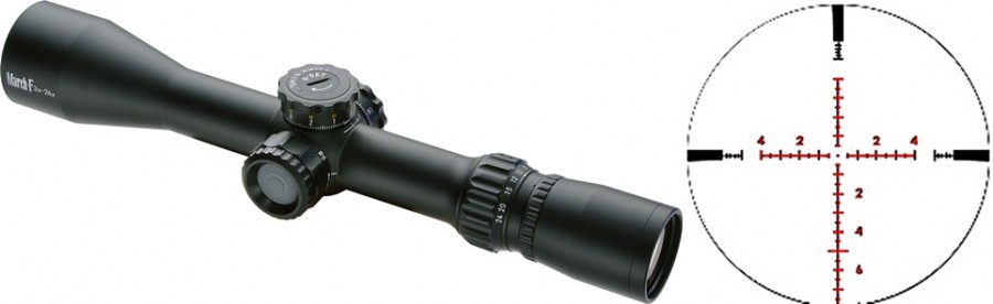

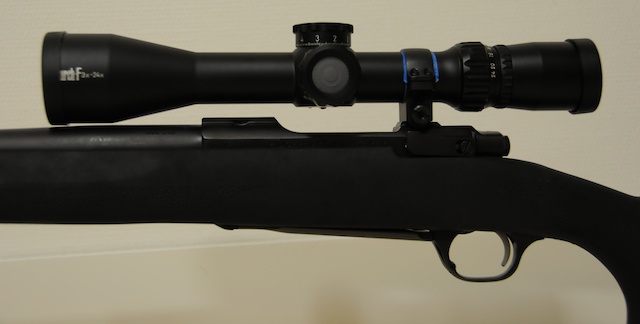

March-F 3-24x42 FFP FML-1 IR
We spent a lot of time with its bigger brother so this scope got less attention in some ways.
The specs are good, but in the crowd of scopes you had to look closer to see this little gem.
It looks like a scaled down version of the 5-40x56. Very small if you consider the specifications.
Turrets are the same as the 5-40x56, just as well made and they look very good on this small scope, sleek and streamlined without sacrificing grip or usability. Clicks are wonderful as we expected and increments are .1 mil! This feature made it a lot easier following spotter calls.
In fact everything regarding the reticle and illumination is the same as 5-40x56, except the reticle has .1 mil dot instead of .05. This is just right for its magnification setting and we were all pleased with the reticle and illumination on this little March scope. No bleeding, easy to use on all magnification and a nice big button to press when changing light setting.
I think that it is actually when we come to optical performance we start to smile more than the 5-40x56. Maybe we expected less and were pleasantly surprised, or we just were amazed that you can get so much out of such a small package.
It is really as clear and sharp as the 5-40x56. Adjusting the parallax is still necessary, but not as much… It is still tricky to get everything right on highest magnification, but not as difficult…
The eye box does get small after x20, but within x20… well, it´s, maybe not generous and forgiving, but definitely decent enough for practical use. Because of the magnification, the scope was easy to grasp the range with. Field of view appeared wide, again wider than we expected when looking through this small scope.
The depth of view is still shorter than most scopes this weekend, but we seemed to struggle less with the eye box, not so much wiggling and stretched necks. We were hitting targets faster and adjusting faster compared with 5-40x56.
So, what about twilight? We were again surprised… The light transmission is remarkable! For a scope that has a 42 mm objective lens it was a lot better than we expected. When setting the magnification to x8 we could again see details in the wood line and see some parts of the hunting tower.
When looking in backlight it performed very well, with little or no light effects, no bright outs were found by any of us. The reticle appeared black and with high contrast even in almost direct backlight.
The scope is simply a lot of optical and mechanical quality in a very compact size, considering 28 mils of elevation travel in a 30mm tube, or 3-24 magnification in a total length of 312 mm
and weight of 640 grams… It should not compete as well as it does with the bigger scopes!
Sure, the Hensoldts win in the dark, but not by that much. The 3D feeling is still not close to what the Hensoldt scope can do, but the small March is on par regarding sharpness and resolution.
The conclusion was; March 3-24x42 is the winner of ”most scope per gram” in all categories! A very well built solid scope to put on a hunting rifle or light tactical rig. Easy to mount low for a sleek smooth setup. After all, it is easy to add accessories to a rig; it is more difficult to decide what you can do without. Do we really need a scope that weighs more than 1 kg? With this scope it just became harder for us to answer ”Yes!” to that question…
P.S. The close-up pics are from a previous occasion, it was of course never shot with with one scope ring... just to show how sleek it can go on a ruger.

Hi Guys,
Christmas is upon us and translation is slowed down by its obligations. Currently working on the US optic scopes...
Some pics from the range for now...
