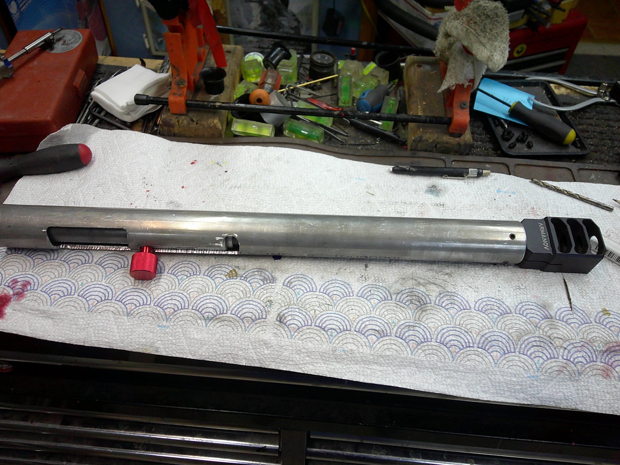

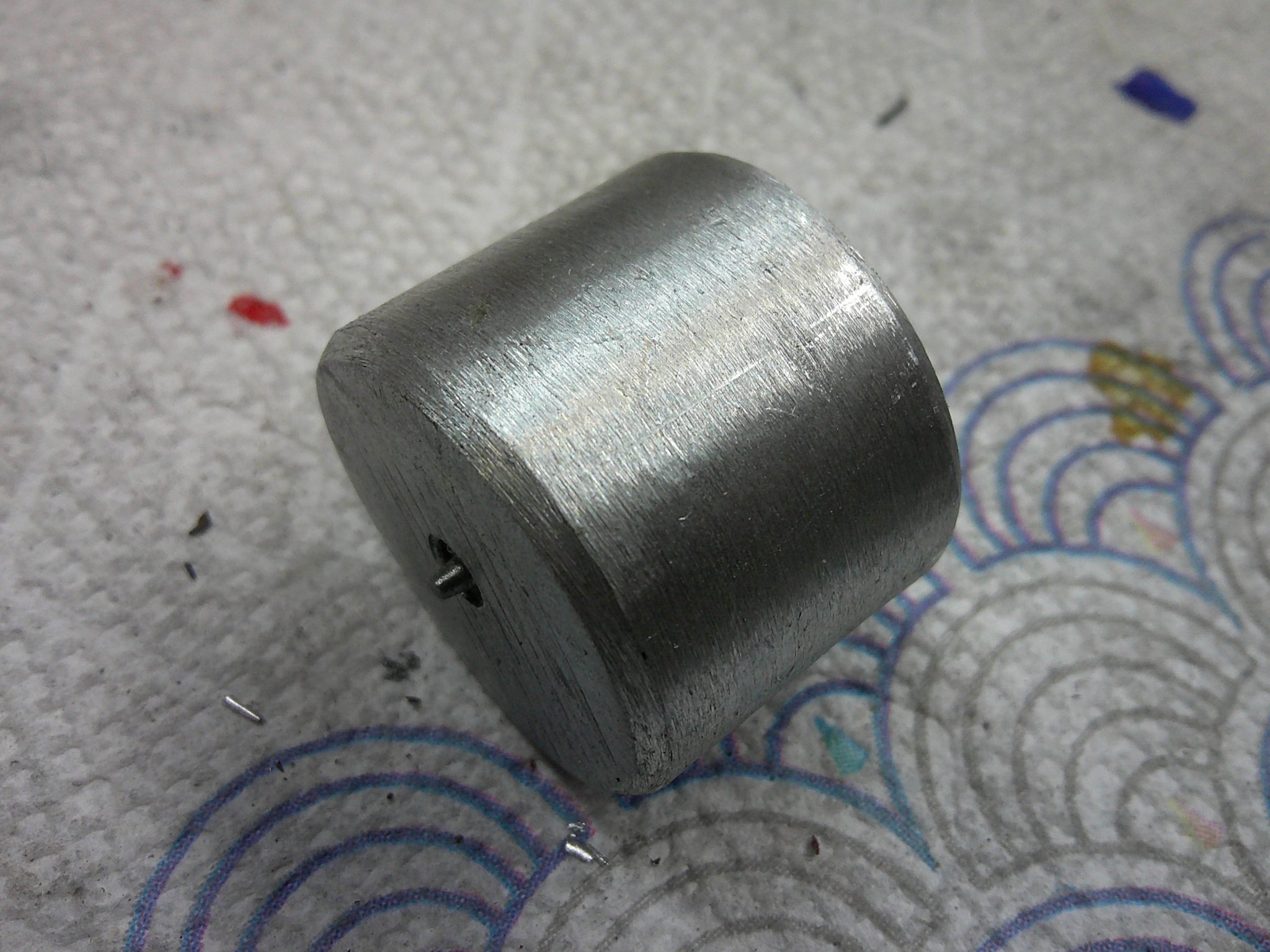

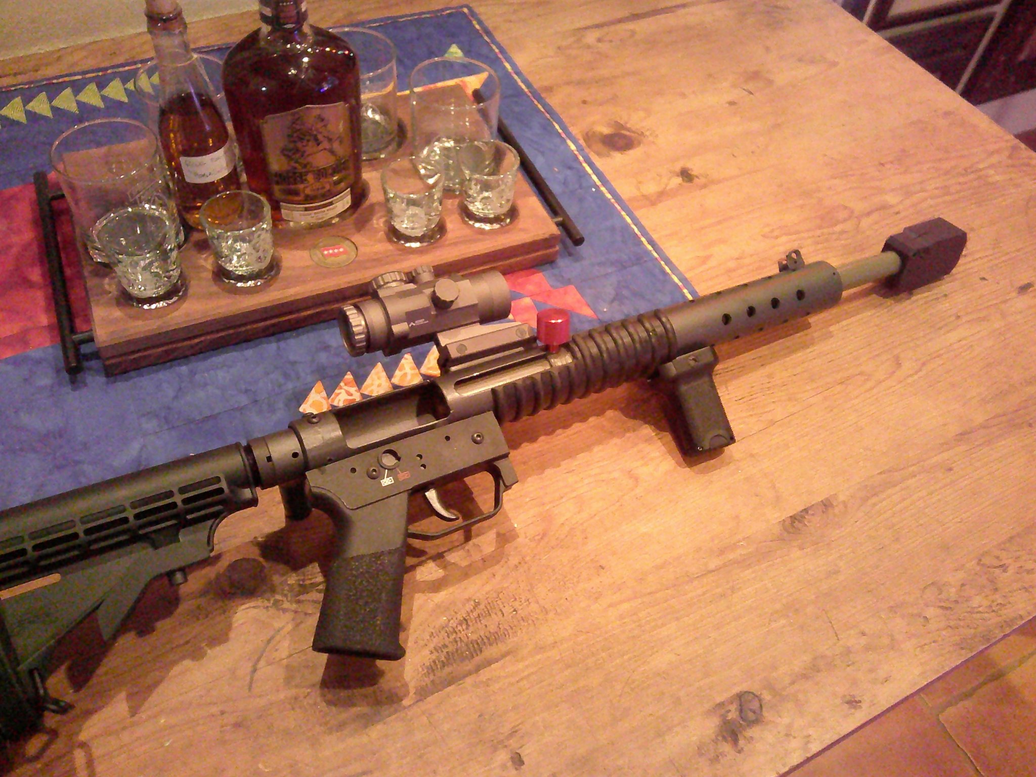

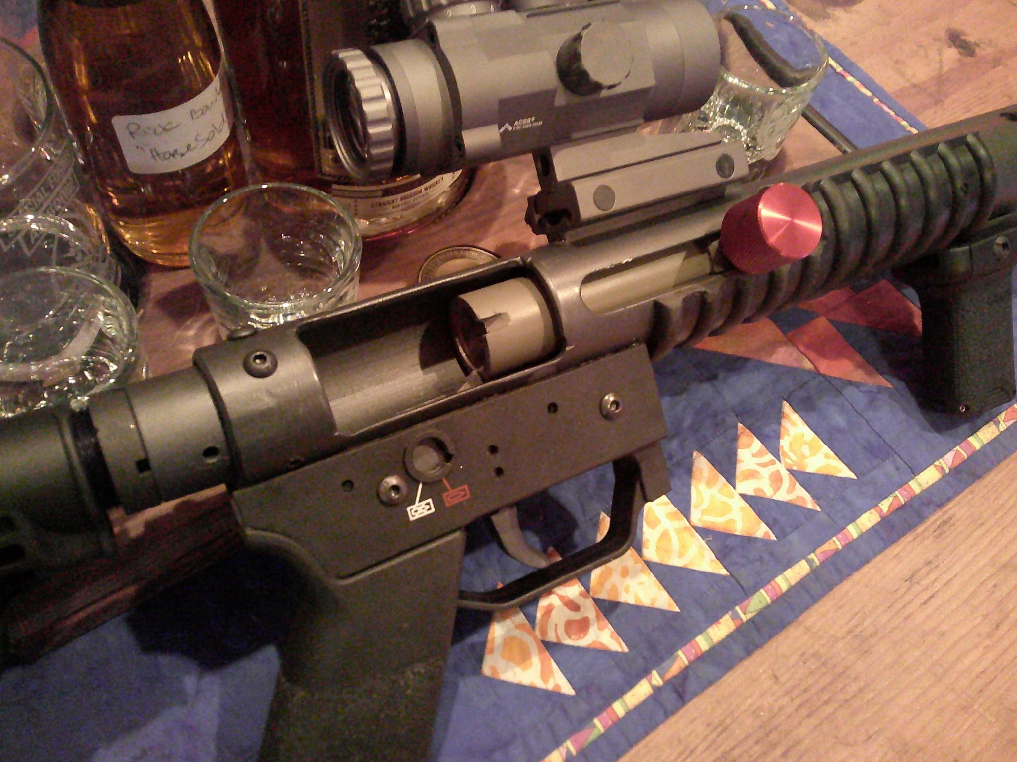

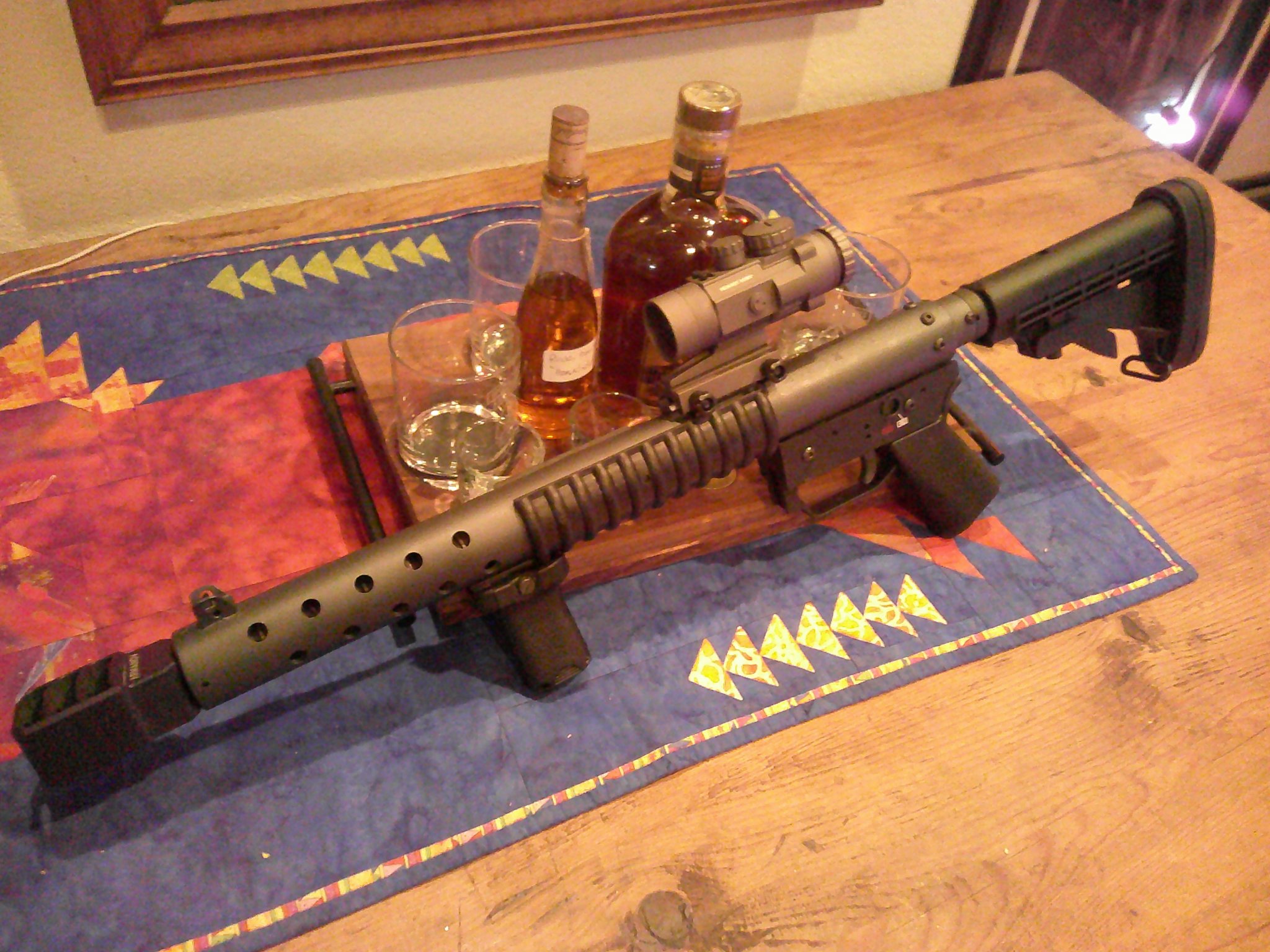

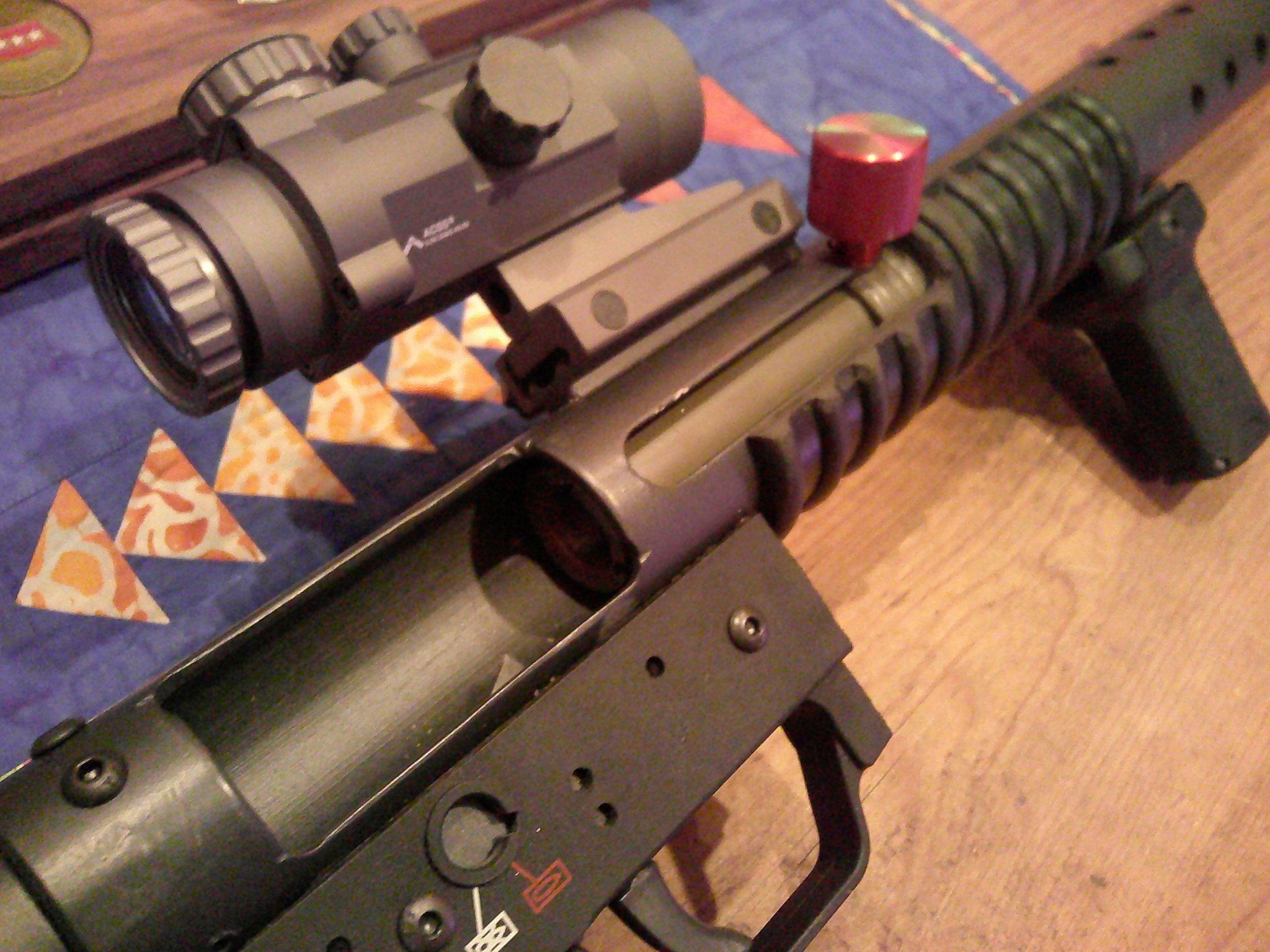

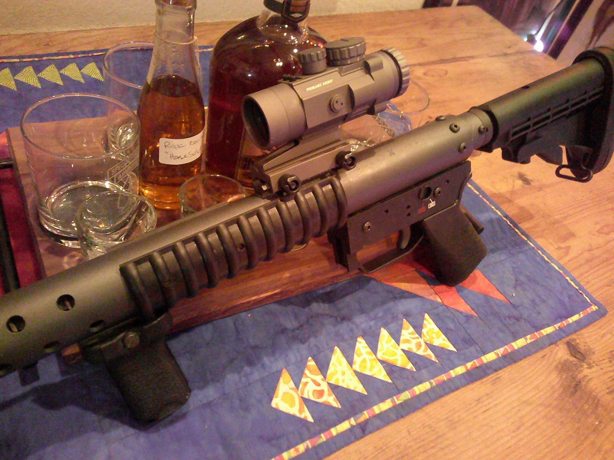

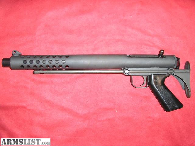

    I like to make simple guns, an interesting example is the Cobray Terminator shotgun. The Cobray is a single shot shotgun. It has a fixed breech with firing pin, often mistakenly called an "open bolt". Actually the Cobray is a unique system that is neither open bolt nor "blow forward". To fire the Cobray a shell is placed into the open port and pushed into the barrel. The barrel is under spring pressure and when released, is forced rearward into a fixed firing pin in the breech plug. The round fires and barrel is blown forward. To load, the barrel is pushed forward and rotated into a locked position A round is inserted, and the barrel is unlocked, much like an MP5, by pushing the charging handle downward. The barrel then moves a small distance rearward where it is caught by a catch. Pulling the trigger, drops this catch allowing the barrel to move rearward under spring pressure and fire. In the video below, you will see the host complain about misfires and light primer strikes. The Cobray actually has an adjustable firing pin whose depth can easily be adjusted...it is simply a threaded firing pin locked in place with a set screw. My improvements include a more ergonomically placed charging handle, an extractor, muzzle brake, and sturdy folding butt stock. A marketing failure, and universally hated, the Cobray now commands collector prices of around $1400.
    The original Cobray
    The Cobray Terminator

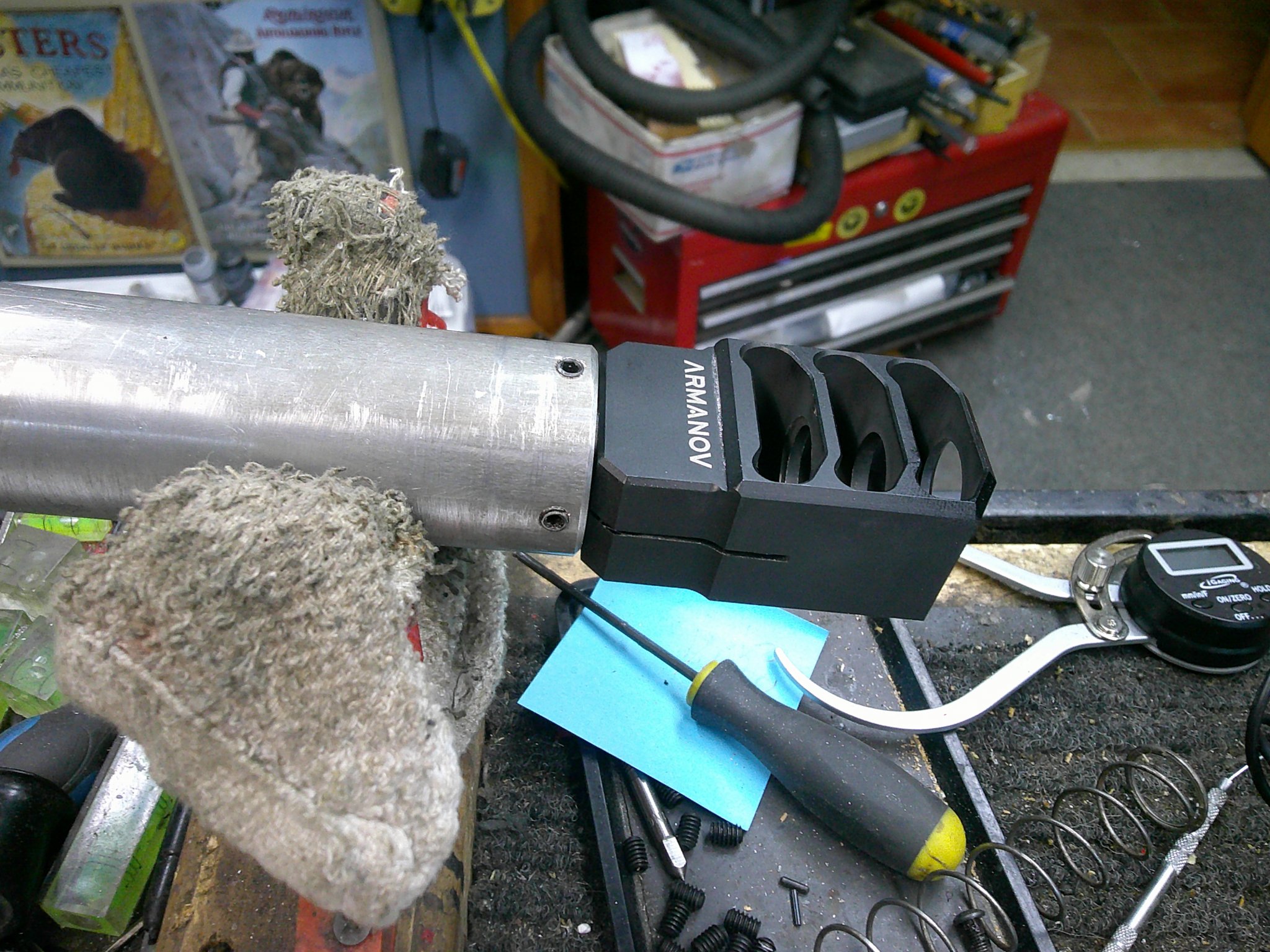

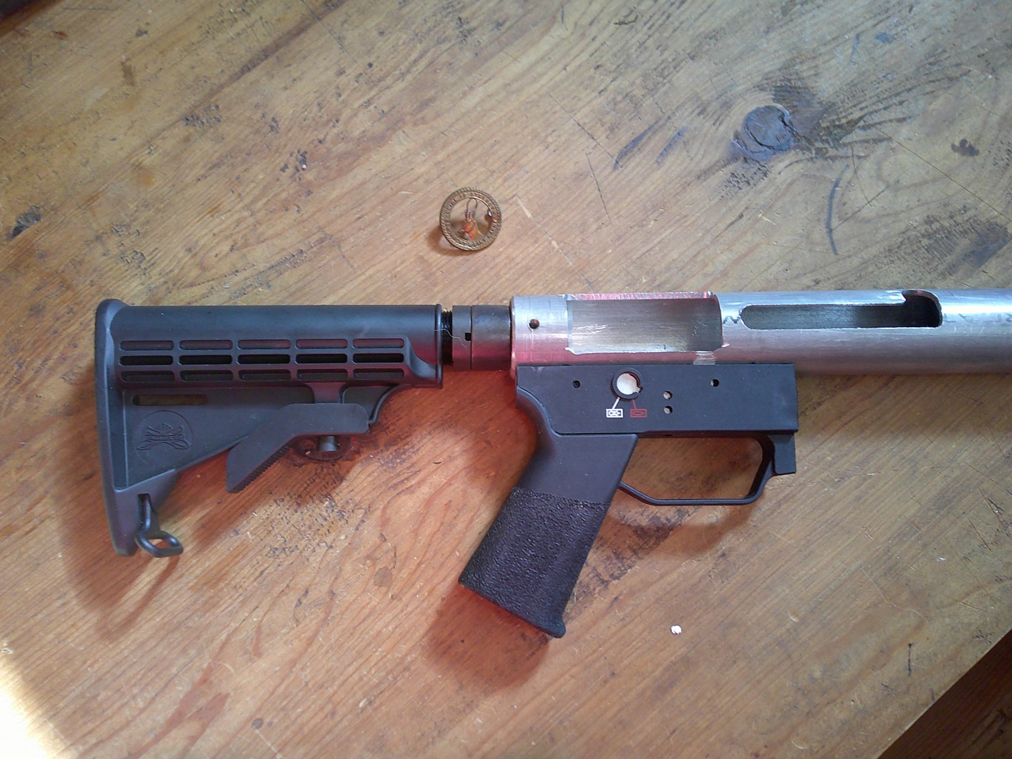

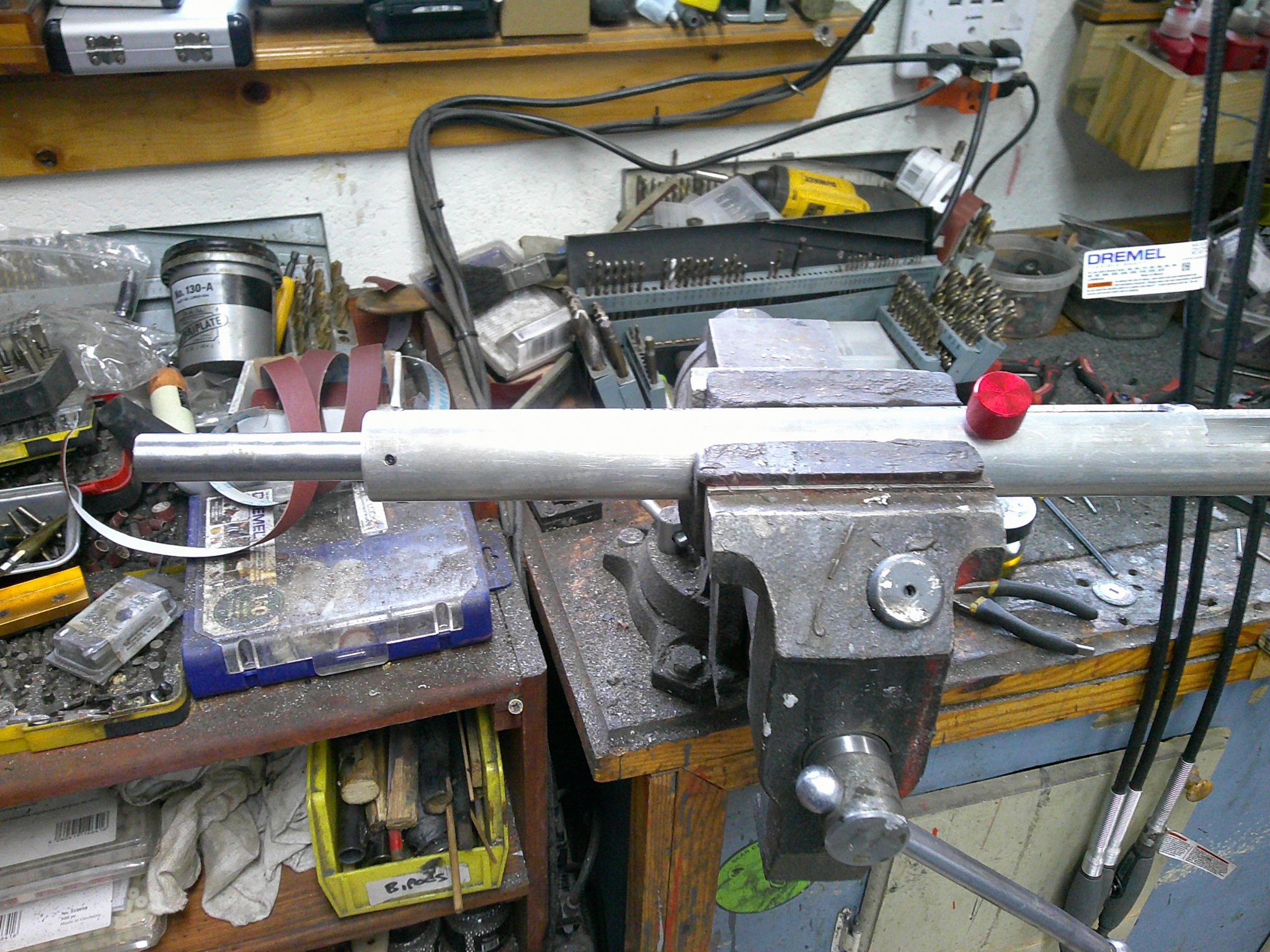

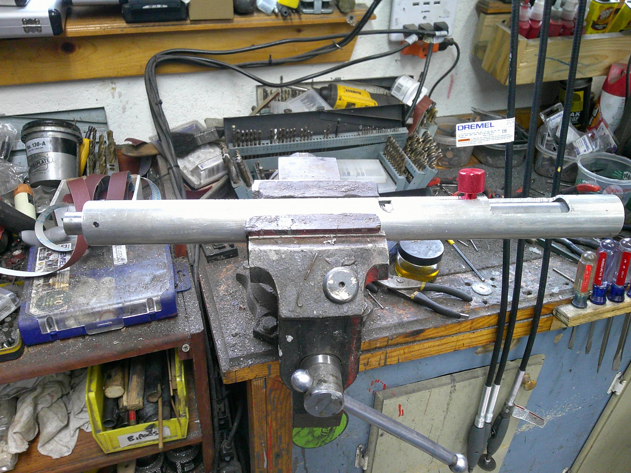

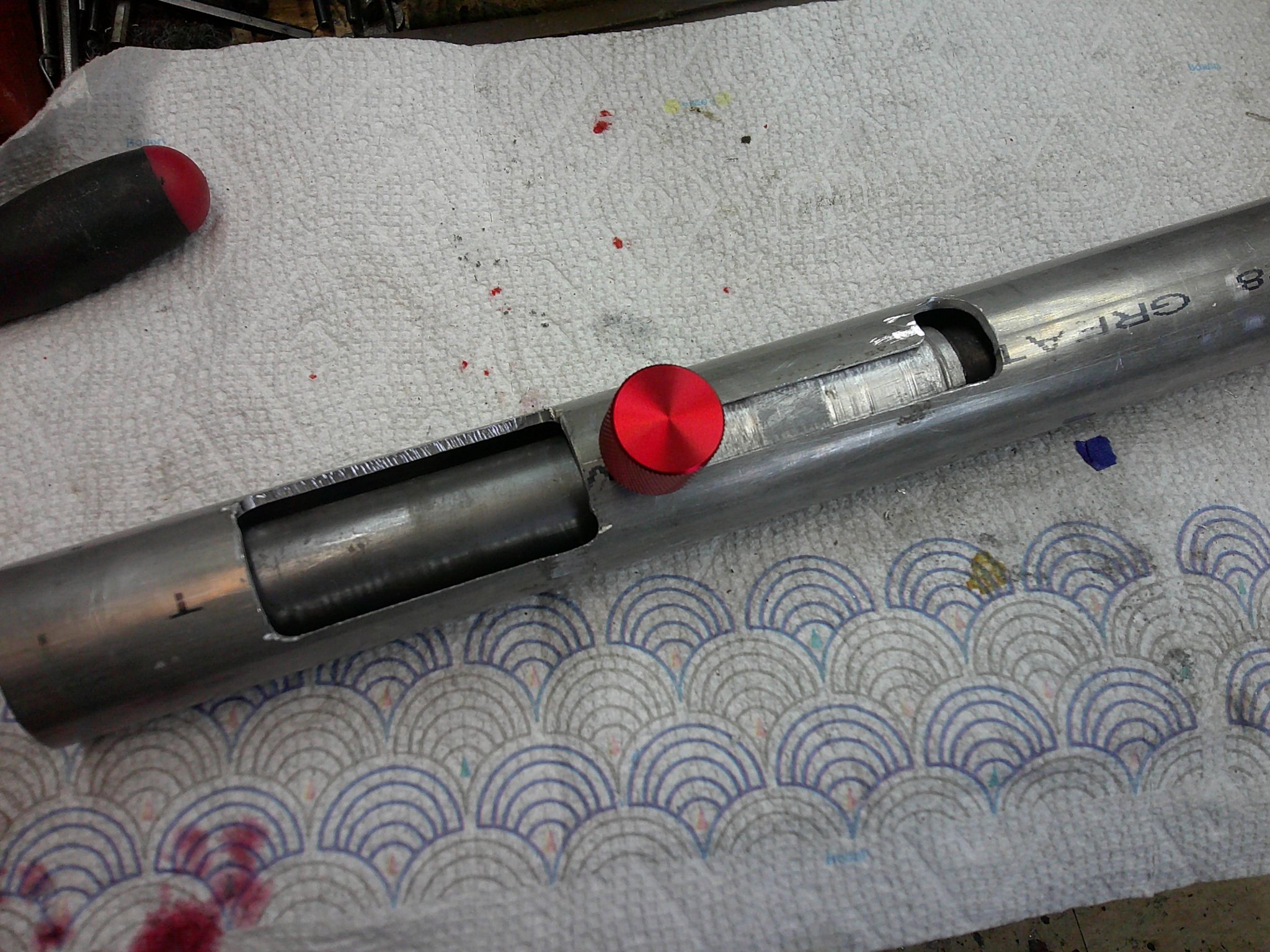

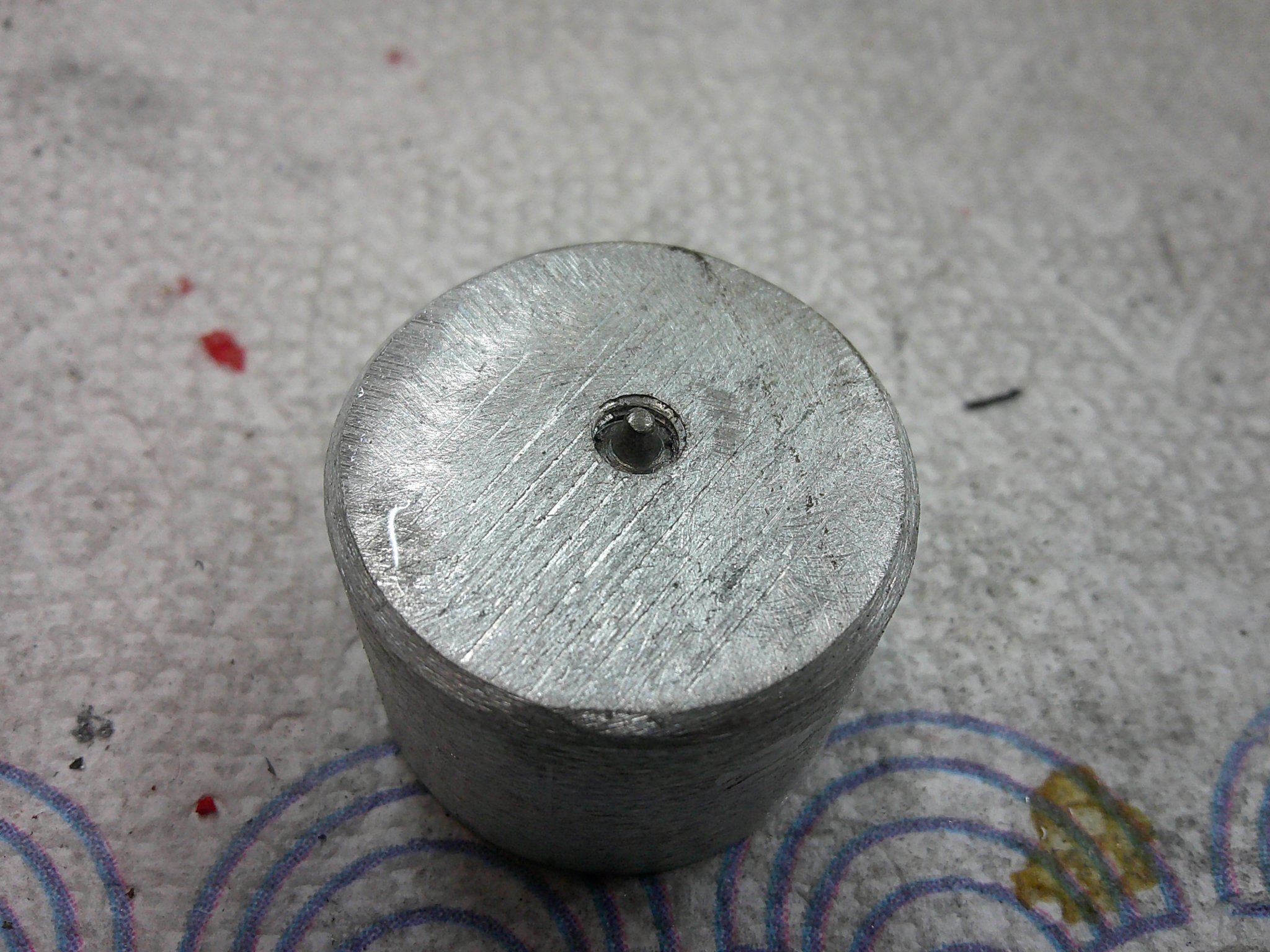

    Work in progress.

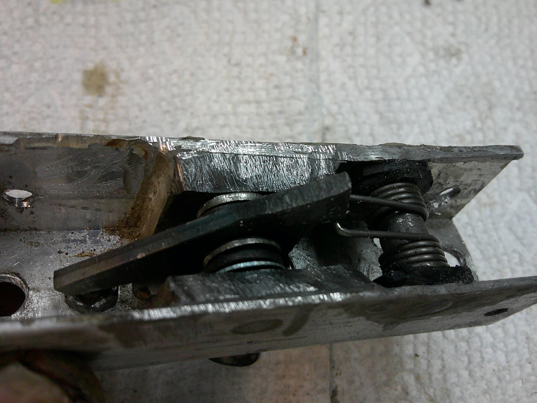

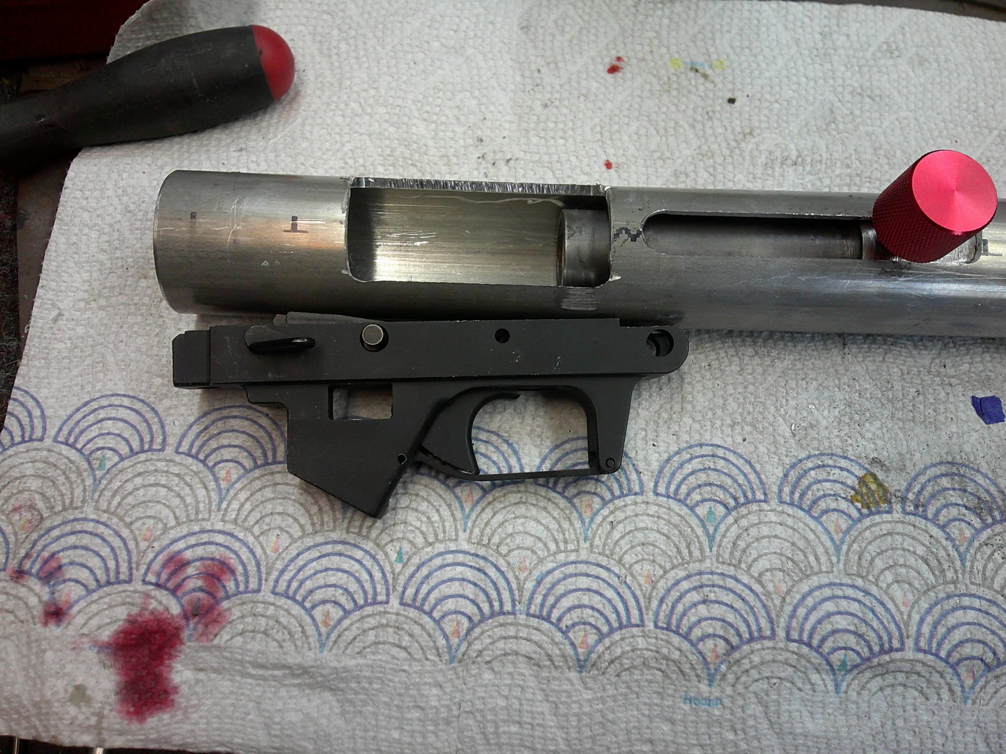

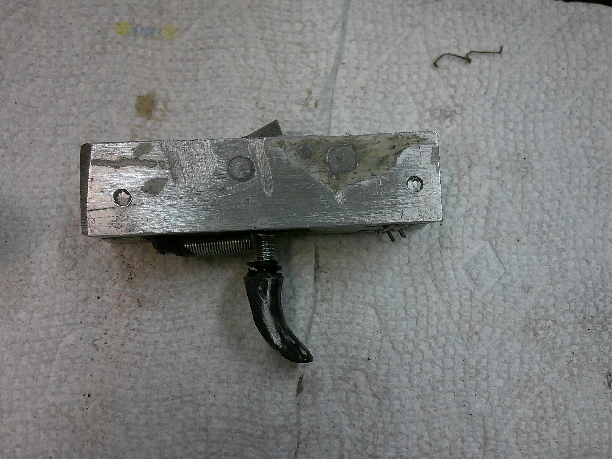

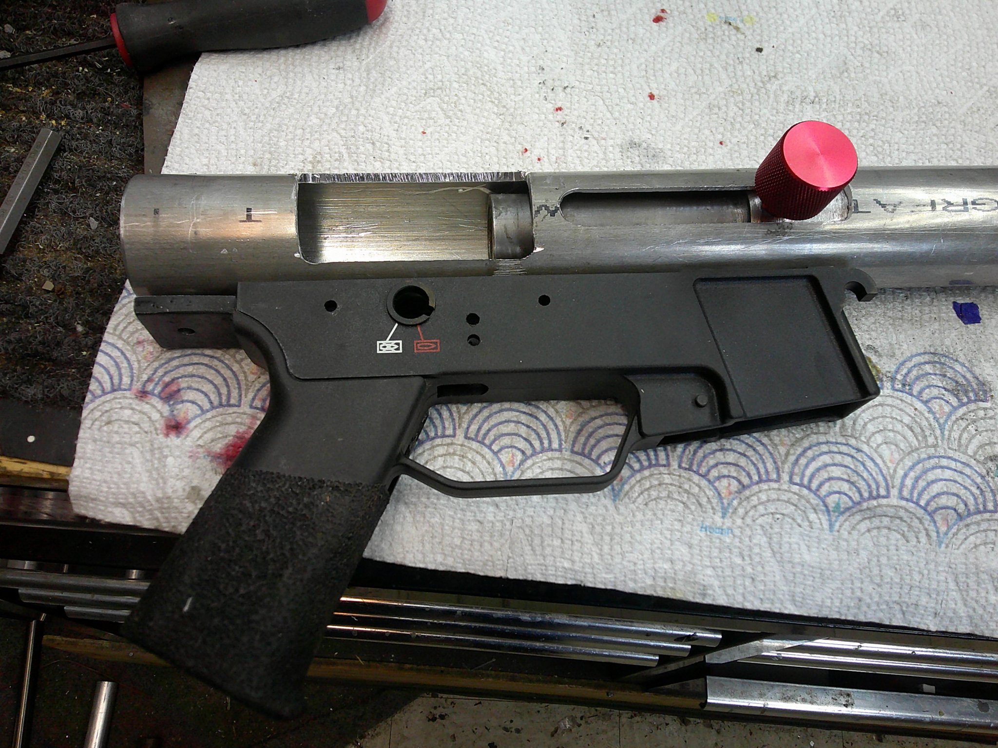

    Possible trigger housings.

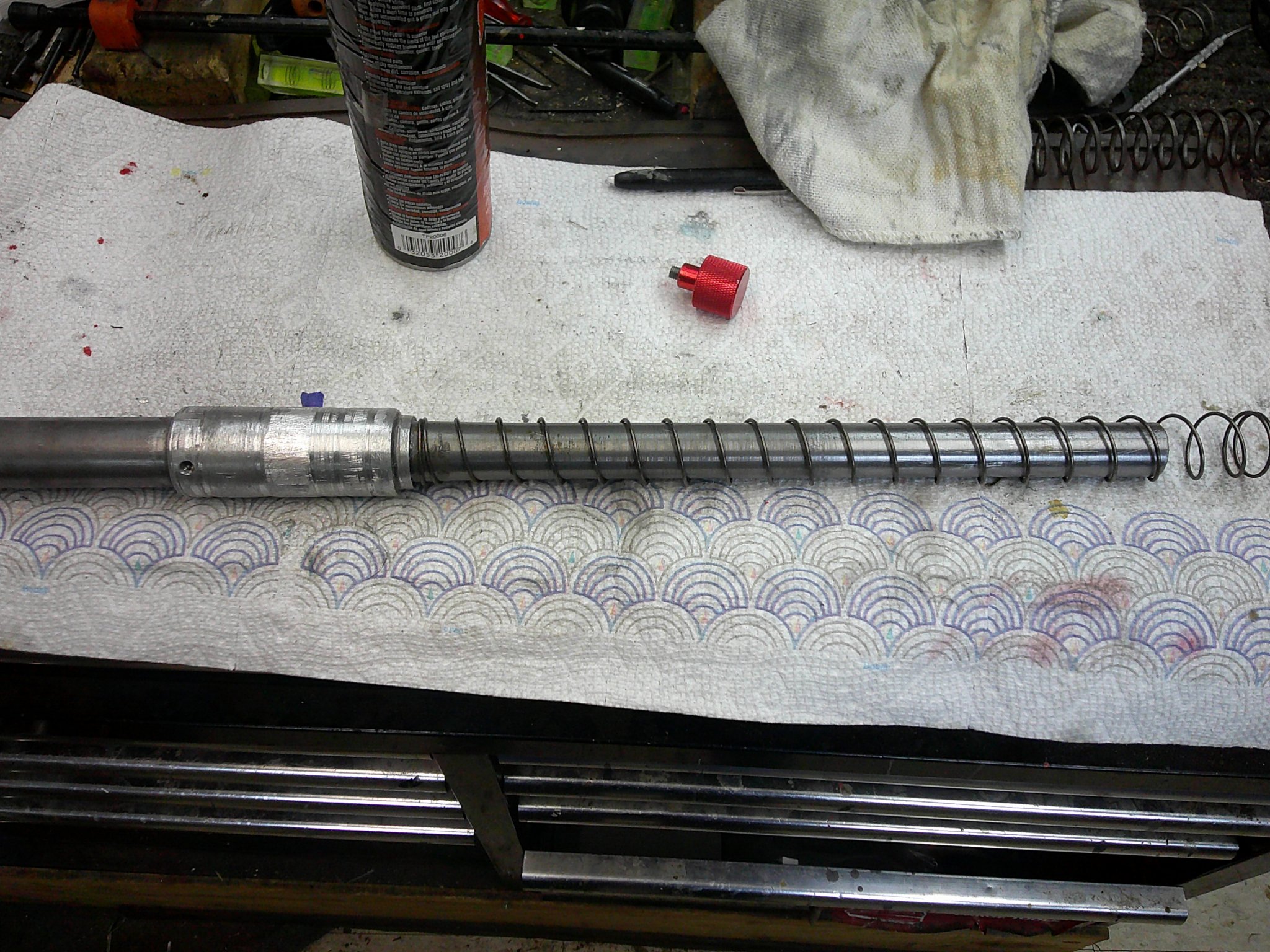

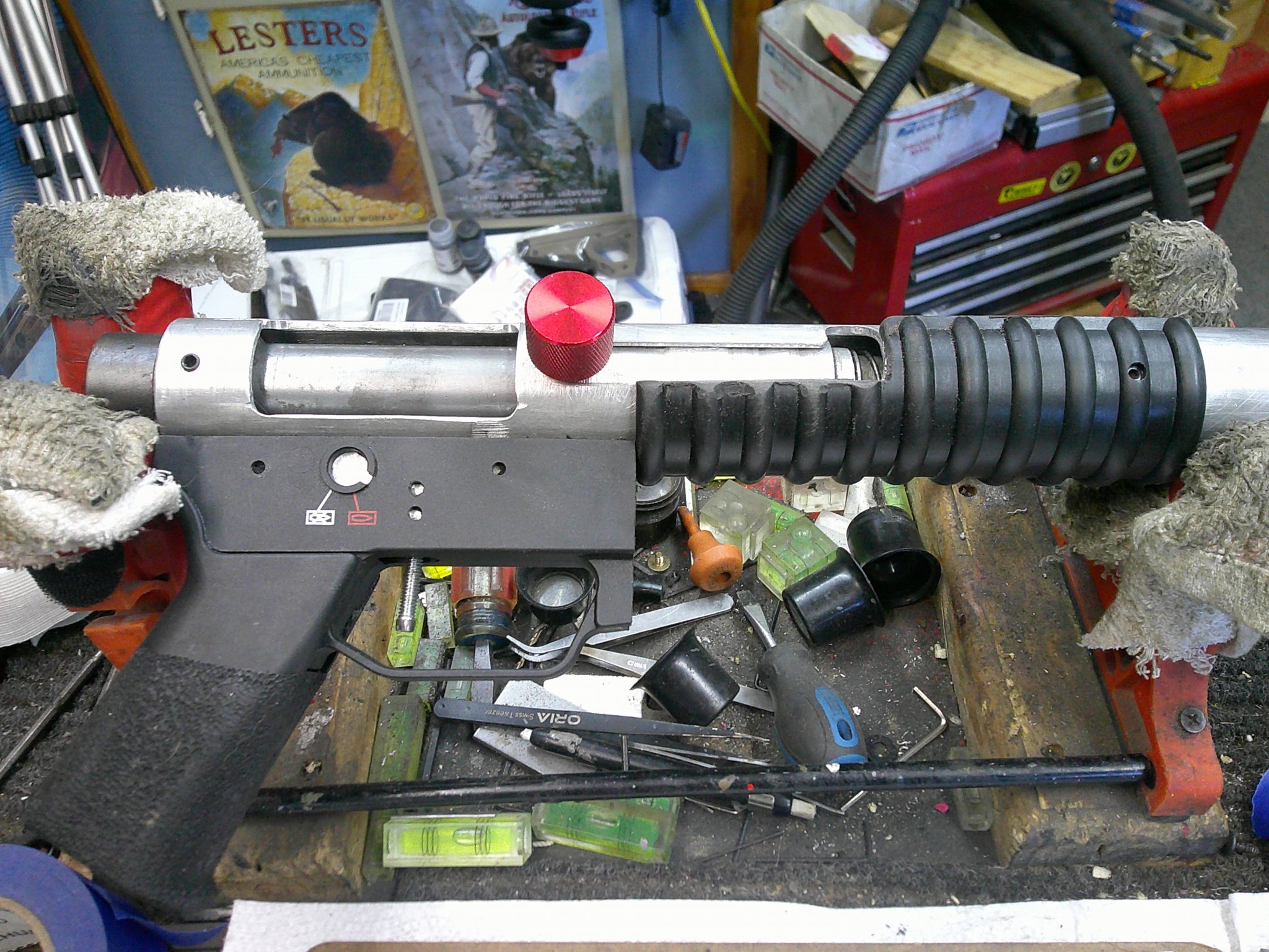

    Work continues...

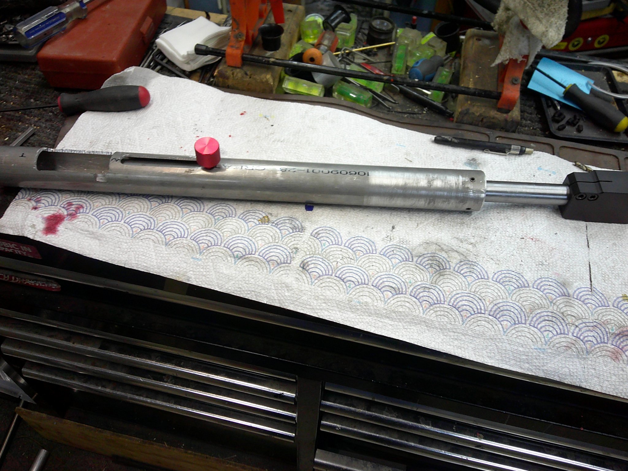

    Trigger pack
    Yes, that's an AR-15 trigger spring being used as the sear spring

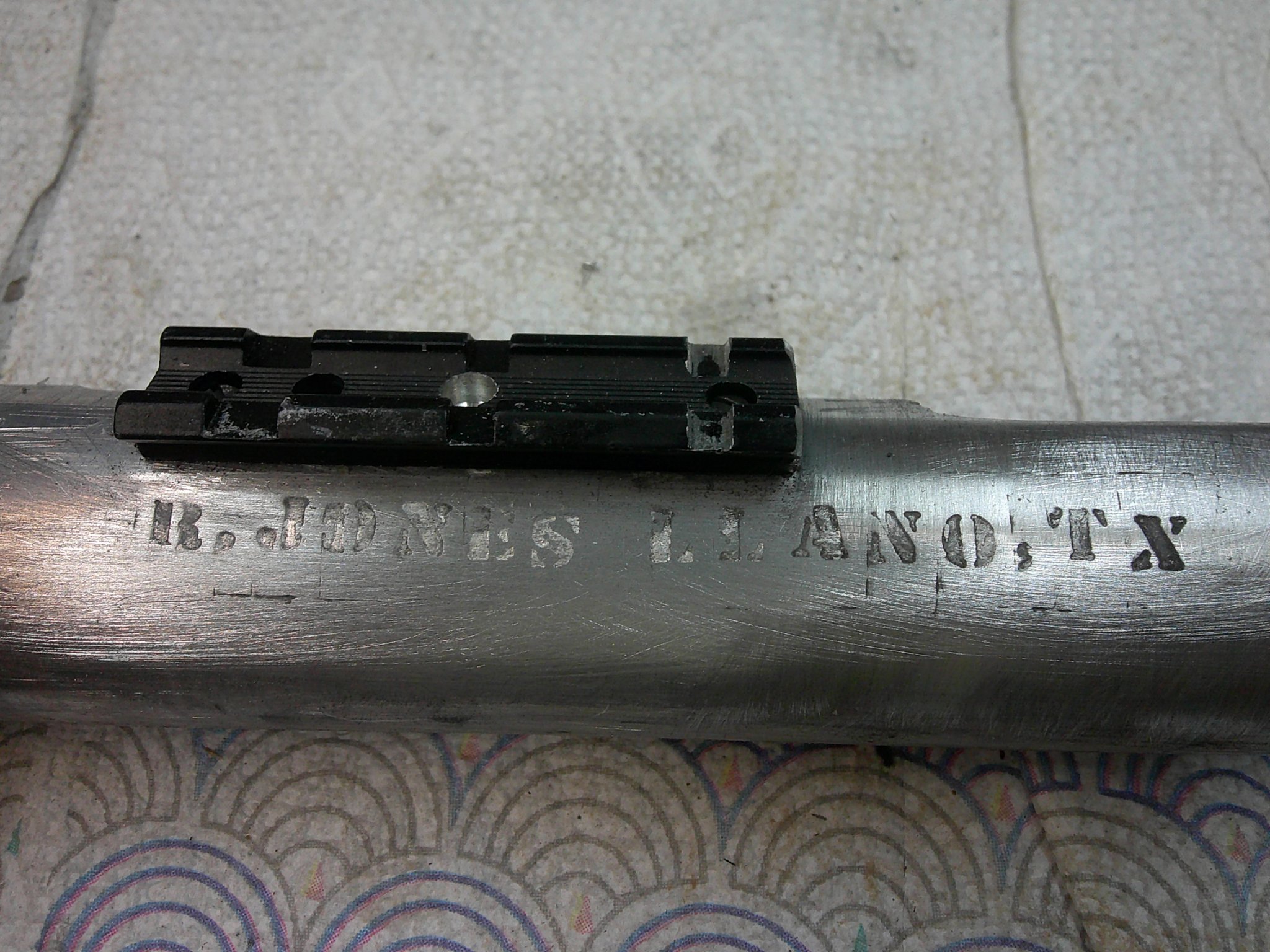

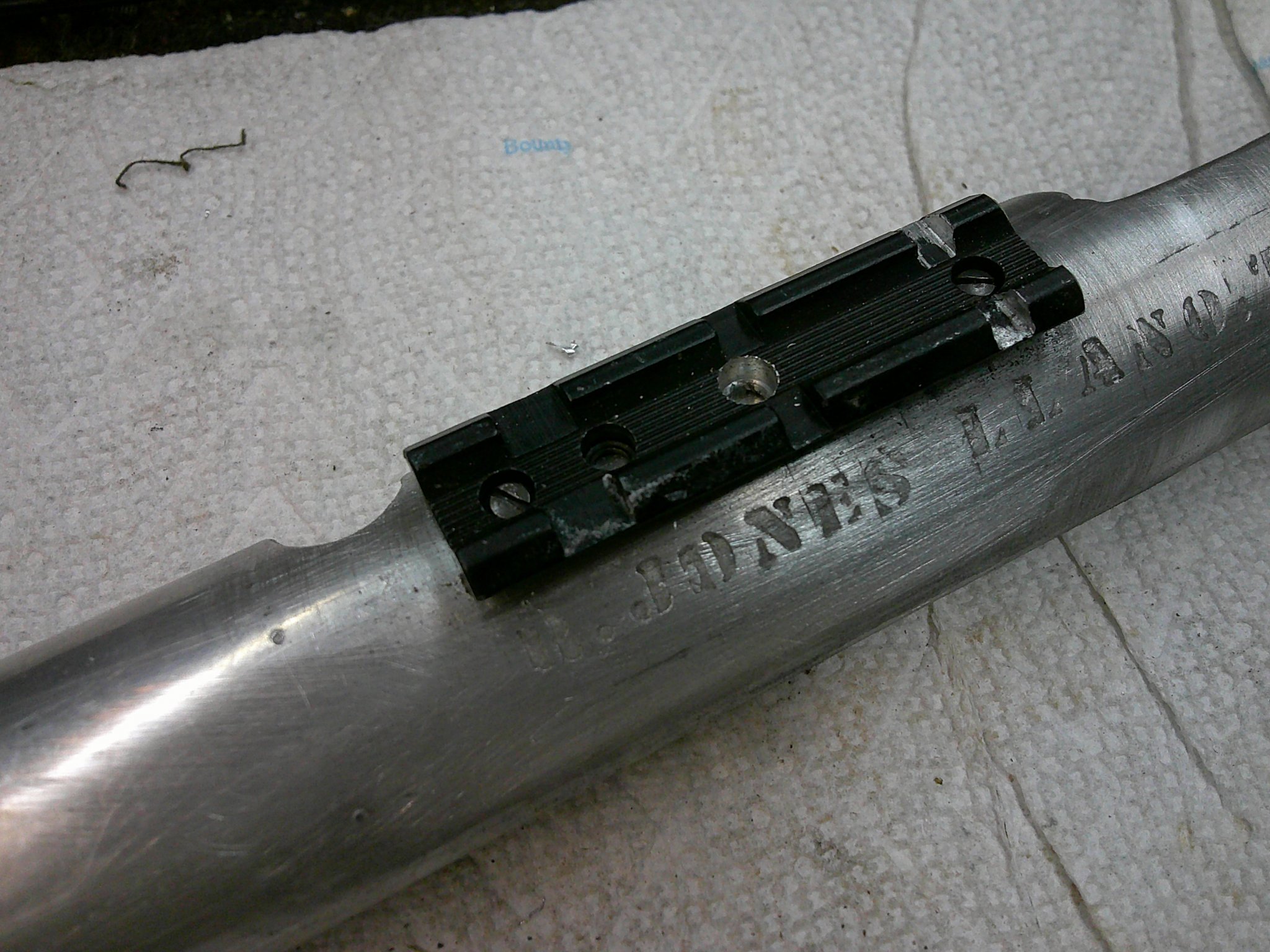

    Maker and Serial number

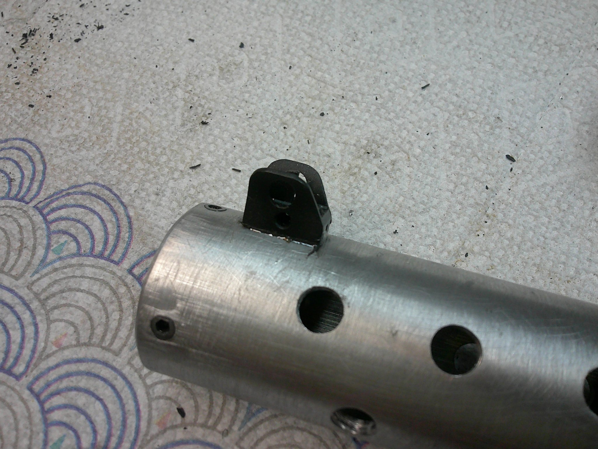

    Modified M1 Carbine front sight
    Picatinny mount

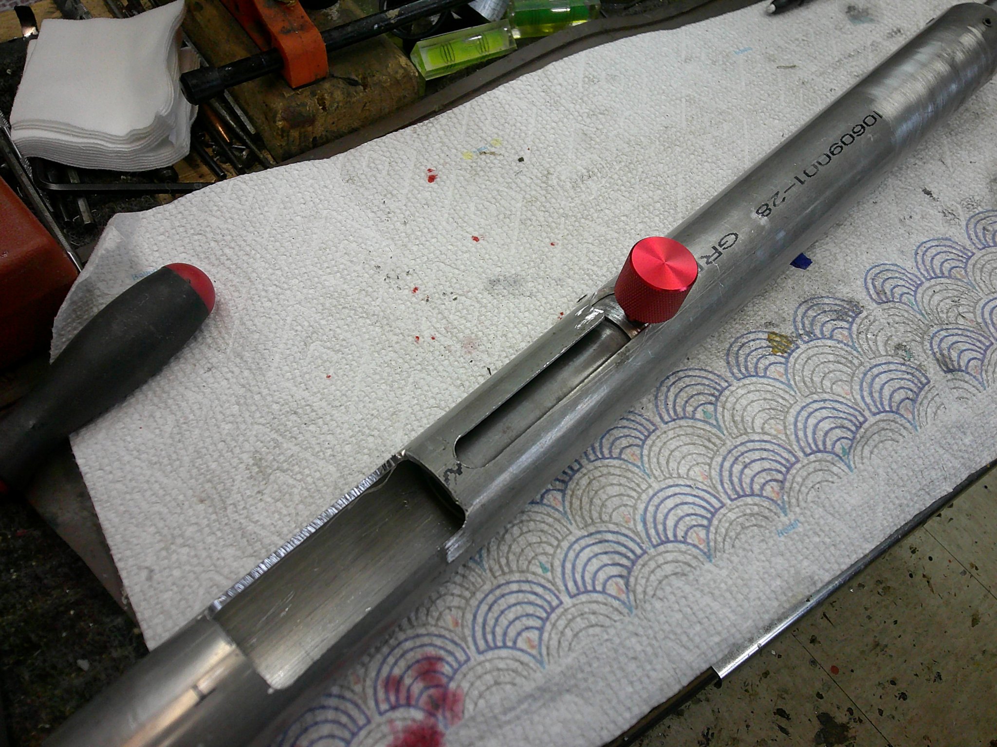

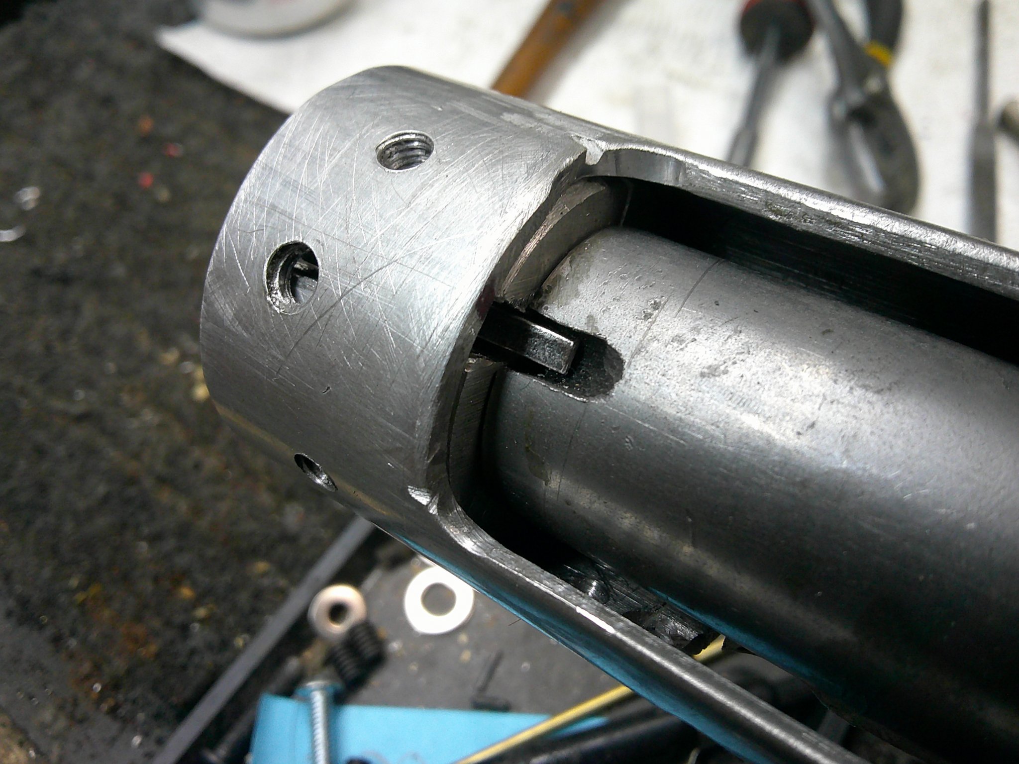

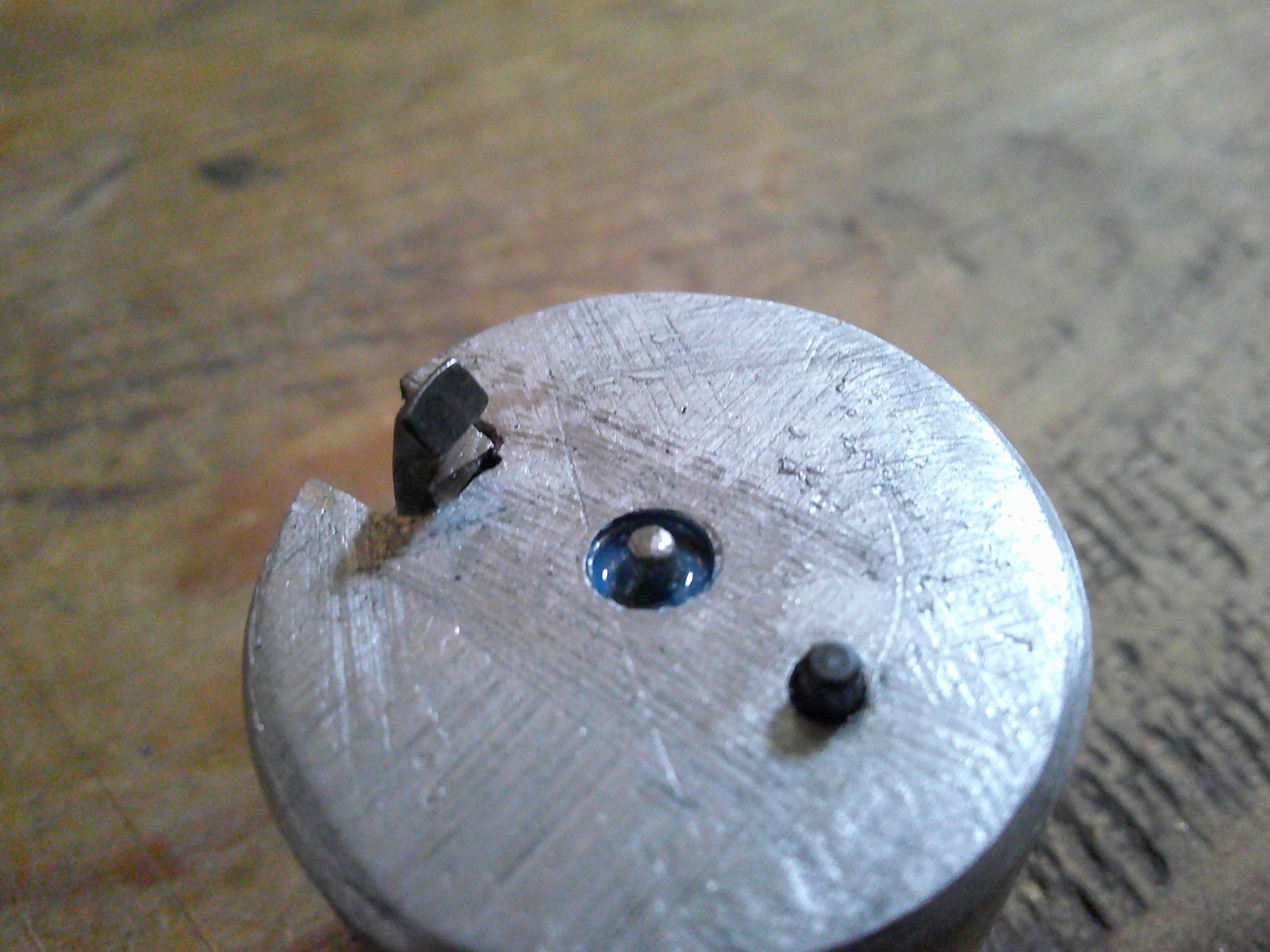

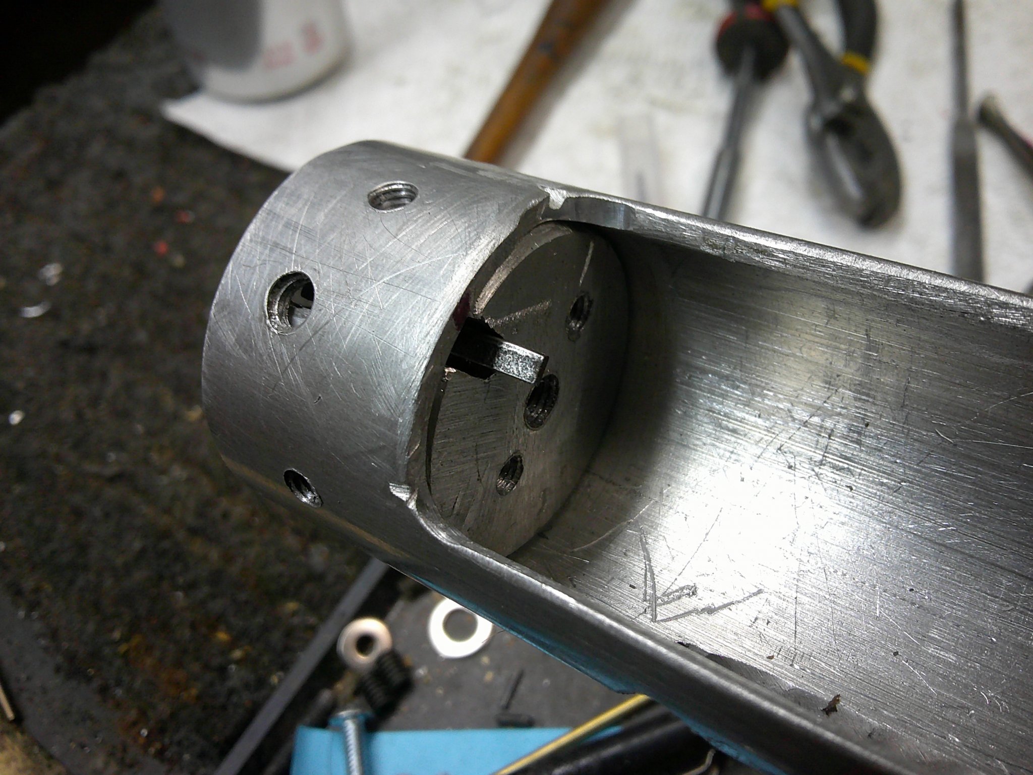

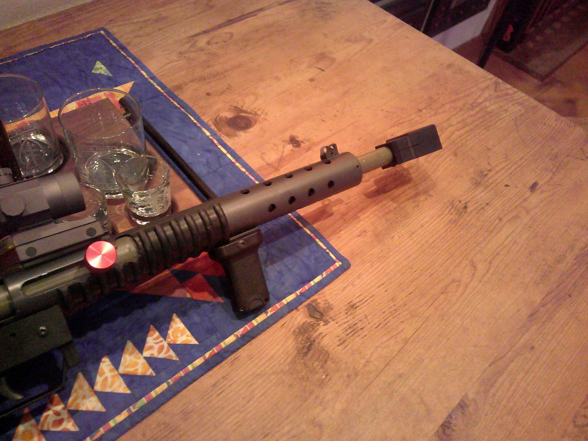

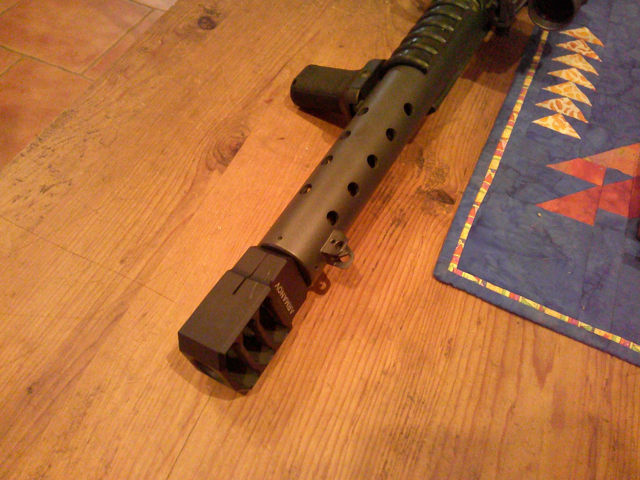

    I'm on the third iteration of making an extractor. I think I'm going to have to go with dual extractors. I tried a simple ejector without much success. I don't want to have a complicated solution. I think turn to the side and dump the empty may be the best solution for a single shot shotgun.
    I have one question about your build here. One key difference with the terminator is the what appear to be a lack of a “bolt hold close” in your build? Or am I missing it?
    The terminator has that small spring loaded lever that pushes against the ejection port when the barrel is pushed fully back. I assume it’s to manage and risk of the barrel flying forward from something like a case head rupture. Does yours have a hidden one somewhere not visible?
    The "barrel lock" on both guns is a "safety" notch like on a STEN gun. It holds the barrel open for loading and then released so the barrel can move rearward where it catches the sear. There is not enough pressure in a shotgun shell to overcome the barrel spring and cause the barrel to be shot off the frame.
