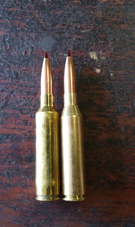

20170830_165832-1.jpg About to make another 300 norma mag. Lighter for hunting purposes. I already have improved version 35* with all reloading components..
Should i standard or improved?
Pros and co​​​ns between the two pls.
