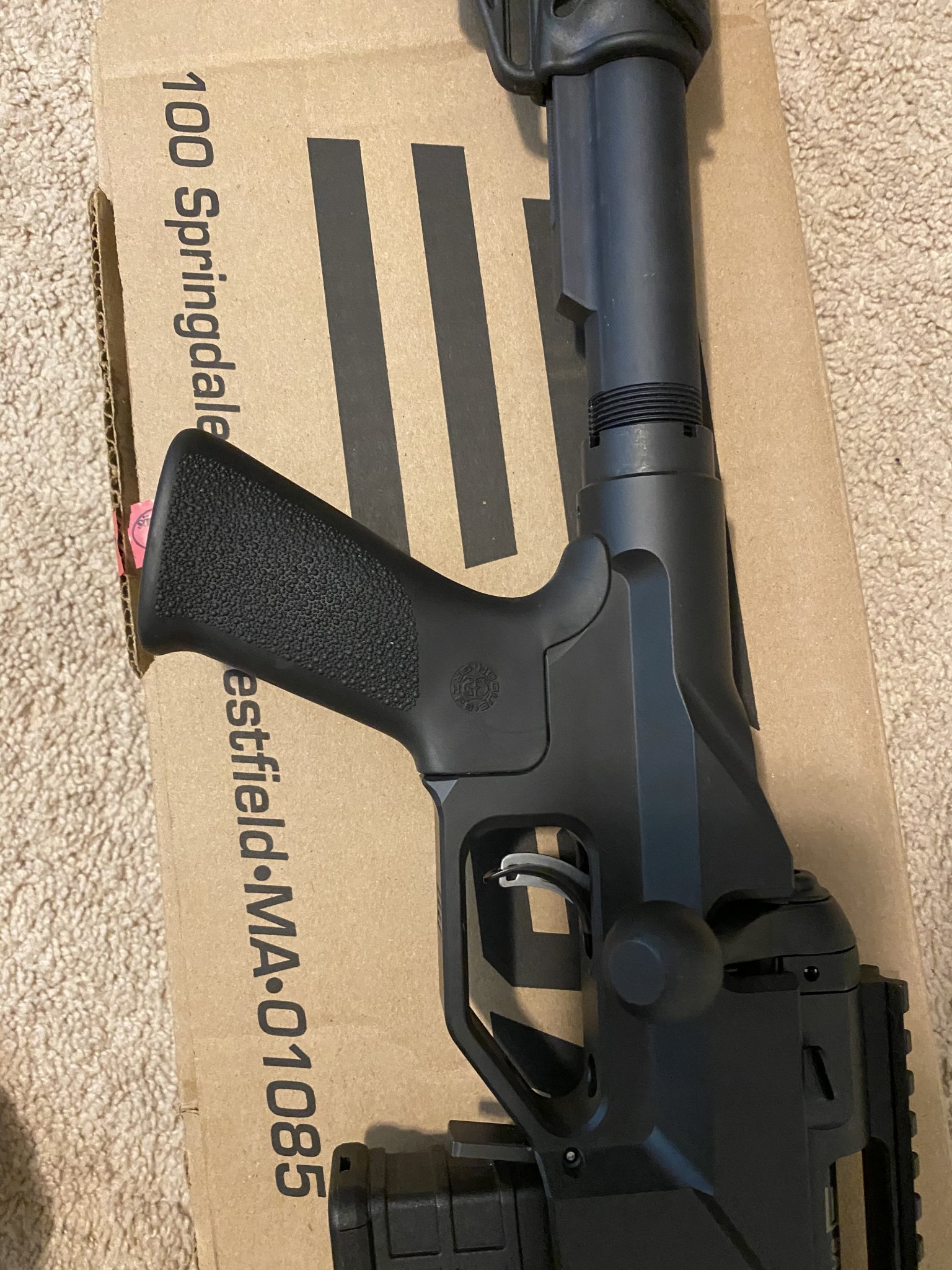

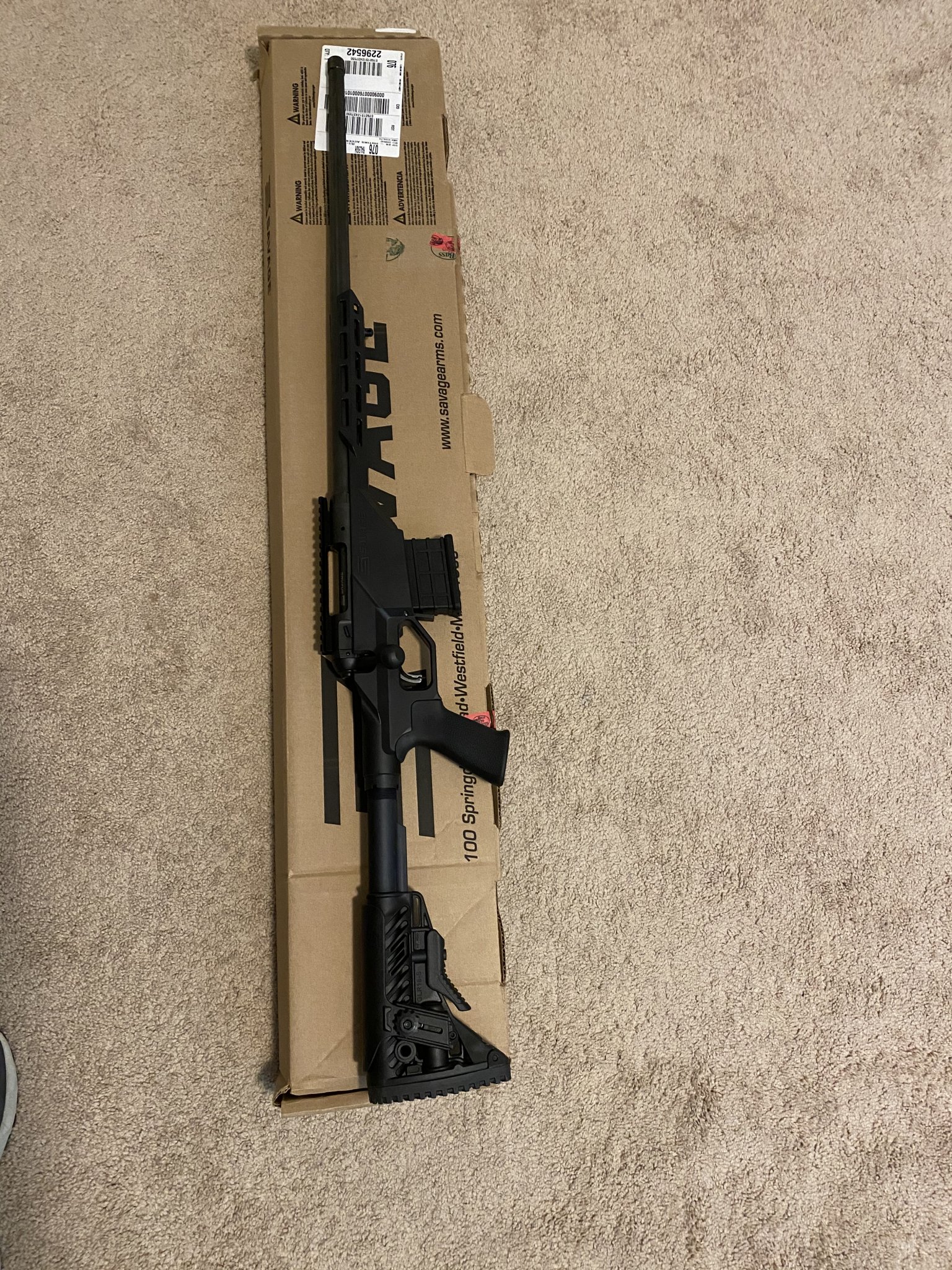

I saw a Savage 10 BA stealth in 6.5 Creedmoor marked all the way down to $600 still brand new and ended up buying it. Hoping I’m. Not going to regret my decision even though it was marked down so much. I know this model was replaced by the Evolution and now the Savage Precision Rifle which is why it was probably marked down so much. This is my first “chassis” rifle and I have a few questions. My only other precision rifle is a Rem 700 in 6.5 Creedmoor in a KRG Bravo.
Stock: Already have a Luth AR Rifle length buffer tube and stock sitting around I’m going to swap for the one it came with.

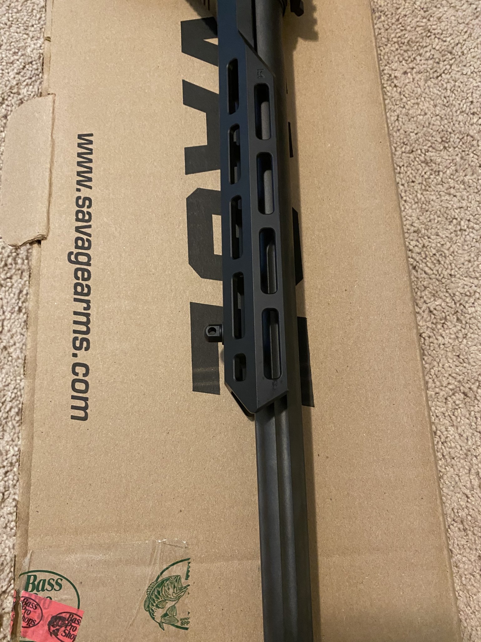

Mounting a bipod further forward: the hand guard isn’t that long and I think I’m going to want the mount a bipod further forward. Can I just mount a long ARCA rail to the bottom of the handgun via the M Lok that sticks out passed the end of the hand guard? Any better ideas?
Pistol grip: wanting a more vertical grip preferably that also has a large palm swell. Recommendations? I really like the grip on my Bravo but not sure if I can get a similar feel.

I went ahead and ordered a Arca rail I can attach to the M Lok attachments on the bottom that will extend 2 inches past the end of the hand guard. I’ll try that out and see if it’s rigid enough to support a bipod well

Few easy things you can do out of the box. Get the tactical bolt handle...gives you a lot more leverage. I like to cut the safety blade spring down until it just applies some pressure. Not sure if that model has the brown varmint trigger spring? If not get one and turn it down to the ~1.5 lb minimum weight. A bolt lift kit does work a little bit and will reduce the cocking effort by ~1/2 lb. LaRue has some cheap AR style grips with palm swells and good checkering. If you don't care about the front sling mount you can get crafty and put a pic rail right up the edge for a bipod.
