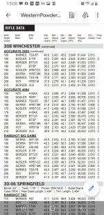

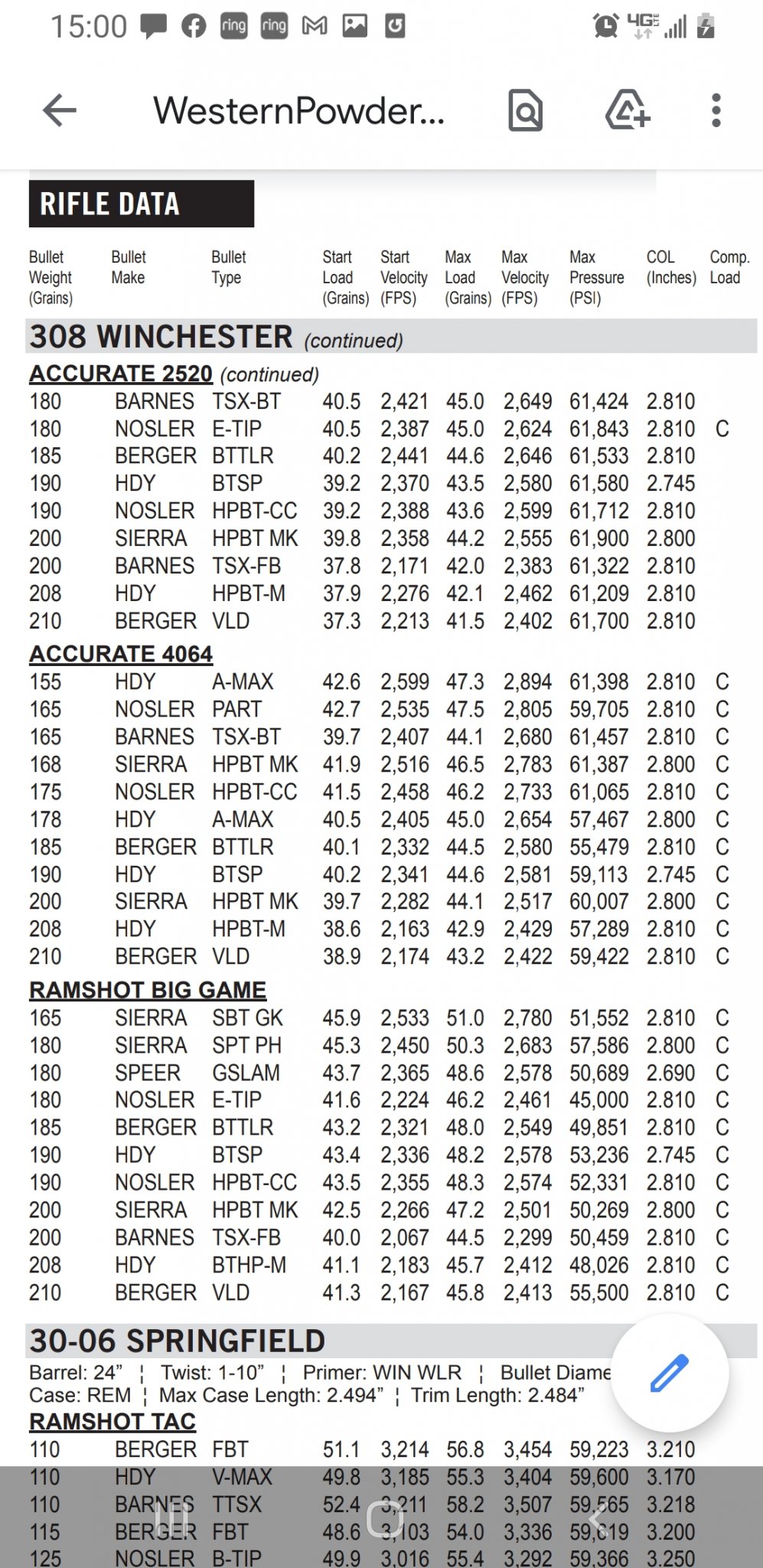

Thats weird western website load data manual shows 41.5 min 46 max for 175gn projectiles
I sure do. Looks like someone is paying attention. Has that much changed with the powder since 2014?
IMR 4064 and AA 4064 are not the same burn rate.
Make sure comparing IMR to IMR, not IMR to AA.
Brass can influence charge weight as well.
No, burn rate of powders hasn’t changed appreciably in last 7 years for IMR 4064 / AA 4064.
