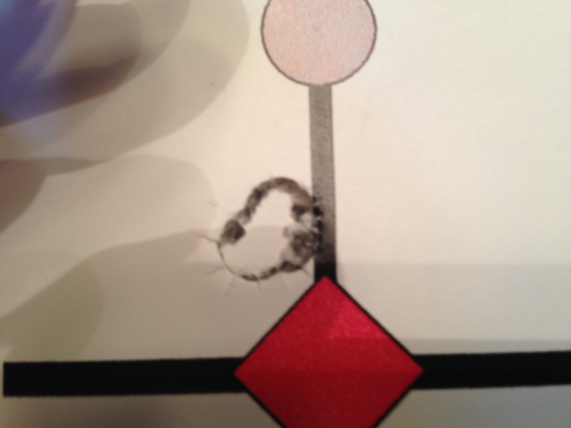

My AO build shoots groups like this with 4064.
