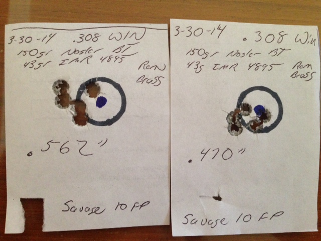

For years I have used 43gr of IMR 4895 with 150gr Nosler BT or 155gr Hornady A Max. It is a very mild load, but they have shot very nice in 4-5 different Savage bolt .308's.
Have used this with Remington and Winchester brass w/ Win LR primers.

I think Clark is spot on. While I have not shot this load at distance, it is the most accurate 100 yard load I have shot out of any of my .308's. There are far superior bullet/powder combinations that will hold up at further distance, but for shooting 100yd groups this one is tough to beat. For me, at 100yds it rivals 44gr of Varget and the 186SMK. The first group even included my cold bore shot as 1 of the 5.
And as far as the .243 goes, Clark and I are on the same page as well. One of my favorite loads is 39.5gr of IMR 4895 with a 70gr Nosler BT in Win brass.
