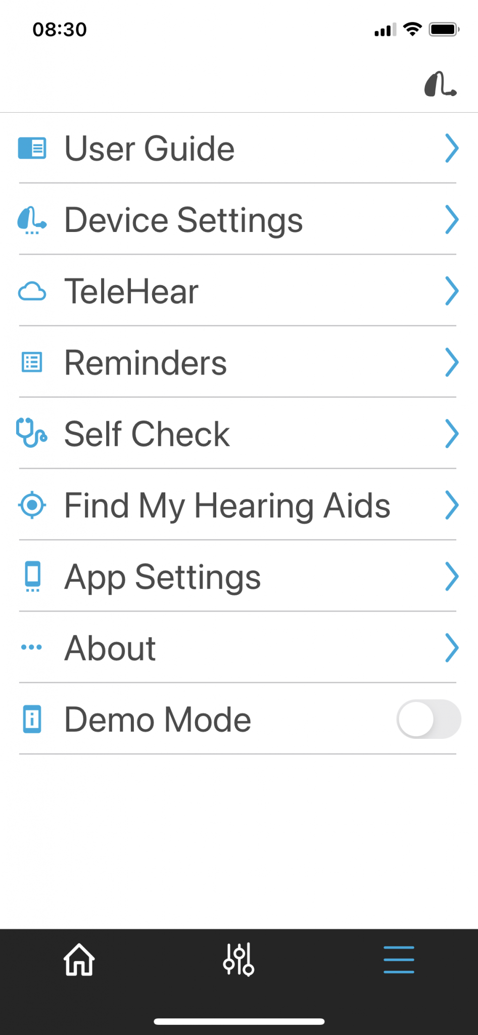

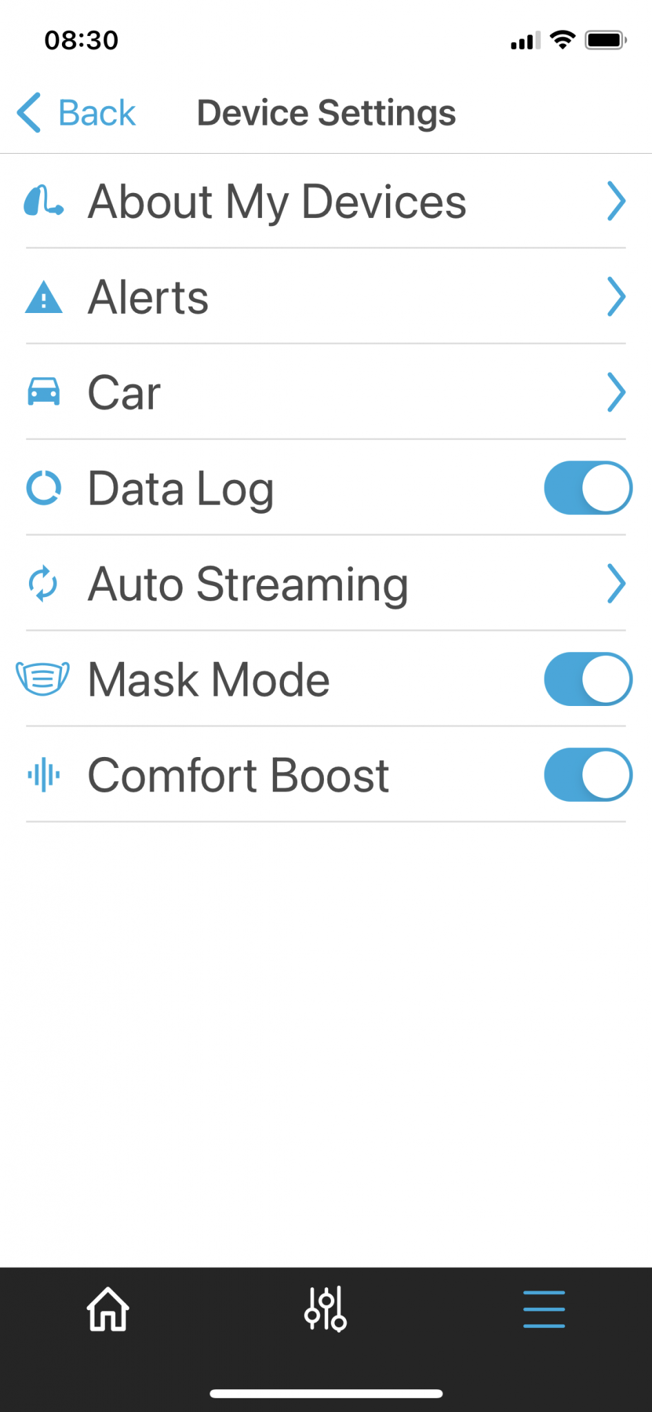

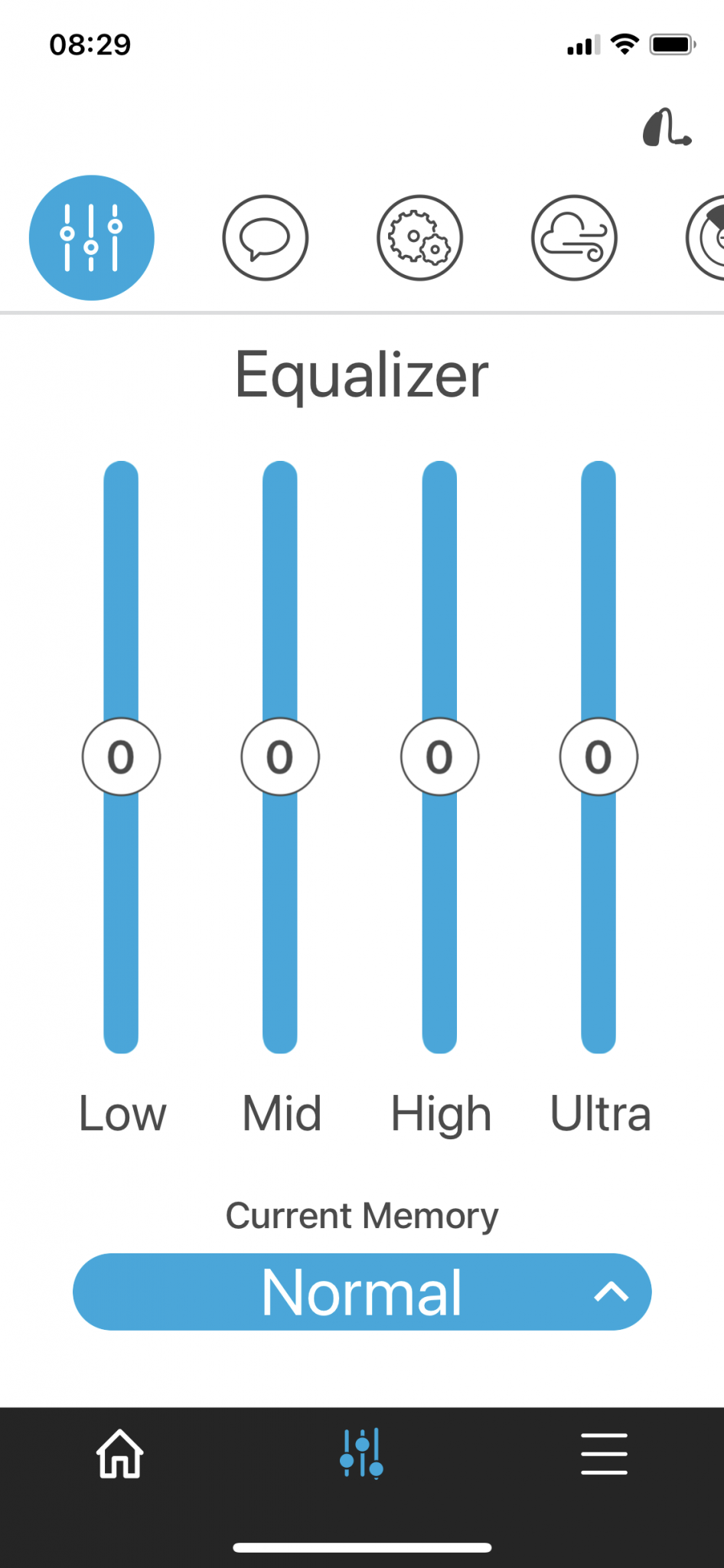

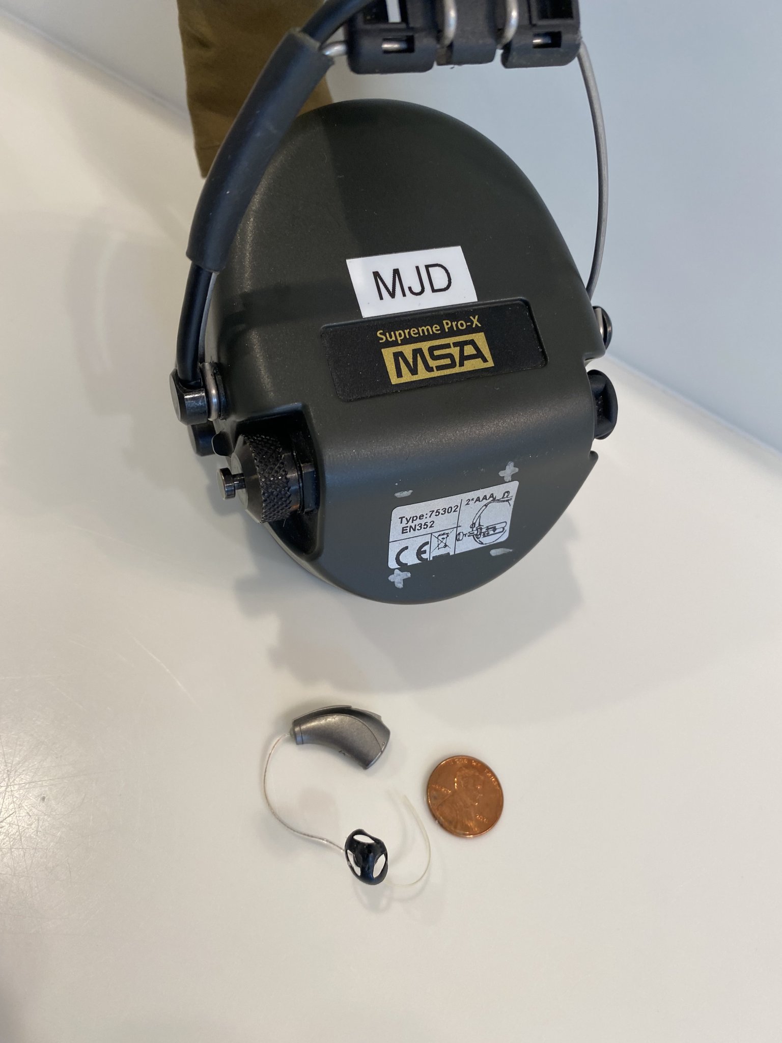

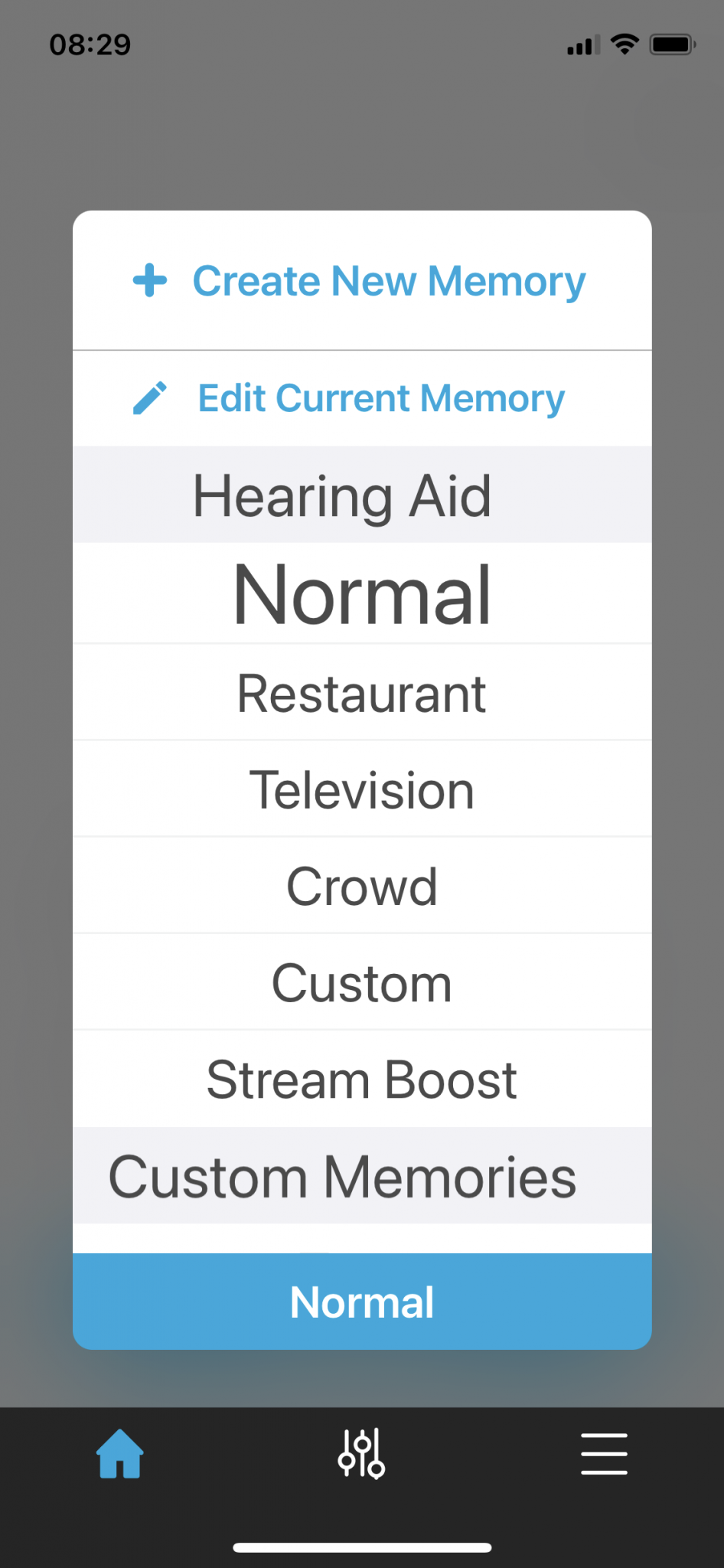

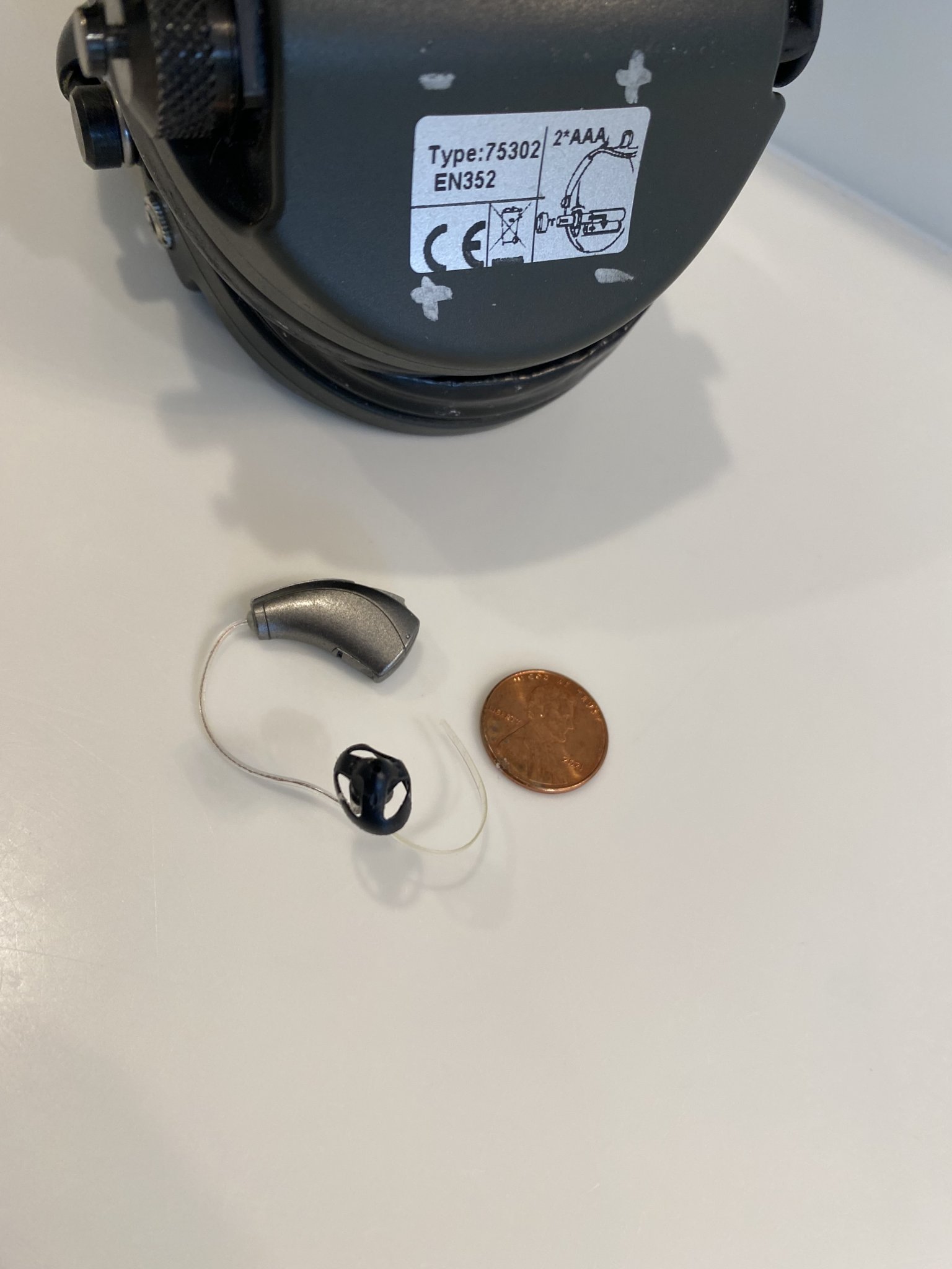

I have been using Starkey mfg Livio 1600 model for past two years.
Functions controlled with small button on device or iPhone bluetooth controls. Very small profile. Lots of
functionalities for user customization, even updated software for "mask mode" to better decifer those wearing masks AND speaking from
behind plexiglass barriers. Use them with my Sordins too. Nice feature is their "Find my Hearing Aids" (just like find my iphone); used it more than once. Automatically will connect with your iPhone incoming calls and can stream any iPhone content. A little over $5K for the pair.
