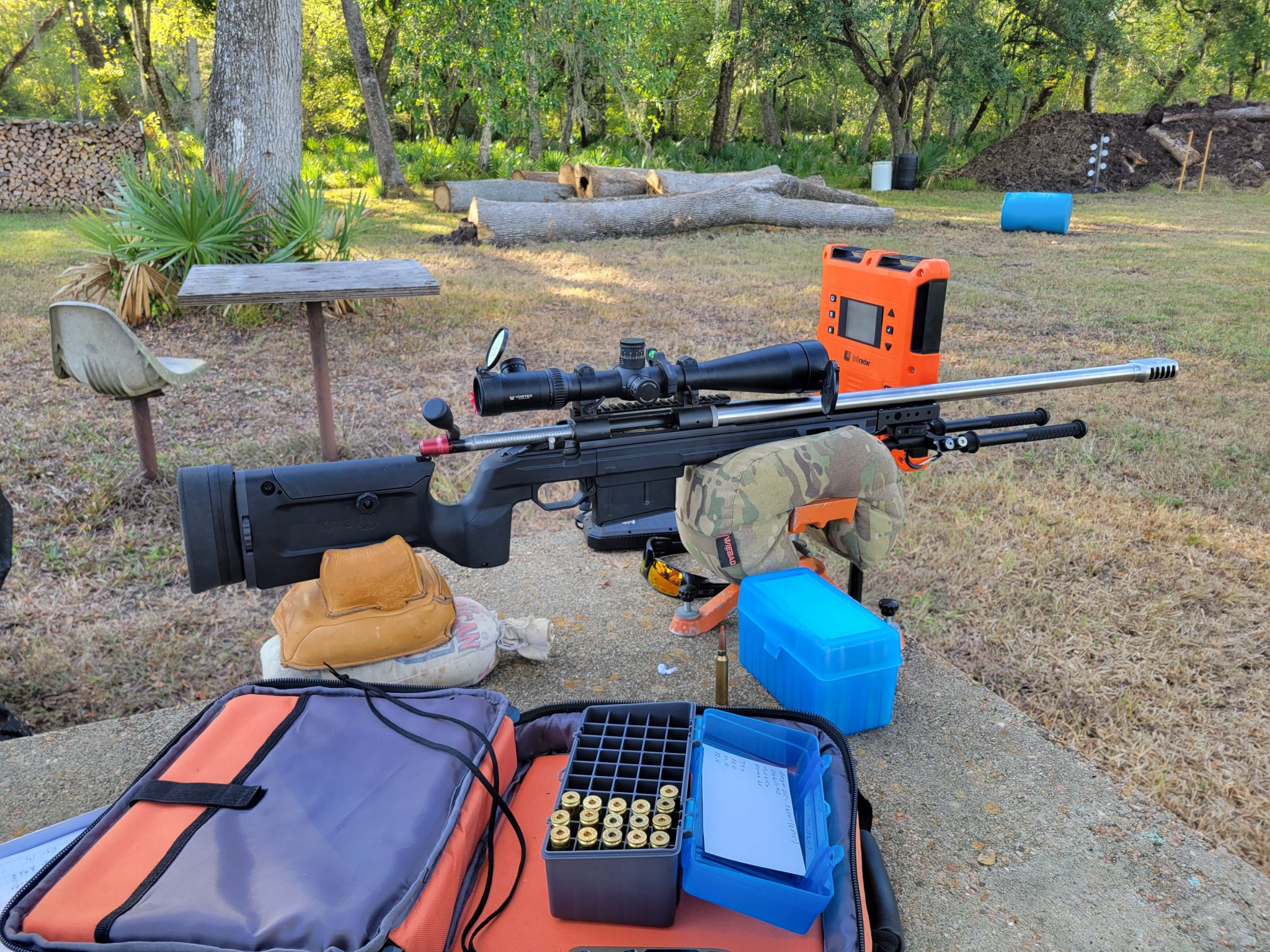

This is my 700 LA in a bravo. Add mag of your choice and roll with it. The magpul aics mags work pretty good.
The only thing I don't like about my bravo is it's not a whiskey3. Yet.
