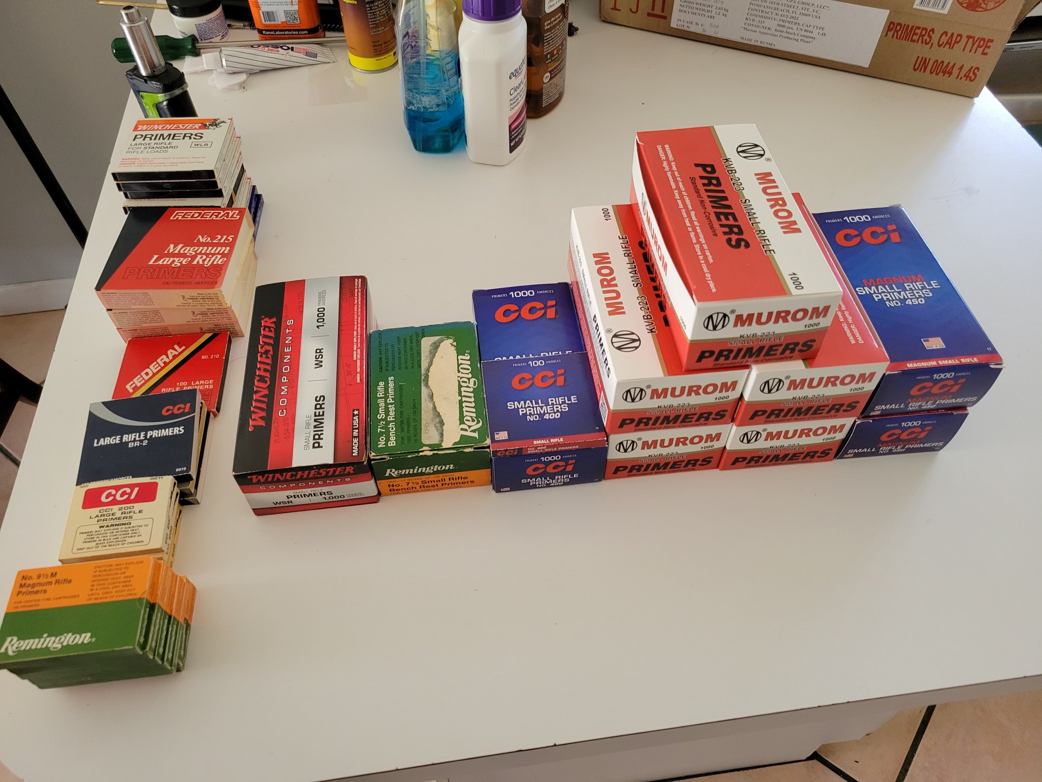

I ordered 5000, they are located In Pompano Beach which is just north of my location. I have a buddy that orders from them often, this will be my first time. Should be here in a couple of days, fuel for the drive is more than the shipping.
Here the link if you want to order some:
BTW: I encountered one hang fire out of 50 6mm creedmoor round I fired on Saturday with these primers.
The Win SR and CCI 400 continue to shoot well.
I'm trying some CCI 450s this weekend if I can make it to the range.
