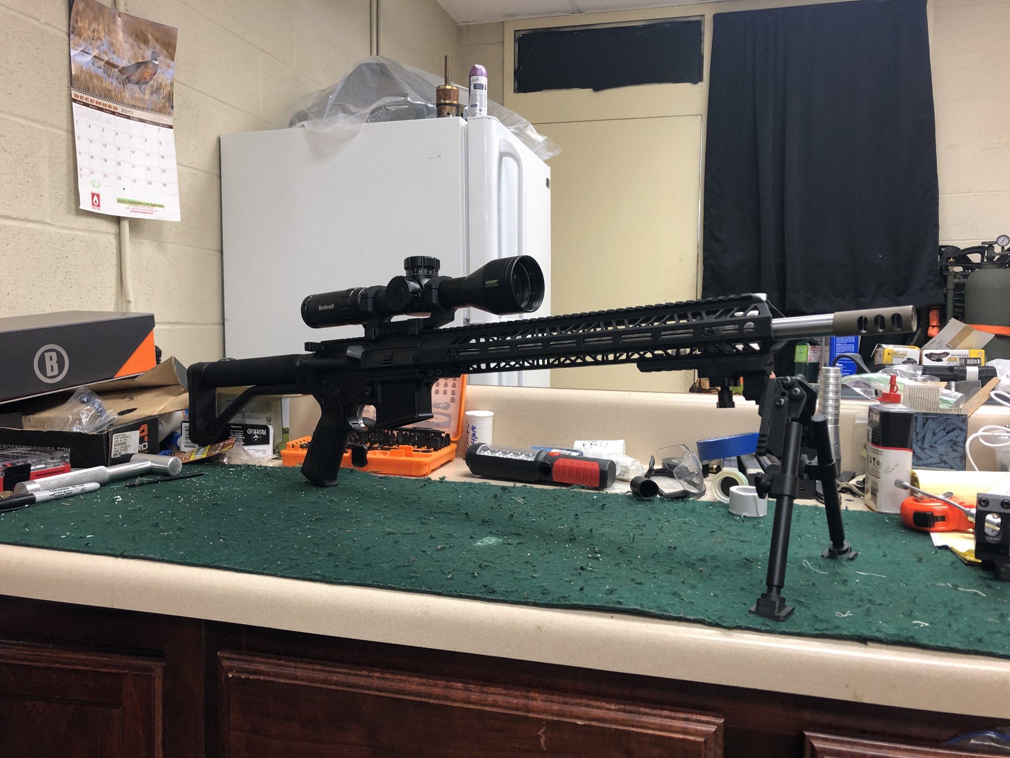

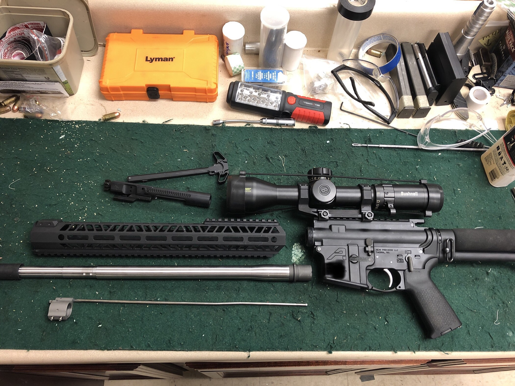

As someone who’s tried this many times and finally succeeded with a great spr build after learning lessons on previous disappointments, I highly recommend white oak armory barrels. They’re very popular here and my attempts at saving money usually led to being disappointed. I have a 18” spr profile barrel that shoot sub moa. A quality barrel is the start to a great rifle.
also learned the hard way to make sure your gas block doesn’t walk on you, I blue loctite my set screws now.
Get a solid handguard that doesn’t flex and contact your barrel. Ones with a steel barrel nut are often good at this. Brownells new wrenchman series seems like a good option for the money but there are many that will do the job.
On that same note, I learned to file down all my mlok hardware screws because it would also contact the barrel when the handguard would flex. That contact would always cause my groups to be inconsistent. Making the barrel truely free floating is key.
lastly, for what it’s worth, I would look an enhanced (SSA-E) geissele trigger for precision work. The lighter trigger break is less likely to pull your shot. They are very good triggers and break clean. The breaking profile of the enhanced versions of their triggers are intentionally crisper than their standard ones, which are more combat orientated.
enjoy building yours! Once you have a shooter it’s incredibly fun. My spr is easily my favorite ar I own and the one I most often shoot.

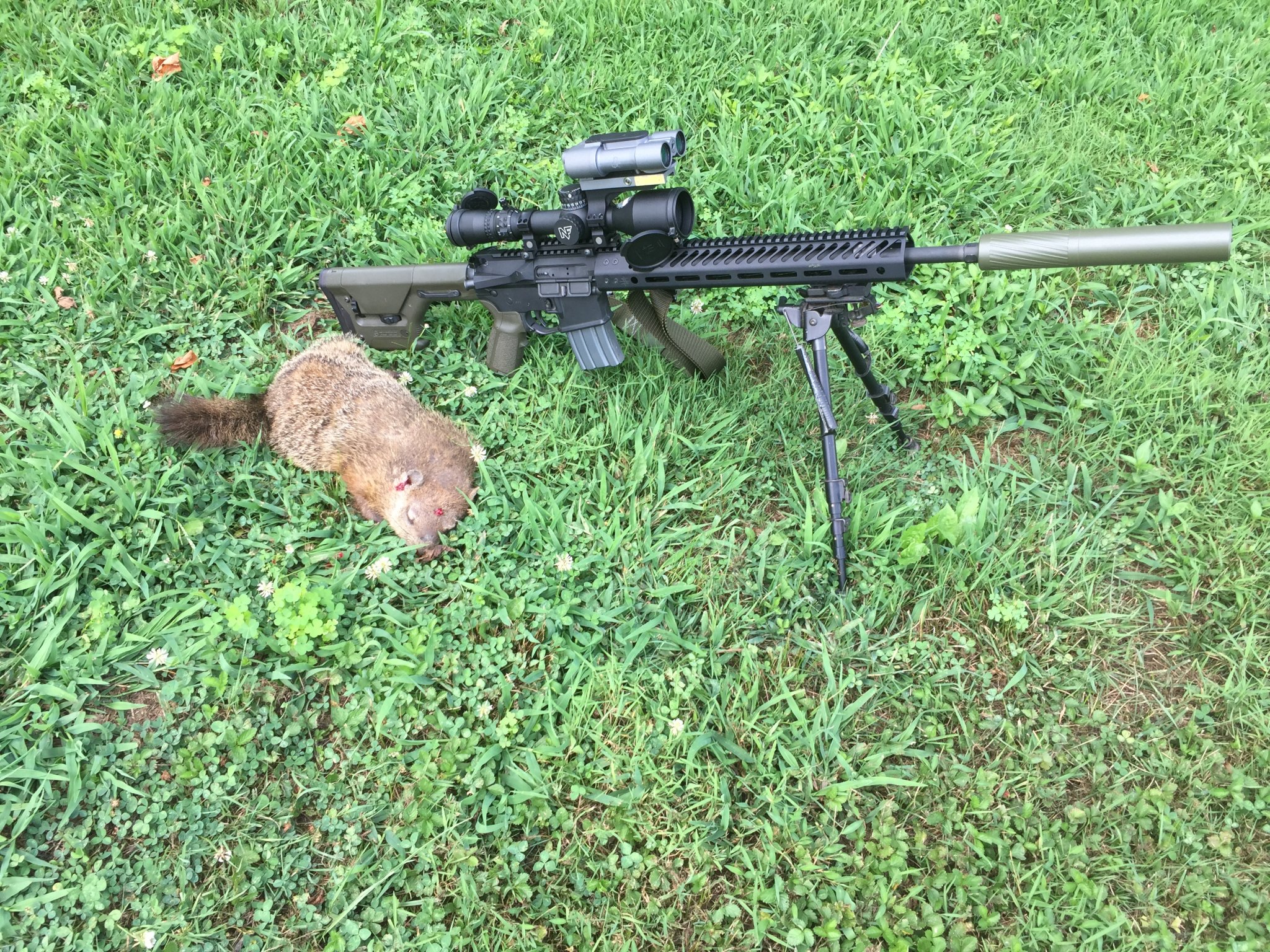

There’s a rodent sleeping next to your gun.
Went with a Bartlein heavy service contour blank and had it cut to 18 inches and headapaced to a Seekins bolt(1:8;wylde), WOA competition barrel extension , aero upper and lower, Triggertech Frictionless two stage trigger, Badger unimount, and a Bushnell HDMRii 3-21x50 scope. Plan on shooting 77g smk for the most part.
