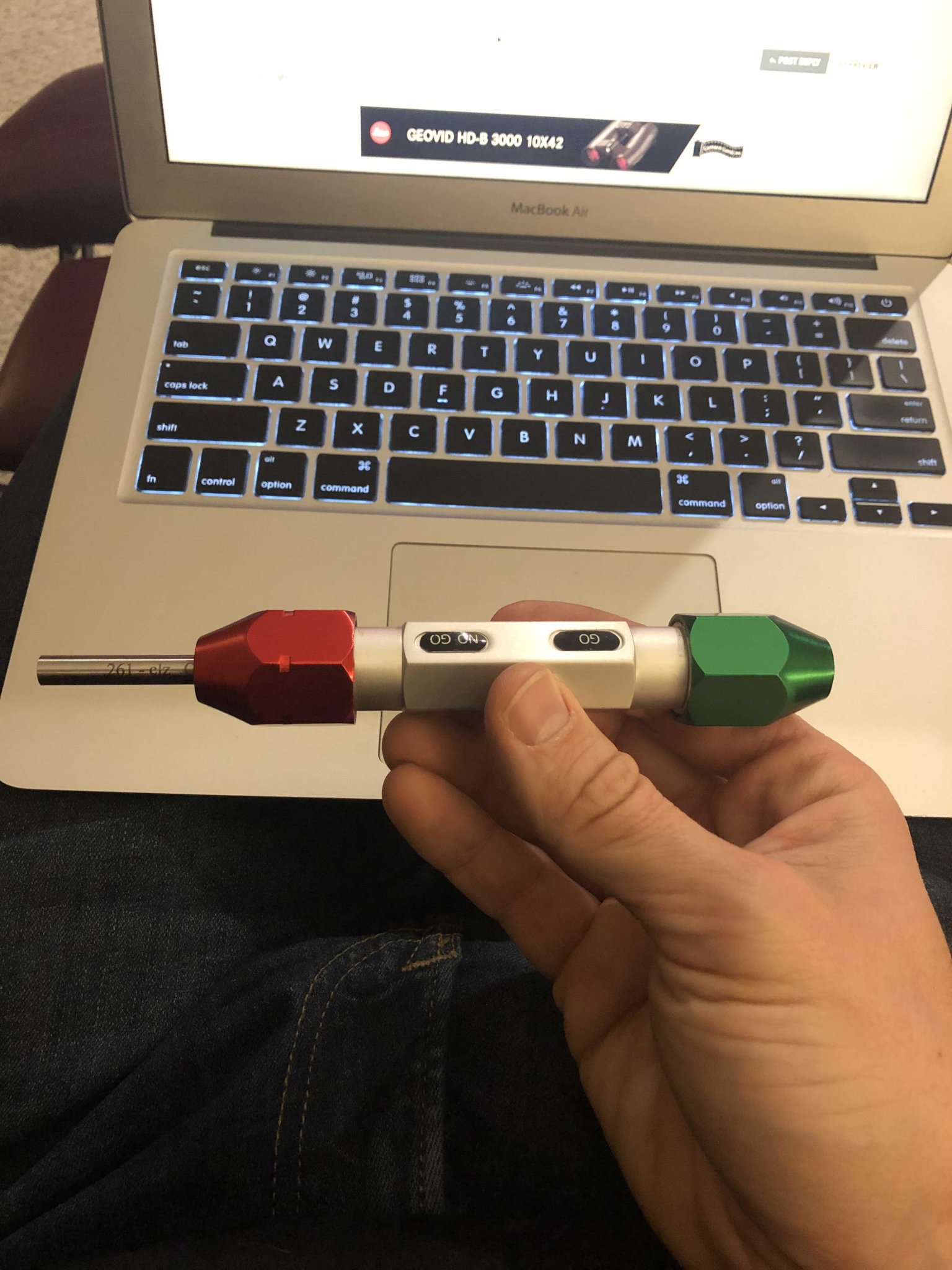

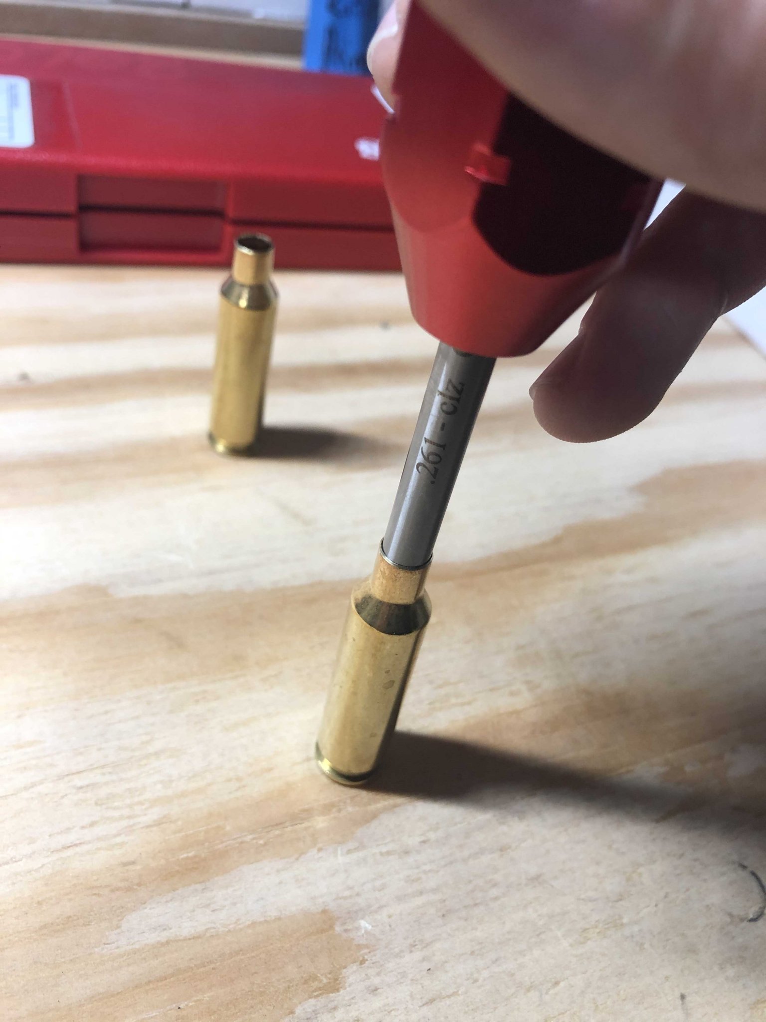

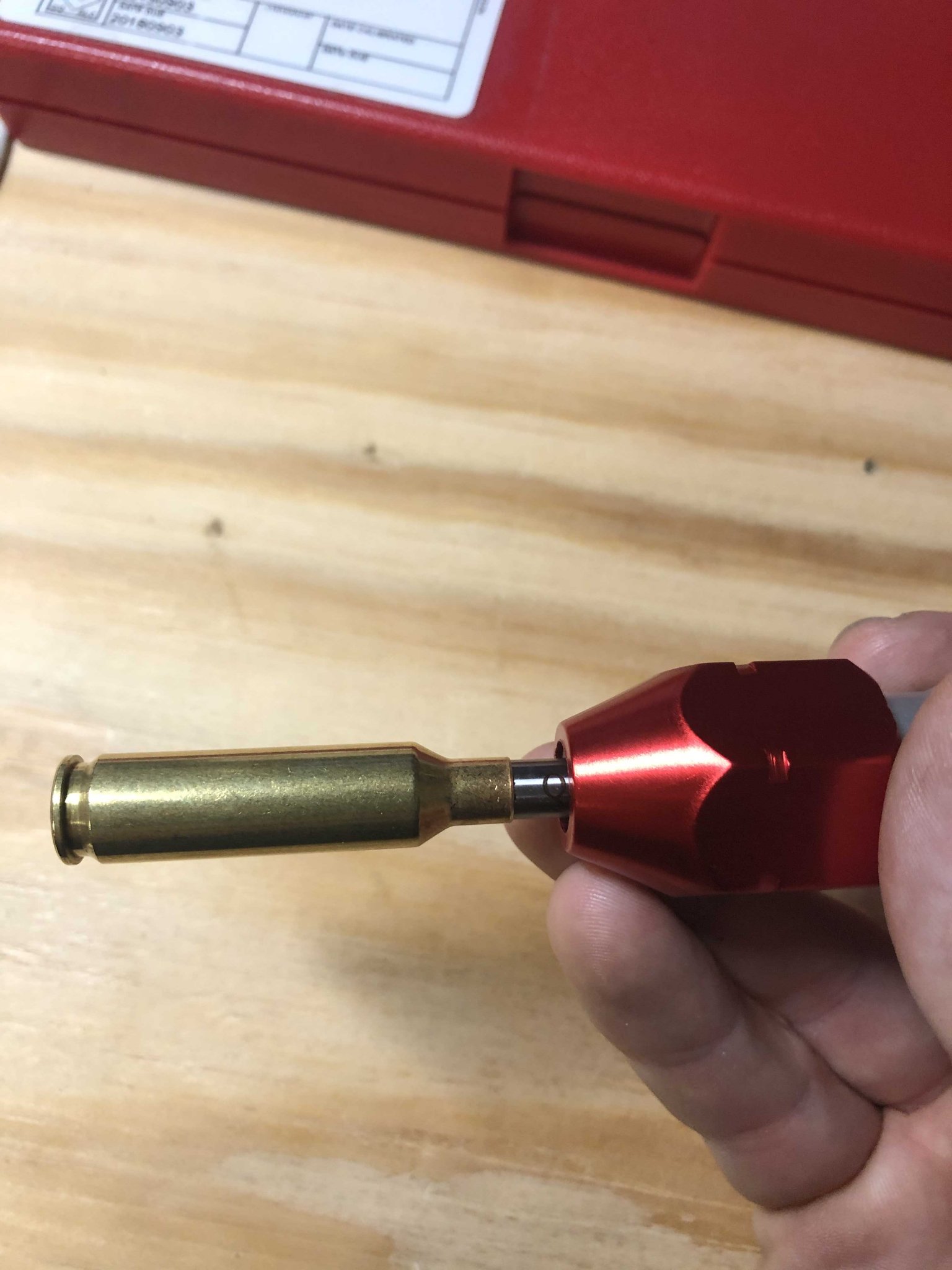

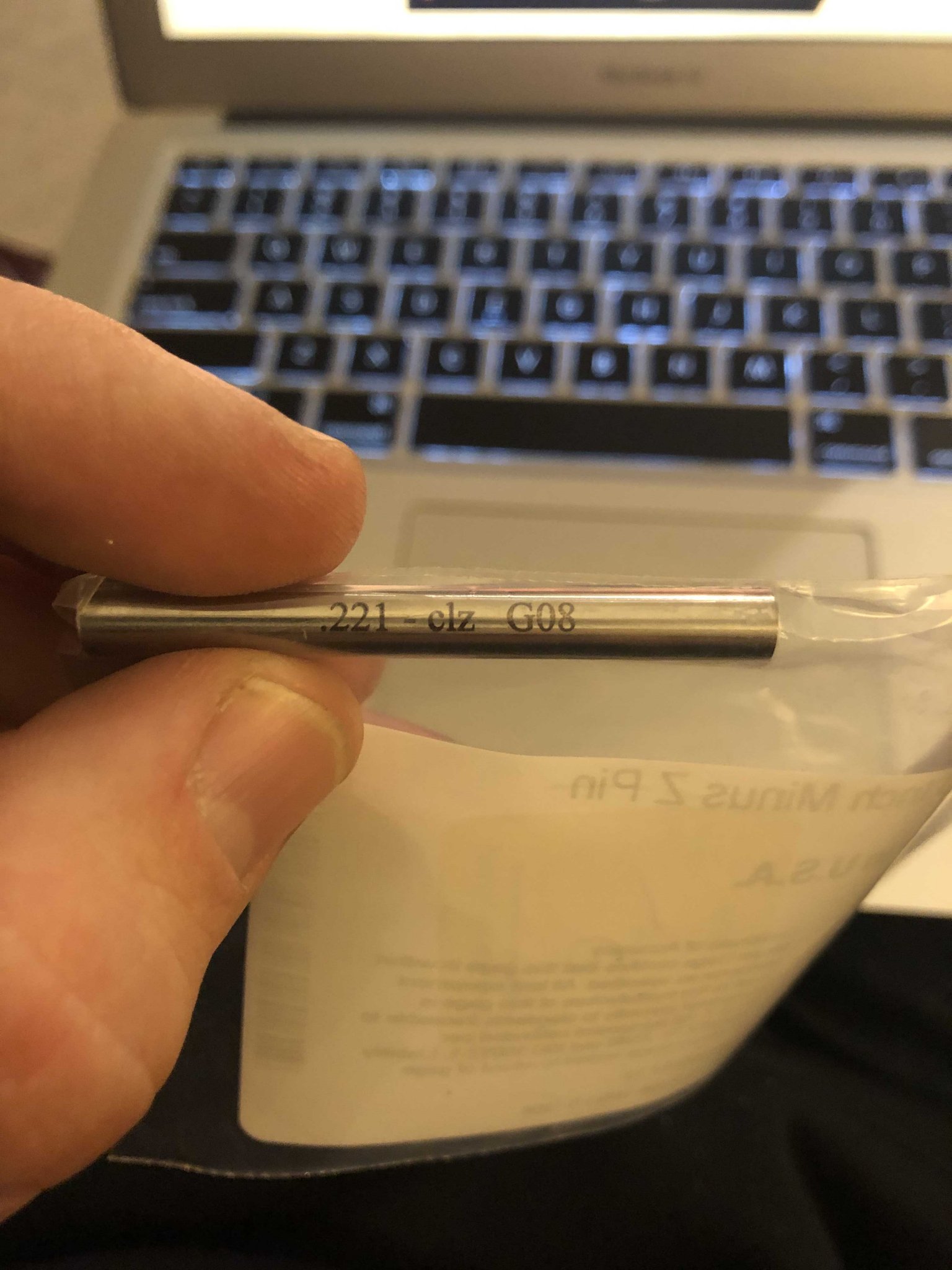

    Since pin gages aren't exactly a common firearm world tool, I posted some pictures below for you. I got mine from McMaster Carr, which is where I usually get anything that Lowes doesn't carry. I would recommend getting a few sizes per caliber so you check and set tension to what you want.
    I grabbed some new brass for my 6.5cm that hasn't had the neck tension set and tried to run my 0.261 pin gage through the mouths. The first case it does not go in freely. The second picture perfectly slides in. So one case has 3 thou neck tension currently and the other has more than 3 thou... ended up being just shy of 4 at the moment. The goal would be that your mandrel sets them all to the same thing but if they start off different they may also have different spring back, resulting in dissimilar neck tension in the end.
    I'm assuming you use the "GO" gauge's, correct?
