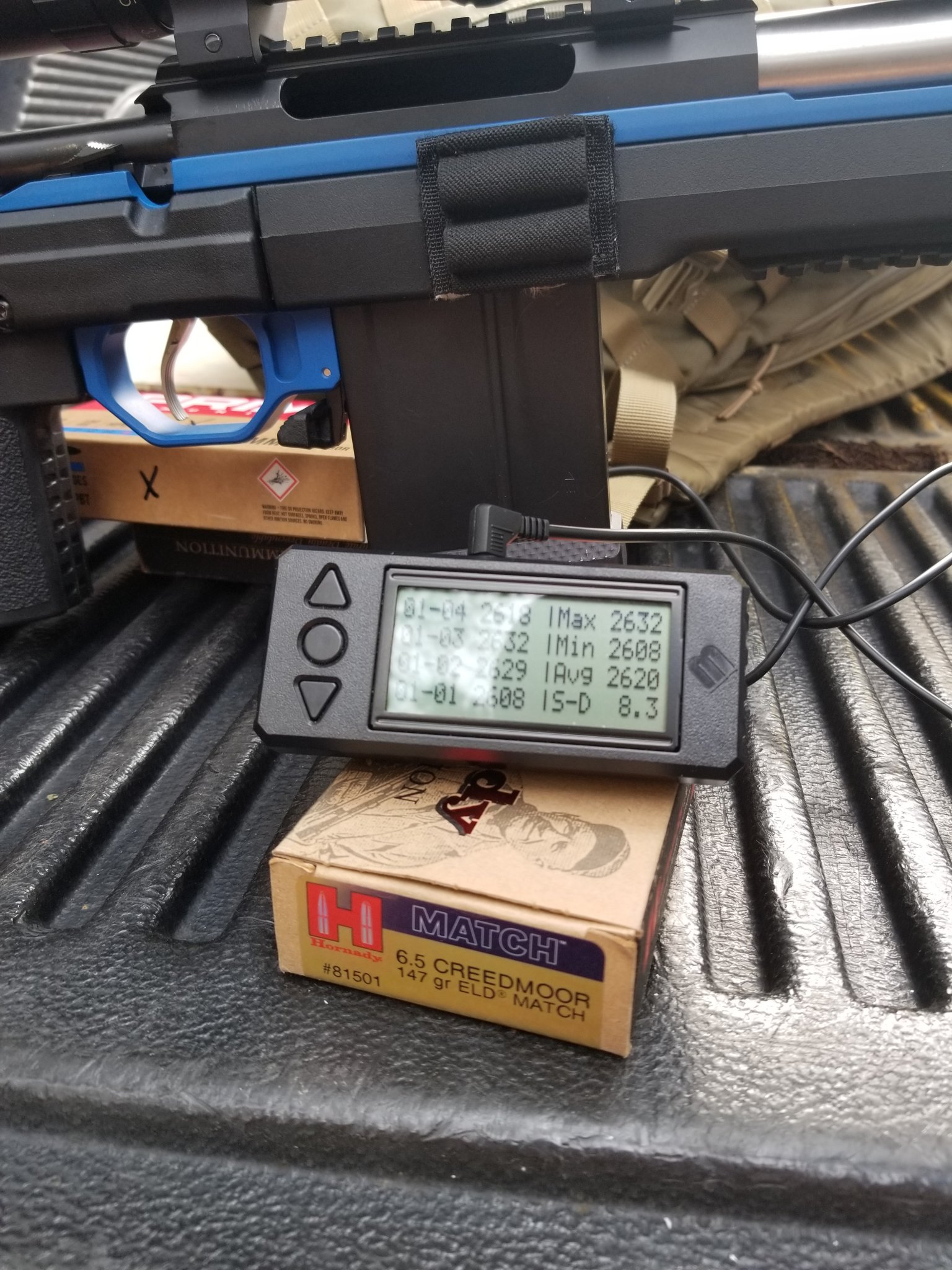

I've had excellent luck with the 147s. Albeit only a sample of 10rds shown here, this is the most consistent factory ammo for my barrel. Give it a try if you haven't, for me it has better numbers on the chrony than the 140s. But as @Rob01 said, it really doesn't matter. I've seen him shoot our club match here in NC and the standings don't lie!

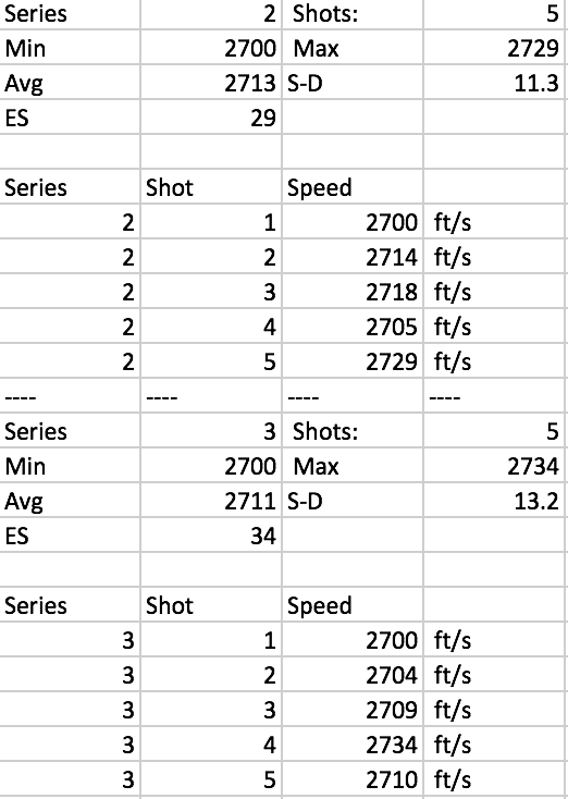

Here's some results from a trip to the range last week.....using my Tikka A1 and Magnetospeed....140 ELD-M Match ammo.....
I also shot 2 five shot strings of 140 ELD-M loads of mine: 41.8gr H4350, CCI450 in Lapua brass.
I really didn't expect the factory ammo results to be so positive...
Two days ago, amidst some other testing, i put another another five factory rounds over the chrono and the average velocity was 2710 and the SD was 8.5.

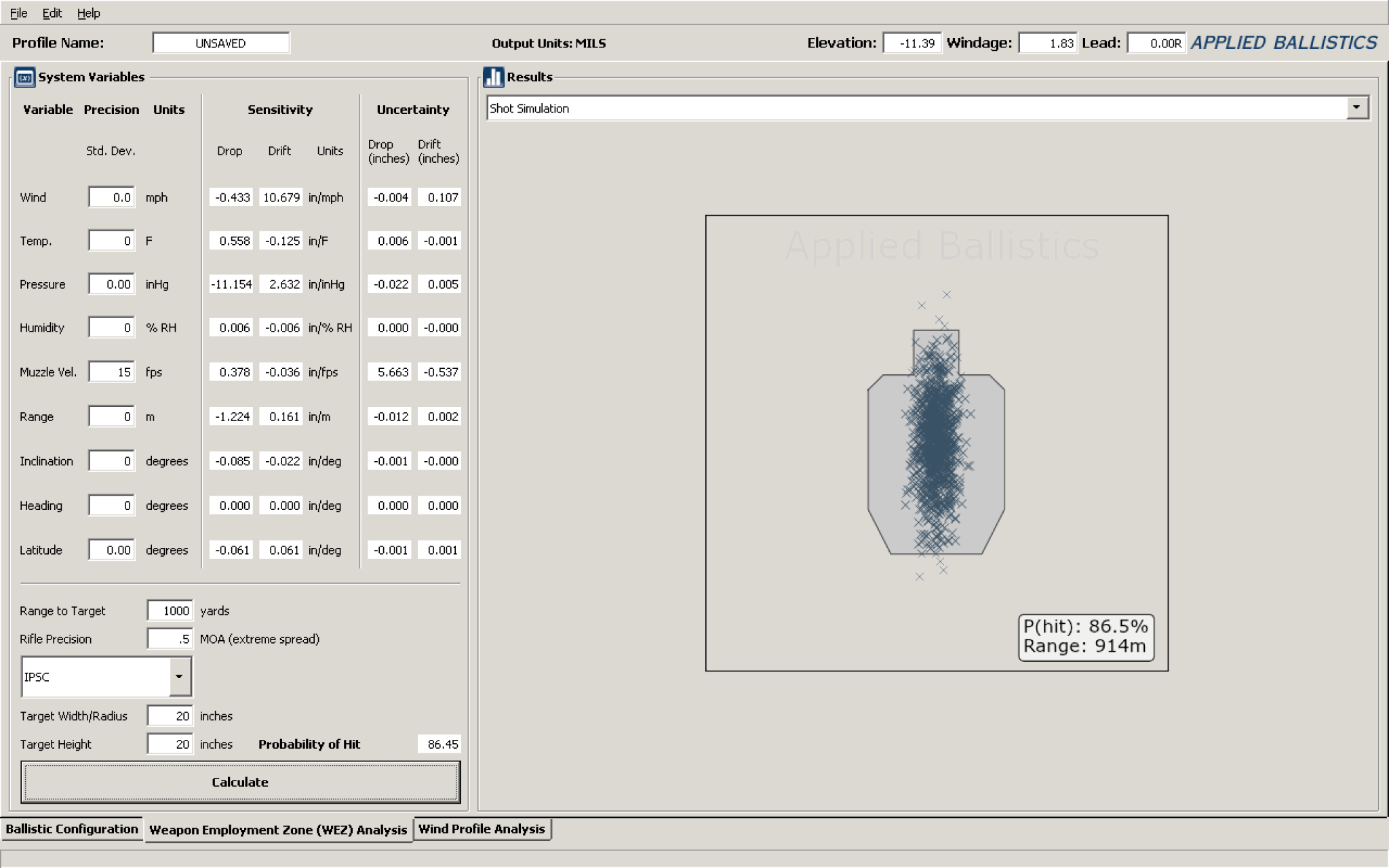

SD and ES do matter, run the numbers at 1k in your solver using a SD of 5FPS and an ES of 15fps (good hand load) and then compare to a SD of 15fps and a ES of 40fps (good factory ammo). The difference is what your giving up. It’s still not worth reloading IMO but your hit probability is higher with a lower SD and ES.
