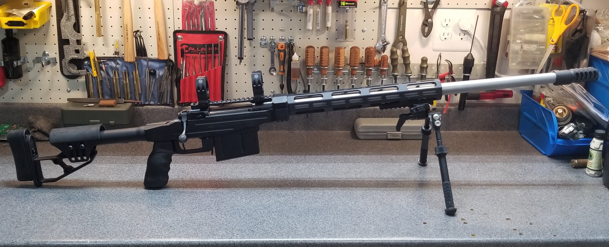

    Found a chassis.
    Cerakoted ACC
    3 internal weights
    4 external(2 large, 2 small)
    OB Inc grip
    SAP 2 round holder
    Wiebad cheek pad
