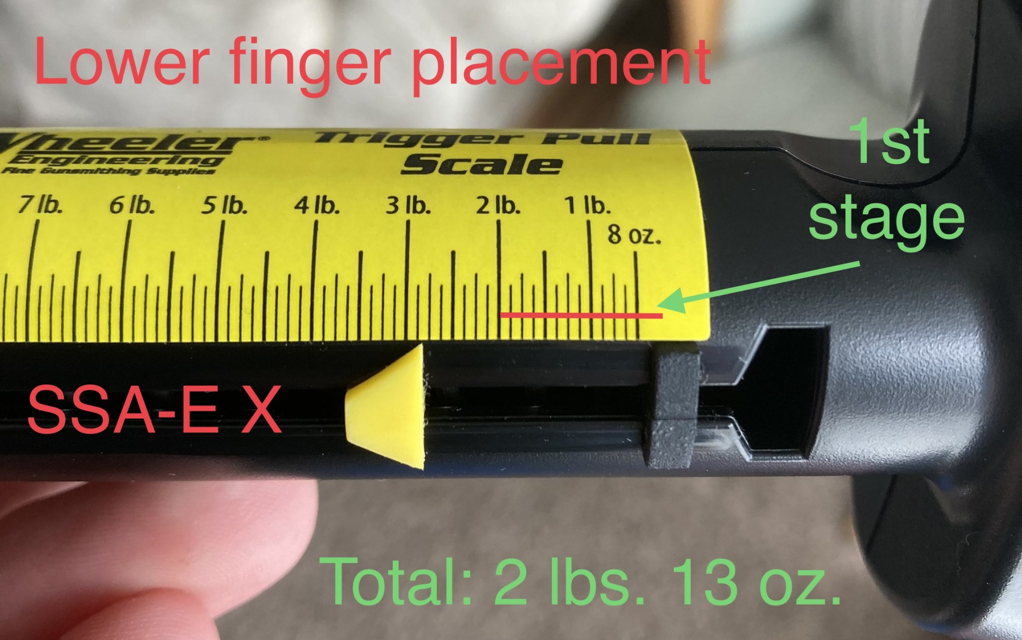

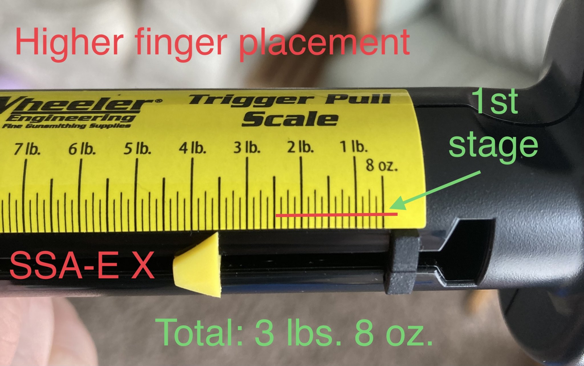

I recently picked up a pretty heavily discounted Geissele SSA-E-X Lighting Bow trigger. Even the discounted price of $215 is too much but at least that price is in line with other premium AR triggers.
Anyways, I’m really impressed with the trigger but I feel that the 2nd stage pull weight is just a little too light for my taste. I used two different pull gauges and the total pull weight averages around 2.8lbs. That puts the 2nd stage break somewhere around 1.0lbs which is crazy light. Honestly, its a little too light.
I’d like to slightly increase the pull weight of the 2nd stage break but not dramatically. I’d like to get it closer to 1.5lbs.
On Geissele triggers, which spring has the most effect on the pull weight of the 2nd stage break? Based on my understanding of the design, it looks like it would be the small spiral wound disconnector spring that sits under the disconnector.
I’m curious if other people have messed with swapping disconnector springs on the Geissele triggers and if that is the right approach to increase or decrease the pull weight of the 2nd stage specifically.

I’ll update this thread with the results from the disconnector swap. I’m going to try the disconnector spring from the SSA-X.
For now, here are some pictures showing the effect of different finger positioning on the trigger bow. With your finger towards the bottom, you get a 2nd stage break around 13 oz. And if you shift your finger up towards the middle of the trigger bow, the pull weight on the 2nd stage jumps up to 1 lb. Moving your finger up a little adds about 0.5 lb to the first stage pull.
Overall, this is an excellent trigger. My only real gripe is the pull length of the first stage take-up. My other AR has a Wilson Combat TTU-M2 which has an extremely short first stage. It’s probably half as long as the Geissele SSA-E X. The break on the Geissele is much lighter though and I think it will be a better trigger for precision shooting.
