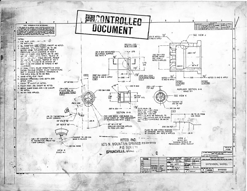

The colt tdp likely relates back to the reamed hole in the barrel extension and the desired interference fit, more than the index slot clearance
Bingo.

The colt tdp likely relates back to the reamed hole in the barrel extension and the desired interference fit, more than the index slot clearance.

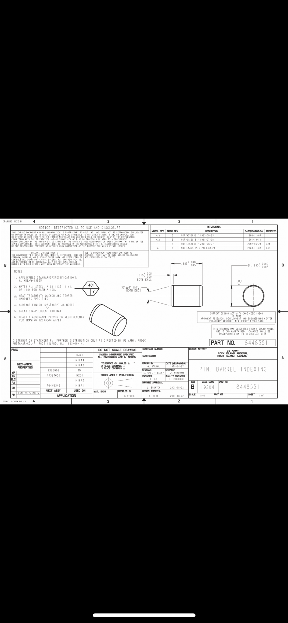

At worst, you'll be off 0.01 degrees beyond the tdp spec....
Yes, that looks like a print for a pin that will always be an interference fit with the barrel extension, according to this print. Also only calls for 30 minute angular accuracy, or 0.5 degree, a lot more than the 0.01 degree caused by the undersized pin.
Also a pretty standard spec for a dowel pin.
Just posting the print didn't add any content to the thread.
You have to understand why the spec is what it is. In this case, it's a pressed in alignment pin, the fit needs to be correct for it to stay put.
Colt may use a 0.1245 reamer, thus a 0.1255-0.0005 pin. Your specific manufacturer may use a 0.1240 reamer, and go with a 0.1255-0.0010 pin.
Very unlikely that the -0.0005 spec relates to alignment
