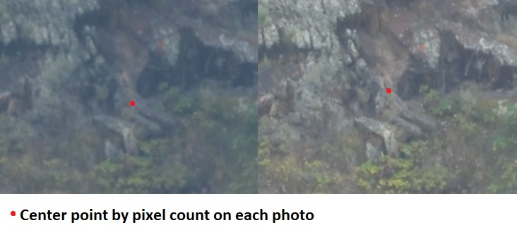

I left a camera on a cliff side one day last year, time lapse photography every 10 minutes for.. I forget... 5-6 hours or so. It was a sunny day that turned partly cloudy. As you scroll through the photographs on the SD card, you can watch the image shrink and grow with the corresponding ambient light. That's fair enough-- the air acts more or less like a lens and with more light there's more heat, change in heat changes density, change in density changes index of refraction--> bend light.
What tripped me up was when I located the "center" of the photographs (they're all the same H*W pixel count so I found the center through that), there was also vertical movement. This is about a 10x zoom lens, roughly 450yd away. Tantalizing subject because what our eyes send to our brain is BS to begin with, so there's a weak link, and most everything that I would think to use to measure the effect is also affected by light and/or temperature so it's very hard to isolate causation. And to be honest, the physics surrounding radiation are not my strongest point. The camera auto-gates itself, so aperture diameter and exposure time can be different between pictures, the lens body might expand or contract with temperature, etc... It's hard to know exactly how much the image is actually shifting and how much is instrument error.
Nonetheless, I think this same (or similar) phenomena can be seen through heavy enough rifle platforms or rigidly mounted optics when looking through mirage. The fixed target can move around considerably on the reticle. Anyway... curious. If you look into guys studying space, they never look below 45 degrees because you start to look through enough atmospheric lens that either the clarity or position is distorted so badly it's not worth your time.
