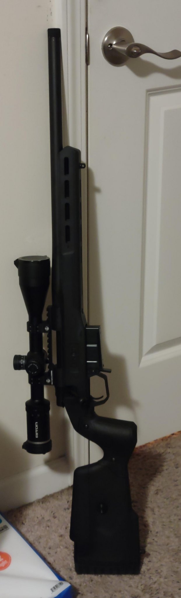

I am looking at doing an inexpensive (not cheap) 308 build. I like to have two of every caliber rifle. Usually a standard style hunting rifle and then something in a chassis, still light enough to hunt with, but heavy enough to be a bench gun. I am buying an MDT Field Stock, but hung up on the action. The following are what I am looking at. Thoughts on the good and bad of each?
1) Brownell's HOWA 20" heavy barreled action $519
2) Savage 110 Trail Hunter $452
3) Ruger American Gen II $540
Just stating up front that I’m fairly new to the long range world so these thoughts are just what I’ve picked up from reading this site.

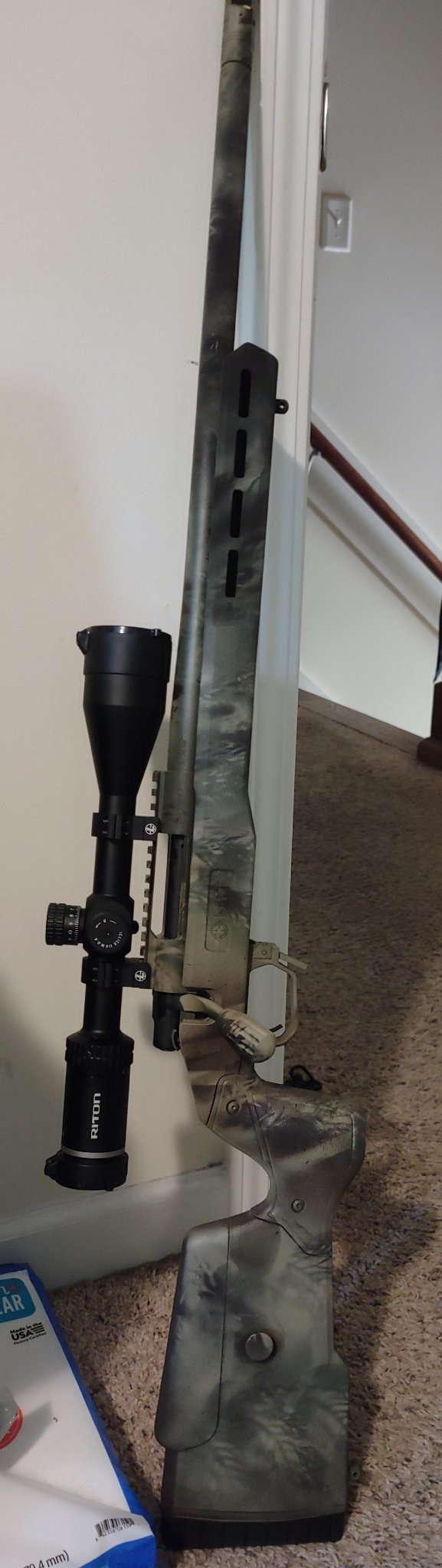

What I was waiting for happened. I caught the HOWA barreled actions on sale and then had a 15% discount code. So, I got a 20" heavy barreled action for $425. I ended up going with an MDT Field Stock with military discount. In about $700 without glass. I have several scopes, so I should be set up after I order a pic rail. Thanks all.

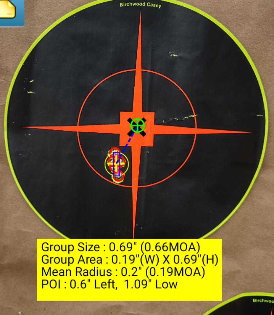

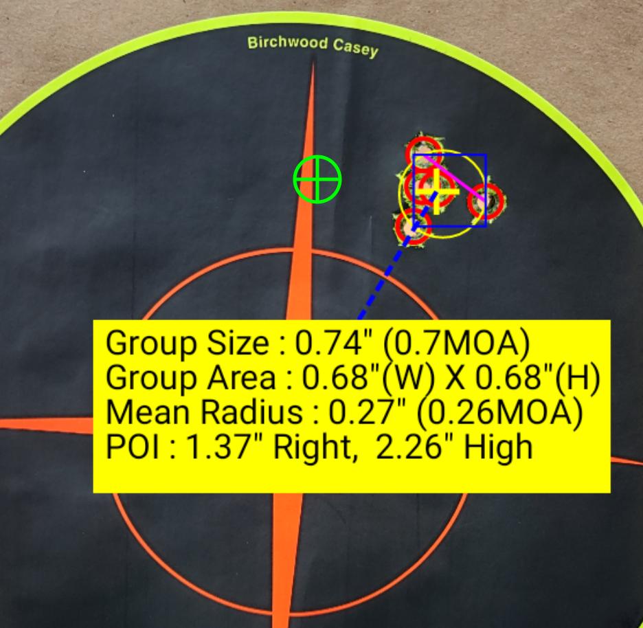

Already a done deal and that would be awesome, but would wreck the intention of this being inexpensive. With glass, was trying to come in under $1k. I made it at about $850 with a military deal on a Riton scope.
HOWA 308 20" heavy barrel barreled action from Brownell's, MDT Field Chassis, Riton 1 Conquer 6-24x50
$850 total

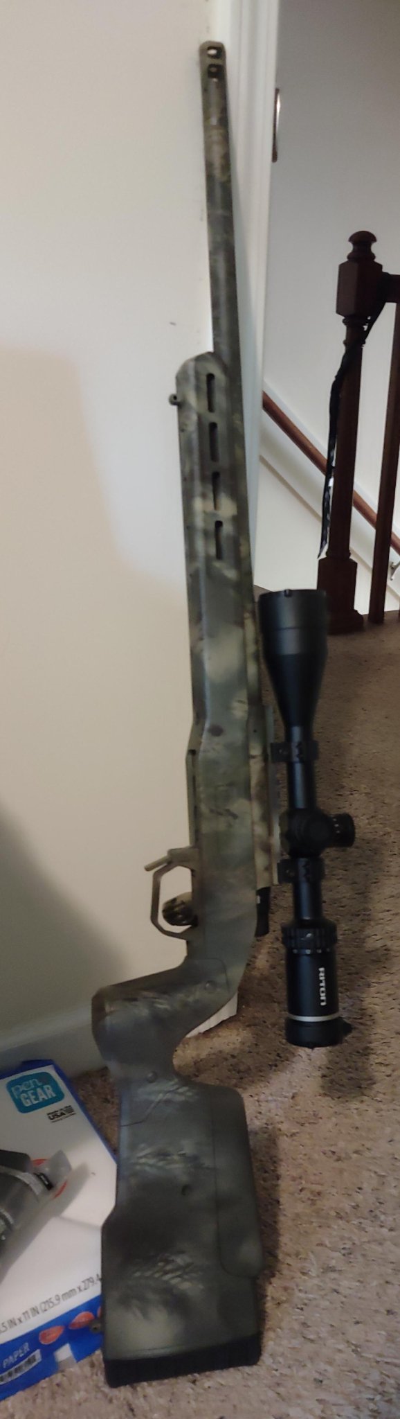

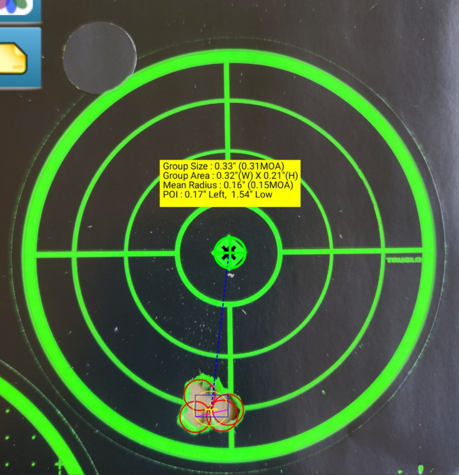

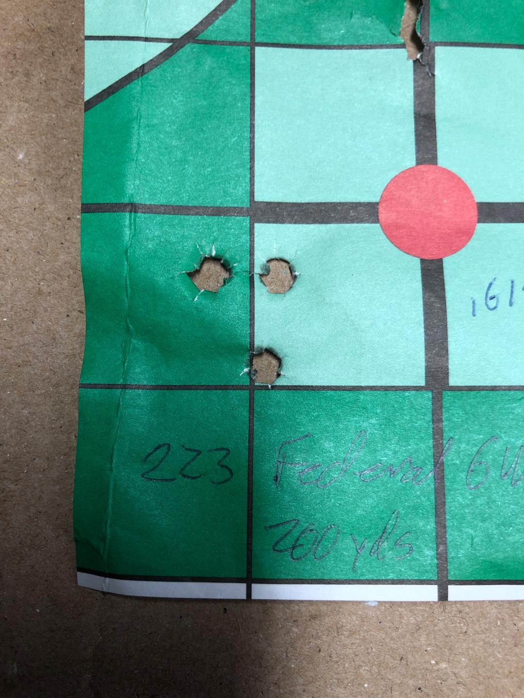

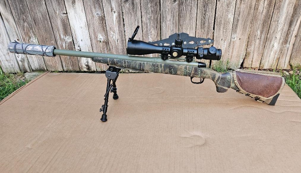

Let me introduce you to Bargain Basement Betty! She ain't the prettiest girl in town, but boy can she shoot!
Marlin X7VH
.223 - 24" Heavy barrel shortened to 18", re-crowned and threaded
Stock is original, but re-enforced and filled throughout - Free floated - Bottom rail is part of interior chassis
It came with the Accutrigger
Athlon Argos 6-24x50 MOA Scope
Harris knock-off bipod
Gemtech M4-02 Suppressor (no effect on accuracy)
Green Cerakote on the barreled action and 4-color "Rubber-band" Krylon camo on the stock.
Target is with 62gr Federal GMM
Rifle $275, Barrel work $125, Scope $200, Bipod $25, Cerakote and Paint $25 - so I have about $650 + sweat equity in the gun less suppressor...
Marlin X7VH
Very nice! Can't beat that at all.
Bargain Basement Betty - The back story...
At the advent of my long range accuracy endeavor, I bought an Armalite AR-50A1 because nothing is cooler than .50 BMG! I found that I would shoot about 7-10 rounds through it each trip at $4 per round for surplus ammo. I was at a gun show and saw how cheap the Marlin X7s were ($259-$299 at the time) and thought I could get lots of practice with a cheap .223. At the time I knew almost nothing about accurizing, but believed a big heavy barrel was better. I originally bought the same scope (SWFA SS 16x) and was rather disappointed in the rifle's accuracy.
Since a 24" heavy barrel is pretty unwieldly, I though I would send it off for a chop and thread job. While it was in process the stock was sitting there all lonely and I thought I would mess with it. The stock is rather like a wet noodle so I started re-enforcing it with things I had laying around including long steel bolts, a steel bar, an old weaver rail and epoxy. When I got the barreled action back the stock pressed on it so I hogged out the barrel channel. Cerakote was a must, as I tend to Cerakote every gun. After seeing a Youtube video on using rubberbands for a camo job, I dove right in.
In the end, quite accidentally, I wound up with a very accurate rifle! 10 years later, I need another safe for my long range rifles..
