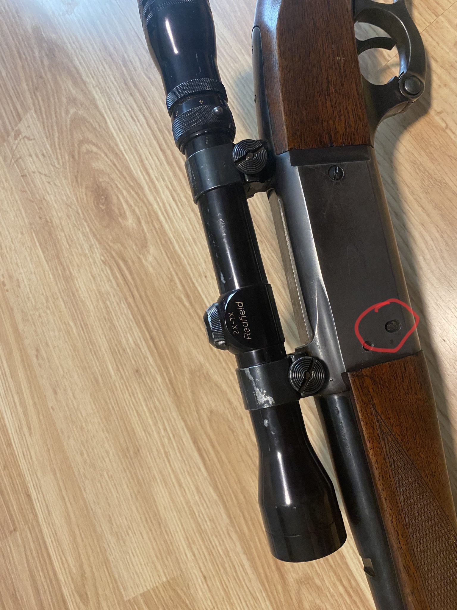

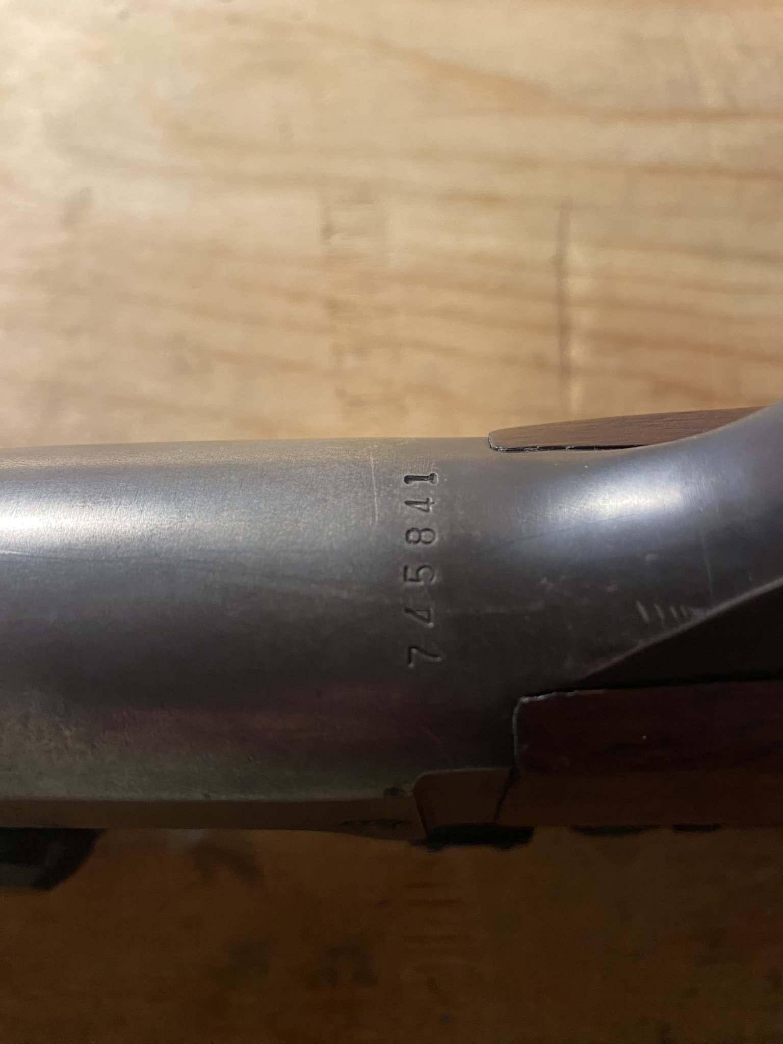

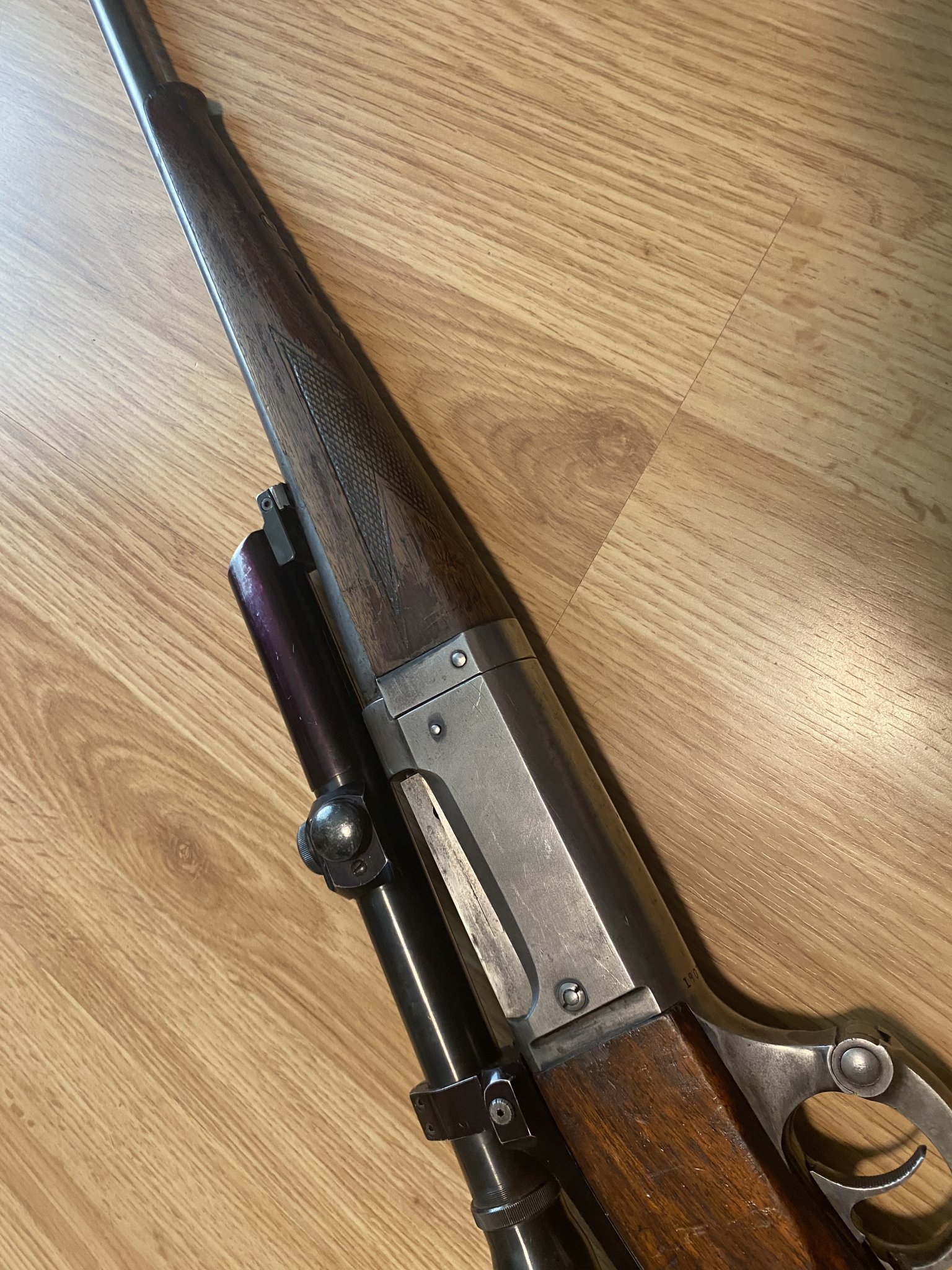

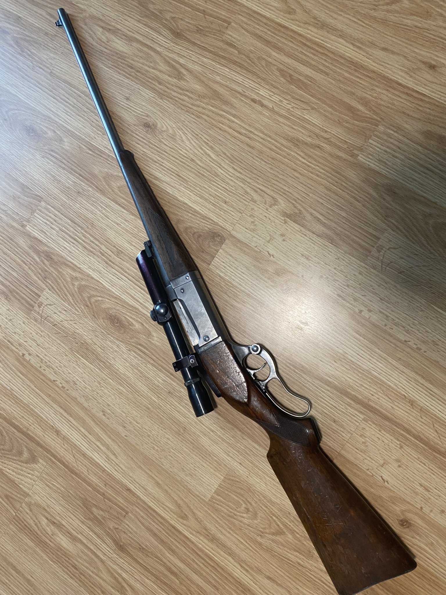

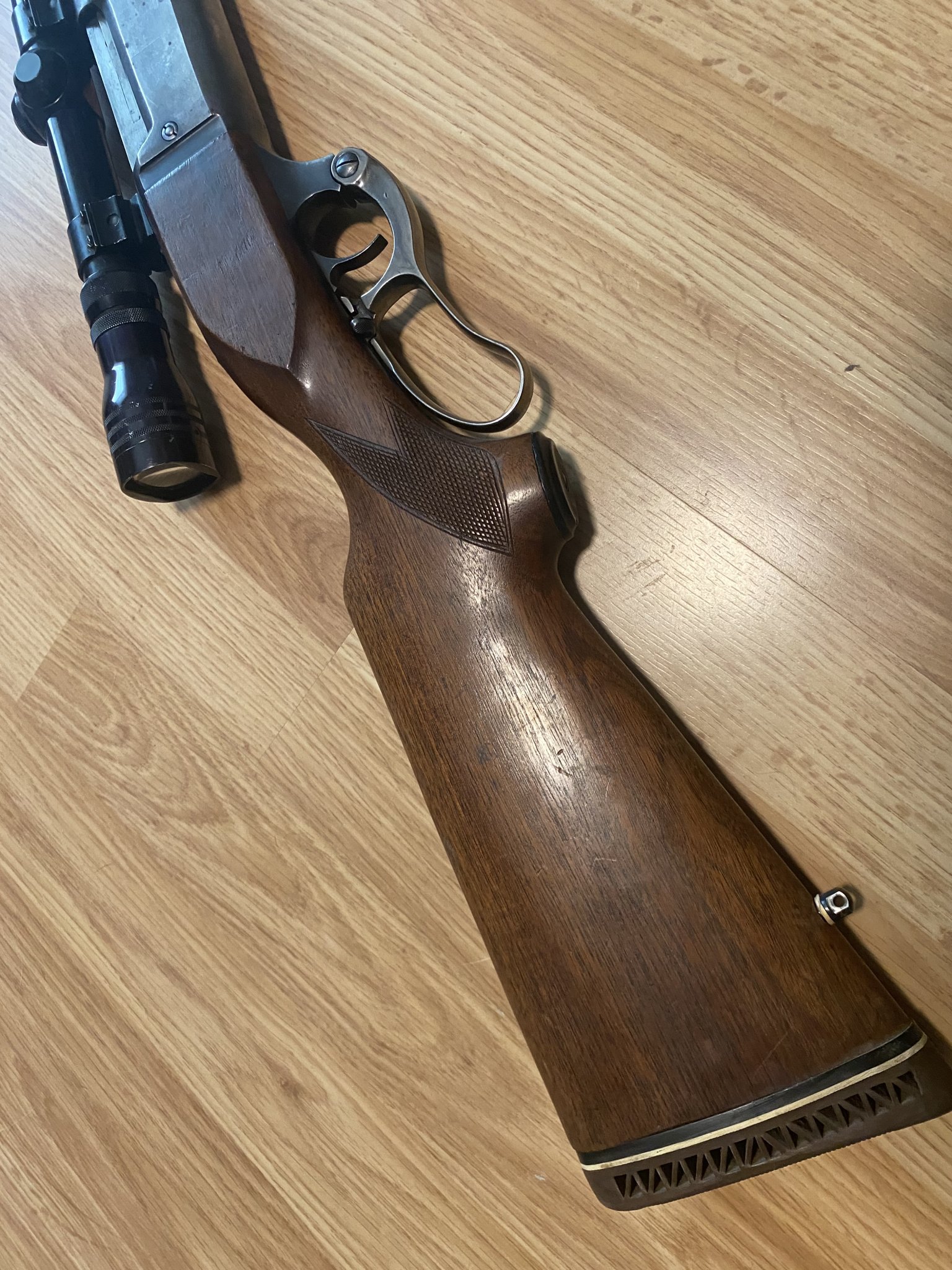

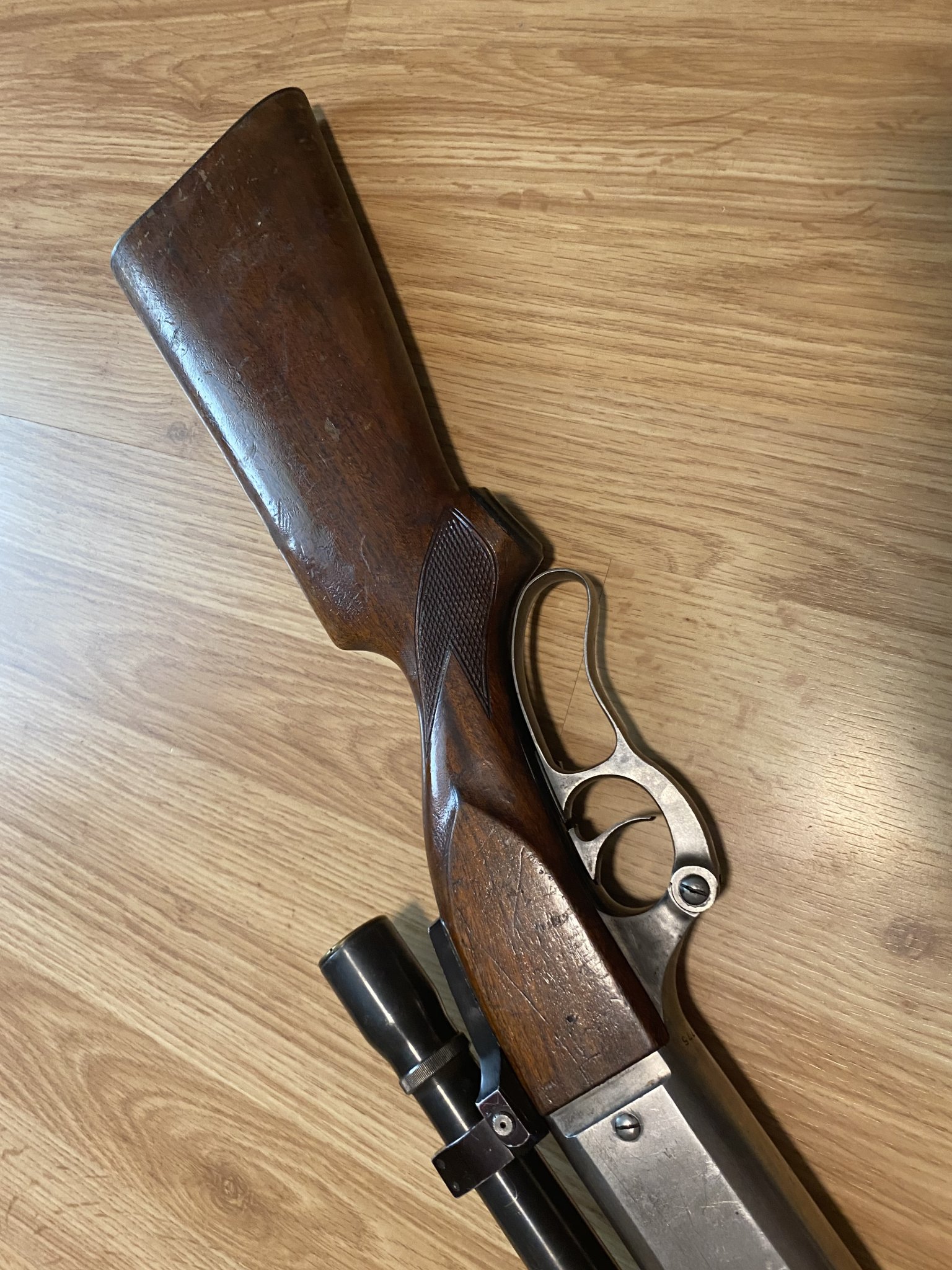

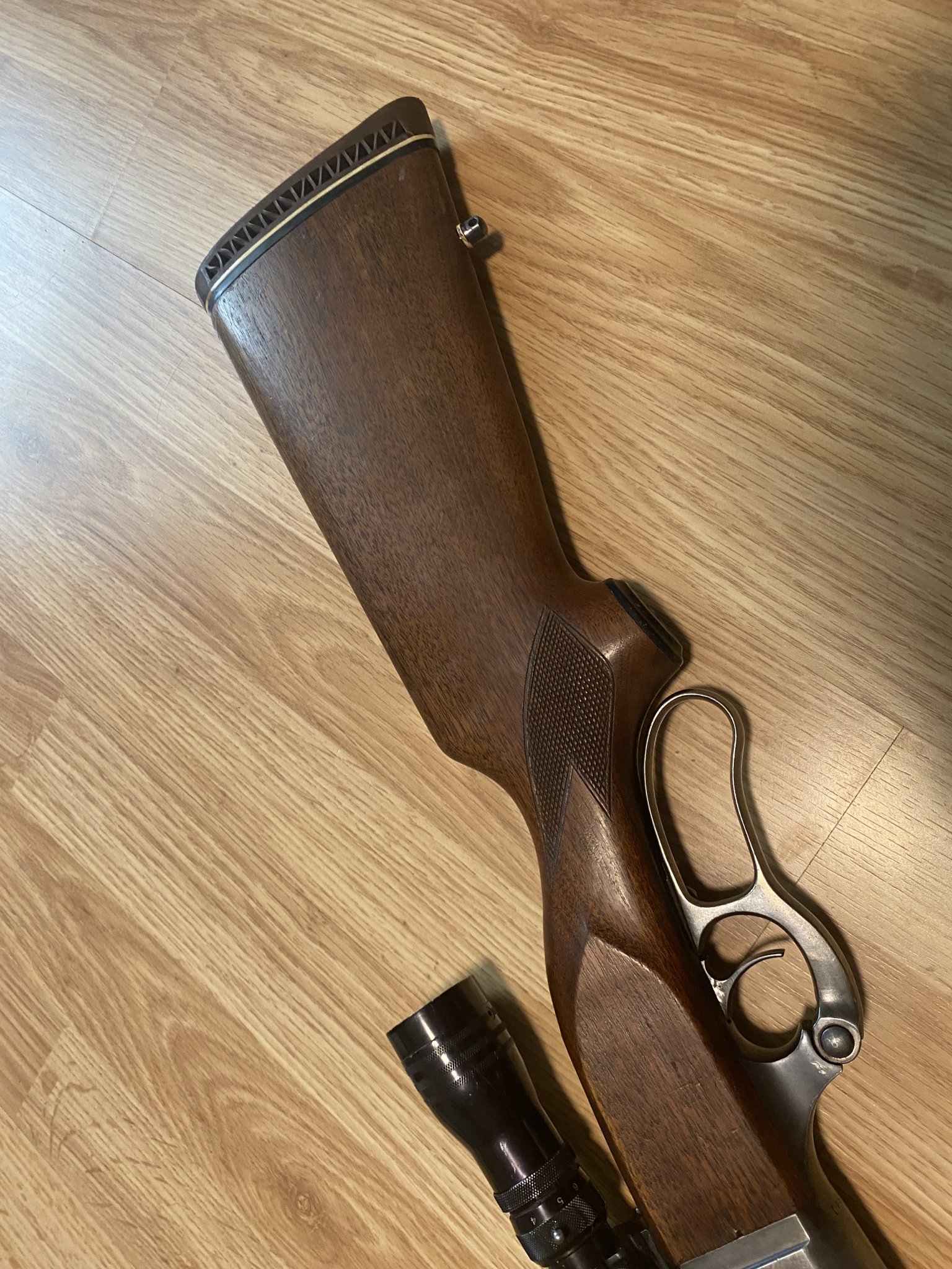

    Hey guys, for starters, I know these aren't sniper rifles, but I'm not sure what other group to search in. I've been searching high and low and can't find much on these rifles. The antique side of things isn't really in my ball park. I inherited several old guns that I really don't have space for and will never do anything with. I'd rather them go to someone who may want them or want to refurbish them. Any info of what they may be worth would be appreciated.
    -First is an old .300 savage with a Redfield 2x-7x scope on it. Decent shape, definitely got shot.
    -Second is a 250-3000 savage with an unknown to me scope, it's definitely old and used.
    Again, any info offered on these is appreciated.

    I would guess the 300 is in the 500-600 range and the 250 400-500 range, maybe less as it looks like blueing is nada.. The Savage 99 seem to sell well to folks looking for simpler times. I am no Savage expert but if you look at what they are actually sell for I think those are close $, baring take down or some oddity I am unaware of.

    I appreciate the info. Up until these rifles, I had never even seen a rotary action. Pretty neat, odd but cool. A lot of moving parts going on, all of which function well on both of these. I'd just hate to have them in a closet forever if there's someone who'd actually want them.
    The Savage 99 is a good rifle and the 250 Savage does better than the .243 Winchester with less powder and barrel erosion. Should be an easy sell. The .300 Savage will take a bit longer to sell, unless you are in a wooded area where that chambering is still popular.
    I appreciate it. I'm out in southern Idaho, so we've got plenty of mountain terrain. Thanks for the info!

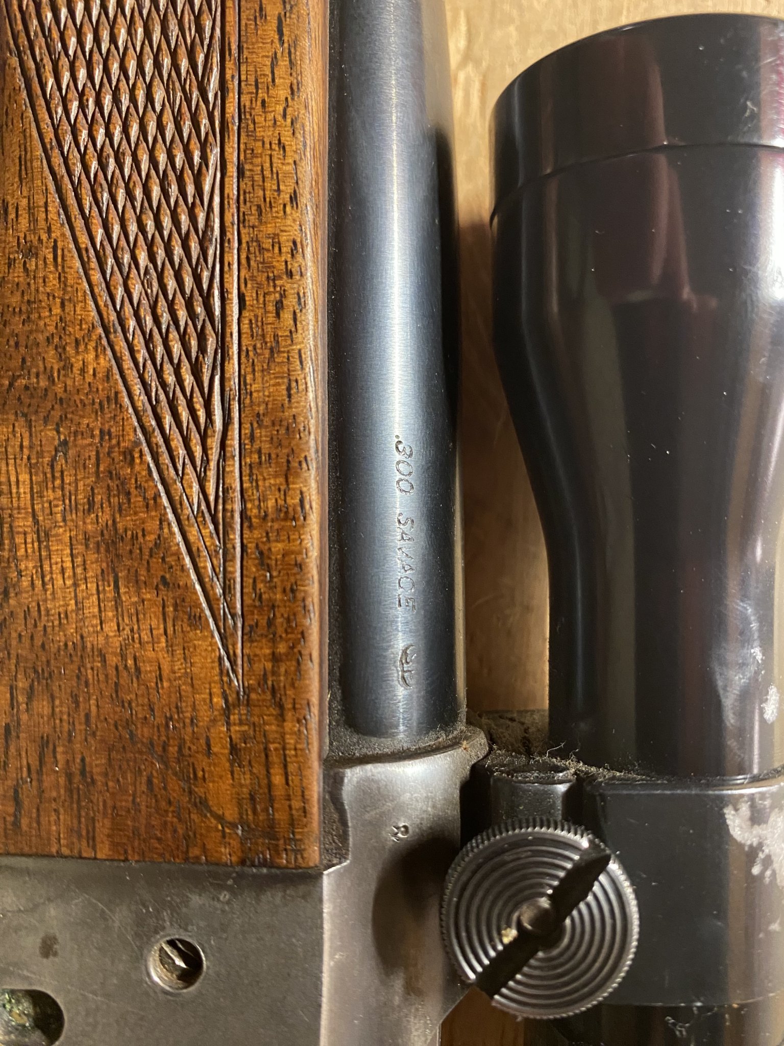

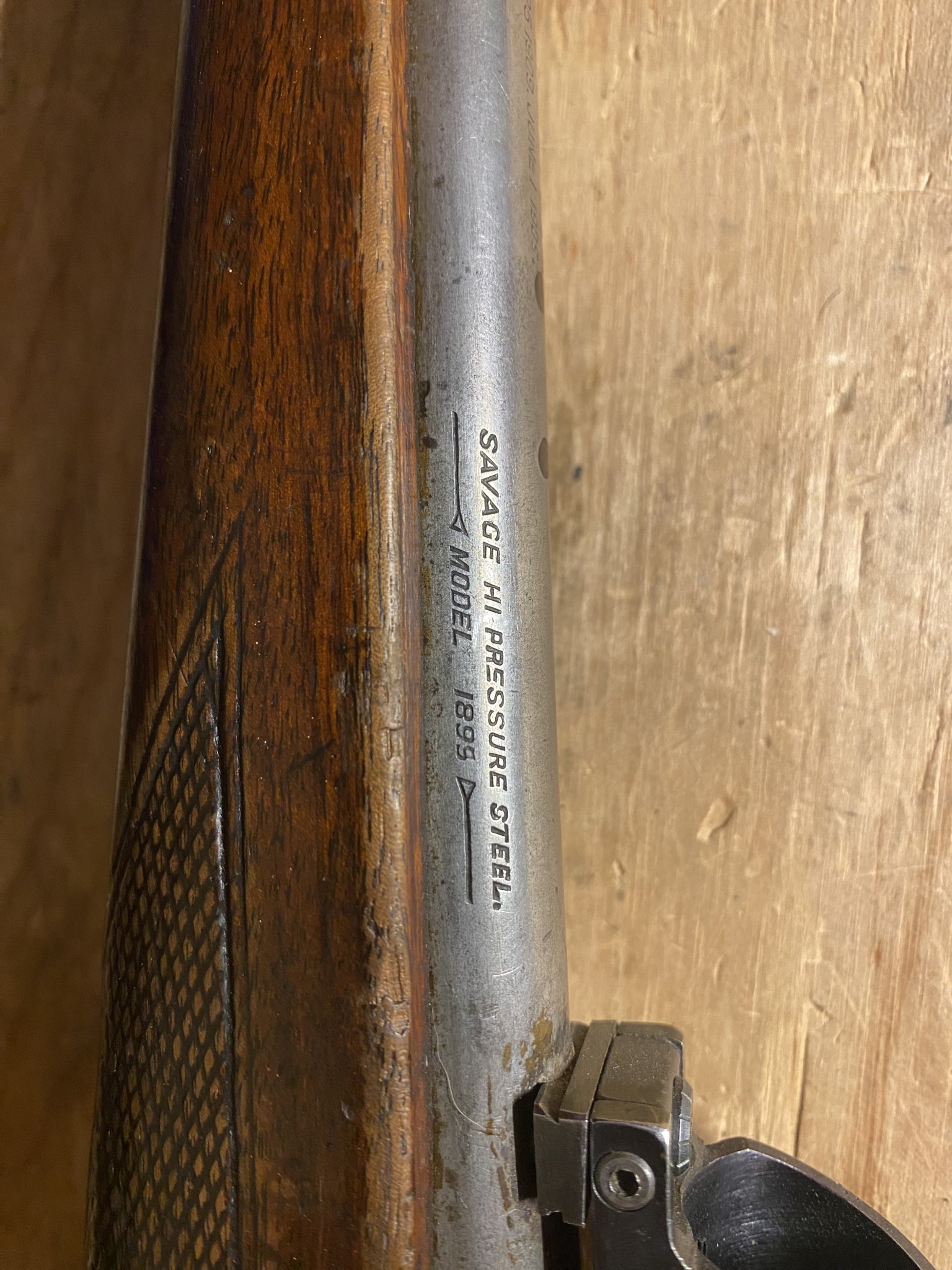

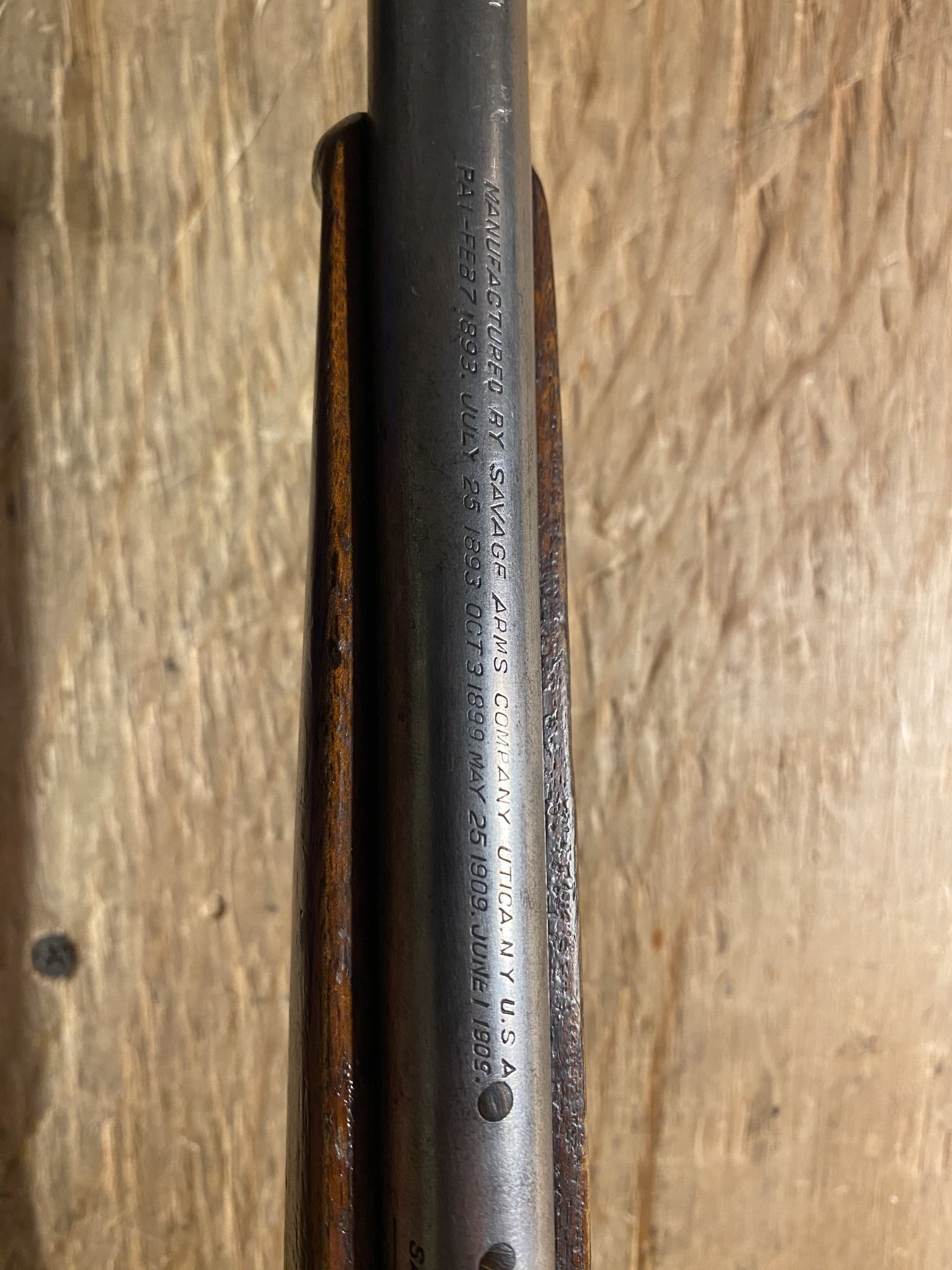

    Both are great rifles. Can you get a pic of the lettering on the barrels? That'll kind of narrow the date of manufacture down. FWIW, I've owned one each of these and found them to be quite accurate...for an old hunting rifle. Also, is there a flat button on the bottom of the forestock? If so that would be a takedown. If no, still good value. As stated above, around $500-$600 each.
    Added: Missed the pic showing the 250-3000. That is pre-1926. (according to one source I read years ago) They dropped 1899 to just 99 and also the -3000 in the 1920's.
    Pre-'26 is kind of significant as it's a 1-14" twist. Which will only generally stabilize up to 90 gr. bullets. It may stabilize 100's with a good reload, but still questionable.

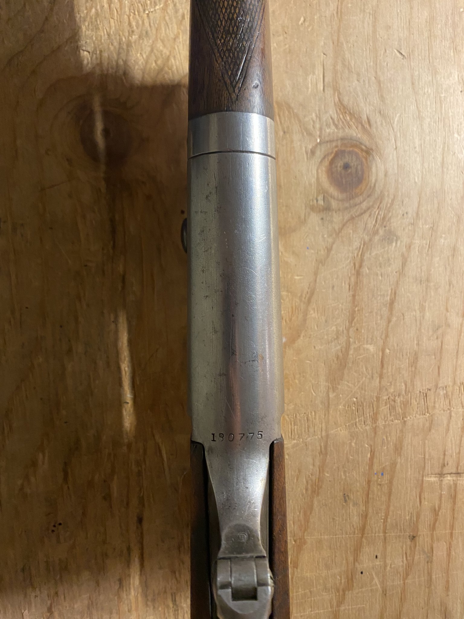

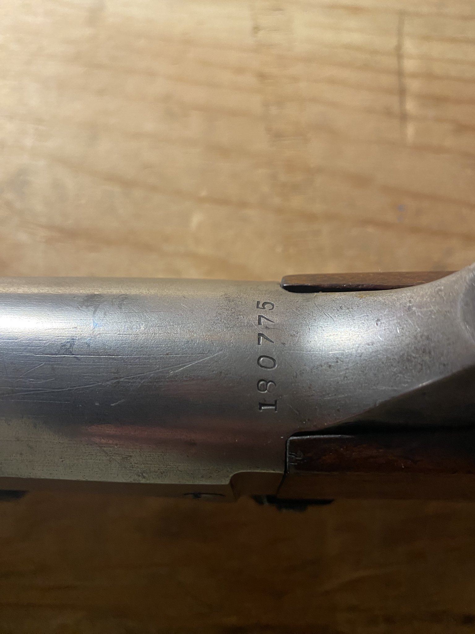

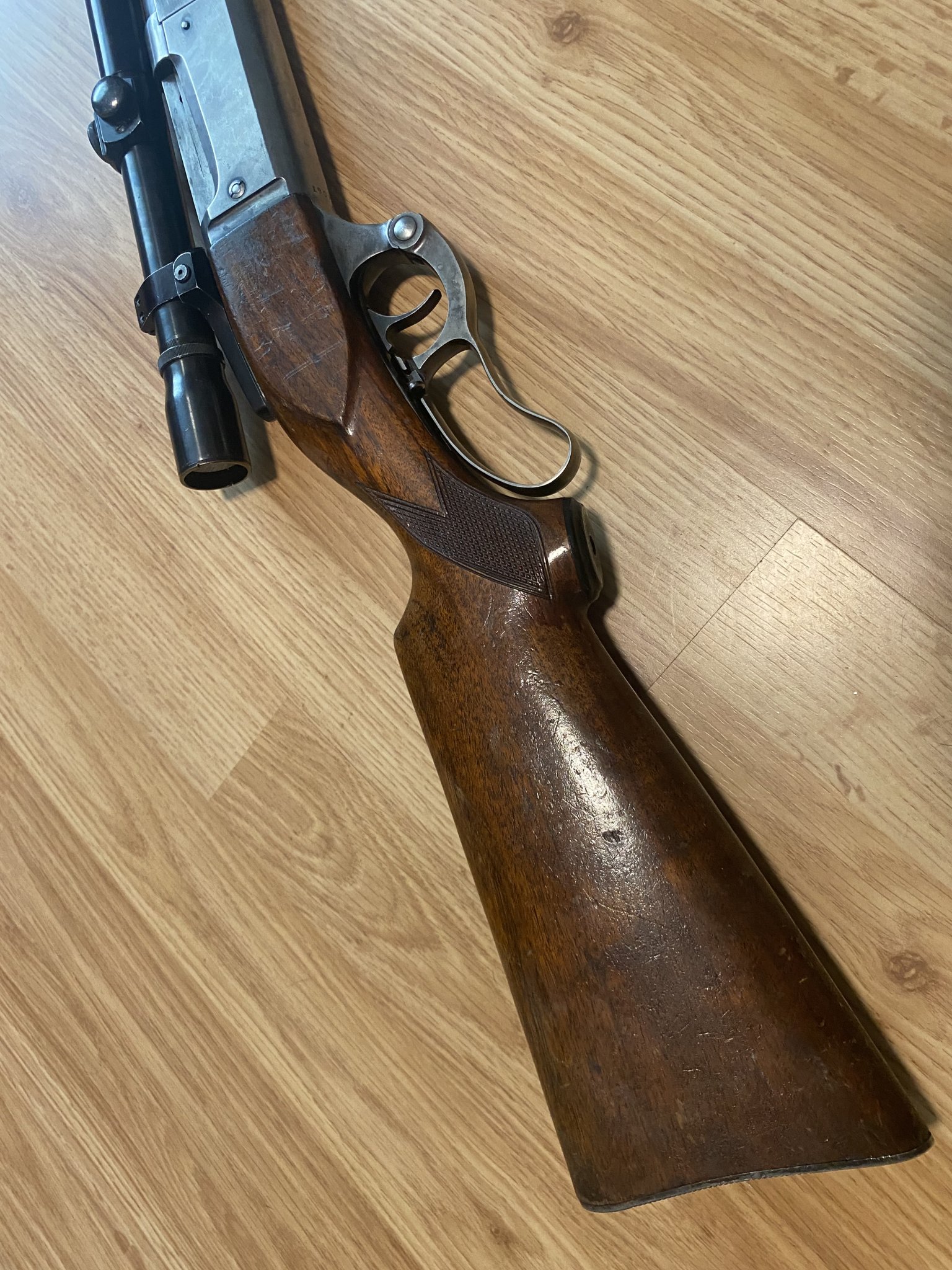

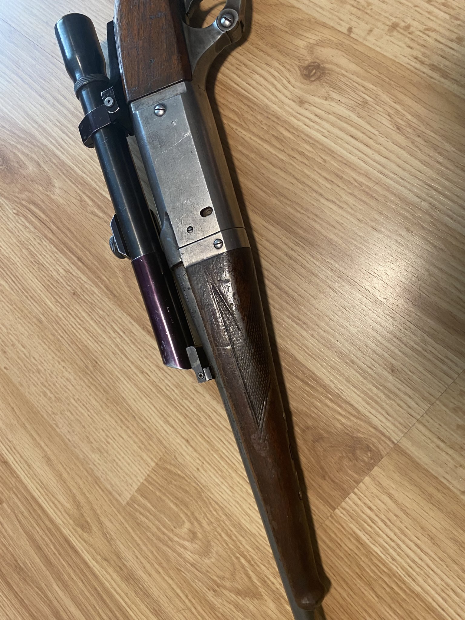

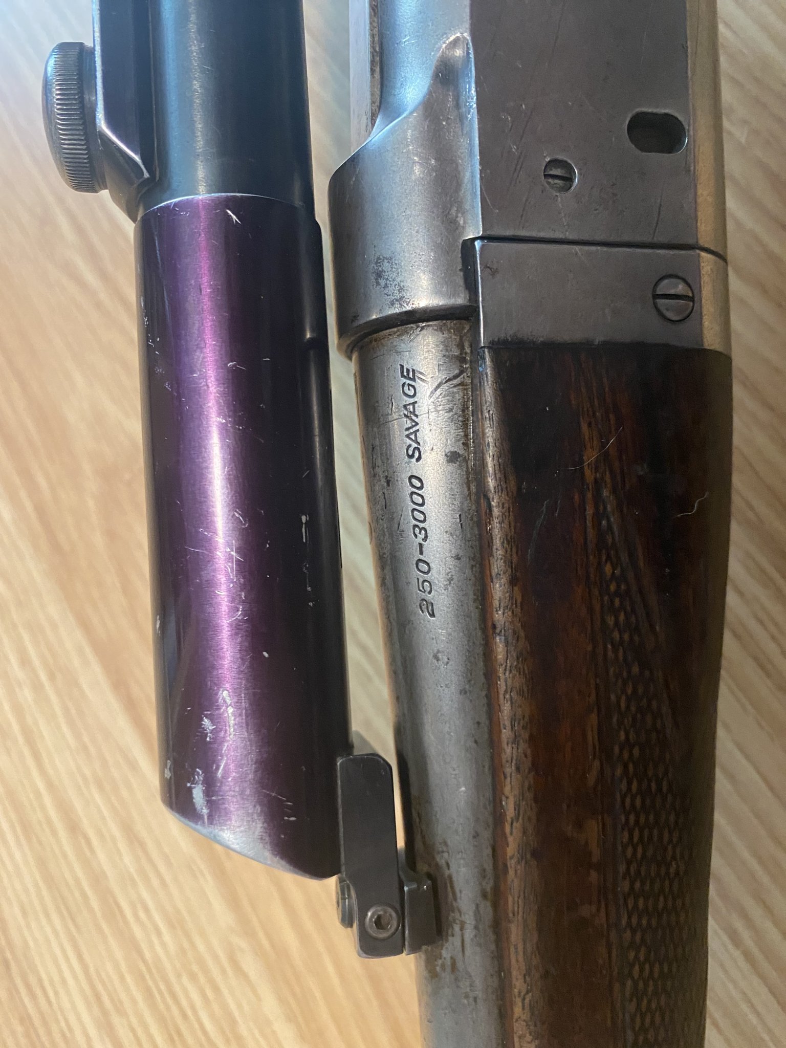

    Thanks for the information! Looking at the 250-3000, it's definitely old, very old. Here's a few more pictures of that. And the 1/14 twist is a bit shocking, I wouldn't have guessed that! Based on the dates on the barrel, it's definitely older than 1926, but no earlier than 1909. I'm not sure if the serial number helps you at all, or if you know how to decipher them.

    And here's a few more of the .300. It's much newer, maybe 50's-60's?

    Serial number will help tremendously if I can find the website again that dates them. Definitely later than 1909 as the .250-3000 didn't come out until 1915. First year production serials started at 175,000 and went through to 177,000~sumpin' Which would still put yours in the 19-teens. (Maybe just the model I had) No exact date, but definitely 19-teens. Also note on the barrel it shows 1899. Early for sure. However, that's kind of the 'plain jane' model. If it were the fancy model it would be a 'takedown' and have a perchbelly stock. It would also have a Marbles peepsight. What appears to have happened is your rear buckhorn sight was removed, and the dovetail used for the front scope base.
    The 1-14" twist was used to properly stabilize 87 gr. bullets. Savage used a marketing ploy to announce the first 3000 fps cartridge. Thus the -3000 in the name. Charles Newton, who developed the cartridge for Savage wanted to use the heavier bullets (100-120). But. Savage wanted the hoopla of 3k fps. Later, they changed it to 1-12" and late models (up to 1983) a 1-10" twist to handle those heavy bullets.
    The "High Pressure Steel" is significant also to the rifle. While the first many years of production (1893 onwards) it noted it could handle a lot more pressure than comparable rifles made in America. Notably the Winchester and Marlin series of lever guns. The .303 Savage was the first smokeless powder civilian cartridge in America.
    Newton also designed the .300 Savage. It'll do just about anything a .308 will do as it's the parent cartridge (T-65) for the 7.62/.308. Added: The changes made were for feeding a machinegun. It's also the basis for the 'International series' of cartridges being used for competition necked to 6mm, 6.5mm and 7mm. The latter was adopted by the Venzuelans briefly as the 7x49 in the FN-FAL rifle. U.S. pressure put an end to that.

    1. Stith mount has some $ value to Savage collector.
