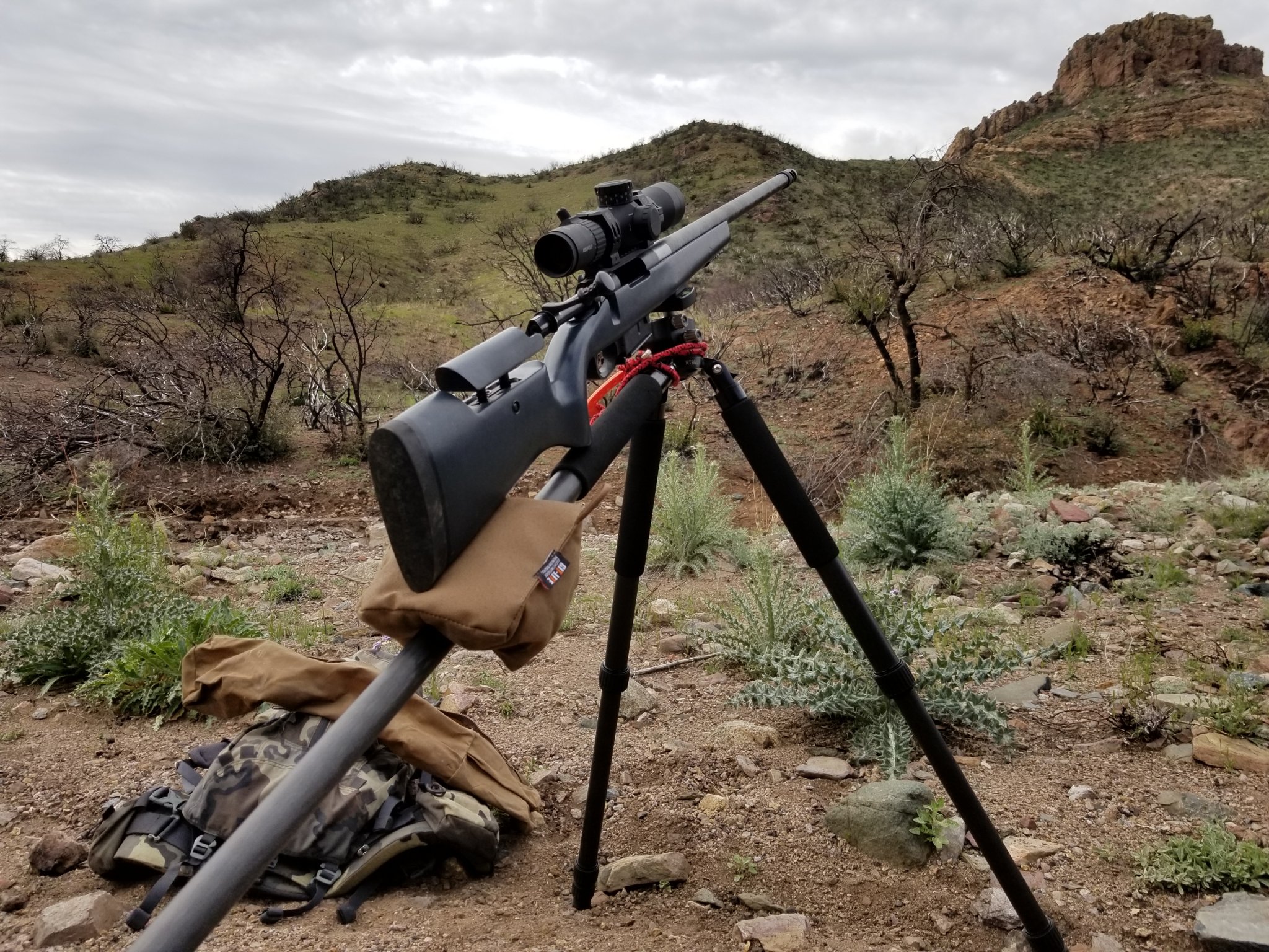

7 saum, 300 wsm, or my favorite the 7 Sherman Short mag.
I say the 7 sherman is like the 6 br of magnums. Super efficient. Using 26 proof barrels, I got my 7 rem mag to 2950 with 68.5 gr H1000. I got 2979 with 61 grains of H1000. H1000 isn't the best powder for 7SS.
It is also inherently accurate. You can't hardly make a load that doesn't shoot with the 7SS. A 180 vld in ADG/Sherman brass with 60.5 gr rl26 and you be 3020 fps +/- in a 26 proof barrel. And, it will shoot sub moa. Even fireforming the brass four rifles I know of are .5 moa and better with all sorts of bullets.
In a 10.5 pound set up, braked, recoil is nothing. And, the numbers on a 180 in 7mm rival or beat lots of 300 loads with less recoil. I love it off my tripod in the mountains hunting.
A 7mm with the right bullet will take any critter you named. Its as effective as a 180 300 wm.
