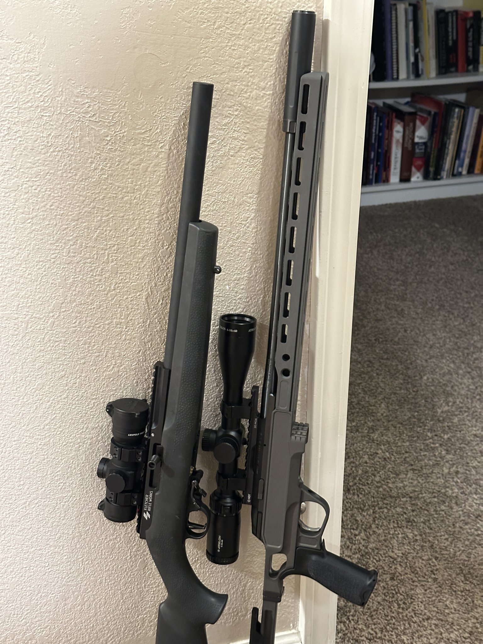

Here is a picture of my 11/22 with a gemtech mist 22
And next to it is a tikka in a gray birch chassis the suppressor is a dead air mask
I’m not sure what your ultimate goal is, but there was only a few inches difference between the two
