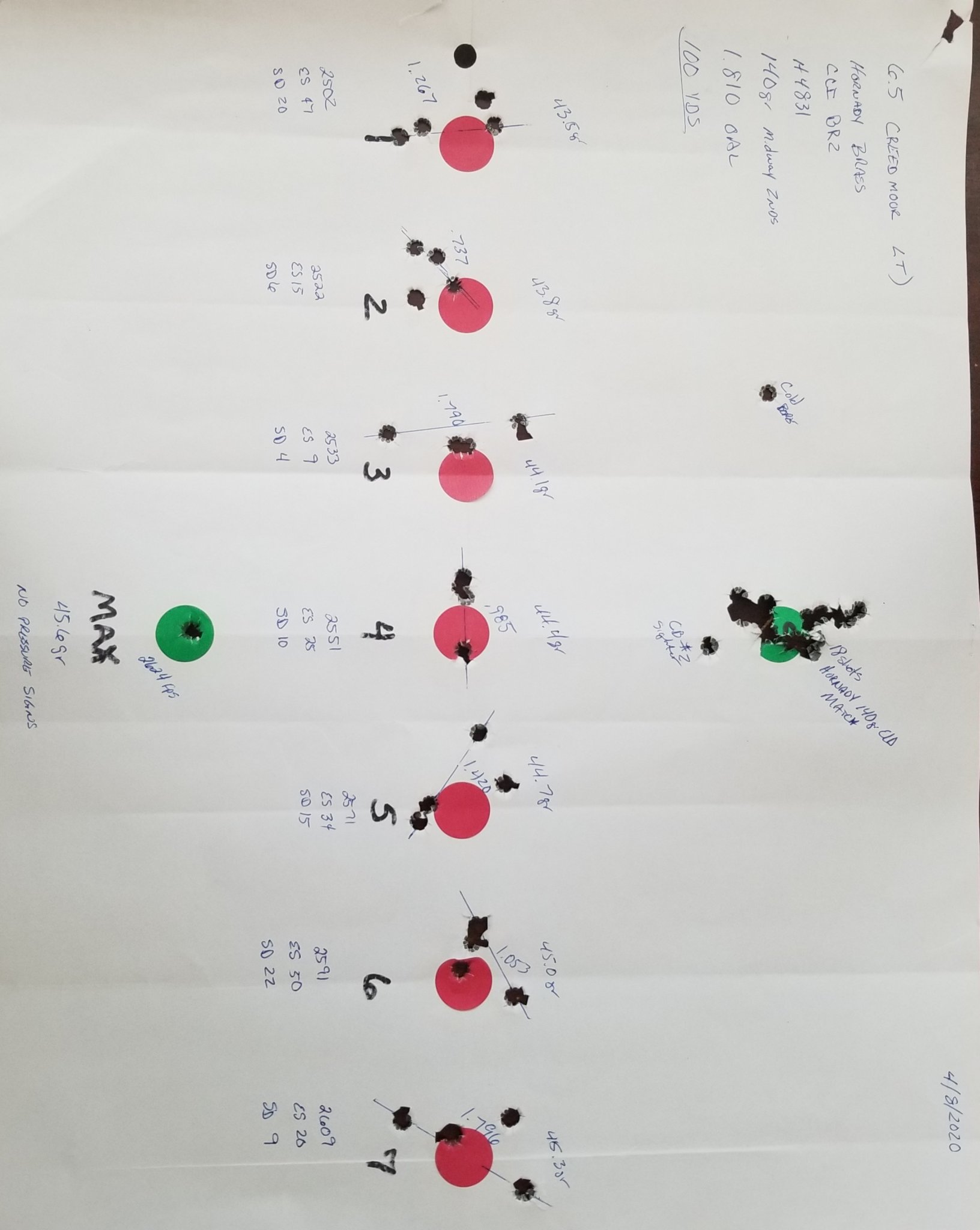

    Granted I'm still learning to drive this thing. A large frame AR is definitely different than a bolt rifle.
    I loaded a factory round in the mag first then the test round. Fired the test round and repeated. The factory round was kinda beat up from the repeated chambering by the time I got through 4 rounds of 7 charge weights plus a single max load round. I'm happy with this process.
    What I learned.
    1. I need to practice alot more with this platform. Obviously.
    2. The extra round in the mag gave the same recoil pulse after the shot, but it would have been the same without it albeit the bolt locking back does feel different on the follow through.
    3. My Max charge weight was published at 45.6gr of H4831sc, I did not have any pressure signs, at all. Should have loaded more rounds than just one, and possibly another round .3 over.
    4. 4th group is probably my OCW. But the third group could've been me. SD was 4 on group 3.
    5. Hornady 140gr eld Match runs average of 2665 fps with an SD of 14. My OCW is 100+ fps slower. H4831sc is probably not the powder I want if I wanna run at 2650+.
    6. My cold bore is a bitch.

    Now I need to decide next time if 3 rds is sufficient or should I do 5? I did 4 this time of each just in case I knew I had a driver induced flier. I did 7 charge weights because I am new to loading 6.5CM, there is also not a lot of data for H4831sc. I had the powder on hand and wanted to get a feel for it all.
    I learned a bit, burnt up a some powder that was sitting around, as well as got some practice in. Right, wrong, or Indefferent, I'll chalk it up to experience.
