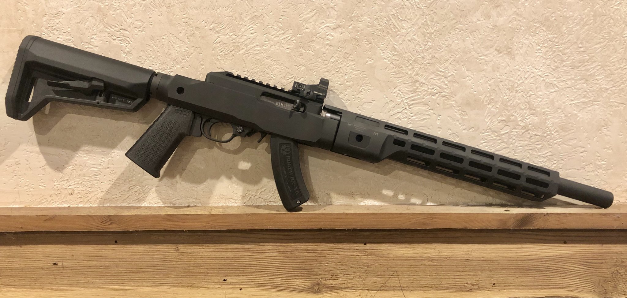

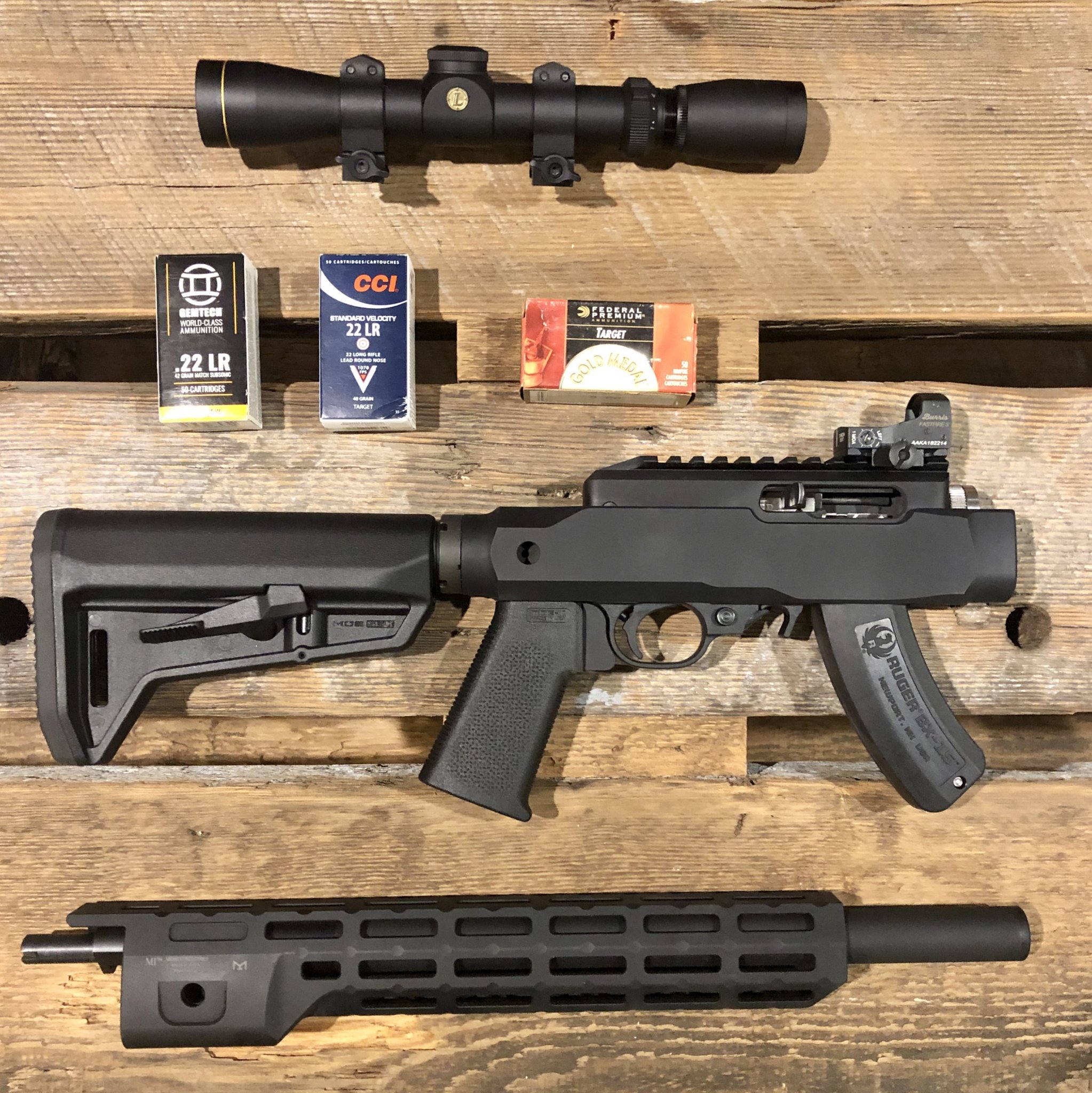

I got a Gemtech Mist TD (takedown) which I first put in a stock Ruger 10/22 takedown setup (trigger, bolt, receiver) but with a Magpul Backpacker stock and Leupomd 2-7 rimfire scope. Tried a variety of ammo (CCI std, Gemtech subsonic, Fed match etc) but couldn’t get it to shoot under 2” at 50yds.
Upgraded to a BX trigger (which will soon go to Brimstone for a tier 2 job), Brownells BR22TD receiver and Midwest Industries chassis & rail system. Tinkered with the action screws and barrel tensioning ring and it’s now shooting at or right under an inch at 50 yds. The integrally barrel is very quiet with subs, about the same as my 16” Tacsol setup with Tacsol Axiom can. (Btw that Tacsol build has a Kidd trigger which is SWEET!). I’ll try to get some pics posted up soon.....

All very good & valid points laid out above. I went thru much of the same reasoning, but when I saw the opportunity to snag a Mist TD a couple years ago for $325 shipped to my dealer I decided wtf and rolled the dice.. So the add’l cost of the single stamp Mist over a 2 stamp suppressed sbr 10/22 was $125 - worth the gamble to me. I knew that TD’s aren’t inherently accurate but I’ve got other 10/22’s and a couple b/a CZ’s for that. This one was intended to be more of a tin can/steel plate/armadillo whacker. With the Burris FF rds its definitely not the most accurate rimfire I have, but it’s the most fun and the one in the lineup that friends/family want to shoot the most.
