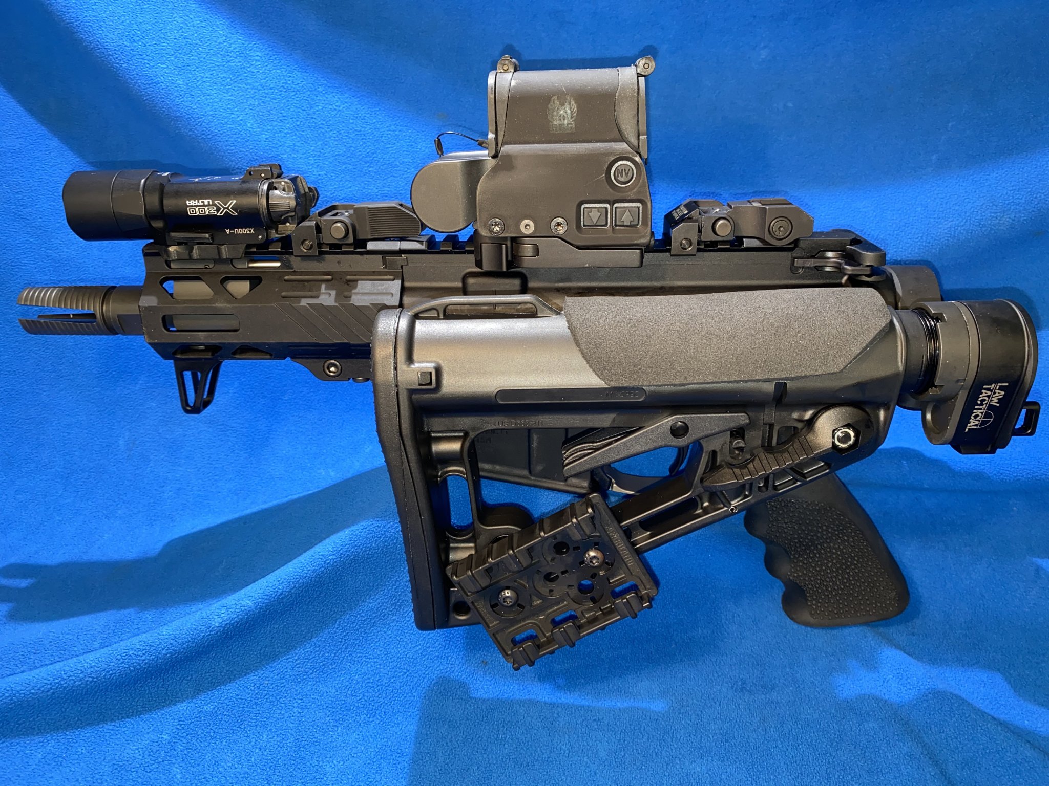

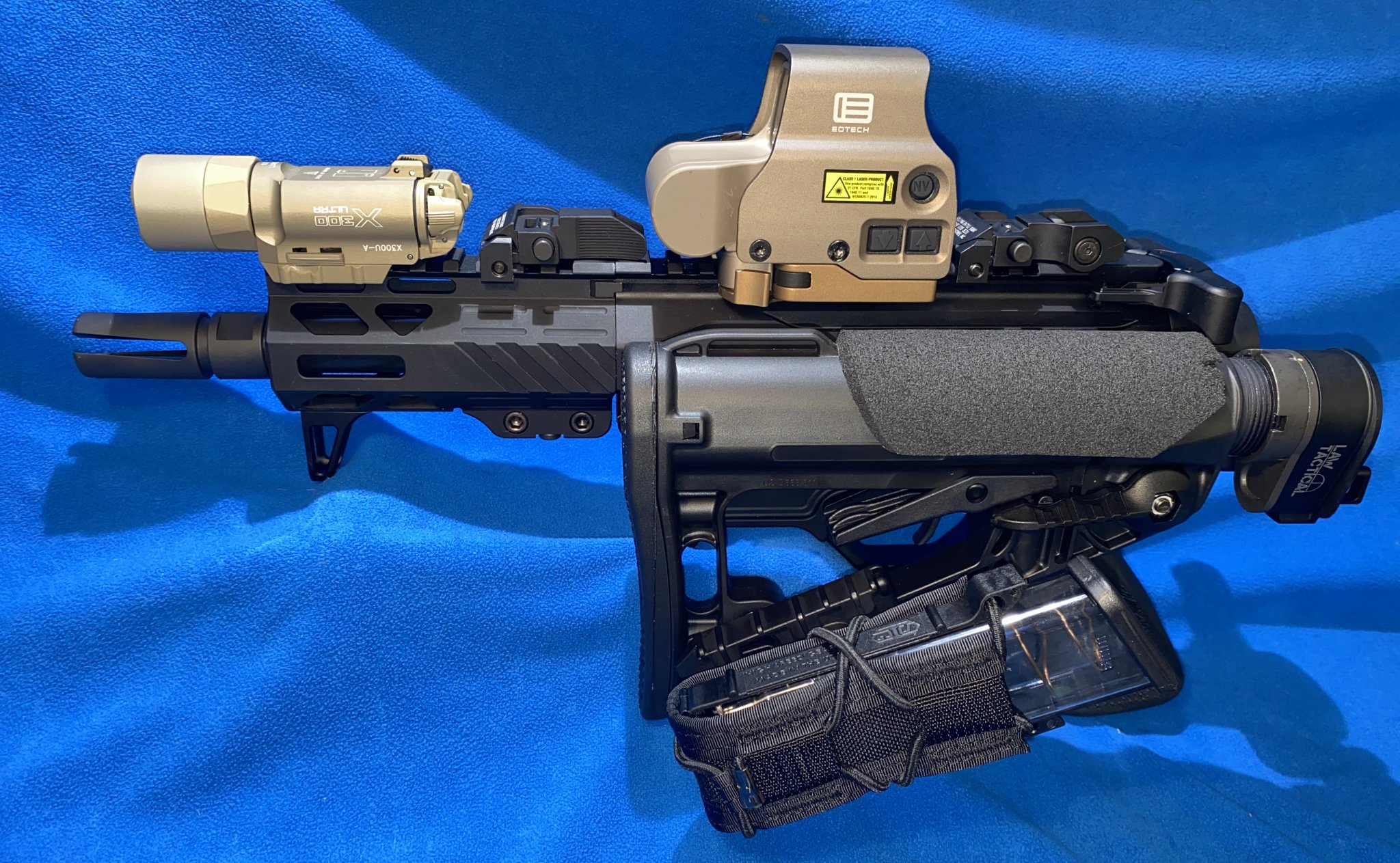

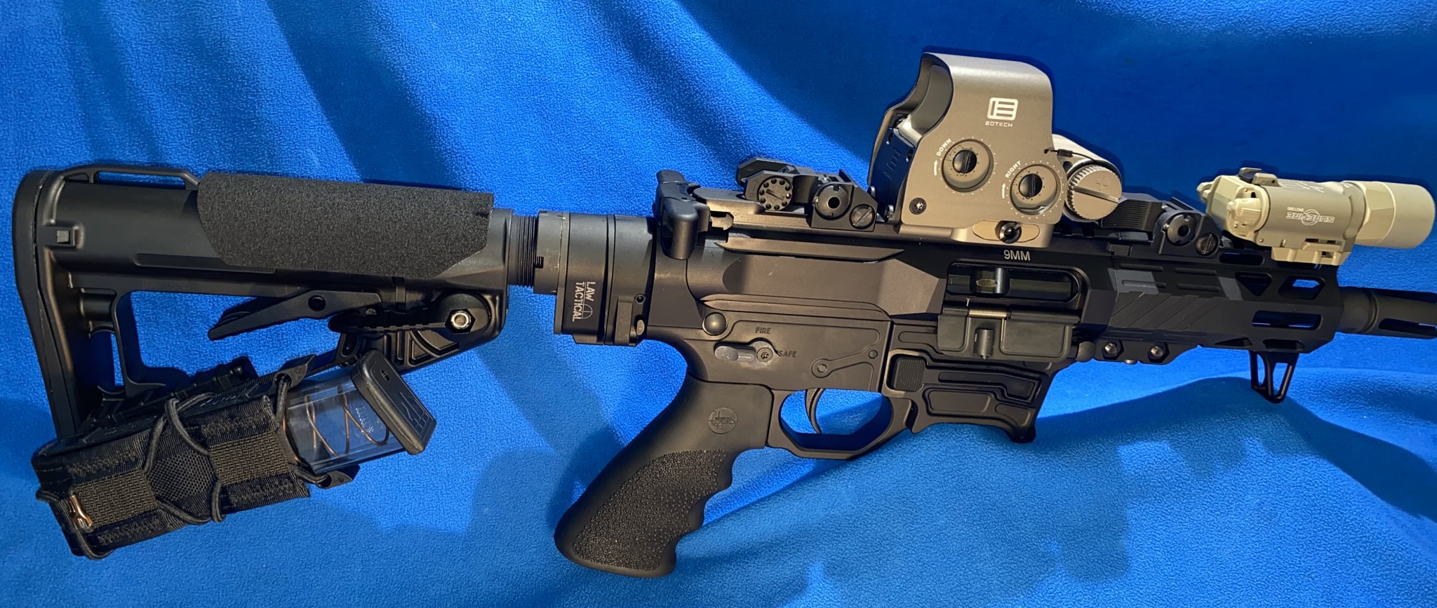

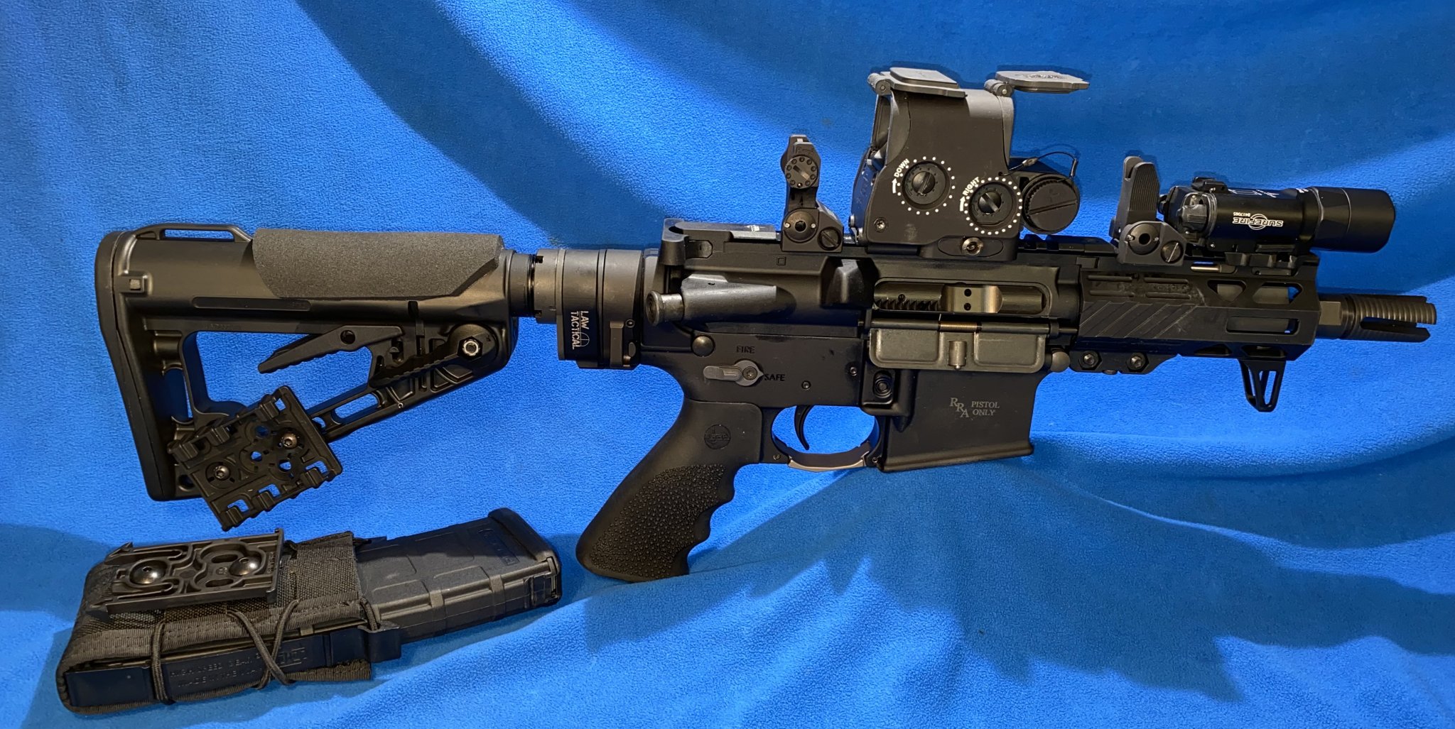

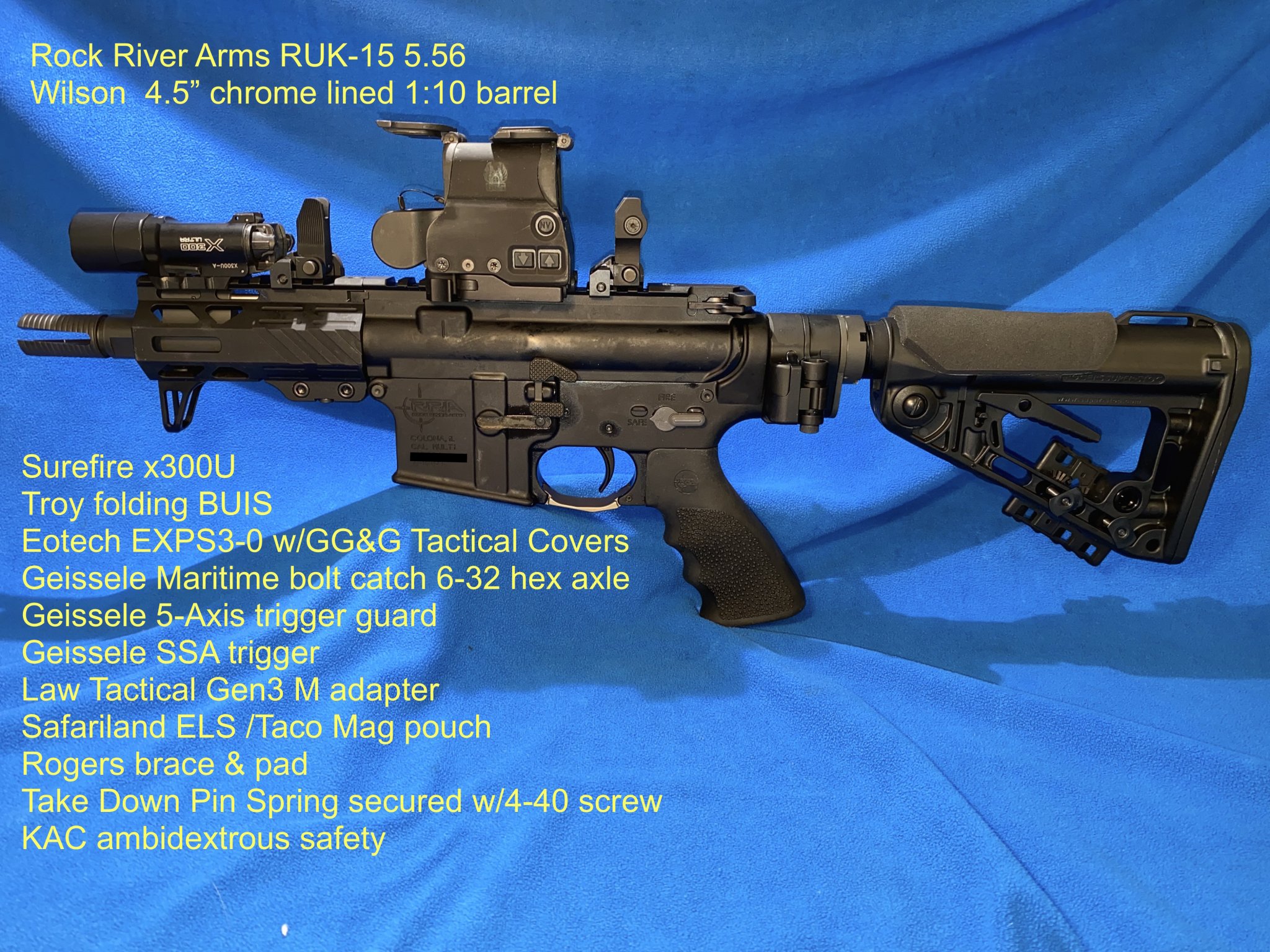

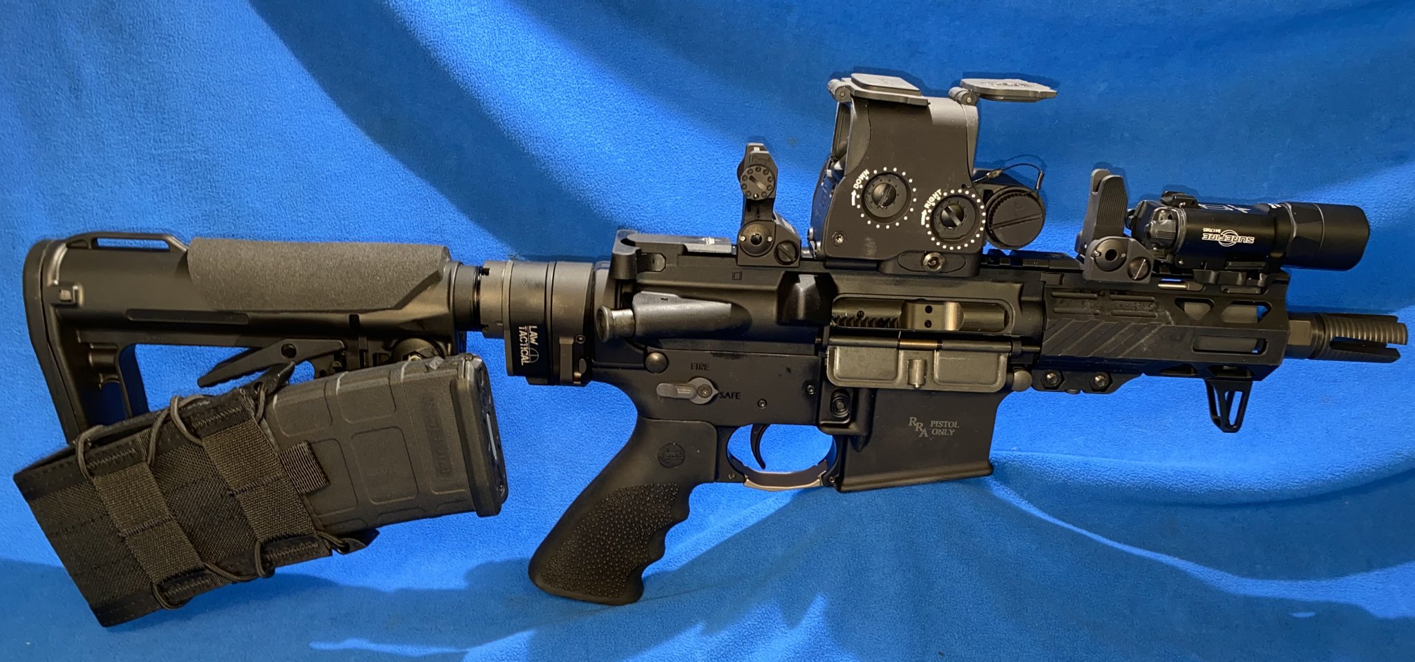

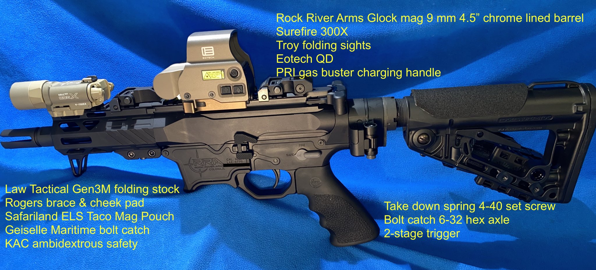

I just finished cobbling together these two RRA 9 mm / 5.56 pistols using the Law folders, pretty small packages.
