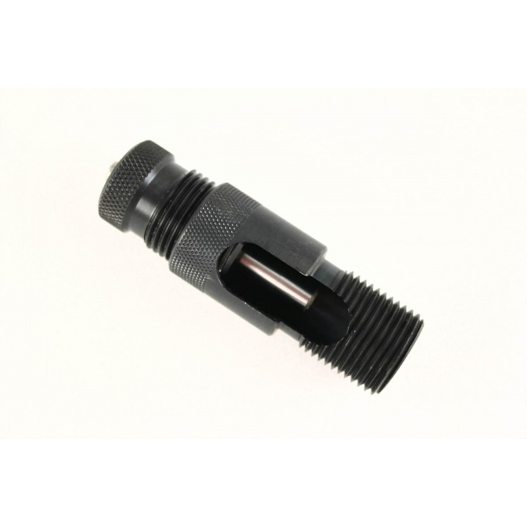

OK gents. Here's the scoop. I've been using the Sinclair gen II die body with Sinclair steel mandrels. At the moment, I'm gearing up to reload a new cartridge. My original thought was to just pick up a new mandrel for my existing die body, but then I remembered I've seen a lot of posts that mention K&M and 21st Century. So, I went ahead and looked at those two to see if they had something to offer. At first glance, I would say that I find the 21st Century setup more appealing. It is a familiar design that gives me a die body with a view window and more options on mandrel sizes. The K&M has some features that I also like such as the nice storage case and even more mandrel size options. From what I have read in this forum (and others) both get the job done. So, I think either would work for me. What I don't know is what are the benefits that are gained from K&M's different design. For example, it appears that the press adapter is threaded into the window riser and then the riser is threaded into the press. It seems like that would be handy if you wanted to test a couple different neck tensions on the same cartridge. What about the fact that the mandrel is secured to the press adapter with a bolt? It seems a little less robust than the drop in design of the Sinclair, but maybe I'm missing something. Is anyone actually using that bottom bolt that is supposed to bottom out before the case neck hits the top?

Yeah. I read that at one point. I actually like the idea of the windowed die body. That's why I would lean towards a new die body.
Not only do 21st Century Mandrels fit in the Sinclair Die body, they now offer mandrel sets that include a full range of sizes in 1/2 thou increments.
For sure. That's one of the reasons I was already leaning towards the 21st Century setup. Mostly just curious if I'm missing something on the K&M that would push me that direction.
Sure you arent mixing up 21st century and k&m with the viewing port? The 21st is a solid body unless there is something new thats not on their website or social media.

I am assuming they are using their own die body in the video. It looks like the same die body as the picture (with the window pointed away from the camera). I could be wrong though.

I guess I wonder what you intend to see in the viewing window. Assuming your not bottoming out when running necks through it a viewing window isn't going to give you much feedback. I'd say you're probably better off upgrading the mandrel to either their TiN mandrels or carbide. I found the SS mandrels would gall unless I used sizing lubricant. I prefer to use dry lube on my necks so switched to Carbide and the TiN mandrels.
I thought it was handy to have that visual feedback. Re: Carbide/TiN - I intend to upgrade the mandrel material as part of this. Which made me notice something else. Anyone know the material of the 21st century mandrels that are sold in 0.0005" increments? It doesn't specify.

I use the k&m with the adapter with a window it works good u can see how far the case goes up the mandrel. Not saying there better never used the others mentioned but they work I had k&m custom grind all my mandrels to the neck tension I wanted

I use the 21st century die and mandrels. There is no window. To make sure I don’t contact the top of the case with the die I put a stack of 4mmx2mm disc magnets on the Co-Ax press next to the shell holder. This gets full mandrelification and stops the case neck just below the body of the die. Use more or fewer magnets for different height cases.
If you take the top of the expander die body off and remove the mandrel you can raise a case up into it with the press and see exactly where the end of the case neck is in relation to the lip that holds the mandrel body. It’s easy to adjust perfectly.
