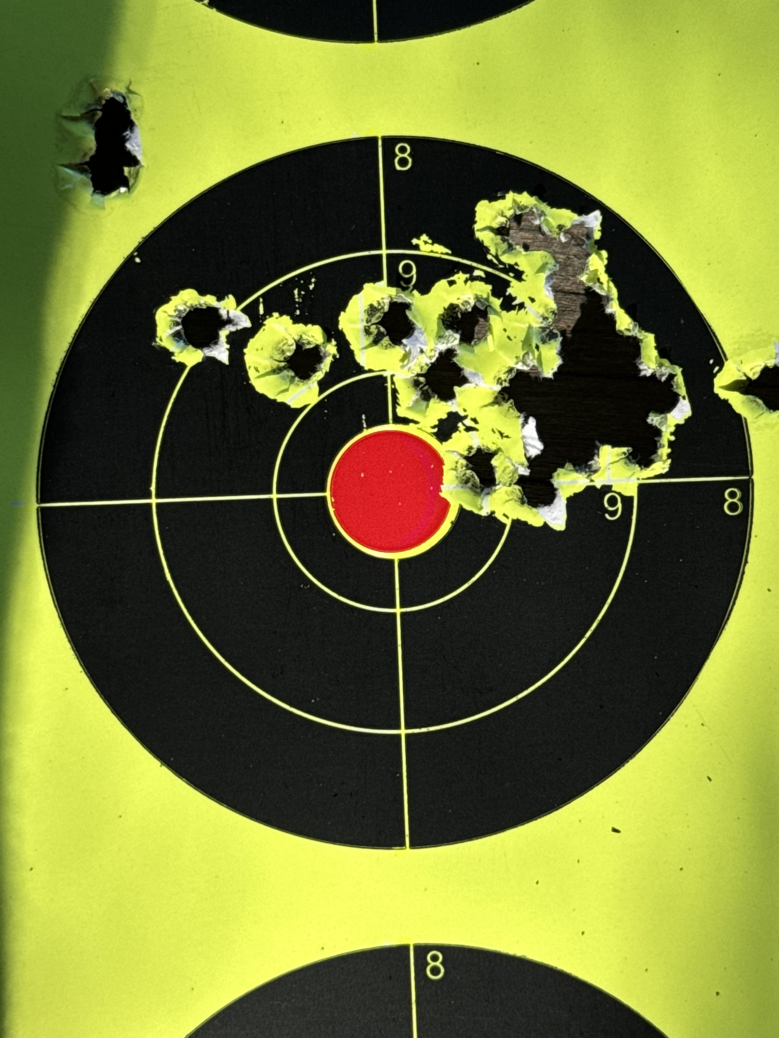

    Here’s the situation:
    Picked up a PVA osprey 6 Creedmoor 1:7 barrel with what should be a standard chamber.
    I’ve been testing various factory ammunition to see how well it works, and I ran into an interesting issue with Barnes 112gr rounds.
    On a cold gun while taking my time to shoot, I got this:

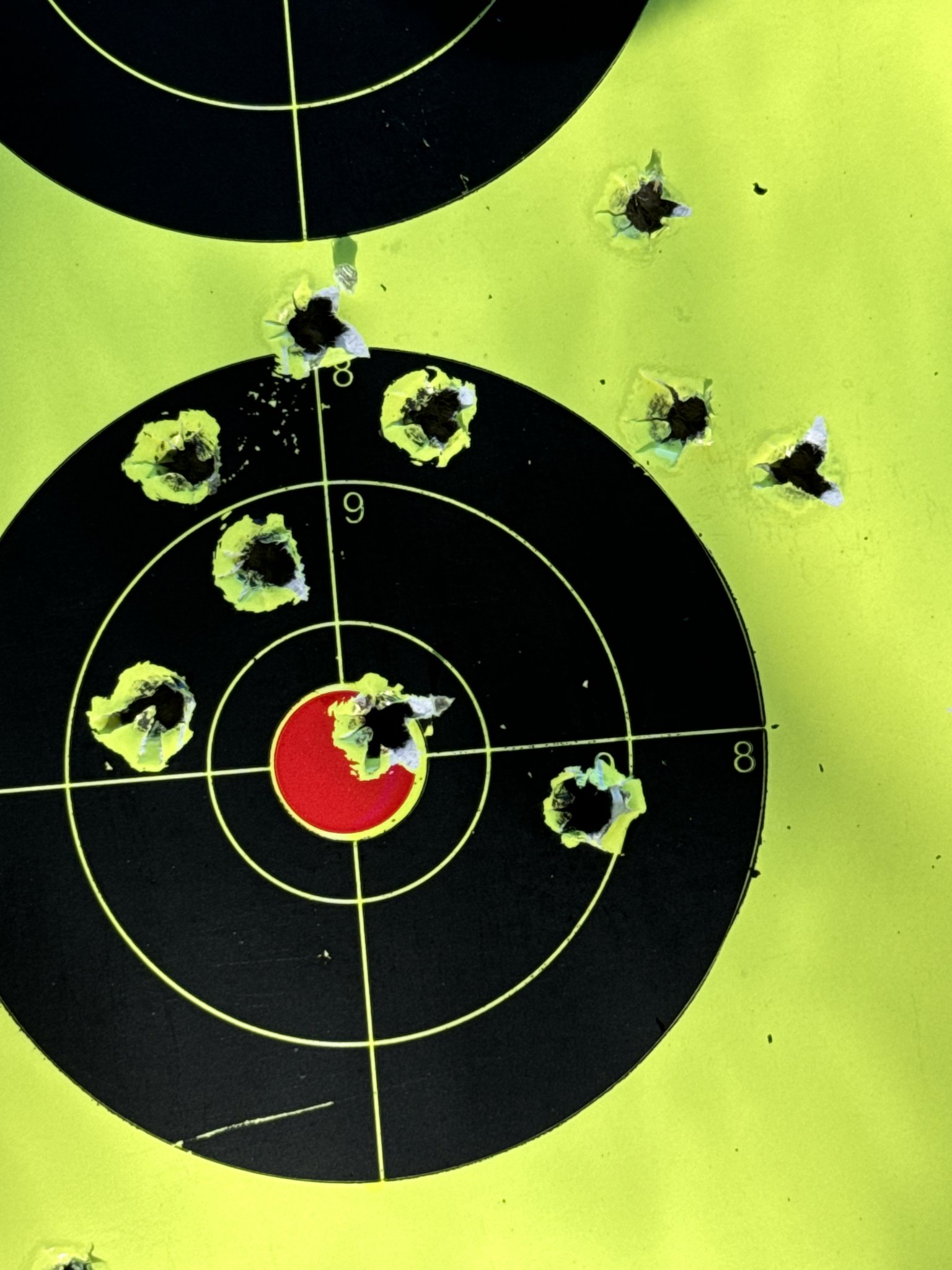

    With a very warm gun and deciding, I didn’t give a crap anymore, I got this shooting rapid fire (it’s probably more like timed fire and so far speed was concerned… cycle bolt, aim, fire, cycle bolt aim fire…):
    What I did notice was that I shot fairly well 20 rounds for the second set and I definitely ended up with a grouping.
    I filed it under interesting, but then I started thinking:
    - Cold barrel initially, warm barrel for the second string
    - Abel Thorium-L vs thunder beast ultra9 for the second string
    Can either of those things significantly affect the groups?
    I would not expect either of those cans to do anything but make things shoot better.
    Other ammunition does tend to work very well in that rifle… the 112gr ammo has shown to not do such a great job… at least initially. 110ATips shoot very well, as do a variety of ELDM and Berger rounds

    I'm betting the can. Go shoot it with the U9 cold bore and see what results you get.
    Reactions: FuhQ and GBMaryland
    Different cans, different mounts, different weights all play a factor. Your barrel is like a tuning fork. Change in tune produces different results
    If it doesn’t like 112 as much as the others I’d just set that aside and rule it out.
    My TBAC U9 has zero negative impacts on any gun I’ve shot it with. I have yet to test a rifle in 6.5/308 calibers where it hurt accuracy vs bare muzzle or brake. That’s probably 6-8 guns or barrels I’ve used it on
    Many possibilities one of them is bad trigger pull, shooting slow you may be disturbing the rifle as the
    trigger releases the sear. Rapid fire you are probably slapping the trigger disturbing the rifle less.
    Yeah any suppressor weight or adapter weight will play with harmonics. If you have ill effects from a suppressor or any other muzzle device. It’s possible that the threads are not centric by a small margin. I dont know I had pva prefit that I could not get to shoot consistently. Kinda turned me off the whole prefit thing. Plenty of people have good luck tho. My Smith spun up a bartlien and it’s night and day.
    I went back out and I did some test firings yesterday.
    I will say that the rifle seems to be very sensitive to certain loads, even if it’s factory ammo.
    Interestingly, federal gold medal match 107 Sierra match King ammo shot one ragged hole at 100 yards.
    The rifle definitely does not love 112 grain burger, and other ammo shot OK… just not exceptional
    I was trading on an off between the two suppressors to see if there was a difference, but the thunder beast and the Abel had the same POI.
