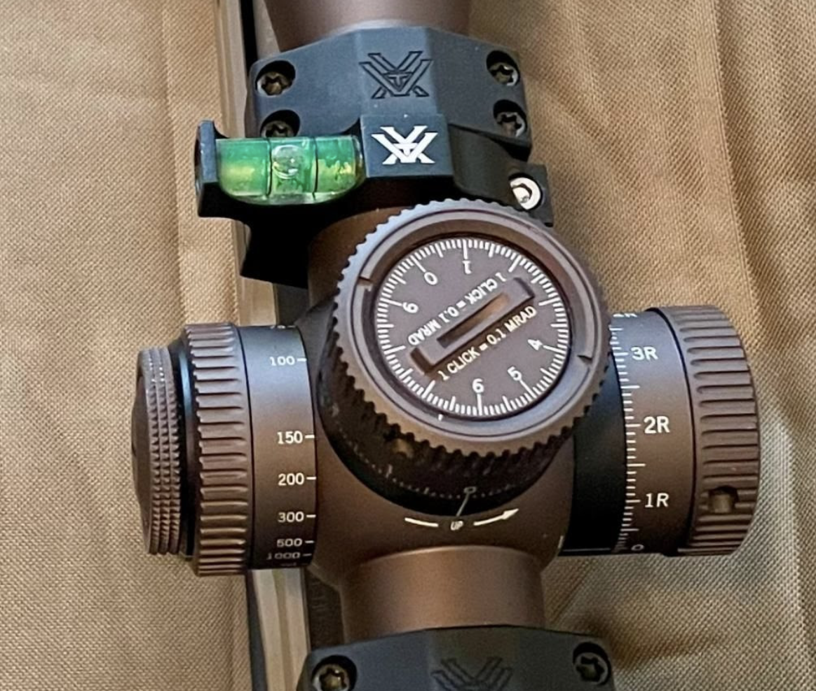

If you like it and have $230 burning a hole in your pocket then grab one. I personally like a scope tube mounted level. It’s at perfect eye level for me to see right over the parallax knob.
^^^ This. If someone were to give me a Send-It level or two, I'm sure I'd try them out. But I can't bring myself to pay even even 40% off for one when plain ol' Vortex bubble levels for $40 apiece get the job done and are easily visible from my cheek weld. [Hopefully Frank doesn't see this and get triggered into an anti-bubble tirade... 🤣🤣]
