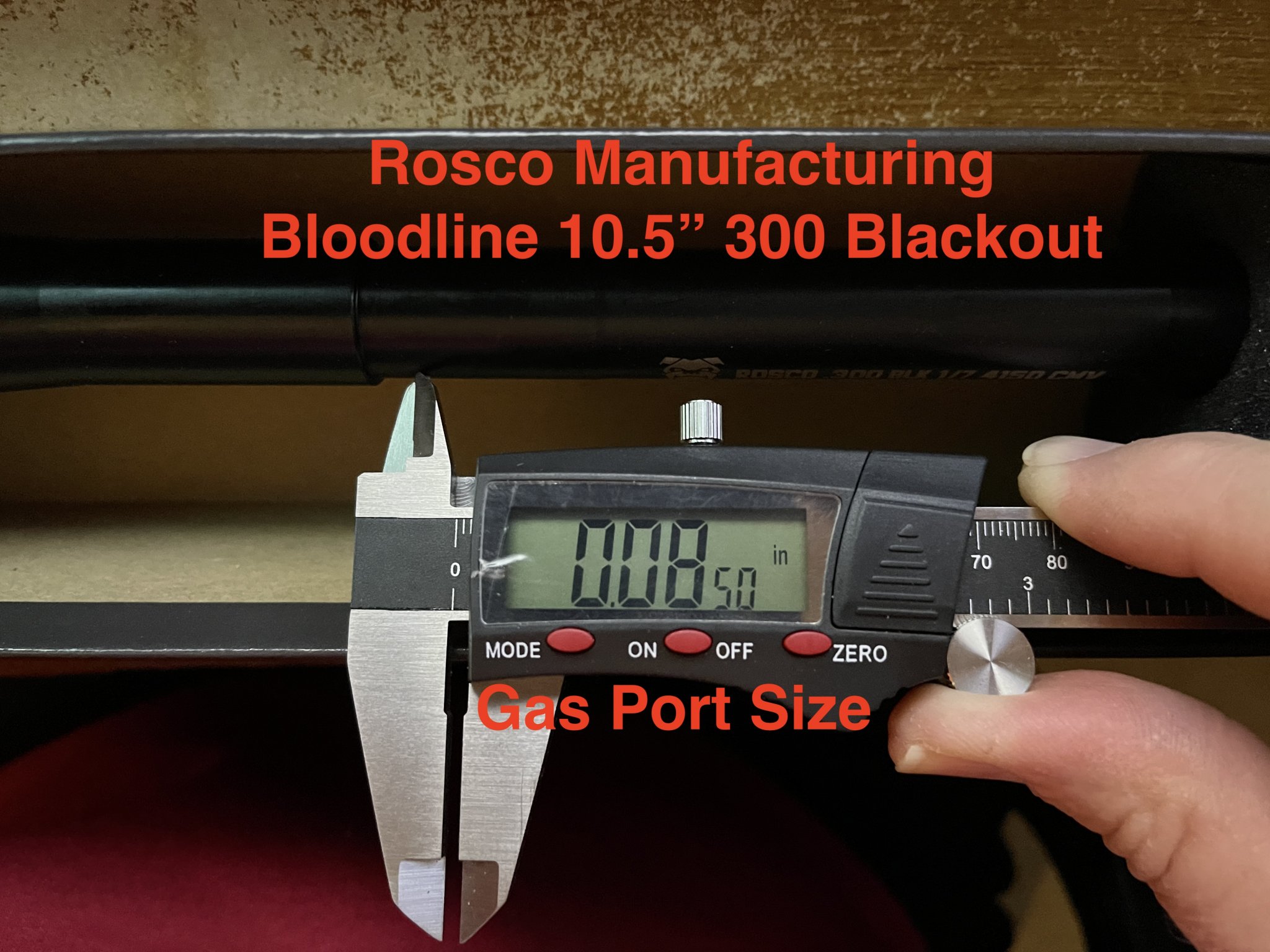

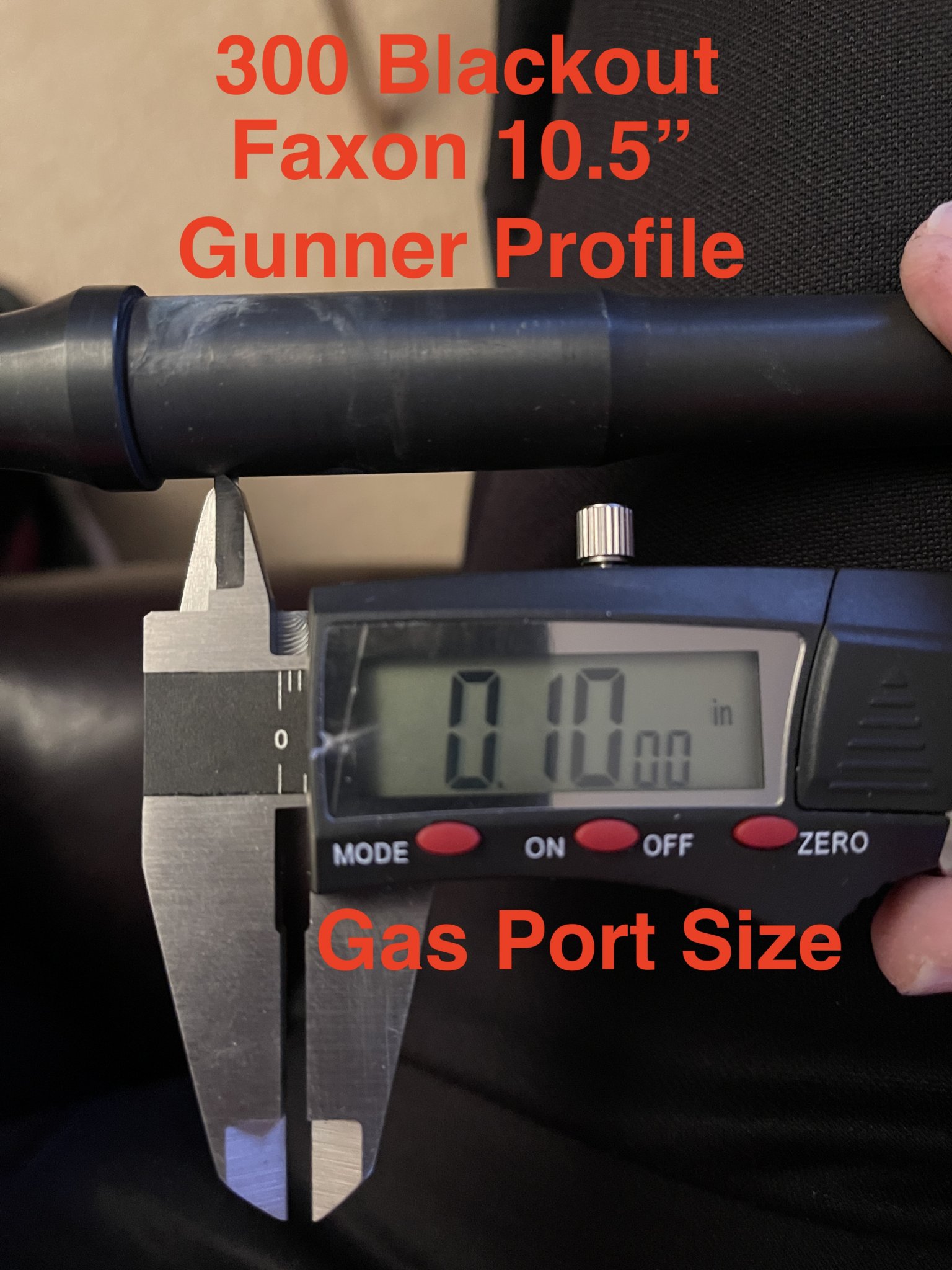

While I waited for the Sup Arms AGB to come in, I took the rifle apart and removed the Aero Precision AGB. Decided to measure the gas port size (see picture below) of the Faxon barrel. The Rosco Manufacturing barrel came in today and I measured the gas port size for that barrel (see picture below). I have installed the Superlative Arms AGB on the Faxon barrel but have not yet been to the range yet. Given the gas port size of the Faxon, I don't hold much hope...but have the Rosco Barrel basically ready to install and get the SBR up and running.
Faxon Gunner profile 10.5" pistol length gas: 0.1000" gas port size
Rosco Manufacturing Bloodline 10.5" pistol length gas: 0.085"gas port size

What bothers me about the situation more than anything is that barrels for small frame AR's are usually much more consistent and I don't expect this variance in gas port size. Large frame AR barrels...yeah, very inconsistent and frequently I have found that drilling out the gas port is needed to get the rifle dialed in.

2) Gas port diameter on current barrel (Faxon 10.5” gunner w/pistol length gas) is too large

Went to the range on Friday with the new Superlative Arms AGB on the 10.5" Faxon barrel. Tried 110gr V-Max, 147gr Federal American Eagle, 190gr Sub-X and 208gr A-Max. All still failed in form or another at gas wide open (18 clicks). Went through a series of tests down to 15 clicks from closed and up to 23 clicks from closed. Same behavior regardless. Opted to go home and put the Rosco Mfg 10.5 Bloodline barrel on, then retest.
Saturday (Yesterda), removed Faxon barrel (10.5 Gunner profile, 0.1000" gas port diameter) and new Superlative Arms AGB. Installed the Rosco Mfg 10.5 Bloodline barrel and the Superlative Arms AGB. Set the gas to 18 clicks from closed and reinstalled the handguard.
Just got home from the range:
Tested using the normal 1 round to verify lock-back for 110gr, 147gr, 190gr Sub-X and 208gr. With gas port @ 18-clicks from closed, no issues on 110, 147 & 190. Unfortunately, the 208gr A-Max is still not ejecting round.
Loaded up 3 rounds of 110gr. V-Max...rifle cycled perfectly.
Loaded up 3 rounds of 147gr. Federal American Eagle...rifle cycled perfectly.
Loaded up 3 rounds of 190gr. Sub-X...rifle cycled perfectly.
Loaded up 3 rounds of 208gr. A-Max...rifle failed to eject the first round.
Since my SBR will primarily run suppressed (once the can is out of ATF "jail"...probably 30-45 days yet), I will hold off on any more testing since I know I can load up the 110gr and 147gr and the rifle will work just fine. Once I have the can (OCL Hydrogen L 7.62), I will spend more time dialing in the rifle (including removing 1 tungsten weight in lieu of 1 steel weight to make my JP SCS an H1 instead of the current H2).
All in all, the Rosco Mfg barrel actually felt better and didn't have as much recoil...so that was good $ spent. :)
I fought same thing with a faxon barrel. Discovered the gas block was machined in the wrong spot, set too far forward, so the standard length gas tube was not into the bolt where is should be, but about 3/16-1/4 inch out too far. I got a custom longer gas tube, went back to test but had other issues with the barrel, breach was machined wrong, so I just returned it.. nothing but problems.

In the end, I ended up rebarreling with a Rosco Mfg 10.5" Bloodline barrel. After re-assembly and setting the SupArms AGB to wide-open, I started dialing in the rifle using a variety of subsonic ammo. My 300BLK prefers S&B 200gr subsonic OR Fiocchi 220gr Range Dynamics subsonic ammo. If needed, can also shoot Hornady 190gr sub-x...but it's not as consistent as the 200gr S&B. ;)
For supersonic ammo, I can shoot 147gr or 150gr with no issues.
