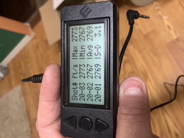

I get single digit SDs with Varget.
This is my 308 load using Varget out of a 20” Savage barrel. It also shoots sub MOA out to at least 600 yards.
no it’s not
