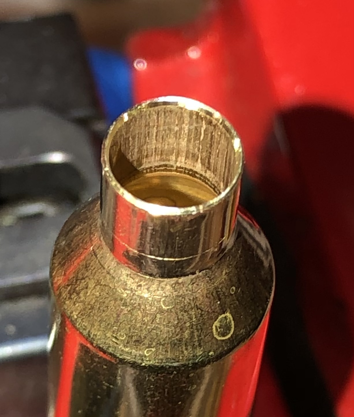

I have some new ADG 6.5 PRC brass that has a slight internal donut or raised rim at the bottom of the neck. These were prepped with a turning mandrel, trimmed/chamfered and lubed with HbN prior to loading. Loads fine until the 156gr EOL hits that donut. Anyone run into this? Possible solutions other than inside neck reaming? I tried running them through with the mandrel again, but the donut remains.
I have two 50ct boxes of this brass, same lot number. First box loaded without issue; second box not so much. The fully crushed case did not present as much resistance as one would think necessary; more than lubed .002, but I don’t recall going gorilla on it. Then again, I’ve never crushed a case like that before.
I may load them with shorter 130 hybrids which would not be below the neck/shoulder junction, fire them, then go through full prep including annealing to see if that helps to smooth things out. I am hoping to avoid inside neck reaming.

I don’t think it’s a doughnut. What makes you think it’s a doughnut? Did you measure the neck diameter at the case mouth and at the shoulder?

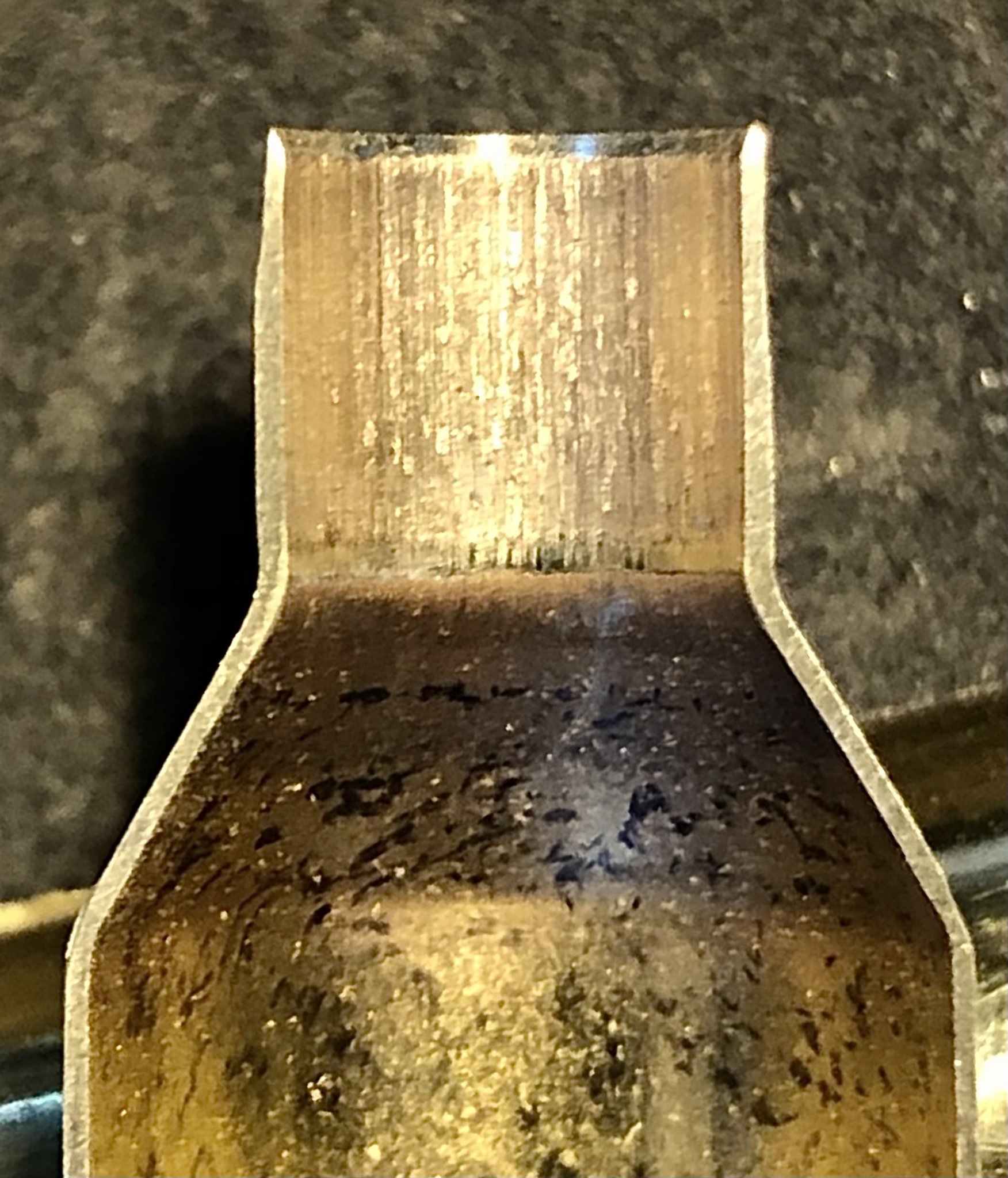

In the second photo you can see a raised rim at the bottom of the neck. It is more ‘polished’ where the mandrel encountered more resistance. Maybe donut is the wrong term, but it definitely presents enough resistance to deform/crush the case.

Reflected light at neck/shoulder junction looks curved. Is it?
Maybe some straight edge pics? Box cutter blade edge is pretty straight.

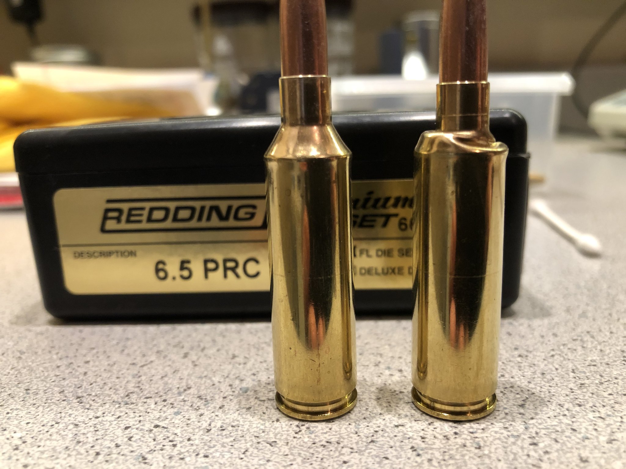

The loaded case on the left is only partially pressed into the case. I stopped when the resistance increased. The curvature you are seeing is where the boattail stopped on that raised rim. Still deformed the shoulder slightly. These cases have not been turned.
I’ve checked the seating die to make sure it is not interfering with the case and it is not. The crushed case is from too much seating resistance. Checked bullet diameter and it is typical Berger perfection at 0.264”
if you sized the inside of necks with a neck turn mandrel there’s no way you should be crumpling shoulders like that with a few thousandths neck tension.

That sucks. Donut looks clear. I've inside neck reamed to clean up galled and donut cases.

I will cut a few pieces to have a look at the internal profile. Also going to anneal a few then prep and try to load them.

at least one of them is adjusted currently so low that the neck end is visibly shorter than the case neck in the properly loaded cartridge. It's set up adjusted too low.

I should have been more clear about the two cases shown. The one on the left is not fully seated. I stopped seating that one when resistance increased. Even though I stopped, the shoulder/case junction had started to bulge outward. You can see the slight curvature in the photo. Regarding the seating die, I can set an unloaded case in the Forster, cycle the handle all the way down, and the die does not interfere with or touch the case.

As a test I annealed 5 pieces of the new brass, FL sized it, ran the mandrel through twice, lubed the neck with hBN, then attempted to seat the 0.2645” bullets. Too much tension. Found some 0.264” bullets, and was able to seat those with a bit more resistance than normal, but no case deformation.
I’ll send this photo to ADG and will report back with their conclusions. Probably just need to get a 0.263 mandrel, or use the expander ball as 918V and Whatsupdoc have suggested.

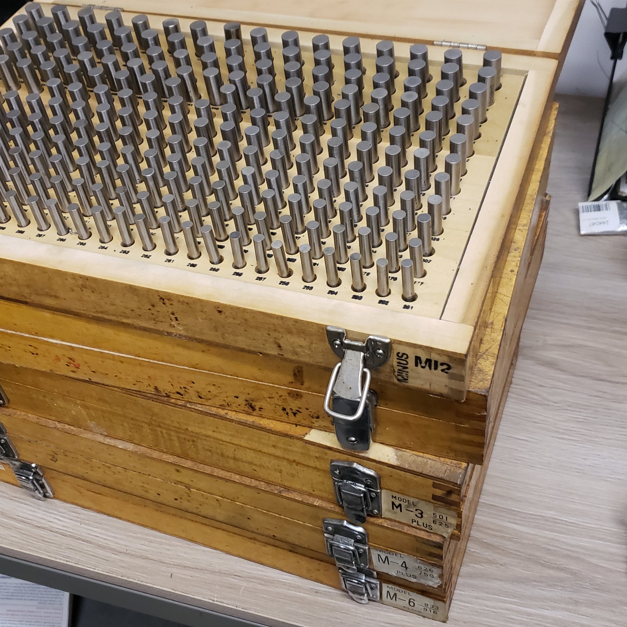

Amazon sells individual pin guages on the cheap. You can put together a set to cover the range your working in.
