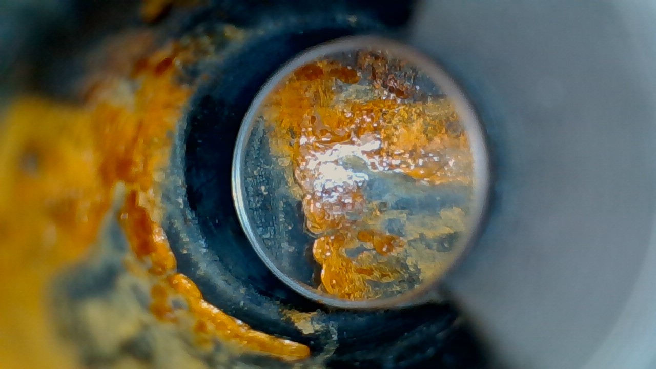

I got a cheap bore scope to be able to check my barrel for wear, and often take it with me to the range if anyone wants to have a look into their barrel. On a couple of occations i have had a look in a couple of Tikka T3x 308 light barrels, that according to the owners only had shot a couple of houndred shots.
Both of them did how ever have strange pittings that i dont really know what they are or what caused it. My first guess was that the rifles(being hunting rifles) had been used in the forrest, and rain droplets had gotten into the barrel during hunting trips causing corrosion. But i have seen this in a third barrel also, and i know that one hadnt been used in rain. There are several of these areas in each barrel, and the steel look a bit matte in the whole barrel, the rifles didnt have any accuracy issues according to their owners.
Could this be a manufacturing defect, or is it corrosion?
A barrel maker had mentioned to me that he sees pitting like that when using boretech. I had sent one of my barrels in to this manufacturer for pitting exactly like that in the last 3 or 4" of my barrel. He also said if shooting suppressed you will see it more when using boretech.
My gun still shot great and he only lapped it very lightly.
On early bottles of Bore Tech the instructions implied that you could leave it in the bore for corrosion prevention. I found this to not be true on one of my rifles. Had some light corrosion after sitting in the safe for a year or so.
I still like using Bore Tech but now I will coat the bore with gun oil if I'm going to store it.

Yes, that indeed looks like corrosion OP. JB bore paste may or may not take care of it completely.

Haha, pretend all you want . Stupid borescope, damn thing saved me a pile of money . Some bore problems can be alleviated if you have knowledge , some folks are not bright enough to believe it . Can you honestly say a borescope will not aid a person ? Have you ever used JB Bore Paste, Iosso, etc . ? Many a fine rifle has been brought back to being a shooter once again with a simple paste . Abrasive bullet kits like Tubbs have smoothed out some rough bores . I could go on to prove you are wrong , but I doubt you would ever admit it .
I do the same now, bought too much boretech to not use it and it does clean, I just patch it out then put slip2000 or similar down it.
He has said in his analysis boretech is mostly water and recommended plain old hoppes.

IMHO, these days, cheap access to borescopes probably causes more problems for guys than they help.
If the barrel isn't doing anything wrong or out of the ordinary, then who cares what it looks like inside?
Besides, an easy and proven way to get shit like that out of the barrel is just to put some rounds downrange, done. There's nothing you can put on a brush that will do more than press-fitting a piece of copper and lead through the barrel with thousands of pounds of pressure behind it.
I NEVER use any abrasives of any kind on my barrels, nothing besides Boretech Eliminator, nylon brushes, and cotton patches, cleaning a barrel takes 10 minutes if I go slow, and my shit shoots great.

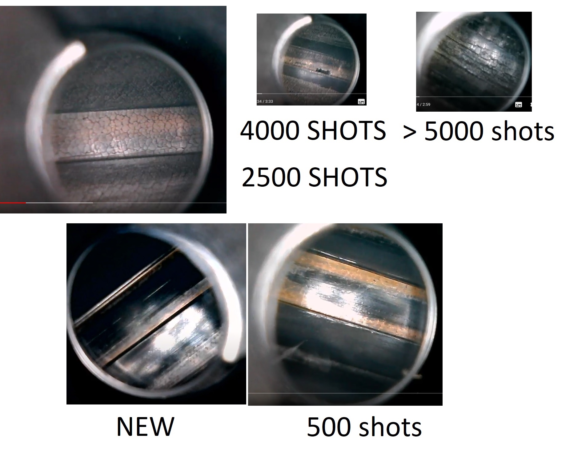

I got the borescope to try to see if i could learn how to tell how worn a barrel is, and to get some data on the subject bore scoped other shooters rifles on the range, and recorded it together with an approximation of how many shots they had fired. Most of the rifles are either 6,5x55 or 308w. (I never had any issues with cleaning or changing POI when cleaning, and my cleaning didnt effect group size)
The results i came up with are as follows(imagees are taken just in the beginning of the barrel):
0 shots: No cracks
500 shots: Slight and superficial cracks on the glands
2500 shots: cracks form a pattern and are not superficial any more
4000 shots: small peaces of material starts to be missing
>5000 shots: barrel starts to look "flaky" with long groovs
None of the barrels in the photos had any problems with accuracy, the one that had shot above 5000 shots was a Sauer STR 200 that performed really well on a 300 meter competition, shooting groups well below 1 MOA.
(disclamer: I am not a gunsmith or a scientist, this might be biased and missleading)
0 shots: No cracks
