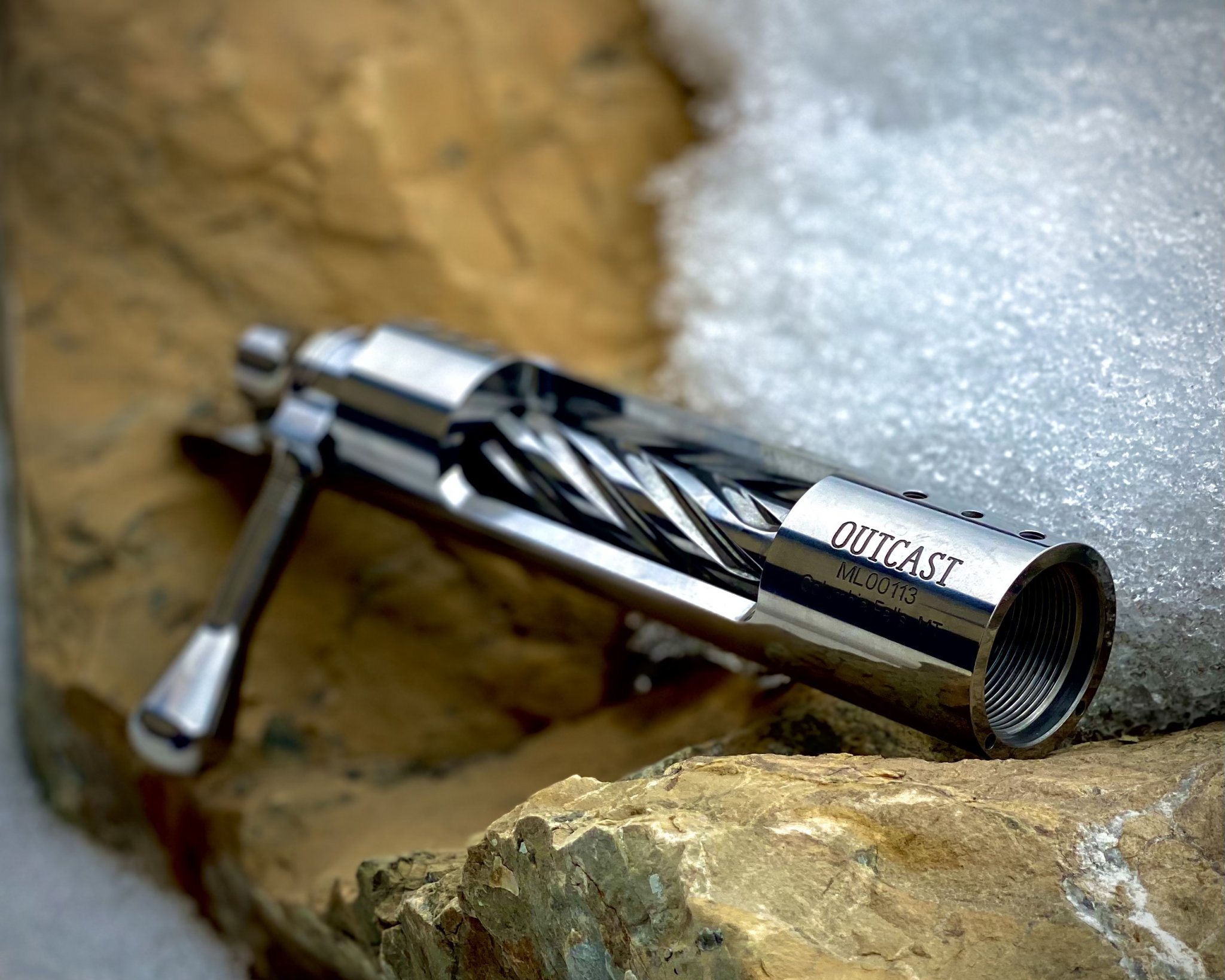

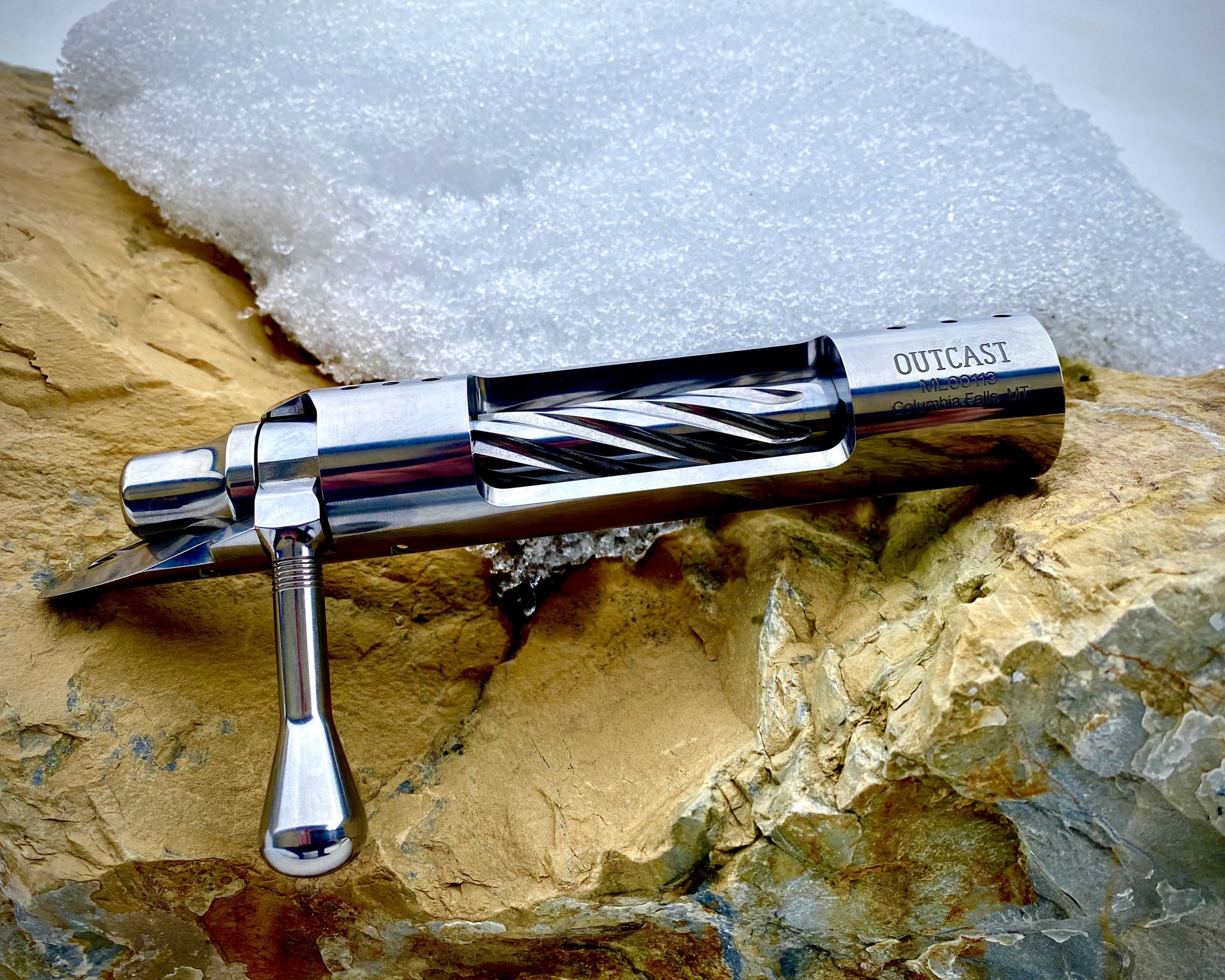

The new OUTCAST muzzle loader action.
A precision bolt action created specifically for building modern muzzle loading rifles.​

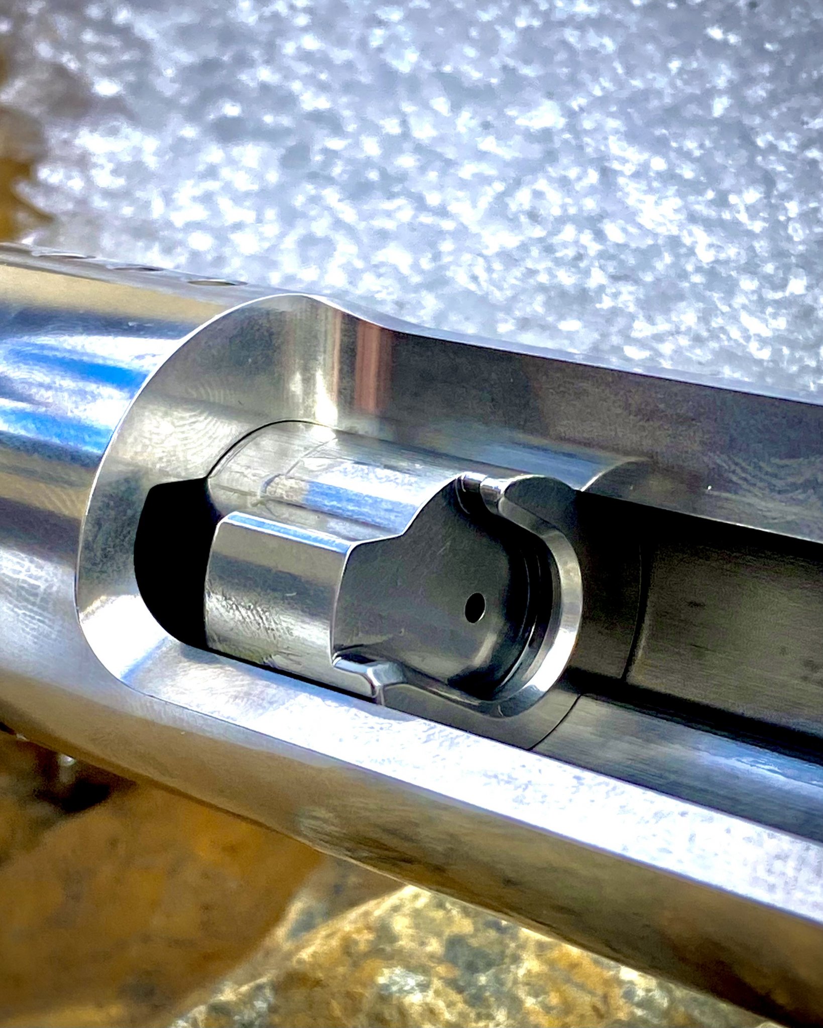

The OUTCAST is designed to use the Hankins Ignition System - Made by Hank's Precision Gun Parts (Standard .473” modules), or Arrowhead Rifles Gen 2 muzzleloader ignition system. The OUTCAST Action utilizes a “shell holder” type bolt face. This allows the module to be loaded and unloaded at a convenient angle. The bolt stop is positioned so the shell holder is always easy to get to.
Specifications
• Available in right and left hand
• 20 MOA stainless steel scope rail, or lightweight Talley mounts included

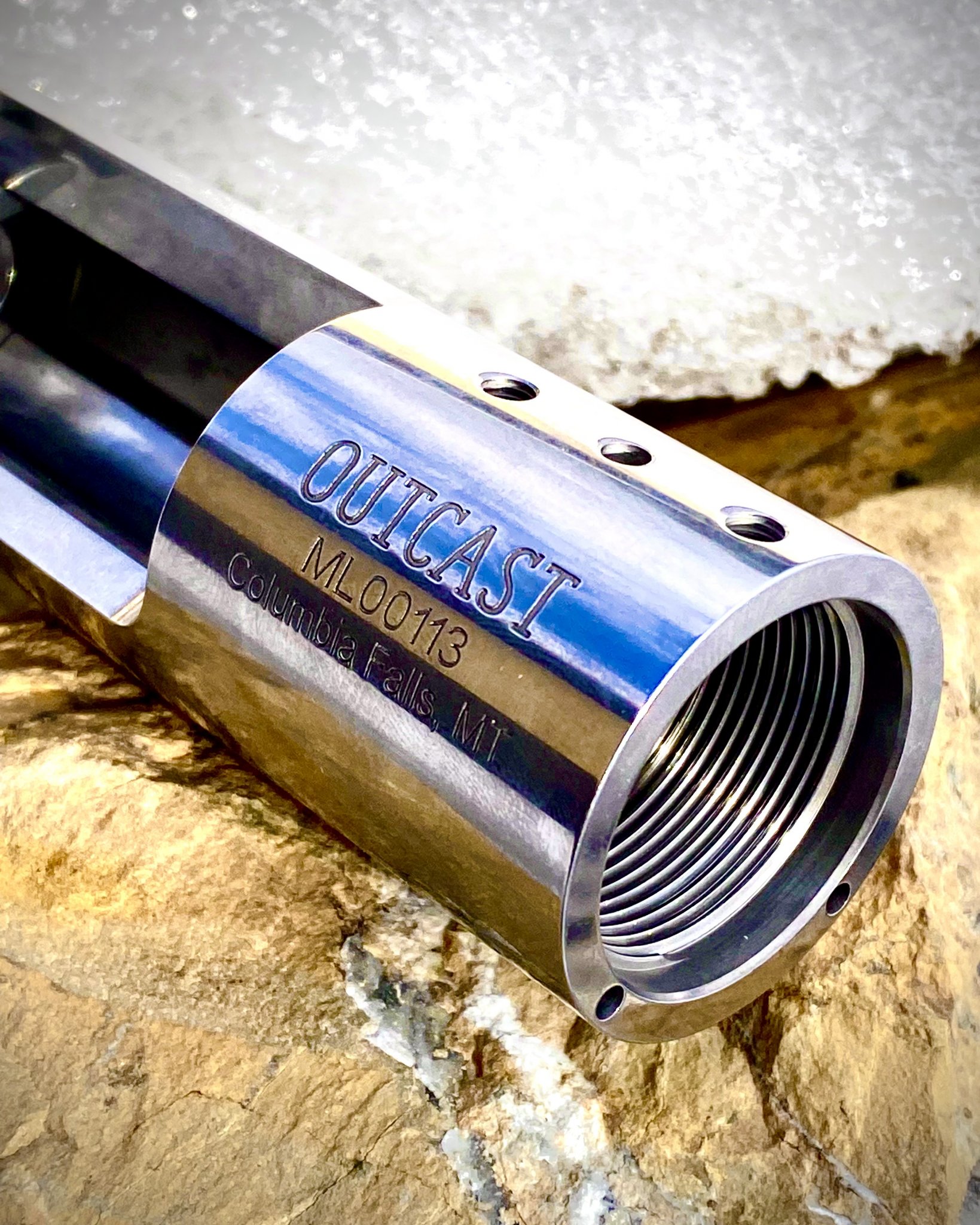

• Receiver has 20 Threads per inch (TPI) Barrel threads, leaving greater hoop strength in the barrel.
• .250” pinned recoil lug included
• Single shot (solid bottom) receiver – Modules cannot fall into hard-to-reach areas
• Defiance Medium Length action – Fits in Remington 700 Short Action footprint inlet
• Accepts Remington 700 style triggers
• Shell holder style bolt face
• Standard (.480”) bolt face diameter
• Straight teardrop knob
Note: This bolt action is a firearm and requires an FFL transfer.​
Price: $885
For more info, go to https://defiancemachine.com/actions/outcast/.

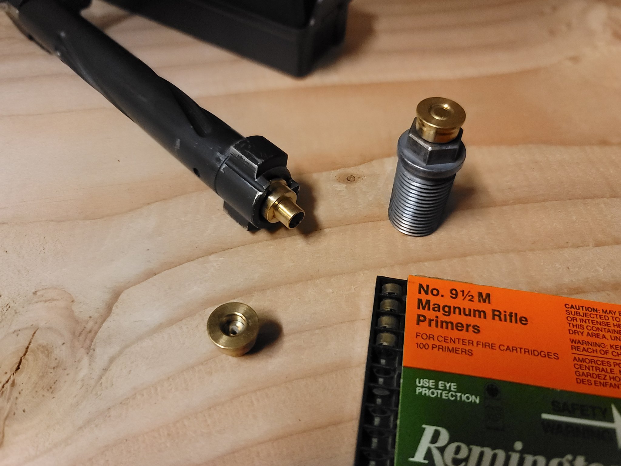

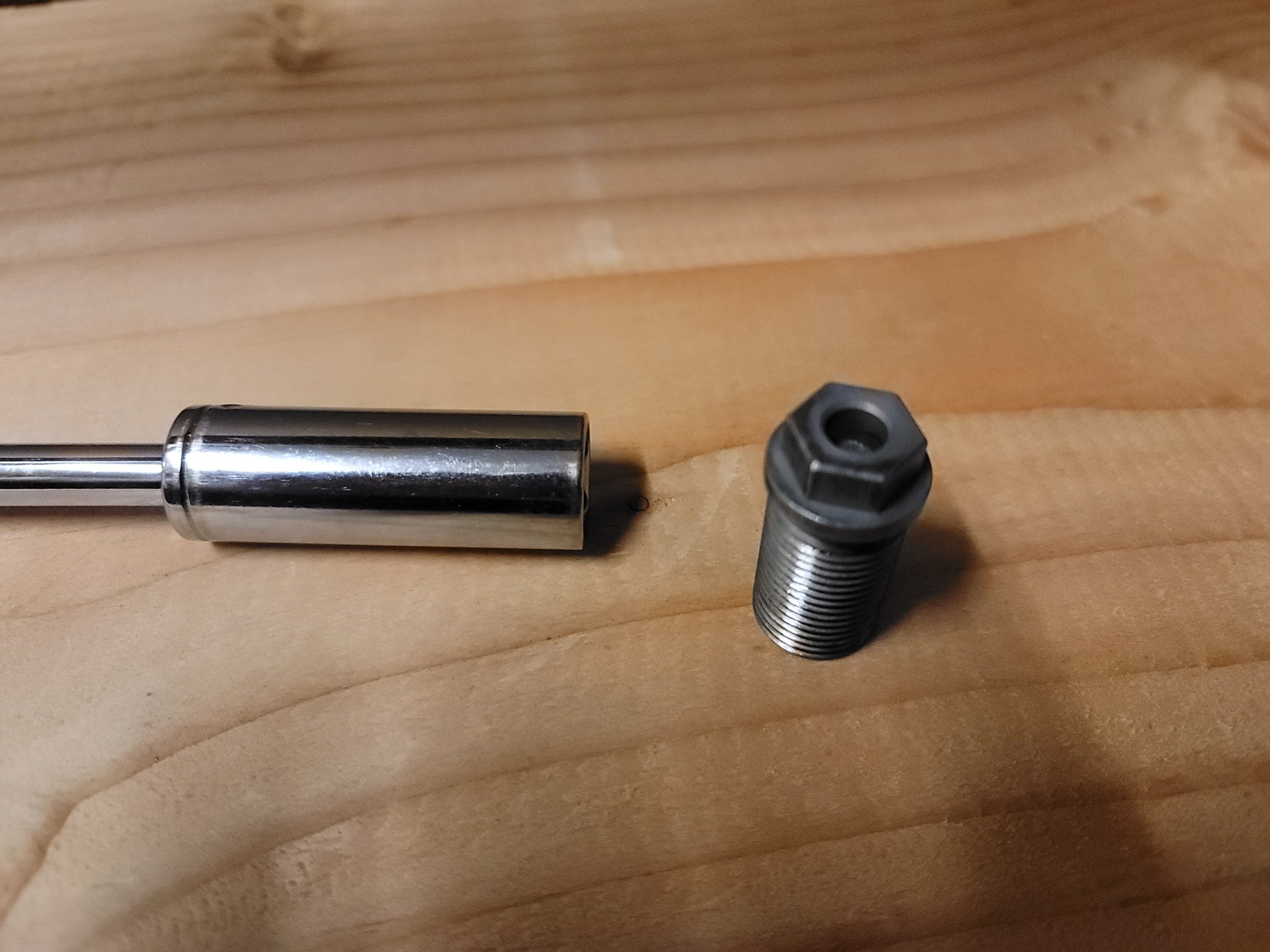

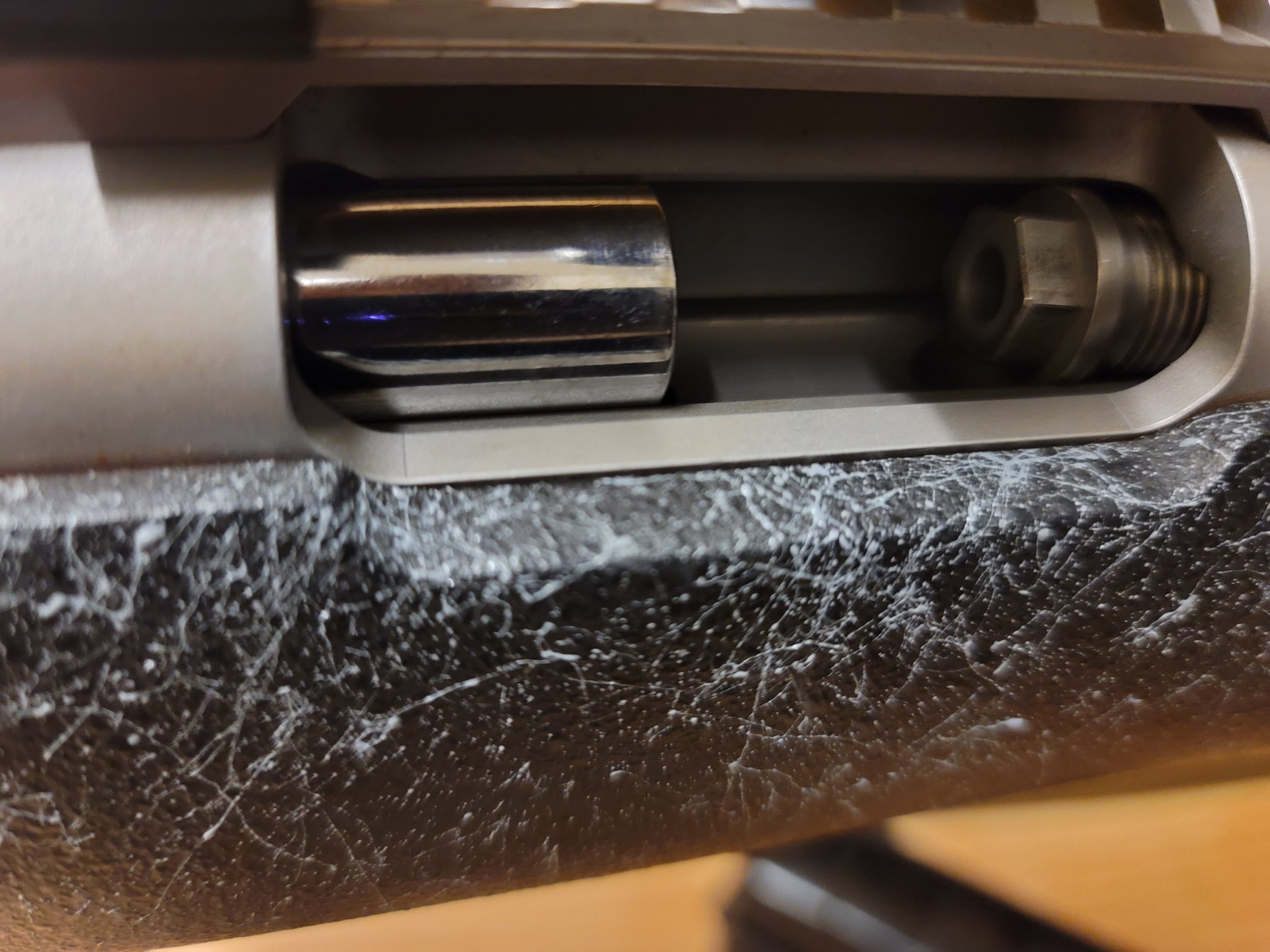

I'd like to see more info on how the Hankins system works. Like, how do you take the breech plug out for cleaning? Do you have to unscrew the entire barrel?
You take out the bolt, then take out the breech plug with a torque wrench. Check out Hankin's Custom Rifles and Hank's forum. His muzzleloaders are usually sold out, but you could probably order a barreled action. Or get a pre-fit barrel if you can do it yourself.

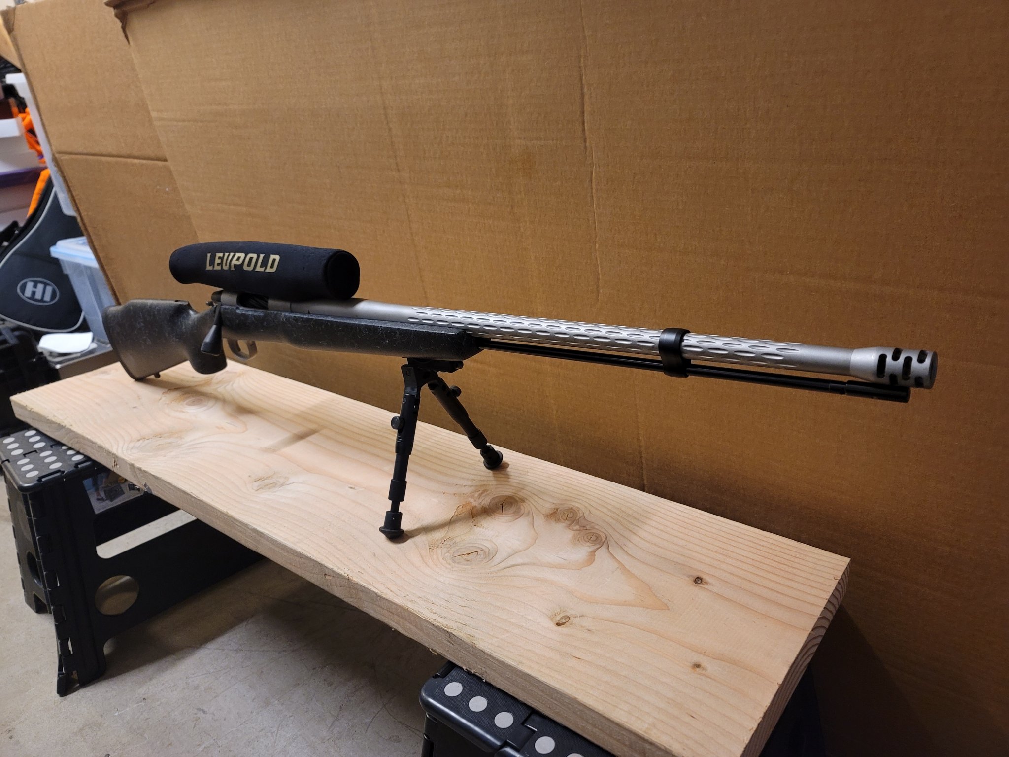

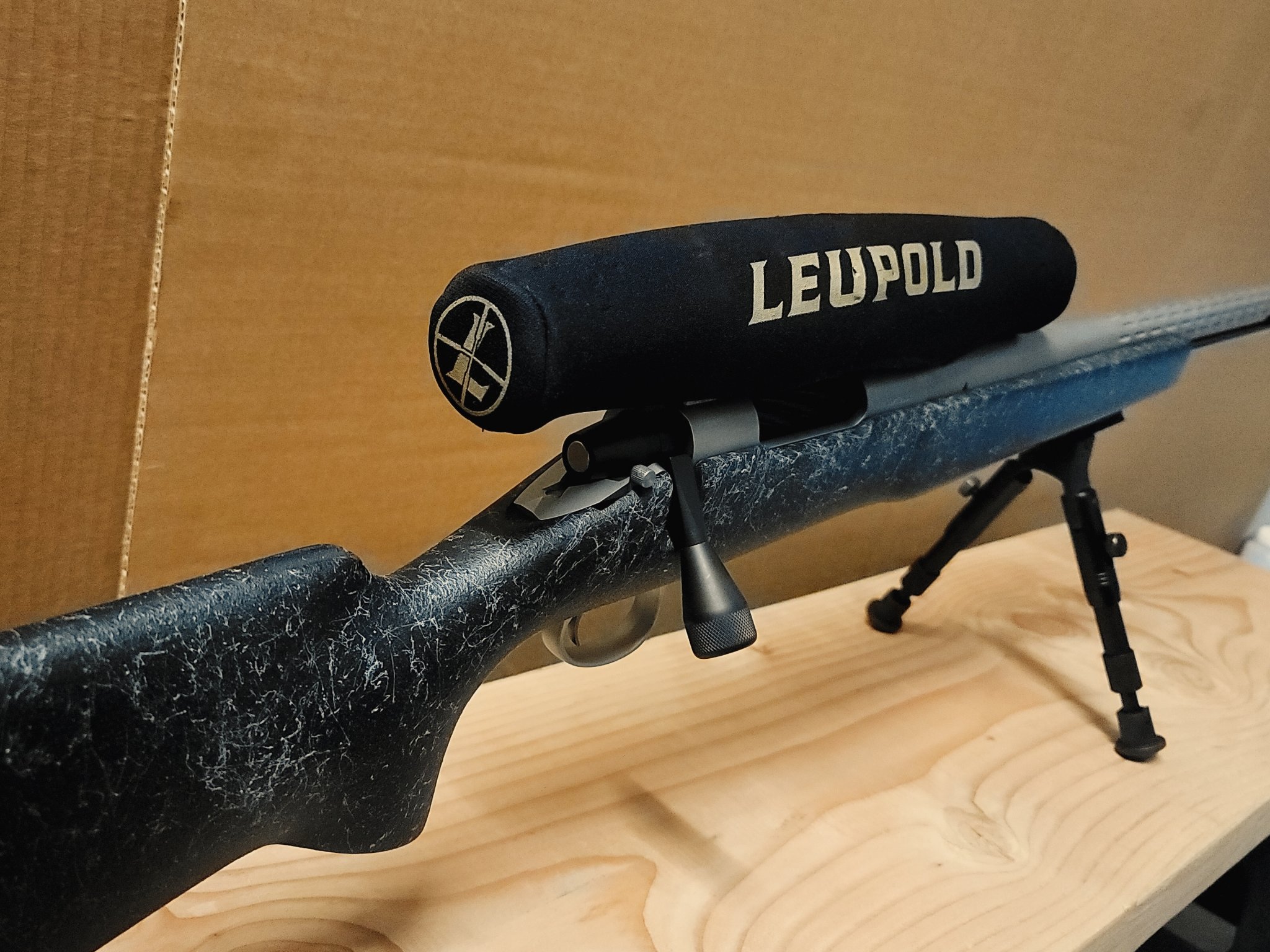

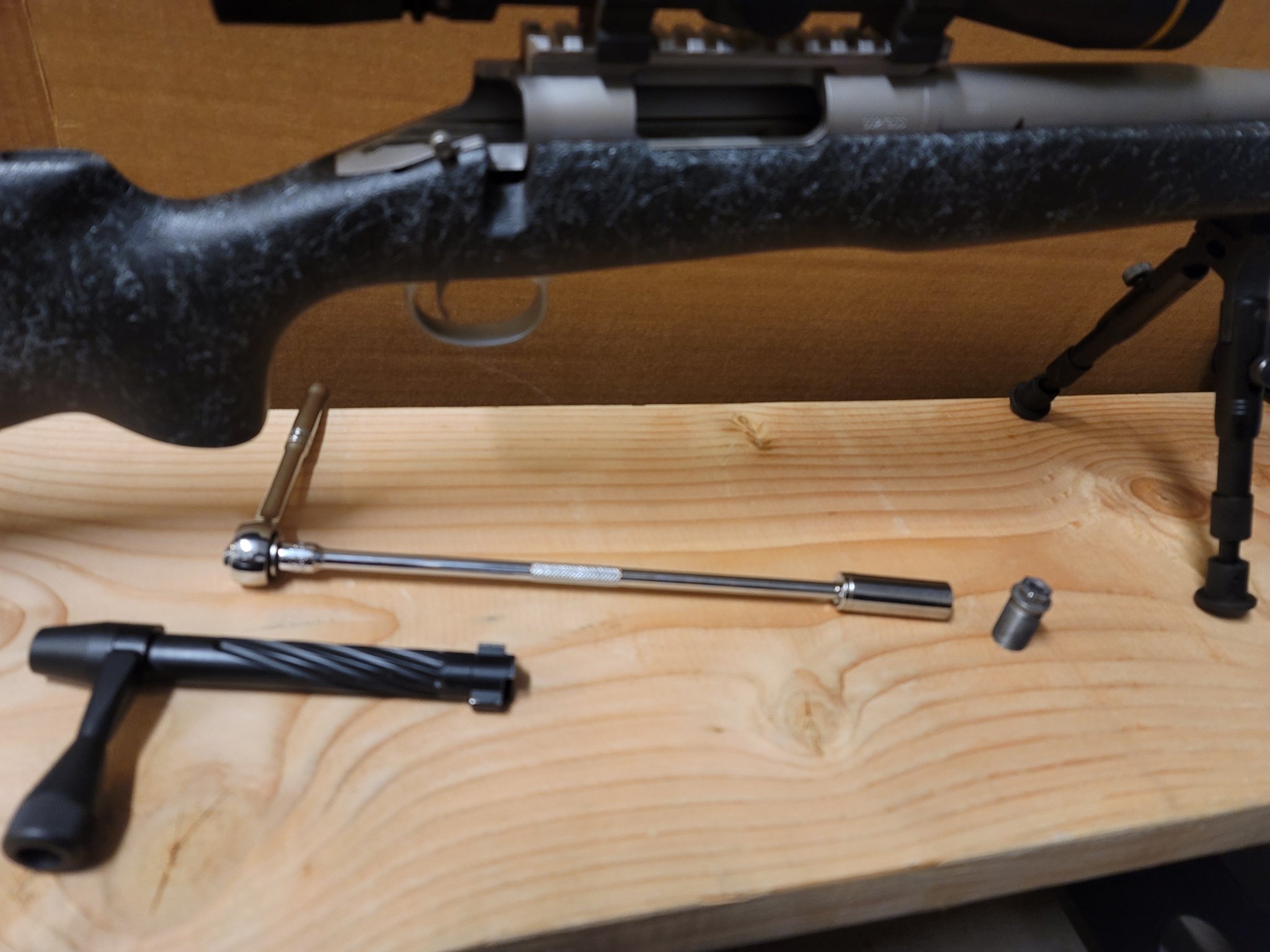

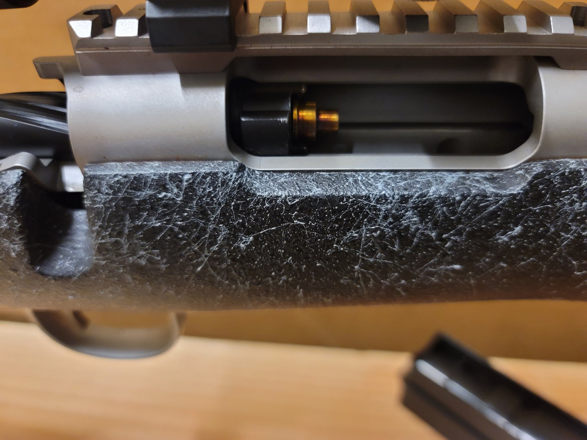

this looks cool, but does anyone have pictures of a complete rifle? It doesn't seem like there is much info on how to actually complete one of these actions.
You could use an ASG prefit with barrel nut or have a shouldered barrel spun up with a breech plug by a smith. There’s a few builders that make them, ASG and Hankins being the most popular.

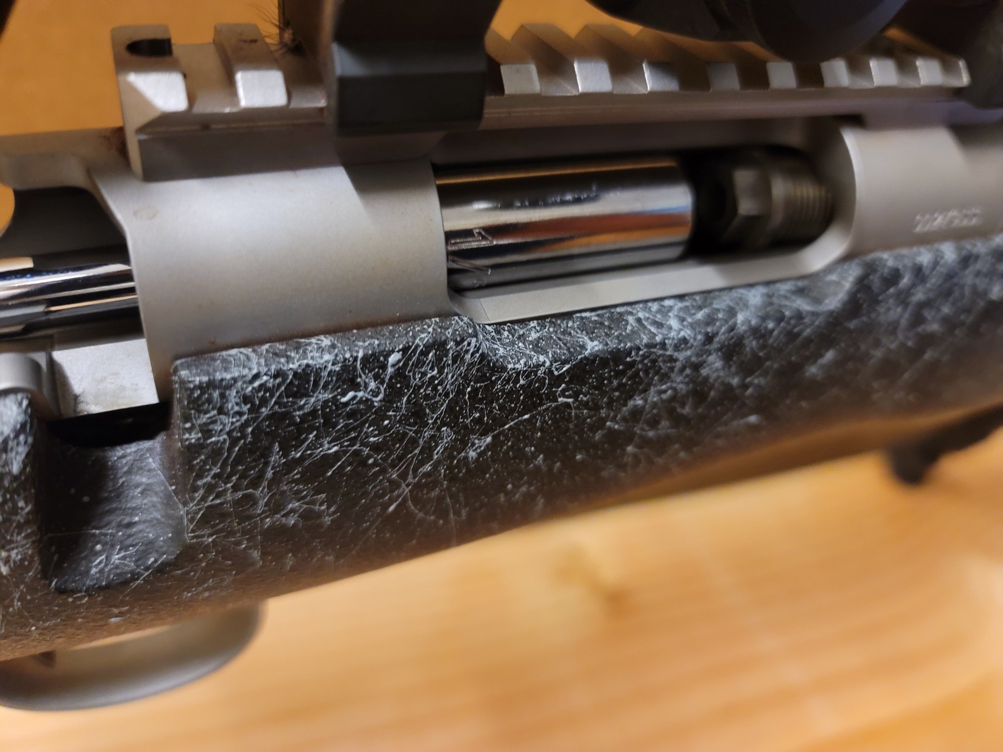

Mine was bought already made by Jeff Hankins. But if you're a diy'er, Hankins sells prefit barrels on his website. And it comes with his ignition system with the breech plug, along with the primer modules that you put the large rifle magnum primers in.
